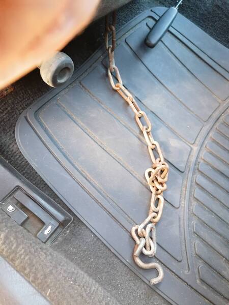

2 hours ago, TheDoctor said:
Was hoovering the Tourer out today, and discovered this chain under the seat. I presume it was wrapped around the bar under there, hence I hadn't noticed it before. It is looped around one of the bars and bolted together. Any ideas? A rudimentary steering lock? Some sort of bondage thing? ?
A friend says that's a "prince Albert ring chain".
I do hope you were wearing thick gloves.

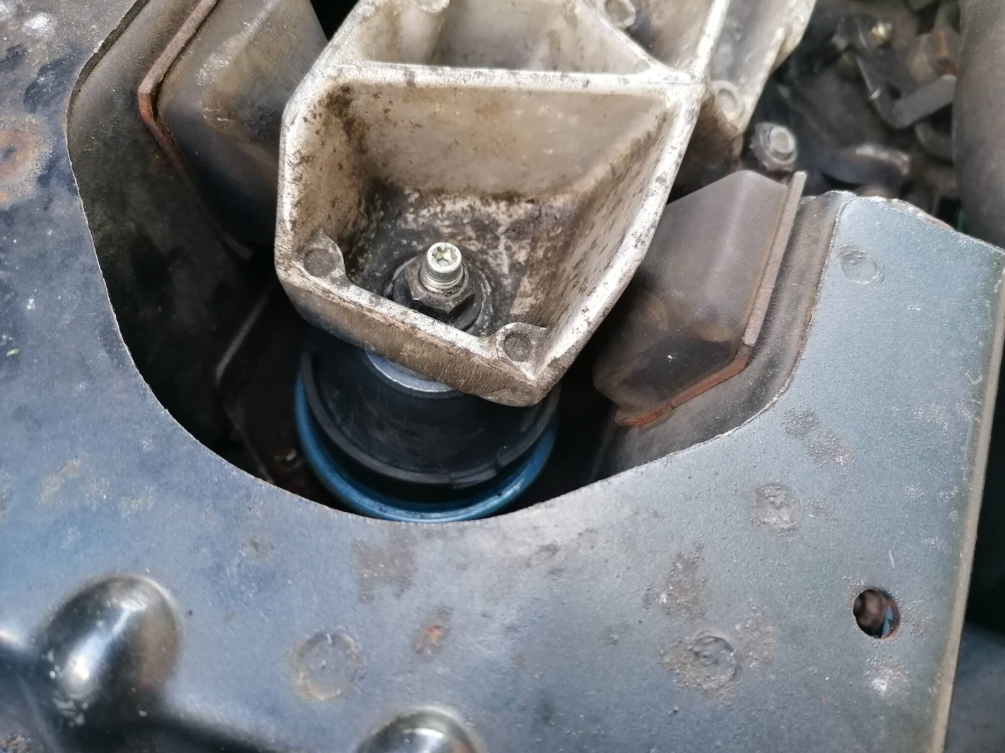

Went to do the engine mount today.

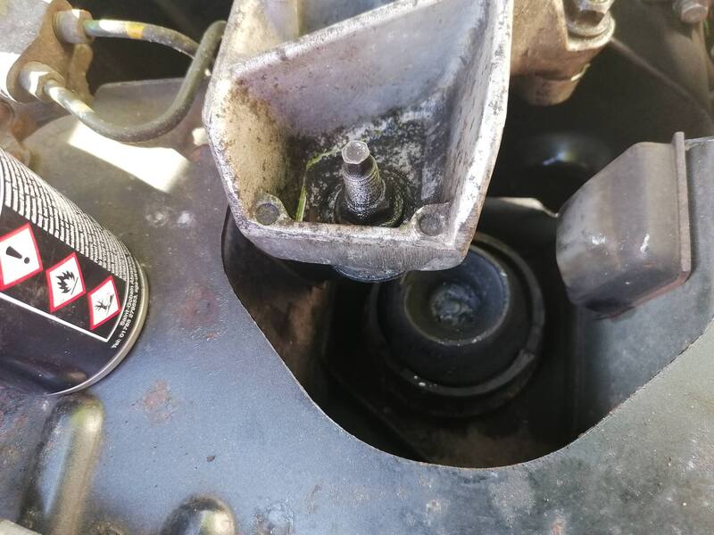

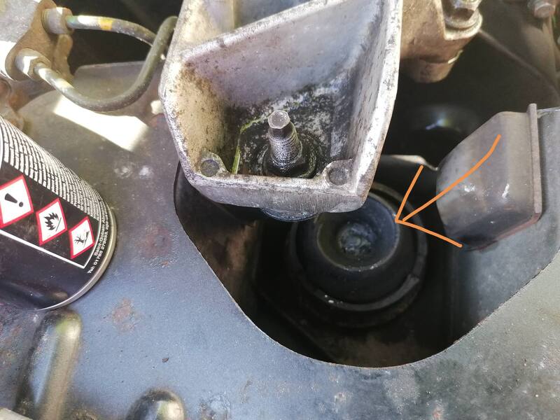

Slight problem - the mount screws into a captive bolt, but with the rubber snapped, there is nothing to grab and turn it with. It is too wide for mole grips. (Thanks to Doctor Jnr for the photos)
Any thoughts? I'm not going to attempt it this weekend, it's been like that for long enough already. It won't go anywhere unless I try any dukes of hazzard stuff.
Can you get a tool in to cut a slot in the top? If so do that and use a big flat blade screwdriver.
That's not a bad shout, thanks. Just need to hope it's not on there too tight..
43 minutes ago, Out Run said:
Or remove the bracket and work on it off the car?
It's the bit that is attached to the car that is the problem
Got ya. If the slot cut method doesn’t work, slip joint pliers might hold it. Or just wedge something in there? Drill a hole or two in it and hold it?
Tap it round with a chisel, sort of castle shape bit at top.
Done loads on Peugeot’s, not usually that tight either.
The big fat oil filter pliers any good for that? They usually have teeth so would grip it well.
Hmm. Good idea..

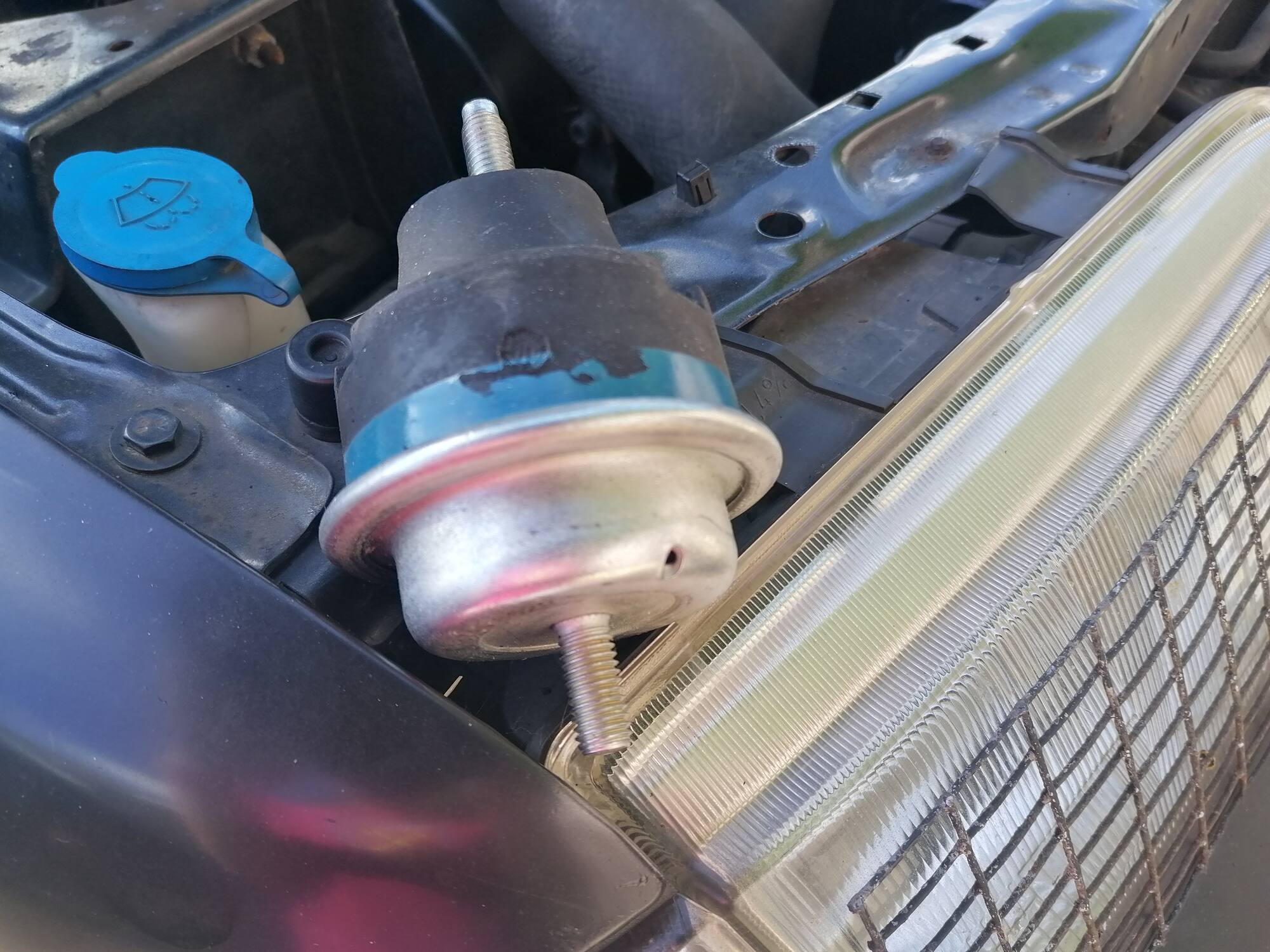

Done it!
I used an old screwdriver as a chisel and whacked the fuck out of it. It came off after some persuasion. Then used mole grips to get the rest of it apart.
The hard part was getting everything to line up again, but that was sorted by jamming a jack down the back of the engine and winding everything forward a bit.
Tada!
Old one had definitely seen better days, and now I have more peace of mind on my long journey next week.
