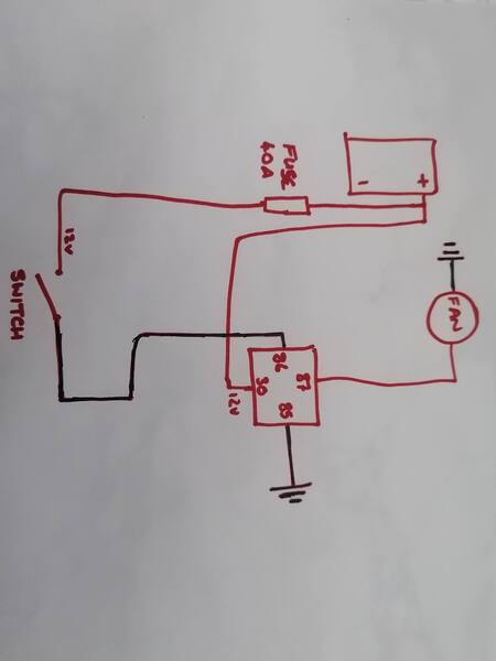

I'm having a bad day. After patching myself up and carrying on, I wired the fan using too small a gauge of wire/switch and melted the switch. So back to the drawing board.

I thought Fan Fuses were 15/20 amps, dont use speaker wire for that :)
I used household wire, but the switch wasn't man enough. I've ordered 4mm wire and decent connections and an aircraft style switch.

Regarding the rad fan- are you using a relay? If not then you should! That way the switch handles a tiny amount of current and you can use a nice small switch and thin wiring.
Good practice anyway, you want to try to keep large current draw away from your fingers if you can. Just putting bigger wiring or a more hefty switch in probably isn’t the right way to resolve this.
Especially in a DC motor. Inrush current will be quite high until the motor spools up

How's this?
Or does the '30' bit need to be a switchable live, e.g. ignition?
Wouldn't you want the fan side fused, rather than the switched? Ign feed rather than permanent live also a good idea unless you plan to run the fan after you've switched off.

29 minutes ago, TheDoctor said:
Perfect. Your feed for the switch wouldn't necessarily have to be ignition switched either as I doubt you'd accidentally leave it on, and also make sure it's something that's fused with a nice small fuse like the cigarette lighter feed.
