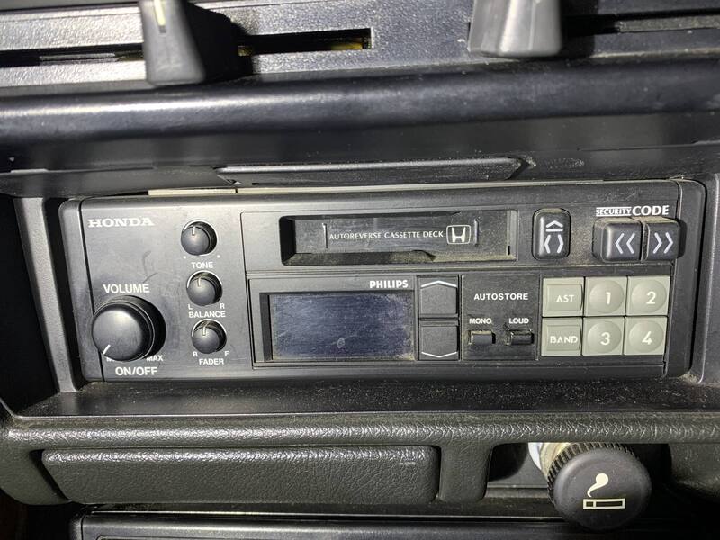

Because it had its battery disconnected while parked up, it needed a radio code to reinstate choonz and nooz.  Unfortunately, despite putting two of the online radio code websites to the test last week, and even corresponding with actual humans, no code for this model is to be had even for ready money.
Behold an ornamental OEM stereo:
Unless anyone has a better idea, I will probably have someone replace the innards of the head unit with modern Blueteeth at some point.
Until then I shall just have to sing to myself and make up my own news, traffic and weather.

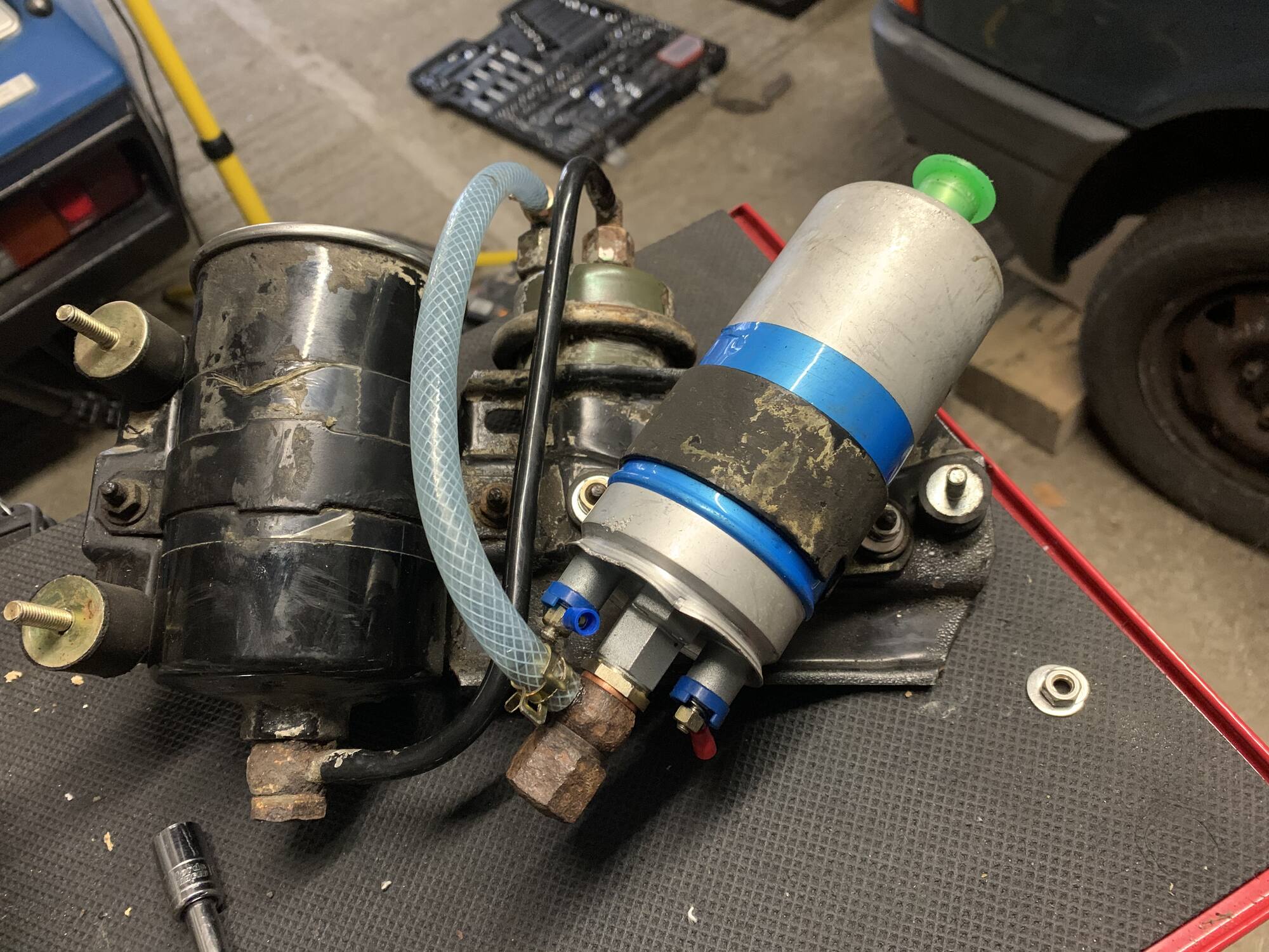

Meanwhile I have also been chipping away at the Audi 80, which you’ll recall was last seen perched atop my new car lift.

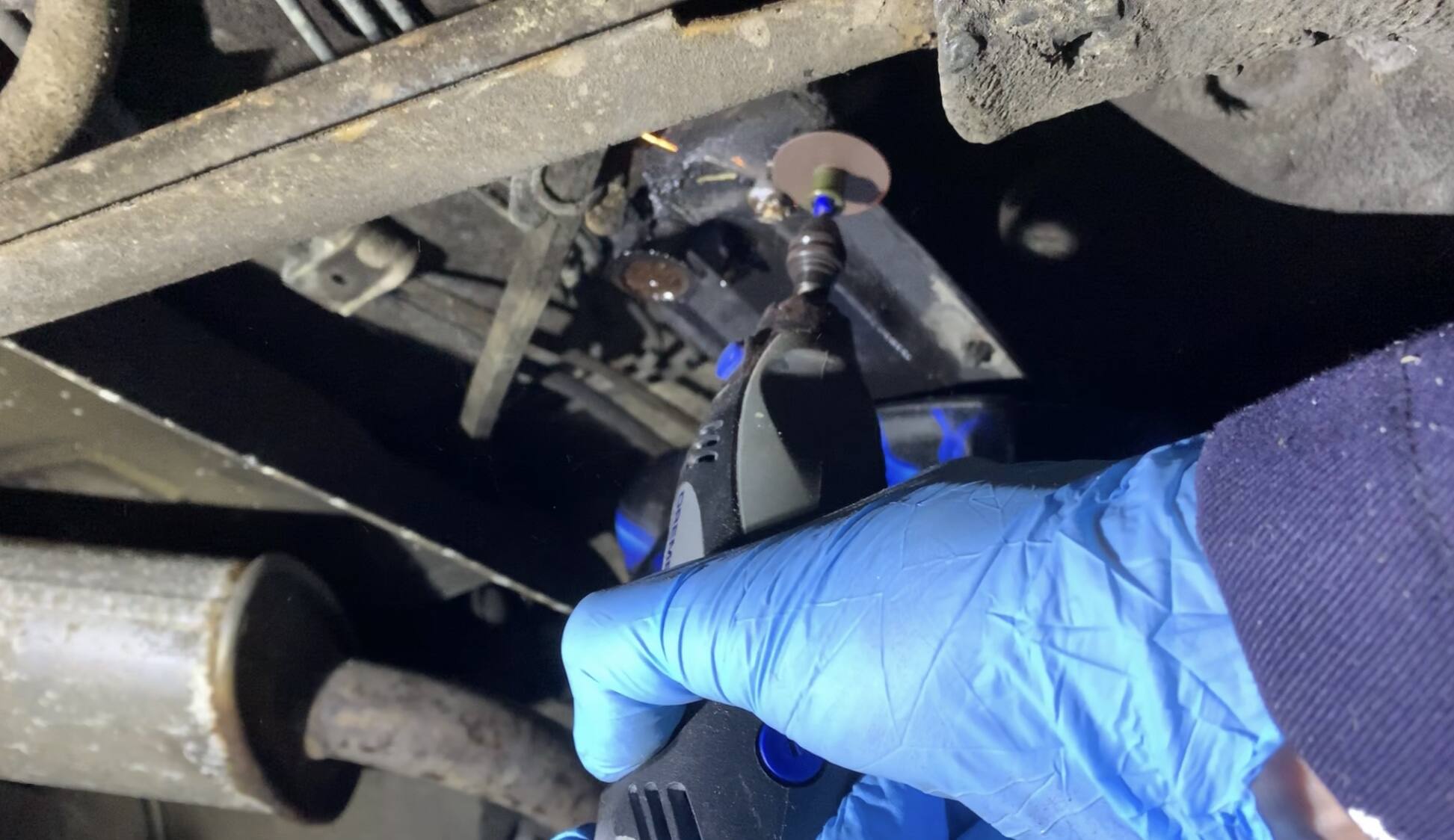

The reason for this was that fuel pump had packed in, and the subframe it’s mounted on had almost come adrift as two of the three rubber bobbin mounts had perished.
All that had to come off, which meant grinding off bolts next to fuel pipes.
Brave pills were required but luckily I didn’t die. Hose clamps, bungs and a plumber’s soldering mat helped with being lucky.
It was all very manky.
I thought about getting an ultrasound bath, but since I’d just filled a bucket with petrol I left the whole assembly soaking in it for a week instead.
Pebble Beach here I come:
Well, it’s better than it was.
Behold also three new rubber bobbin mounts from eBay. The hardest part of that was figuring out that’s what they were called so I could search for them.
Also note a new Chinese knock-off fuel pump from Autodoc.  It was advertised as an OEM Bosch pump and priced accordingly, but it’s identical to the cheap Chinese knock-off I’d already bought, right down to having the same, wrong, type of electrical terminals.

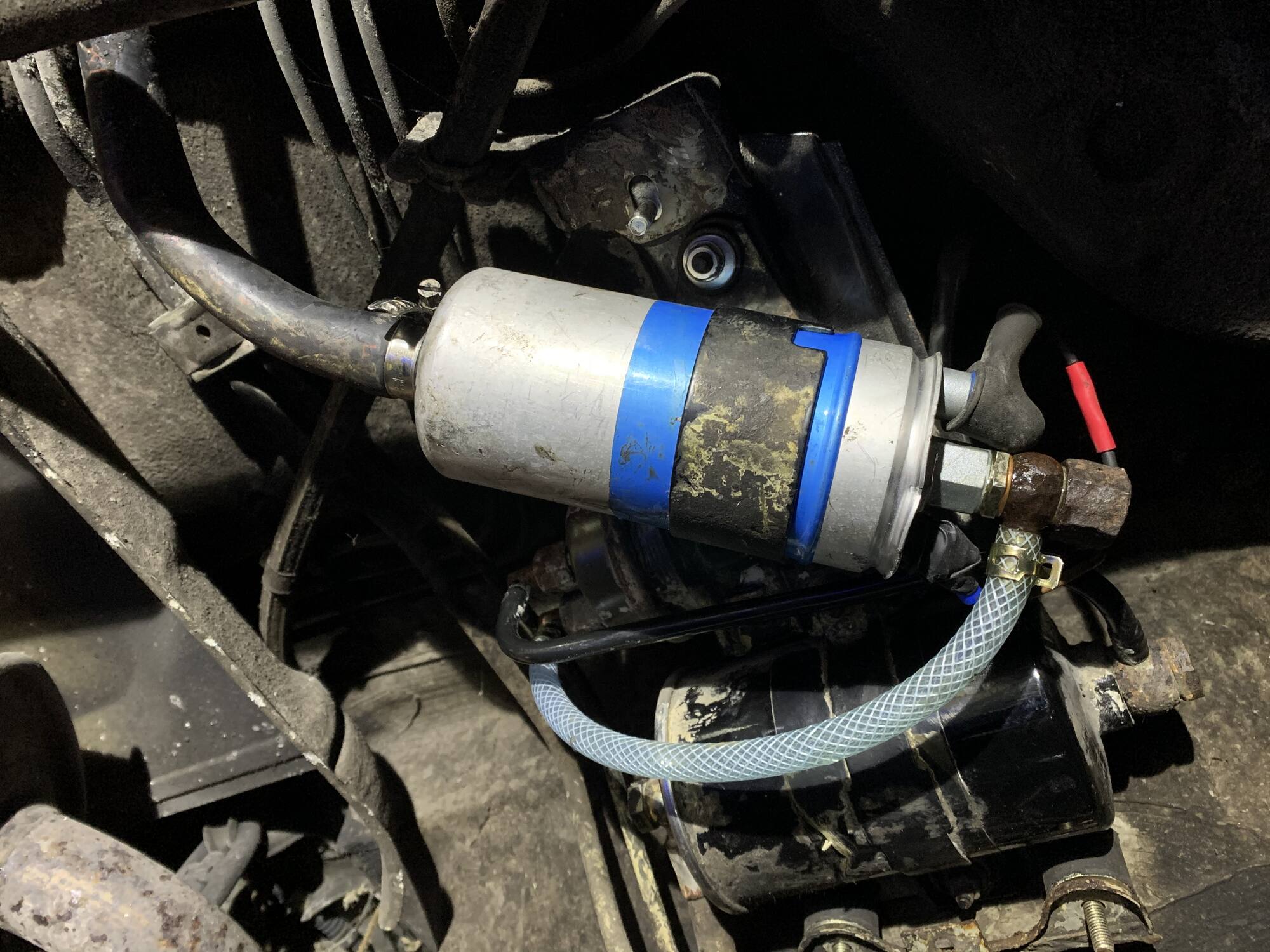

I had to cut off the lovely OEM screw-down terminals and fit ring connectors like a barbarian. I found one dust boot in the bottom of a drawer and improvised the other out of the little finger from a disposable rubber glove and an o-ring.
Anyway, it’s all back on the car now.
I slightly* doused myself in stale petrol this morning refitting the main hose from the tank, but at least my wristwatch is now very shiny. Here it is connected up.
It makes a fuel pump noise and doesn’t leak, which is good, but the car won’t run yet because the battery is shagged.  Or maybe the starter motor, which just clicks, but most likely the battery.
3 minutes ago, SiC said:
Tried the dealers?
It did cross my mind... might give it a go just to see how they feel about their heritage.  I may have more joy emailing Honda UK, in fact.

I have a better idea for your radio.
It's a Philips unit, and some Rover units are the same. Fascia swap!
8 hours ago, andy18s said:
Have you pulled the stereo out and checked the code isn't written on it?
Yes, sadly. It’s not in the extensive original paperwork file either.
Two different serial numbers are on the unit, one stamped and one printed on a label, but apparently neither are in the standard databases.
IIRC similar bobbins are used on something Jag/Rover/Triumph - fitters used to refer to them as cotton reels.
Is the radio an early enough model to respond to the of trick of putting it in a freezer for 30 mins?
Those Aerodecks are ace, although I'm sure you already know that.
I'd definitely call the main dealer.  I had to do this with Volvo for my old 240 and they obliged over the telephone.  After all, it's your radio.  Volvo were quite pragmatic about it, and accepted that people aren't going around stealing 30 year old radios any more. (!)
?? Didn’t know that one. I might give it a go if the local Honda dealer doesn’t help.
