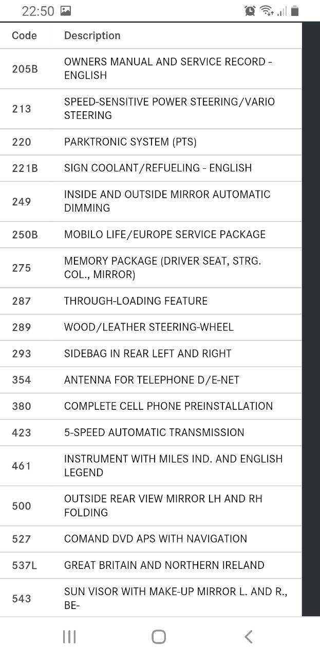

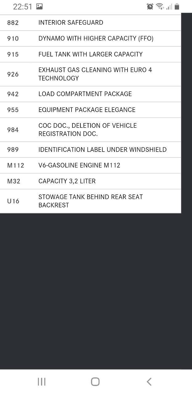

I did a VIN decoder look up, to find full spec.
Std E Class fuel tank is 80L.
The BFG has an extended tank fitted (Code 915), which is 90L.
God knows how much that cost when it was specced.
Who thinks, nah 80L is not enough, I will pay extra for a bigger fuel tank, cause those extra 10L will come in handy.
Full spec for BFG below - nappa leather for extra softness :)
Code U16 - Stowage tank behind rear seat backrest.
@SiC thought it was for the storage of the Load compartment package (code 942). Makes sense because it fits.
But when I ordered the boot mat, the guy asked if my car had the gun rack behind the rear seats !!
SiC is probably right, but gun rack sounds cooler, so I'm going with that :)

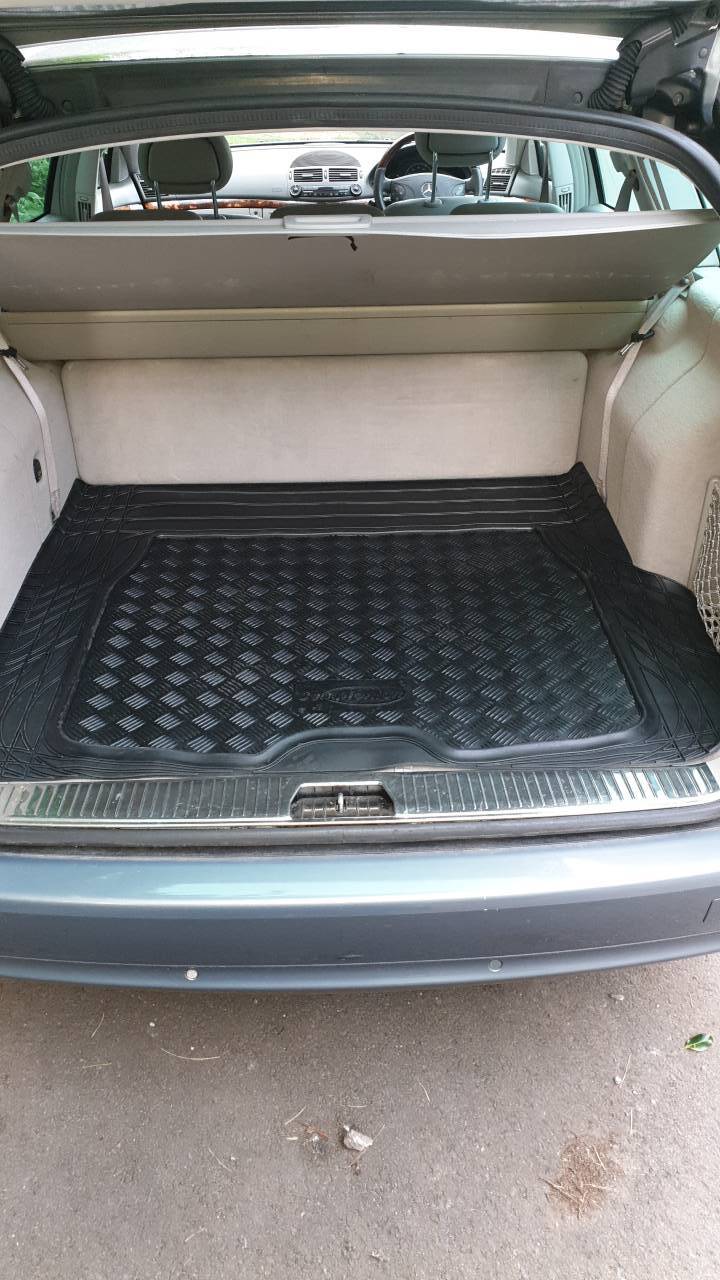

Put the new rubber boot mat in, to give some protection from the dogs (on the rare occasions they will be allowed in it).
Before
After
Needs a bit of a trim in places, but happy. Note the back of the gun rack - saying that will never get old. Gun rack :)

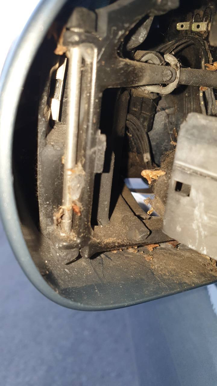

The new drivers mirror indicator arrived, so once work was out the way today, thought I would give it a go.
Watched a YT vid. Seems easy.
Well it wasn't. My mirror had a internal cover that the ones in the YT vids didn't have.

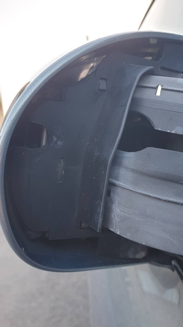

So being the professional mechanic that I am, I pryed it out the way with a screwdriver. Miracle - I didn't break it.
See that little metal clip at 10 o'clock?
It needs to be pushed to the right, so the cover will come off.
Success.
Two little philips screws to remove and unplug the puddle light.
Fitting the new one is simply a reverse of the process.
Then push it back on. Sadly epic fail.
I can't get it to clip back in.

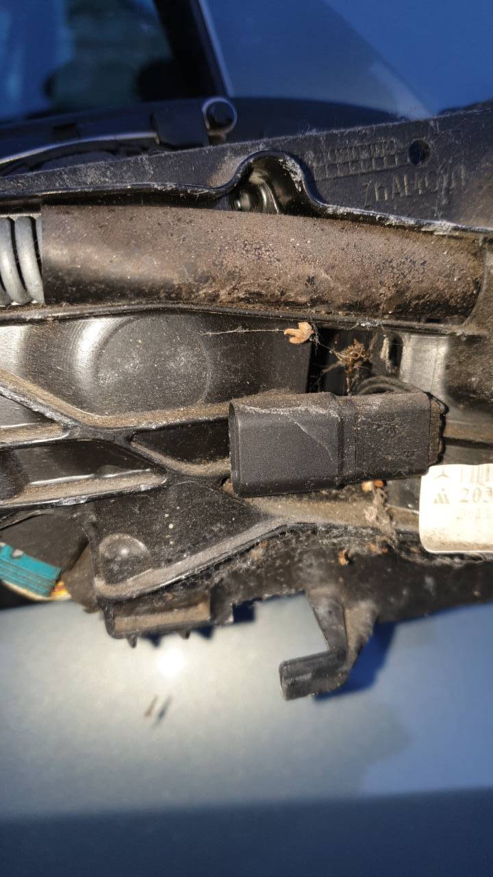

See the electrical connection, with the red plastic round it?
Well in theory, it should slide back in to the connector attached to back of the mirror assembly.
It won't.
So now my mirror looks like this
Classy hey :(
  • Sad 3

Does it start to go in? Sometimes those rubber boots on connectors can snag
Small dab of silicone grease/spray of silicone lube can help them slide in better.
I dont know if it does, as its all being done blind.
I will get some silicone for the rubber boot and try again.
Can one side be disconnected temporarily and use the length of the flylead to get an idea of what's causing it to snag?
