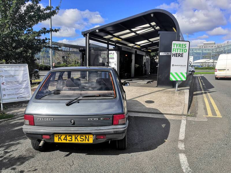

davidfowler2000 Posted August 29, 2020 Author Posted August 29, 2020 I was going to wait until I got the wheels blasted and powder coated to get new tyres but those old ones are just fucking lethal. BL Bloke, Coprolalia, scdan4 and 9 others 12

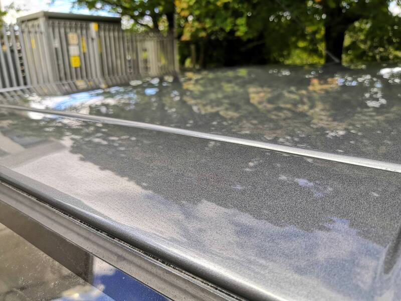

davidfowler2000 Posted August 29, 2020 Author Posted August 29, 2020 Cleaning... Metallic paint is very metallic Coprolalia, dome, Lacquer Peel and 7 others 10

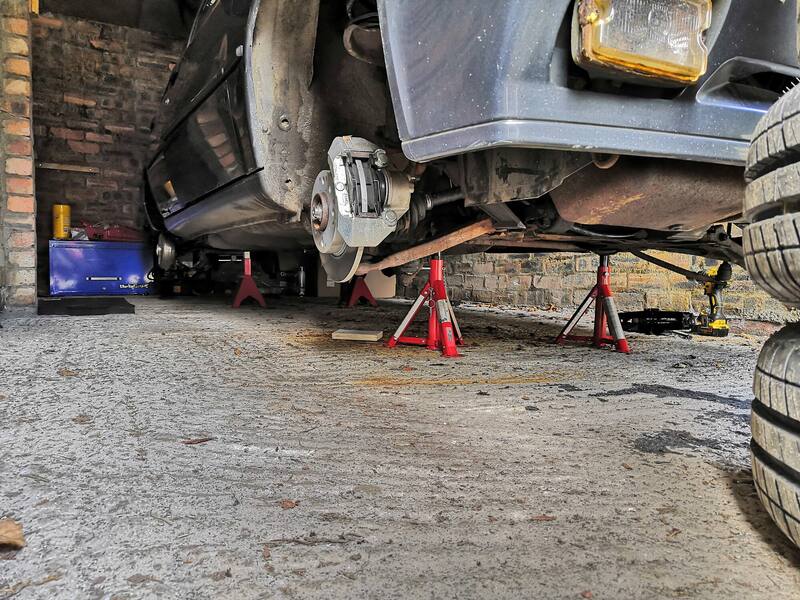

davidfowler2000 Posted September 3, 2020 Author Posted September 3, 2020 Got the wheels booked in for blasting and powder coating in East Kilbride tomorrow. The place I'm taking it to is doing it for £35 a wheel if I bring them just the wheels or it would be £240 if I took the car so up to Cumbernauld today to get the wheels. But first, a quick episode of Scotch Gear... The Power Jack worked a treat lifting the car quickly and effortlessly. Space is at a premium in the lockup so trolley jacks are less than ideal and winding a handle on a scissor jack is not my idea of a good time. I've got 6 wheels - 5 silver ones and a black one. One of the silver ones lived in the cradle under the car so it's in a very bad way but they'll all get blasted and powder coated apart from the black one. The 5 new tyres I got last weekend will go on the 5 silver rims and the black one will sit spare. The one under the car is a Technic T2000. A quick whizz down with the wire wheel to knock the worst off so they don't shed rust all over the 740 Temporary stance Tickman, Coprolalia, loserone and 11 others 14

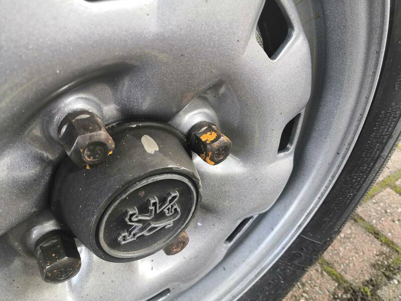

davidfowler2000 Posted September 13, 2020 Author Posted September 13, 2020 Finally got time to fit the wheels back on today after getting them back from the powder coaters. I went for the sparkle silver as the car's own metallic paint has a lot of metal fleck in it... However the super shininess of the wheels brought out how shite the wheel bolts were. Oh aye and I also highlighted the hub caps with a bit of silver paint. Will need to do a better job later... Options for wheel bolts are: 1 - New chrome ones 2 - New black ones 3 - New bare metal ones 4 - Wire wheel the old ones. Experimentation on a single wheel bolt with a wire wheel in the battery angle grinder... I'll do more on the wire wheel and see how they turn out. I also picked up some new door plungers to control the interior light. Driver's side was completely fucked and they came as a pair so I just did both. Yes I know I need a new roll pin for the door stay. brownnova, juular, MorrisItalSLX and 22 others 25
juular Posted September 13, 2020 Posted September 13, 2020 Fine work. Have you considered a citric acid bath for the bolts? It's fairly effortless, cheap and really effective. Leave overnight, remove, dry and paint. Big bags of citric acid powder can be had on eBay for very little, I think Wilko also sell it.
davidfowler2000 Posted September 13, 2020 Author Posted September 13, 2020 Could do I spose. I have a tub of Vactan but I don't want to discolour the metal. Will maybe see what the local hardware shop has in stock but if need be I'll just wire wheel and clear coat them, Ideally I'd use a bench grinder for that but... meh.

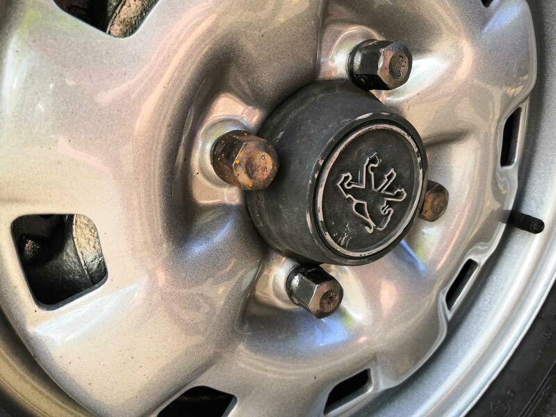

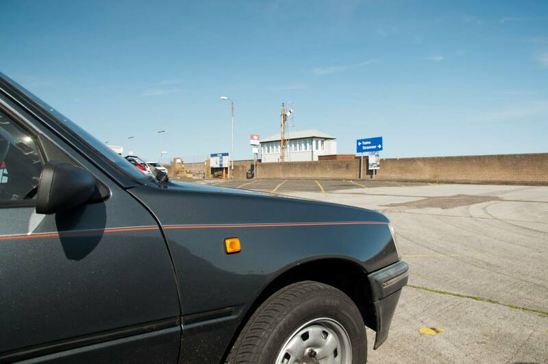

davidfowler2000 Posted September 19, 2020 Author Posted September 19, 2020 Right. So. The experiement on the single wheel bolt with the wire wheel was continued on the rest of them. Results seemed positive. However there was a spot of rain one night and it caused a few spots of flash rusting... I ordered up a tin of spray lacquer to attend to them but they were going to need stripped back again so I thought instead of grazing knuckles on the wire wheel on the grinder, I'd try the citric acid approach. It did work, even on the one bolt I never managed to get done because the battery on the grinder went flat. They still needed a very light rub down with said wire wheeel again once the acid got them back to bare metal... Some other odd jobs - Vactan the spare wheel cradle and cut off the old hanger bolt to replace with the new one. Find the wiring for the spot lights as I've got a new pair to go on and the wiring to the old ones has been cut for some reason. So wheel bolts done and everything secure, time to take it it's first run out for fun... Just south of Girvan... Stranraer... Mull of Galloway, southern most point in Scotland. Approx the same longitude as Hartlepool. Isle of Mann on the horizon in the first two shots, Workington and Whitehaven on the horizon in the third shot Clatteringshaws Reservoir... Somewhere in the Galloway Forest Park... Wanlockhead, highest village in Scotland... Also some bonus chod spot in Wanlockhead... So... observations... Comfy. Nothing seems wrong. Fast as fuck on twisty roads. Need to be above an indicated 2250rpm to get decent boost. While I suspect noticably faster on the twisties than a NASP one, I reckon the turbo is most useful in 5th above 55mph - motorway acceleration. Sore shoulder from pedalling manual steering while changing gear all day. davehedgehog31, BL Bloke, outlaw118 and 25 others 28

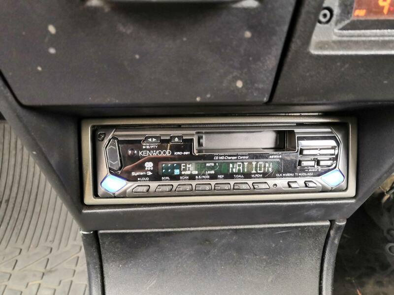

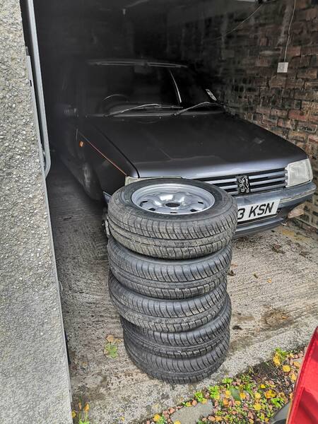

davidfowler2000 Posted September 21, 2020 Author Posted September 21, 2020 Pictures. 1000 words. Etc. "Spot" the difference I also got a new* radio player for it. It was described as having an aux in but the connections on the back are a line out. Bugger. Still be nice to have a better tape deck. It also came with a free Richard Clayderman tape. MorrisItalSLX, chaseracer, outlaw118 and 7 others 8 2
