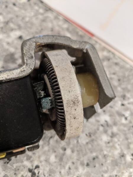

sdkrc Posted January 25, 2020 Author Posted January 25, 2020 Drove to the gym and motorway route was closed. Not a fan of the attention through town Lights started to flick on/off violently so that's 3/3 fucked cars now. Just have to make it home without anyone seeing my fucked lights...hmm I think it was PhilA who said it's gonna be the switch. Serves me right for not solving that right away captain_70s, RobT and Split_Pin 1 2

captain_70s Posted January 26, 2020 Posted January 26, 2020 Have you tried wiggling the fuck out of the switch? sdkrc 1
sdkrc Posted January 26, 2020 Author Posted January 26, 2020 I've wiggled the bollocks off it. Needs to be taken apart and shouted at. Oddly enough a security guard stopped me to talk about cars tonight and said he loves triumph dolomites...wtf paulplom 1

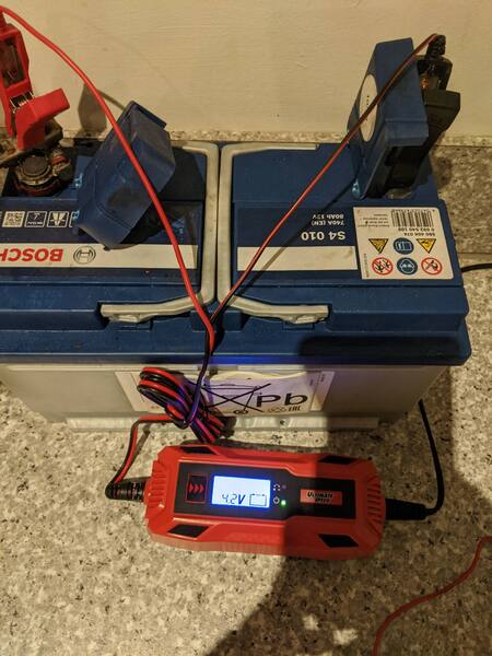

sdkrc Posted January 28, 2020 Author Posted January 28, 2020 On 1/25/2020 at 11:42 AM, busmansholiday said: I've a very similar looking charger that does absolutely fuck all charging when the battery reads that low. Have to use the old one to get the battery voltage up to above 10 volt before that one will do anything useful. Holy shit. 3 days charging and we're at 7.2v. RIP I can't tell if it's the battery that's guffed or the charger but @busmansholiday's experience makes me think it ain't the brand new battery. Surely 1 complete discharge wouldn't brick a new battery?
busmansholiday Posted January 28, 2020 Posted January 28, 2020 1 minute ago, sdkrc said: Holy shit. 3 days charging and we're at 7.2v. RIP I can't tell if it's the battery that's guffed or the charger but @busmansholiday's experience makes me think it ain't the brand new battery. Surely 1 complete discharge wouldn't brick a new battery? Nope, the TF battery got down to three volts because the alarms on these don't ever turn off. That charger wouldn't touch it. Overnight on an old, not regulated one had the battery up and running again. It still is, 6 months later. Those chargers are good for trickle charging full batteries, they are, in my opinion, fucking useless for anything else. sdkrc, Talbot and Scruffy Bodger 3
SiC Posted January 28, 2020 Posted January 28, 2020 It's because the charger is probably thinking it's a 6v motorcycle battery. You need to get the voltage to around to 9v for it to properly detect it. Best method is using a 12v power supply. However you could do it dangerously by jumping it onto a good battery in parallel... Probably wouldn't recommend doing that though. Maybe tapping the clip onto the terminal rather than clamping. You don't need much, just enough surface charge to get it up to 9 volts.

Dan_ZTT Posted January 28, 2020 Posted January 28, 2020 I've just picked up a newfangled battery charger, it has a "force" mode button you can use to override the usual safety/detection stuff and then it will work fine on a discharged battery
captain_70s Posted January 28, 2020 Posted January 28, 2020 I've a more significant charger you can borrow, it's successfully charged some well dead batteries. I'll chuck it in the car for tomorrow. sdkrc 1

PhilA Posted January 29, 2020 Posted January 29, 2020 On 1/25/2020 at 7:45 PM, captain_70s said: Have you tried wiggling the fuck out of the switch? That and going to town with the high/low beam switch- is it still on the floor? If so don't forget the other side of it gets all manner of shit thrown at it by the front wheel, now no longer on the dry side of the road, either. Also your switch may have a bimetallic overload cutout- the contacts on those get crappy after a while and just need a good cleaning with abrasive paper to make work again, and no amount of switch wiggling fixes it. Sometimes reaching up, burning your fingers and moving the contacts that way can bring light back briefly. Sounds like the latter may be the culprit, as the contacts get bad they make more heat and the overload cutout starts to act like a turn signal blinker unit. Phil sdkrc 1

sdkrc Posted January 31, 2020 Author Posted January 31, 2020 Battery has been revived thanks to @captain_70s. The trickle charger does work, but only beyond 11v. Datsuncog, egg, LightBulbFun and 3 others 6

sdkrc Posted February 5, 2020 Author Posted February 5, 2020 Right. Galaxie stuff. Finger = out of my ass I took apart the entire dash only to realise there's a spring loaded pin that, when pushed down, releases the switch. Either way it's finally out and there's a lot of copper oxide Clock was made in 65. I don't think this needs anything other than a working wire to it Skizzer, Coprolalia, Pieman and 8 others 11
