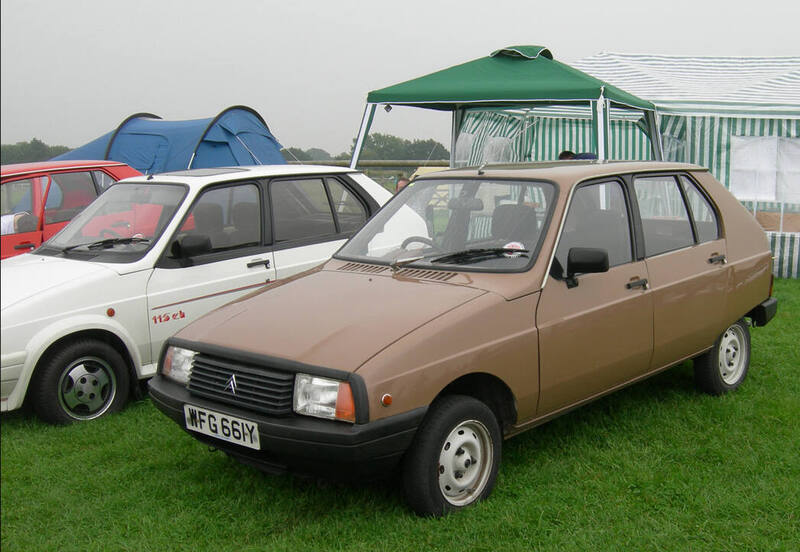

Billy - Medhurst Posted December 23, 2019 Posted December 23, 2019 How long before its like this again?. Coprolalia, Burnside, Lankytim and 3 others 5 1
Lankytim Posted December 23, 2019 Author Posted December 23, 2019 Not long I hope.... where did you find that pic?
Billy - Medhurst Posted December 24, 2019 Posted December 24, 2019 1 hour ago, Lankytim said: Not long I hope.... where did you find that pic? https://www.tapatalk.com/groups/visaforum/how-many-uk-visa-are-left-t1021.html Lankytim 1
Six-cylinder Posted December 24, 2019 Posted December 24, 2019 I could only find one photo of it I have taken myself and that was 2008 at Stratford-upon-Avon Race Course. I owned a powerful Visa 10E at the time. Shame you don't live closer or you could borrow bits from my white one until you found the fault. egg, Lankytim, Sudsprint and 1 other 4
