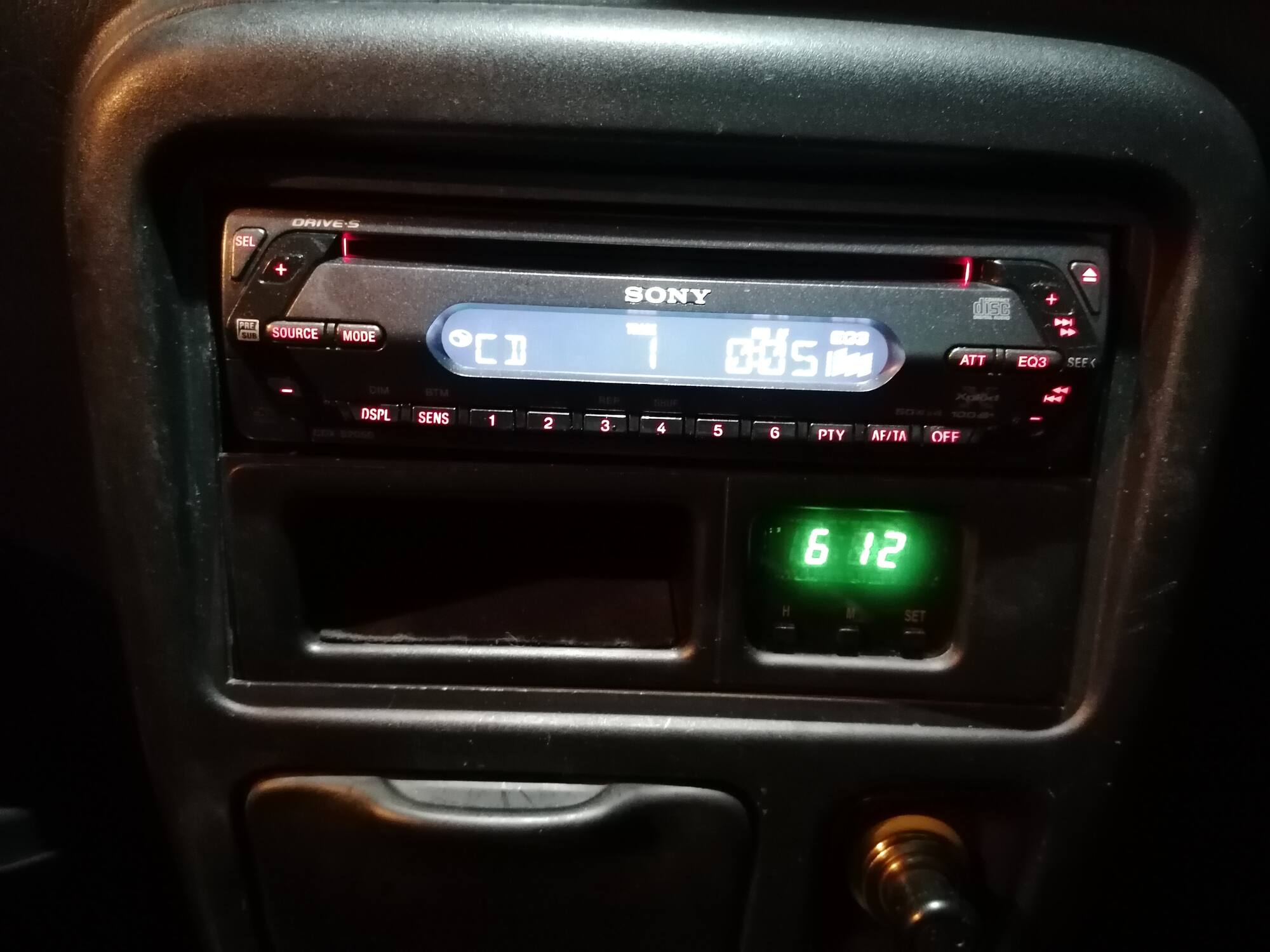

New* CD player, thanks to @Wingz123
It's the same as the old one, so I've kept the old fascia, as I prefer black.
Apart from accidentally putting the original one back in by mistake first of all, it all works fine.
Although, it won't keep time or stations, have I done something wrong?
I assume it needs a permanent "Live" to keep its memory.
May have mixed the live connections up. There's an ignition live and a permanent live.
Sent from my TA-1012 using Tapatalk
It's usually the red and yellow wires that need swapping around.
Oddly enough, the old one was fine, but had to be manually turned off as the ignition had no effect on it.
I thought it was quite annoying, but this one is the opposite...

I'm afraid I havent had this in my car since 2009? And even then I didnt have it in there for long. It was taken out and stored in the kitchen cupboard.....not sure on settings etc I'm afraid sorry.

yer the old one would have been wired to the permanent live then sans ignition wire, swap the yellow and red wires round to restore your previous state

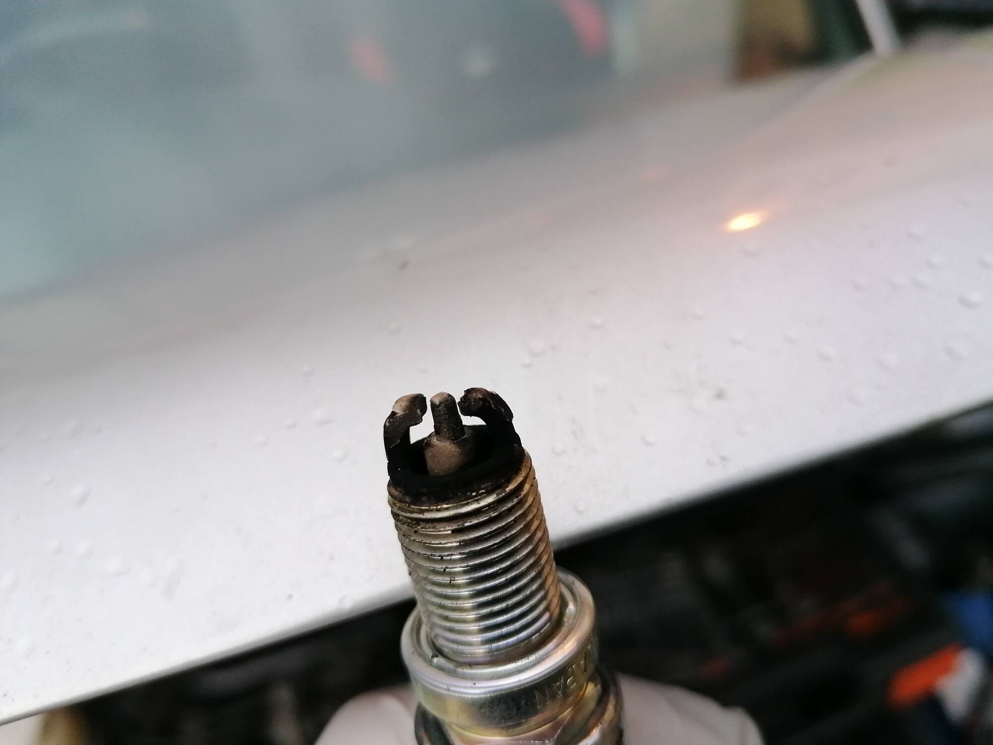

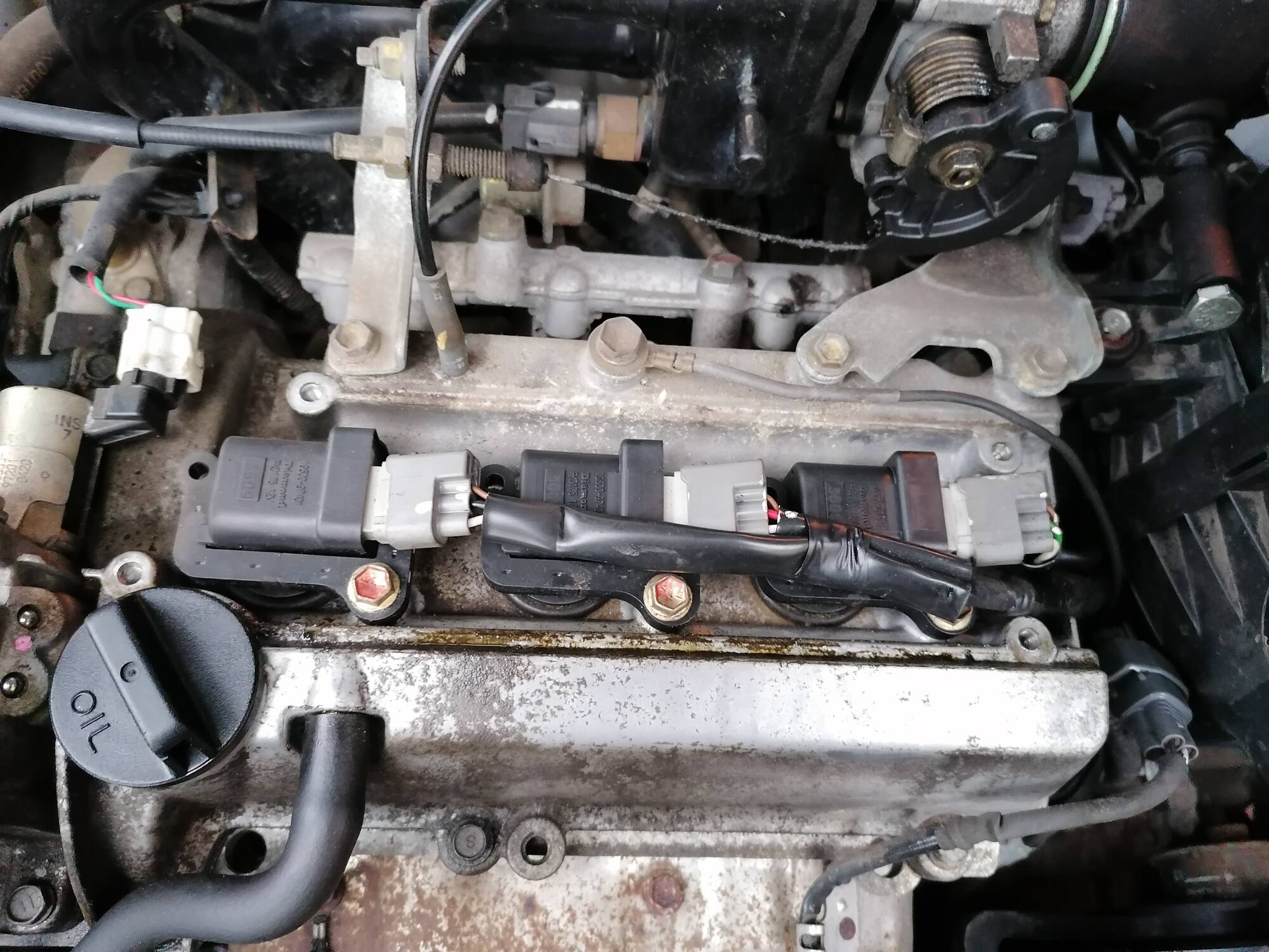

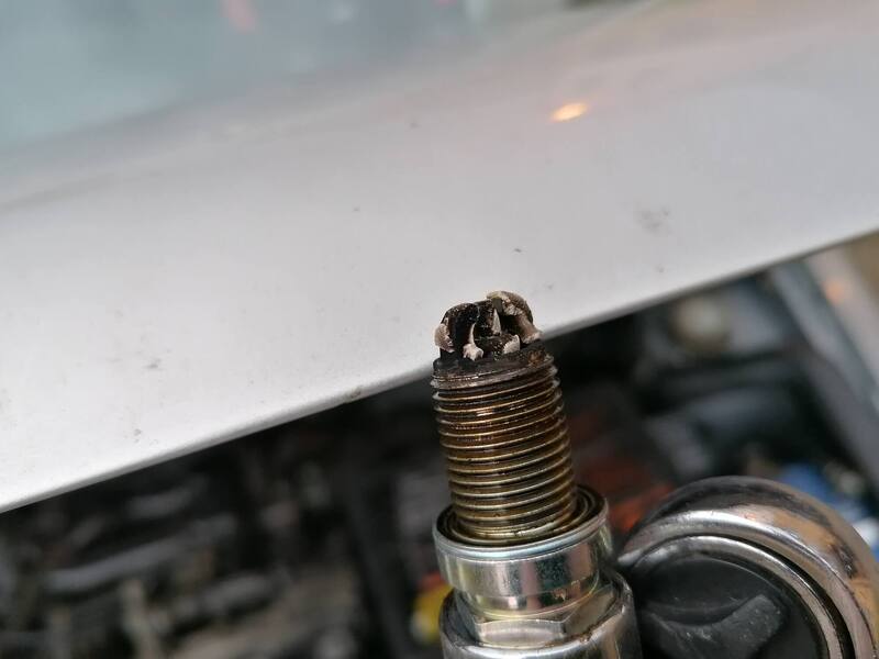

Changed the plugs.
Seems not a moment too soon, judging by the state of the old ones.
Are you burning any oil?
No idea. It does consume oil, but I think more through a leak than burning it. No suspicious smoking that I've noticed.
