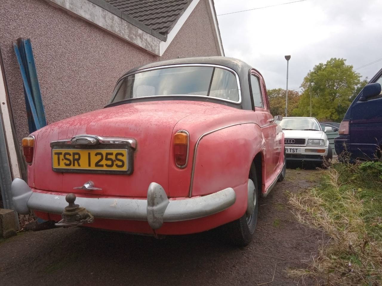

Late registration madness!
Must relate to it being imported back in 1978 from Malaya. Id be tempted to leave it as it tells its unique story much more than a faceless 179YUN type plate that the DVLA would dish out to replace it.
I agree 100%.
️ Post 1968 style raised digit plate
️ Black roof
️ Towbar
️ Patinated paint
️ Autoshiteist previous owner in 1978
️ Rover Owners Club Chairman
I absolutely love the way that looks and 100% agree with @HMC
Enjoy!
Cheers SP, you can understand why I fell in love after commuting past her every day!

I don't own a Suzuki TSR125 but if I did then I would be BATTERING YOUR DOOR DOWN until you sold me that number plate.  Great collection story would read again.
A 1960s car with a 1970s reg and painted with 90s Vauxhall paint by the looks of it...
The towbar, paint and mismatched driving lights make this prime adulterated Shite. I love it.
  • Agree 1
Was red in 1978 according to the docs, I'm just in from washing it and there's red under the black roof too...
Great another P4.
It'll get under your skin, really charming to waft around in, and lovely to work on.
We should have an AS P4 gathering some time!
PS, what's going on with that towbar, looks complicated?

@TrabbieRonnie Awesome swappage! as others say, dont change a thing! :) Do not Paint, Do not Re-register LOL, its so perfectly Autoshite! very much still has that 1970's beater vibe to it, no ones bothered to try and tart it up with naff looking wrong-font Silver on black plates etc!
I would love to know what its story is, how did it manage to get repatriated in 1978, when surely a Rover P4 was probably worthless?
very much looking forward to seeing more on it :)
Yes, the careworn look is partly what attracted me to this fine motor, I will try and protect the current patina.  Maybe next year I'll have to sort something out paint-wise, as there will be a few* localised* body repairs required...
All I have as far as history goes is detailed above, gleaned from the heritage certificate and a dating letter from the Driver's Guild.
I will endeavour to speak to the previous owner (the one before my mate, pretty sure they're fairly local), see if anything else can be added.  As has been said, the cost of transporting her back home must have been huge (unless some military transport shenanigans ensued of course!).

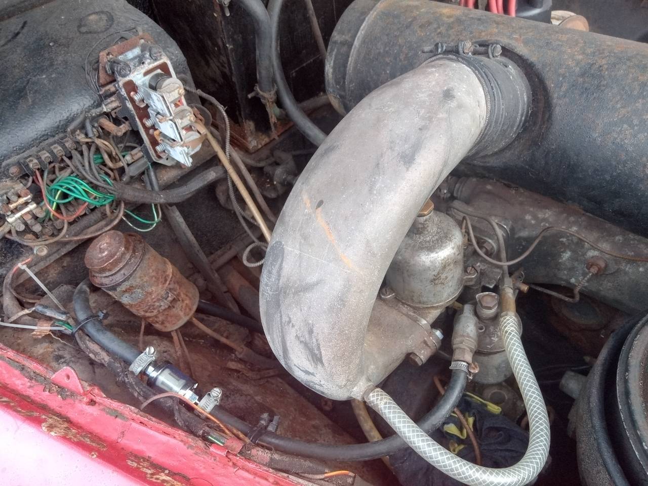

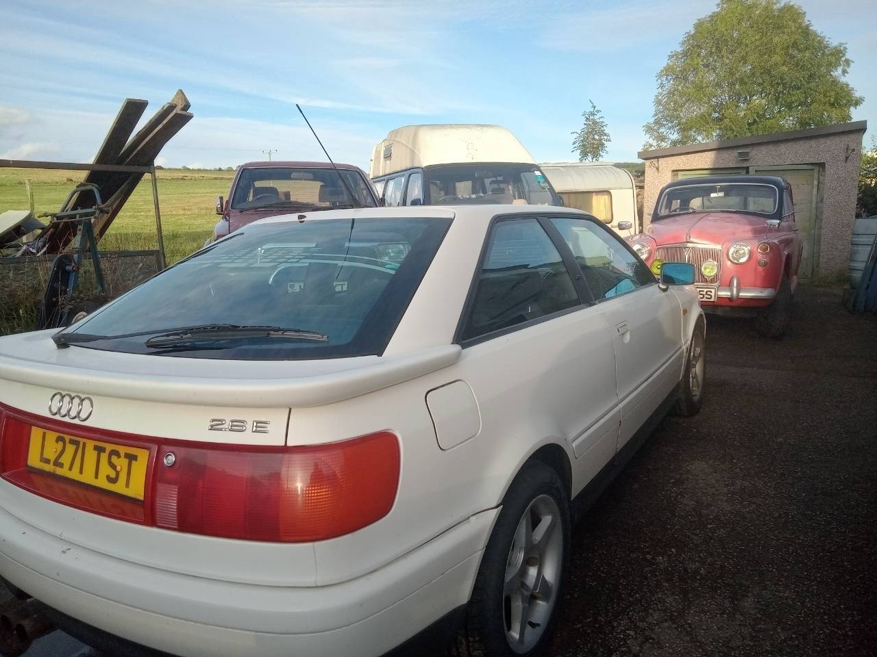

More tinkering with the old Rover, and more pictures for your delectation!
I have the rear end supported on axle stands at the moment, as I was freeing off the rear brakes (offside was really stuck).  Turned out to be the handbrake mechanism, there's a bit of slack in all the various bellcranks/rods, so it just doesn't come off that well.  Brakes were spotless though, good shoes and drums, and obviously been worked on recently with fresh grease where it should be.  Everything came apart easily, which I really wasn't expecting!
No pics of that, but have this one of Old Red with a couple of her new fleet-mates...
Getting this swap completed has been a good thing for me, the recovery truck was blocking a lot of access and just generally looked a bit shit.  A mental block has been overcome too, as it's the first time in ages I've let something go!  Next up is the wee caravan I think... it's the ultimate Trabant accessory but once a year to the local car show just isn't worth the scrubbing it takes.  I've cleaned it up a bit today (did imagine how well it would tow behind the P4), and I'm pretty sure it's time for it to go as well.
Anyway, back to the Rover.  While the wheels were off, I decided to check the brakes were free by running the car through the gears.  Seems that some of the grumbling apparent on my aborted test drive the other day is due to a drive line problem.
As the clutch is released and drive taken up, a rumble occurs.  It's felt through the body of the car (not the clutch pedal), and has put me off driving until I've identified the problem.  It's the same in every gear, just gets faster in line with  increased speed.
I've had a quick grab of my propshaft (ooh, err...), and can't feel much axial play at the uj's, although there's a fair amount of backlash in the diff.  Oils to be drained at both ends methinks, see what's breaking down.  I'll grease all the uj's too, but it's bad enough that I don't think it'll help.
Here's some pics I took whilst lying half under the car, for some reason my phone has forgotten the one I took of the bit of rot I knew about before (the only serious bit I've found so far)... a hole in the sill underneath this dodgy looking wing bottom...
But it's small and easy I think, the wing itself could be less so!  More pics showing the generally excellent chassis condition...

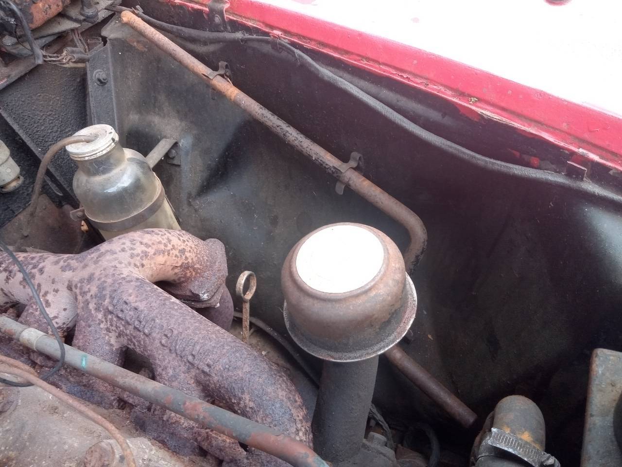

Assorted pics...
Opening quarter-lights are my new favourite thing...
Wipac 'Stainless' embossed on the glass...
Wood needs love, but is all there at least...
Engine...
Ignore my temporarily fitted Trabant ignition coil, I'm pretty sure her previous starting problems weren't a coil issue now as changing it did nothing, and they both tested the same on the Fluke.  Needs a tidy up...
Vacuum advance/retard adjuster wheel on distributor to allow for different octane fuels apparently...

Might be worth having a hunt for the missing cover for your regulator (top left), not ideal for that to be missing:
If you do have any charging issues that would be my first suspect!
Aye, I did hope it would be onboard somewhere but no!

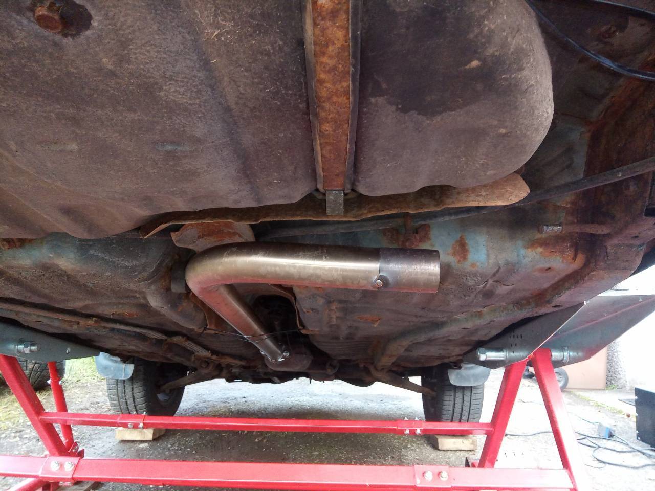

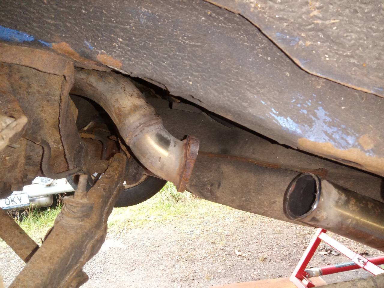

Decided the Mazda's bodged up exhaust had waited long enough, and dragged myself away from a certain pink P4...
Above is after the removal of the old exhaust, and I'd started cutting and welding the second-hand stainless Fiesta one I bought on Facebook.
They really are quite close, but a miss is as good as a mile and there's been a fair bit of cutting and shutting.
Here's the first bit bolted up to the cat, plenty of room in the tunnel (no resonator as yet, will see how 'fruity' this things going to sound!)...
Needed extending out sideways, so took a 3" straight section out from after the Fiesta cat...
Thought it would be wise to position the backbox at this point, it fits (just), but my hanger brackets are going to need to be quite precise!  I knew I was going to have to trim the tailpipe back... I'll cut the weld where it meets the box, shorten the tailpipe and re-weld in the same place, preserving the nicely finished end.
So I am left with this wee gap, always the hardest bit I find (in my vast experience of making exhausts, two... including this one!)...
However, this wee offcut from the Fiesta pipe looks like it will do the job...
That's where I've left it for tonight, getting cold out there by the end, should have cracked on a bit in the warmer weather!  Tomorrow should see it done though, and while it's all out for full welding, I'll task the 323's pilot with scrubbing and oiling up the undercarriage, as it's looking a bit orange under there.
Tomorrow also sees my first parts delivery for the Rover, so I could get its oil change done too if I'm on it...
Made decent progress on the 323 exhaust today, although unfortunately it's not finished due to the short dry spell I was given...
The wee twisty offcut did fit nicely, and I got 3 out of the four hangers mounted too.
After this everything came off and I got it all welded up fully.  It's fairly close where the pipe goes over the rear subframe, but you have to give it a fair old shove to get it to hit.  It must have been close with the standard set up tbh, there's not a big gap at all.
I chopped off the obsolete hangers on the 'new' system, which freed up some space, we'll see if I need to adjust after a test drive.  Like I say, there's more to do, namely trimming the length of the tail pipe so it doesn't jut out past the bumper.
In the fading light and worsening rain, I tidied up the tools and bolted the fully welded pipes back in... I wanted to hear it!  Surprisingly, given the lack of a resonator/centre silencer it's no louder at idle than standard, very quiet.  When revved up it does sound raspier, but not offensive.  Result!  That second-hand Janspeed stainless job has saved me a fortune, even over the cost of a new mild steel set-up.
Will get a drive-by video tomorrow when finished, and then I can get back to my lovely old Rover... parts for which have arrived today!
