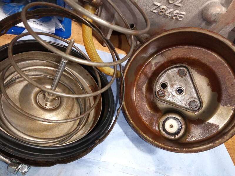

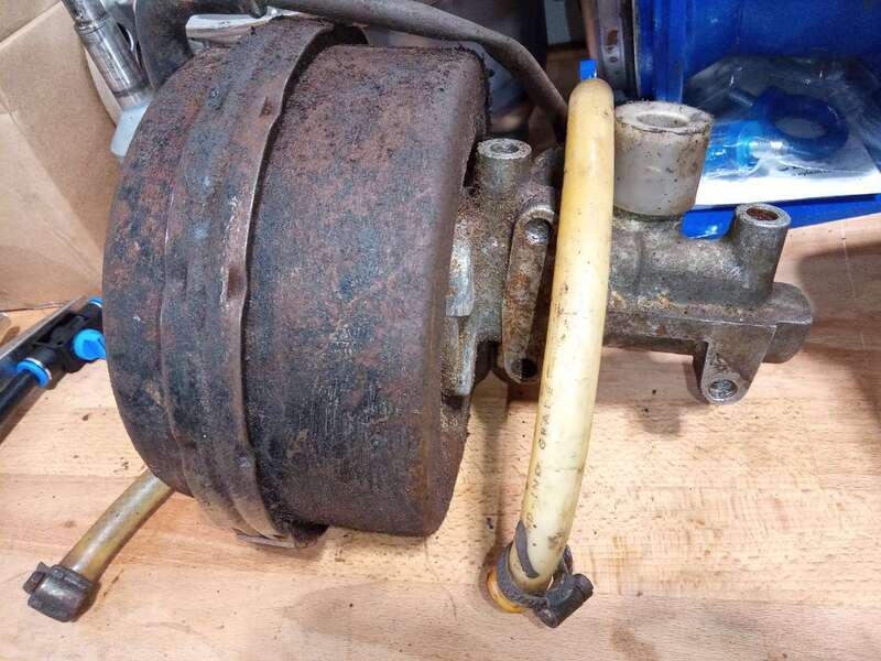

Well good news I think on the P4 servo front.  After stripping down and cleaning it, there doesn't seem to be much wrong in there amazingly.
There was a lot of brake fluid in the air/vacuum pot, so one of the seals in the piston housing must be passing, but the large diaphragm etc. is all intact.
This means I can try the £12 seal kit available, and hopefully retain my original Girling servo.  If I'd needed the whole kit, they seem to be around the £160 mark... bringing it closer to the £300 required for a brand-new Lockheed job.
Anyway, in pics...

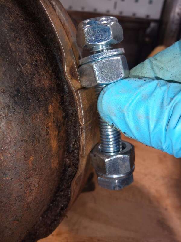

You can see there's a band clamp holding the two halves of the diaphragm chamber together, on mine this is welded/braised together with a wee steel pad at manufacture.  If you buy the whole seal kit, you get a new v-band clamp to replace this, as it will need to be cut off.
Never one to spend unnecessarily (except on an entirely too big fleet of old shite of course), I solutionised with the welder...
I'll clean it up a wee bit, but basically the clamp is now re-usable.
The innards were thus exposed...
Initially quite grim looking, but actually when cleaned up, nae bad!
So yeah, further disassembly of the piston/housing required to get at the five small seals within, followed (hopefully) by some power-assisted stopping once more.  If it works, £12 is a pretty good deal!  I couldn't believe how soft and supple (and whole) the rubber diaphragm still is after 65 years, made me wonder why we put up with such poor quality nowadays?!

That's the servo rebuilt (one snag though).  As you can see from the pics, t'was all a bit cruddy in there... I think my leaks stemmed from seals having to travel over rusty bits for the first time in maybe-a-very-long-time.
Quite a complicated wee beastie too.  The uppermost of the two pistons in the pic above is the control.  It was in a poor state, and almost trapped forever by the sealed plug just to the right of it.  This should just push out (nothing but o-ring stick-tion holds it in, as it cant get out when bolted up to the diaphragm assembly anyway), but it was wedged in there solidly.
It's eventual removal was a tough time for both of us...
My trusty drive-through screwdriver may* have seen some action.  This whole job has been a bit of a 'try and see' thing though, as I have the readily available Lockheed replacement servo to fall back on.  Hence the nonchalant butchery pictured.
I was however, able to re-use it... I ground off the damaged portion, and used M10 washers to take up the space and support the new o-ring.  A perfect fit, which was nice.
Everything else was cleaned up and re-sealed, before sticking it all back together.  This is not an easy process, getting the two spring-loaded halves of the diaphragm assembly held in position whilst attaching the clamping ring has left a few more grey hairs I fear.
I haven't any pics of the reassembly (too stressful), but right at the final furlong, I hit the aforementioned snag.
There's a pipe connecting the control piston port to the back side of the diaphragm, I assume to open it to atmosphere so that the thing can move forward using the vacuum supplied to the front.  This terminates on the metal casing in a very poorly designed rubber elbow, that relies on a connection to a plastic doodad on the inside.  Of course, at this point the rubber elbow disintegrated, 65 years is enough it seems.  It fell out, leaving the plastic doodad unsupported... if the diaphragm moved, it would fall in, disastrous as it would require re-splitting to solve!
It should just be a welded-on metal spigot pipe, allowing the easy connection of any rubber pipe with a clip.  Obviously.
Anyway, I managed to find a bit of clear plastic pipe in the shed, miraculously of the right bore.  When heated, it allowed itself to be pushed over the swage on the doodad, and even into a snug fit against the metal casing.  As it cooled, it has gripped hard, and the other end just slid over it's pipe perfectly.
This may need some silicon sealant-based help in operation, we'll see... seems alright just now though.

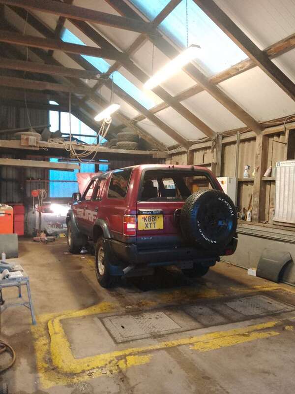

Well, the old Toyota passed with only a failed numberplate lamp!
Emissions were spotless, and she's running great.  We'll get a set of rear shocks I think, to complete the mechanical refresh.
Not bad at all, and nice for my youngest to have all his hard work rewarded.  The Surf is now road legal once again, and it's solid and repairable nature gives me hope that she'll soldier on for a good while yet.
Eleven years on the fleet, two cambelts and a lot of fun.  It's a great feeling passing it on to my lad, he loves it and I know it will provide many new adventures for him.

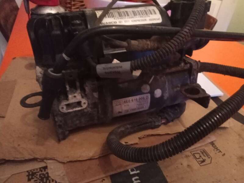

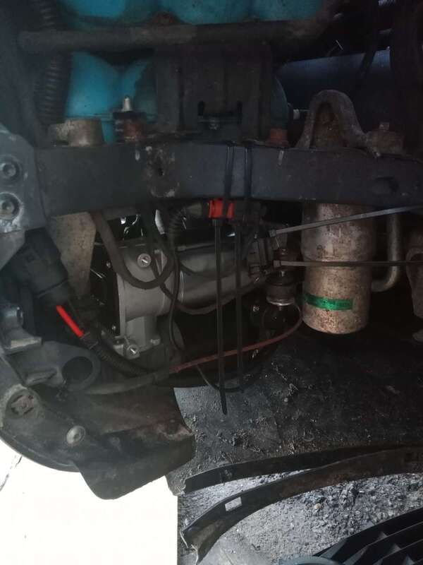

First and foremost, the suspension.  Air-powered on these, and the pump has been very slow to react during the recent cold spell (-16 at one point).  It does rise to the occasion eventually, but as the headlight aim is tied to the level sensors I thought I'd better sort it pre-test.
I had a seal kit in stock and so set about it...
Err... yeah, not in great nick.  I couldn't get the screws out I needed to, and the casting around them has literally blown apart with corrosion anyway.  Being as it was a bit of a faff to get out, I couldn't be arsed and ordered a new one.  Of course the good ones come from Germany (Aerosus), and so the car sat on axle stands for two weeks.

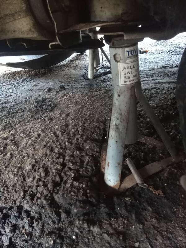

It's a heavy old thing, and my excellent* driveway surface started to lose the war...
Bugger.
Anyway, after some sweary time, the freshly arrived unit was installed...
Yes, a great many VAG clips were broken in the process, I did trim the tie-wraps after this!  Also, how much salt must they put down for my newish discs to look like that so fast?!
Everything is buttoned back up now, and a test drive confirmed much better up-and-downs (quiet and much quicker), and a lot smoother drive particularly in 'dynamic'.

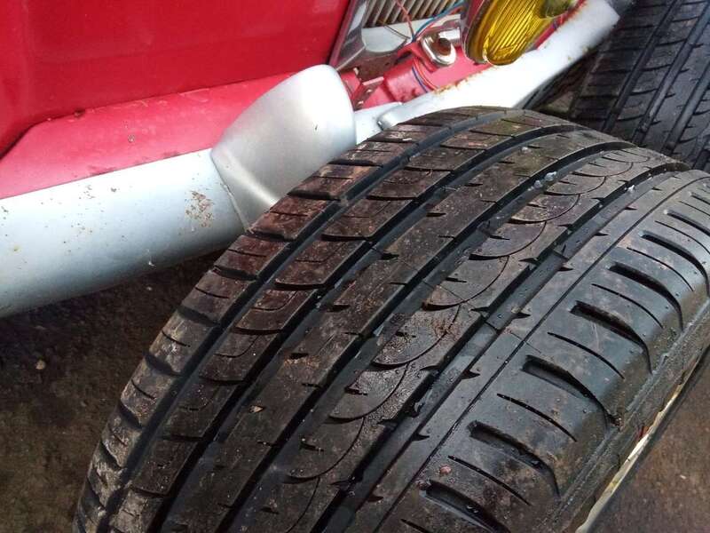

While the wheels were off, I handed them in to the garage for new tyres.  The Uniroyals are an excellent driving tyre, but the big Audi just chews them up.  I can't justify the cost again, so have bought Radars...
(Aunty Rover wondering when her new rubber is coming no doubt!)
My experience with this Singaporean brand has been limited to the Toyota Surf, after searching for a cheaper alternative to the BF Goodrich/General Grabber duopoly that seems to control the imperial size required there.  In America, I read that the Radars came with a 50,000 mile warranty!  Anyway, they were half the price and transformed the ride.
We'll see how they go on the A8, they feel great so far.  £70 a pop on Camskill, amazing price for this size, fingers crossed they last.

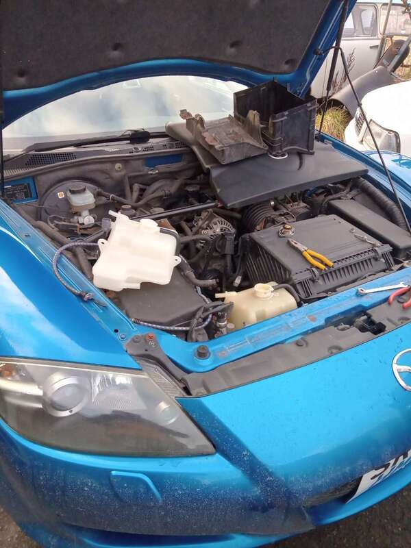

What better then, to decide (for some reason?!) to replace the RX8's slightly leaky, not-causing-any-problems-whatsover, expansion tank?
Things began well...

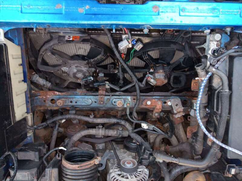

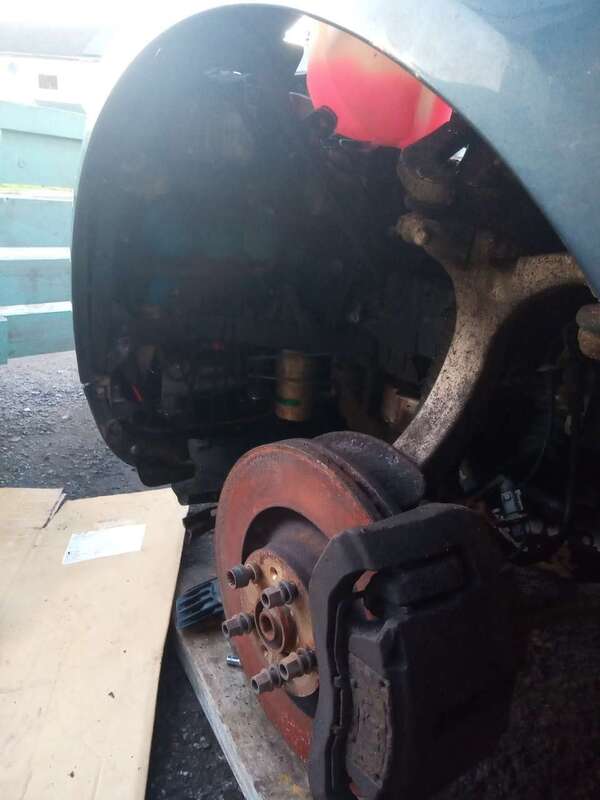

However, when removing the wee pipe 'twixt the bottom of the old tank and the rad, it came off in my hand... suddenly totally separate from the rad, who's pipe spigot had crumbled to plastic dust... oh good.
This of course means the radiator is coming out, and probably (thanks to it's plastic tank construction), un-repairable.
Hoping against hope that this unit could be replaced from above, I began undoing nuts and  pipe clamps, and breaking clips as per normal...
Sadly, it turns out you cannot remove the fan pack or radiator from the top, no matter how much you cut your knuckles up, or how much you curse the feckin' thing.
It would have come up, I think, if there wasn't an air-conditioning pipe in the way... Of course, thinks I, simply removing a mounting bolt would allow enough wiggle room?  It wasn't a mounting bolt though, it was a joint... what fun!  The sudden blast of R134 resulted in a mild heart attack, burny fingers, and now inoperative climate control too!
So tomorrow will see the jacking up, supporting on axle stands and a few hours lying on the stone cold ground.  All while avoiding the inevitable old-car drizzle of rust and coolant.
Fantastic... why do we bother, should have stayed on the couch with the dog.
Jacked up on stands, the all-too-familiar bootful of parts...
...can only mean progress!

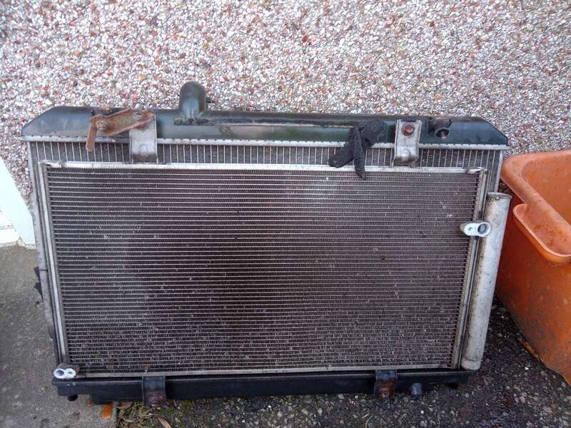

The radiator is indeed removed, meaning I can fit the newly arrived eBay replacement.  Pretty easy removal from below, although I couldn't see how it would have come out without breaking into the aircon lines anyway.
The aircon rad is bolted directly to the front of the main rad, which has got me wondering whether or not I should refit it...  It must impede airflow, and I don't have a great need for aircon thanks to the huge distance between us and the equator...  Knowing hot hot everything gets under there (by design, admittedly), and the car's fairly advanced age, a bit of extra cooling can't be a bad thing?  It is always a shame to lose a working feature, I'm not sure.
Anyway, I'll do the usual rust prevention stuff while everything's out the road, and fit it all back together over the next few days.  Working weekends for me unfortunately, which gets in the way somewhat.

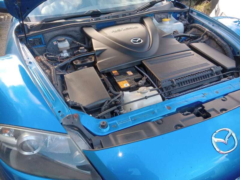

Got the new rad and expansion tank fitted up yesterday, after a wee bit of corrosion prevention work before that.
Mmmm... shiny.
Everything else got a clean up as it went back in, so the whole bay looks a wee bit more loved too...
I don't know why that matters but it seems to!

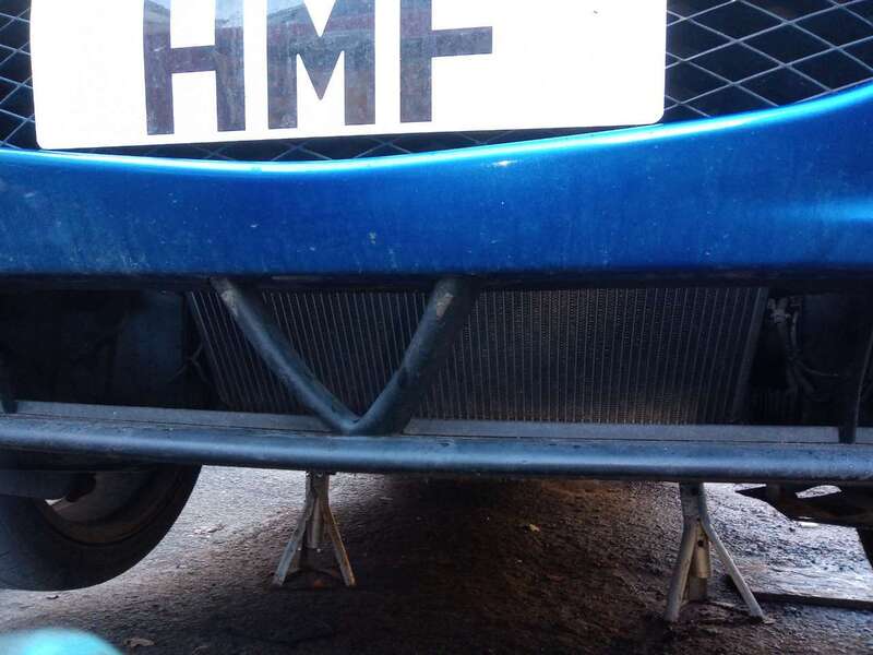

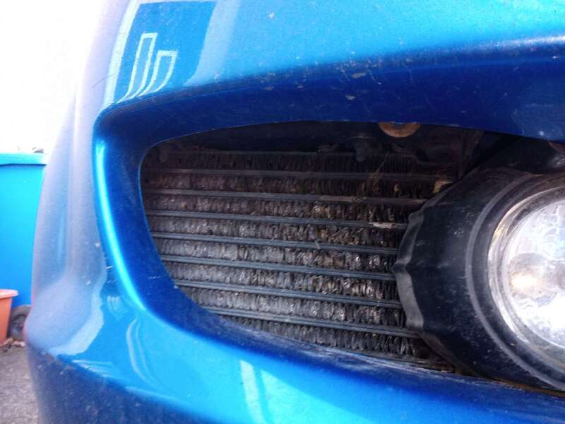

In a shocking* move, I didn't refit the Aircon radiator or the pipework to it.  In fact, I also removed the belt and idler pulley to the compressor for many* extra geegees.  This 'mod' is of course to allow extra cooling, and not because I couldn't be arsed...
Anyway, behold the racecar style cooling setup...
I'm sure this is good for cooling, but it does seem a tad vulnerable... the oil coolers have certainly paid a high price for being unprotected...
I've said it before, but will have to source some grilles methinks.
Anyway, she's had a wash and a test run, and drives just like she should (back tyres aren't going to last long!).  No leaks or bubbling when home, so I'll call that a fix, until next time!

Well the old jeep's definitely in good hands with my youngest shiter...
He's spent the day painting the wheels black, which we like around here... looks tough and is easy to touch in.
It's also running like an absolute dream, it always liked regular miles.
It gets a lot of attention these days, I hear it's quite the Instagram star!  There's a fairly good 'retro' car scene locally, with a few young guys starting to save and run the old stuff.  Great to know for me, as it means help is never far away if needed out on the road.

Had a tinker on Old Red today, very agreeable with the sun on my back.  My scruffy but lovely 1959 P4 inches closer to the highway.
As regular readers may remember, I had held off refitting my 'reconditioned' servo until I'd had a look at the dynamo... today was dynamo day.
Here it isn't...
Bit of pink coolant weep visible down around the water pump, but I think it's come from that dodgy old hose at the the top.
And here it is...
Non-original reconditioned unit from Lucas, at this point I was gingerly trying to undo the second long bolt holding it all together.  T'was a bit reluctant, and I had the fear... could easily shear these methinks.  The shaft itself turned with a squeak, and was pretty stiff too.  Not good.
Anyway, it all came apart in the end...
Very heavy and rugged feeling, but pretty grotty.  The brushes looked good though, loads left on them.  I cleaned up the commutator ring with a scotch pad, so it looked nice and shiny(ish), and gave everything else a brush up.
When all back together, it looked a bit more like somebody owned it, but not much.  Will give everything under the bonnet a lick of paint in the end.
For my efforts, I have been rewarded with a very smooth turning and silent unit, and  MUCHO VOLTS.
Ten minutes saw it back in its home, and the old Rover fired up smoothly as always... after a couple of months sitting, which is impressive.  I am now getting a hefty 17 volts at the dynamo with any revs, so I can't believe there's much wrong with it.  Also, the volts are the right way round, so I think it has been flashed over to negative earth at some point.

After tackling the Rover's dynamo, the Surf decided it needed some electrical attention... it too stopped replenishing it's electrons, leading to a non-start! (first one in ten years on the fleet I think!)...
Either the regulator or brush pack had given up the ghost, as you can see above the brushes we're worn down pretty well by the 230,000 klicks the old girl has covered in her 33 years.
Replacement from eBay (£40), and all is well again, which is lucky as the alternator itself includes the vacuum pump and isn't cheap!
Anyway, it's servicing time here at Trabbi Towers, so next up was my pocket rocket RX8.  It's been putting in some miles, and running well after the header tank & rad change.
However...
Muggins here decided to change the HT leads.  If you remember, about a year ago, I had a misfire in this wee beastie, which turned out to be a vaporised lead-to-plug connection.  The replacement lead was an old BMW one I'd had in the garage for years, which worked but looked weird.
Anyway, the above pic is of the coil at the other end of that same lead... there again was just a blown-out mess of plastic and metallic dust where the connection should be!  This time, the car was running fine though, strange.
I was panicking a wee bit here, thinking I'd turned runner into non-runner again, but managed to cobble something together...
Yes dear reader, that is an old Rover P4 dizzy cap, that has given up it's innards to form my new No.2 Rotor ignition coil connector.  I'm not proud, but it is working!
In fact, it's working better than ever tbh... The engine has always been a smooth one, but now it's incredibly so.  Under bonnet noise at idle is minimal, and the idle is slightly higher now.  On the road, by christ there's even more power!  During a max-attack acceleration, I used to change up into fourth at 90, now it's the ton before the beep arrives...  She feels freer and stronger, maybe the fuel economy will even improve?!
These engines have two plugs per rotor, a leading and trailing one that fires slightly behind it, to ensure full combustion apparently.  It was the leading one that had failed, good to know it's robust enough to manage with 3/4 sparkles!
Oil and filter change followed that without any hiccups, so now I can enjoy the newly discovered power guilt-free too.
I will now start researching replacement coils I think.  Those fitted are genuine Mazda ones, and are second-generation too, as that part number only came into production a few years after my car.  Somebody must've loved it enough to change them all at the recommended 30,000 mile interval.
I'm now nearing 60,000, so as they're looking a bit worse for wear (one of them anyway), I better have some in.  It's only money!
Cheers all.
Oh, and after not even one month, my new shiny radiator has already picked up some damage...
...need to either fashion a grille or reduce average velocity maybe?!
