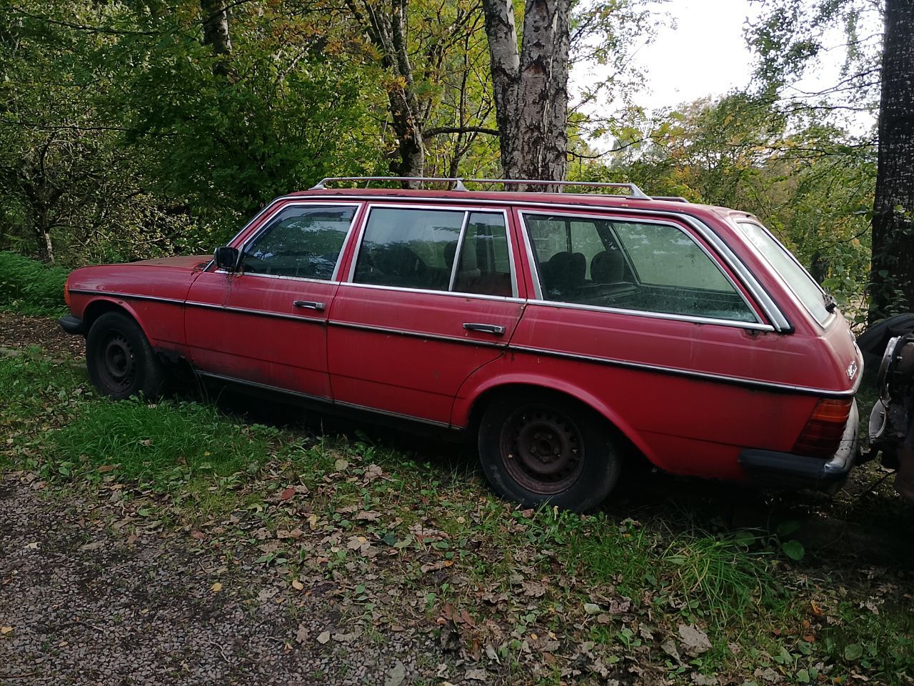

Well well,
The vehicle has been thoroughly* checked over, it's faults catalogued and carefully* weighed up... and a decision on its future made.
Next up in my emporium of faded automotive jewels then, is this grand old fraulien...

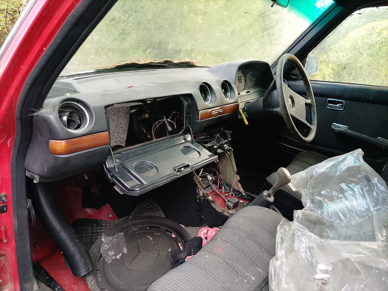

A 1985 2.4 Diesel example.  She runs, idles even(!), although is currently not very driveable due to the clutch being welded to the flywheel.
The front wing bottoms have left the building, and behind them isn't looking too clever either...  Sills seem solid from there back though, and as promised the floorpan looks bootiful.  Inner wings and strut tops ok, and I was quite pleased with the rear arches.
More concerning is the rust patches on the upper surfaces (under rear side windows, wee bits on the roof etc.), but I'm growing in confidence these days, and will get them sorted once she's whole again where it matters.
Interior seemed to be all there, just not all in the right place!

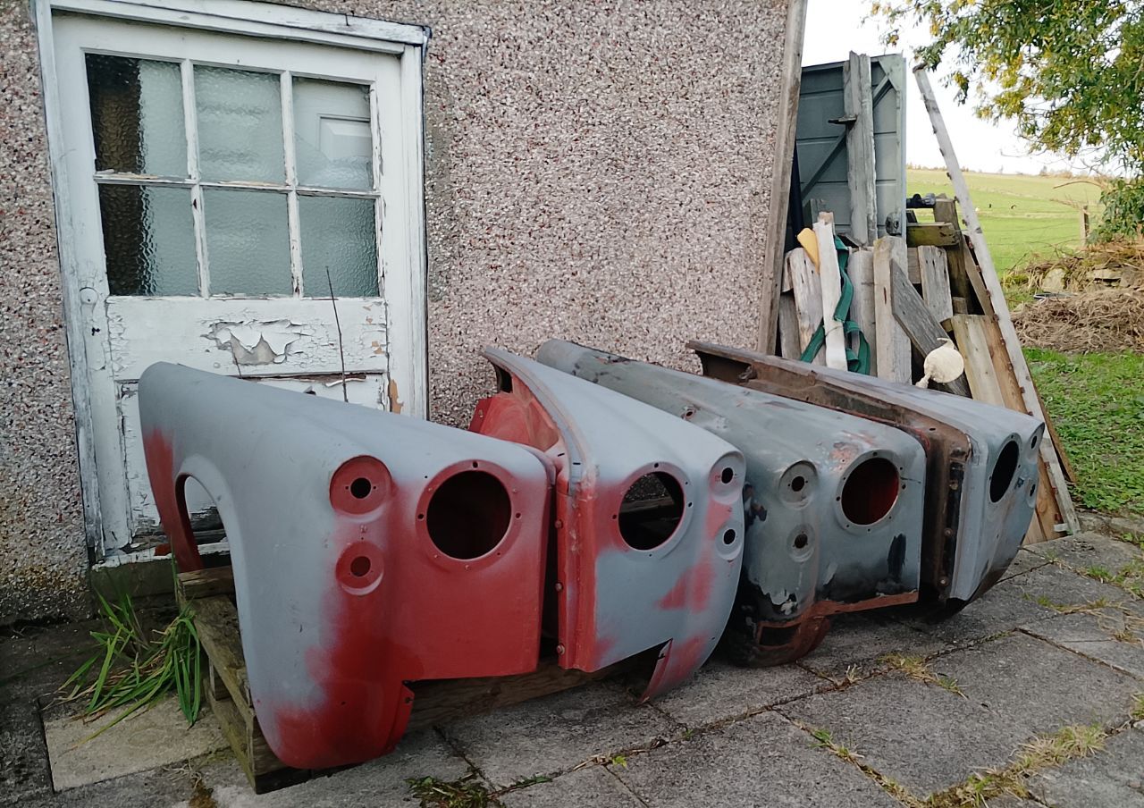

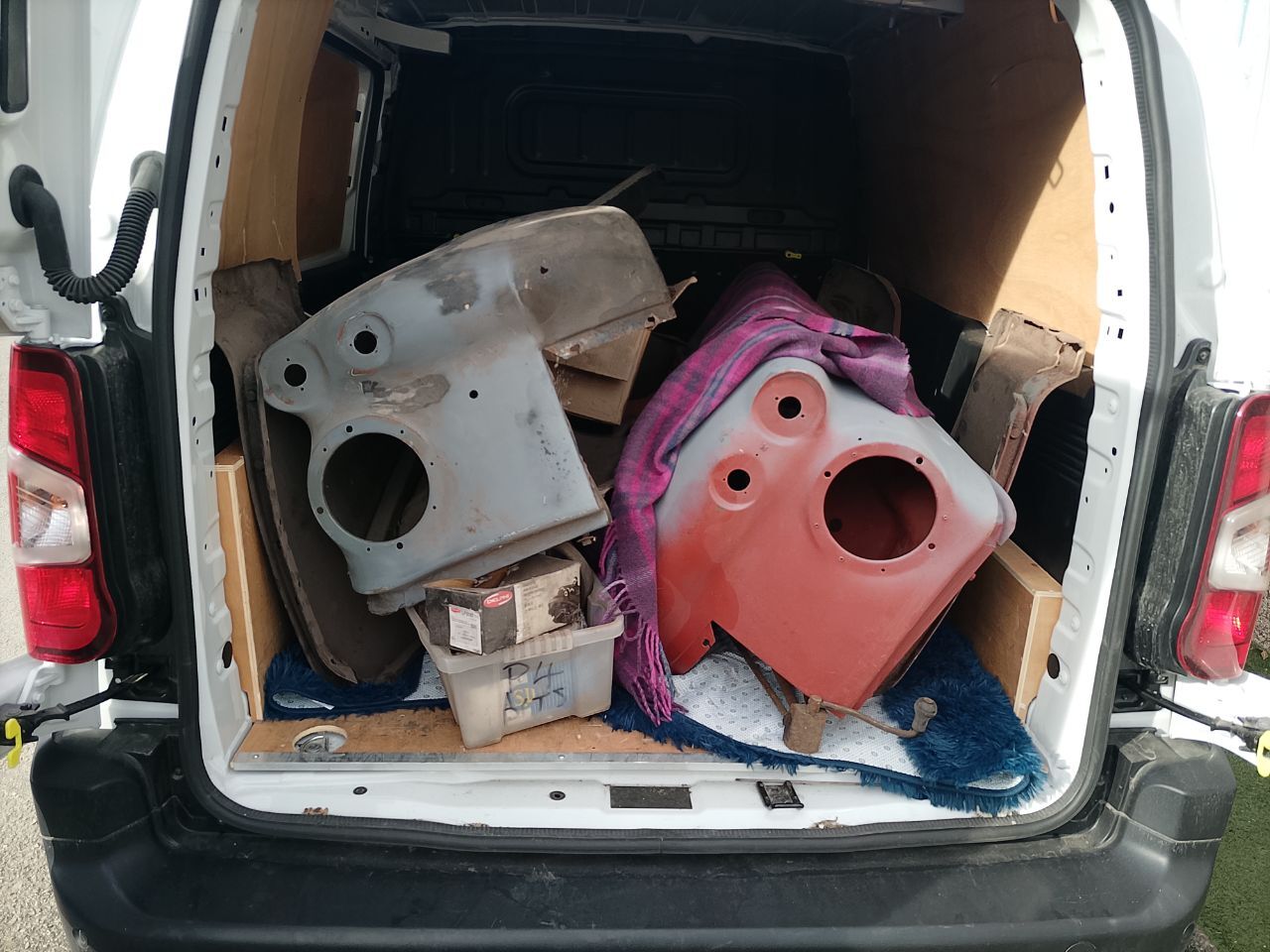

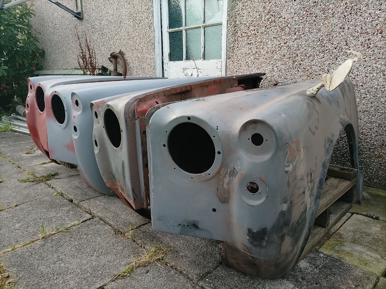

That's us back from a collection mission of sorts, I have mucho Rover P4 goodness after a very enjoyable trip south to the wilds of Forfar...
Tucked away in there are two pairs of front wings, and some of the odds and sods genuine car guys seem to keep labelled in tubs for the next fella!
One pair (in the red oxide), are basically as perfect as you're ever going to get at this point in time,  and even the poorer set is eleventy-million percent better than what's on just now...  One very happy Ronnie here!

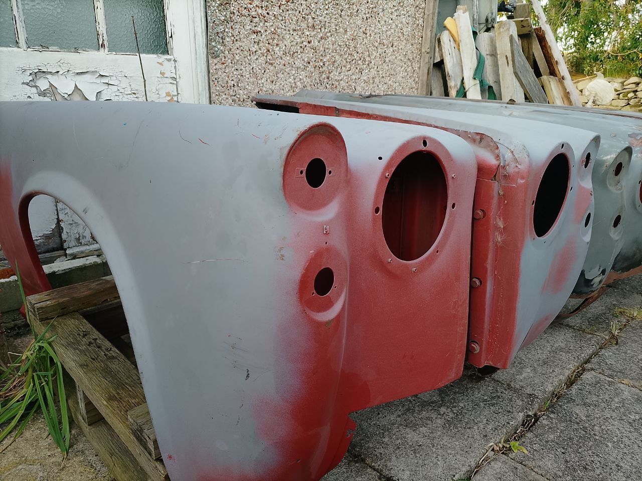

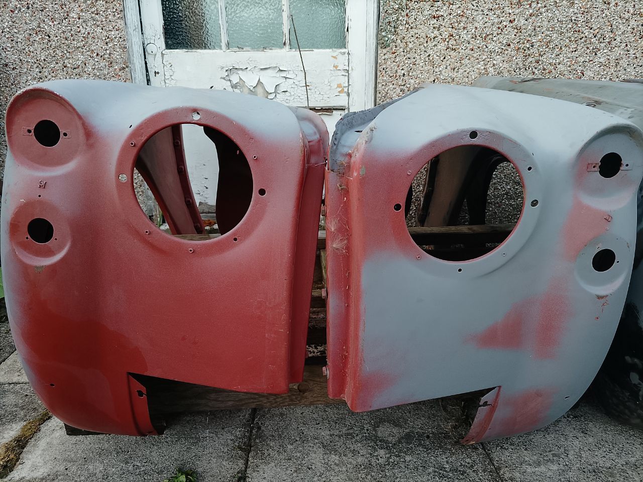

Now unloaded for inspection...
Can't quite believe my luck here... the indicator and sidelight mounts are so good on both sets, I was worried about being able to recreate them in my original ones, which are very corroded.
The grey/black set have been chopped about around the bumper mounts a wee bit, and they don't have any drillings for the chrome strip I notice.  This could mean they're off a smaller engined model I think?
Anyway, it means I can practice my coach enamel painting skills on these before attacking the rest of the body too.

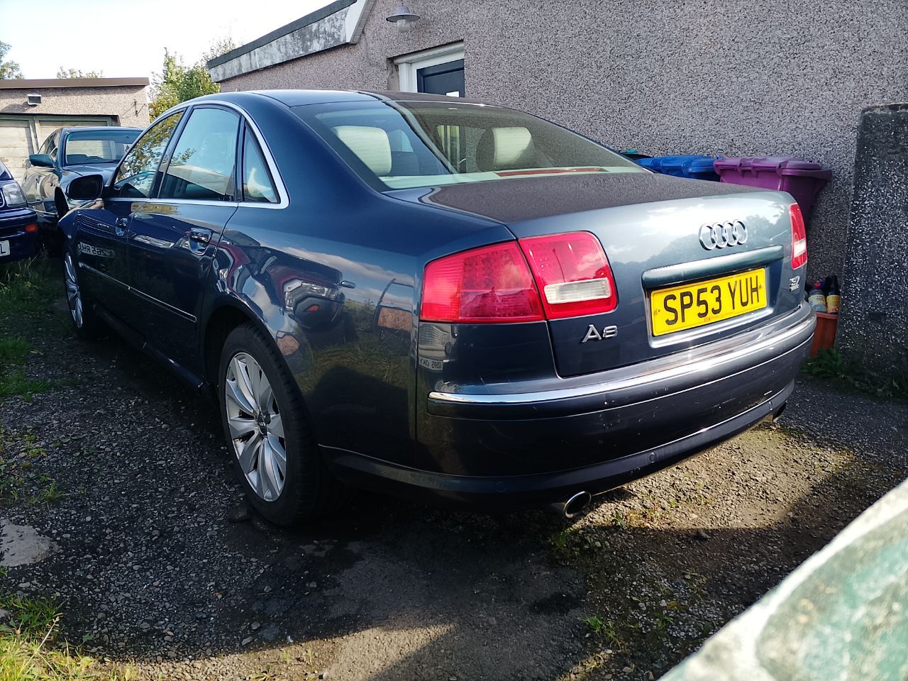

Well, some jobs completed on the big Audi, just in time for another epic voyage south tomorrow...

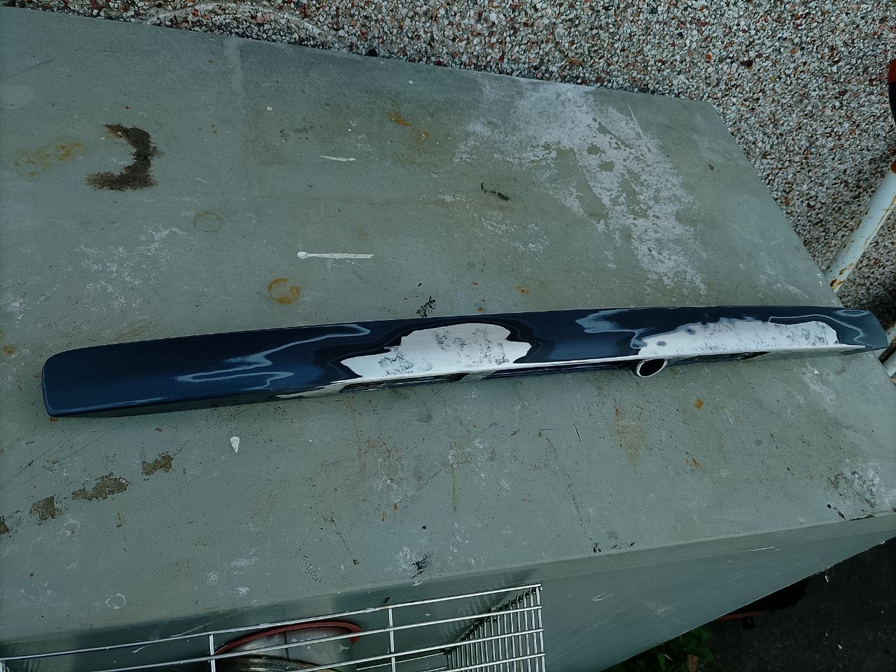

The boot handle has been off for a rub down and repaint, as the aluminium was bubbling quite badly and letting the side down.
Rubbed down, filled and rubbed down again, it got a coat of etch primer followed by some galvy zinc.  Another light rub down before the top coat which I left alone for a couple of days to make sure it would be hardened off for refitting all the bits and bobs.
I tidied up and lubed the boot handle innards, which now feels so much nicer to use, and fitted my new Amazon universal number plate lights.
All back on the car, the colour match isn't too bad, there's a bit more green in it than the original (which goes quite purply in strong light).  However, it's ok and a lot better just for being smooth.
I cleaned and lubed the boot hinges too, it's actually popping up a bit easier too.  A wash and polish, fluid check, and she'll be packed shortly for a 500-mile jaunt to Buckinghamshire tomorrow.
