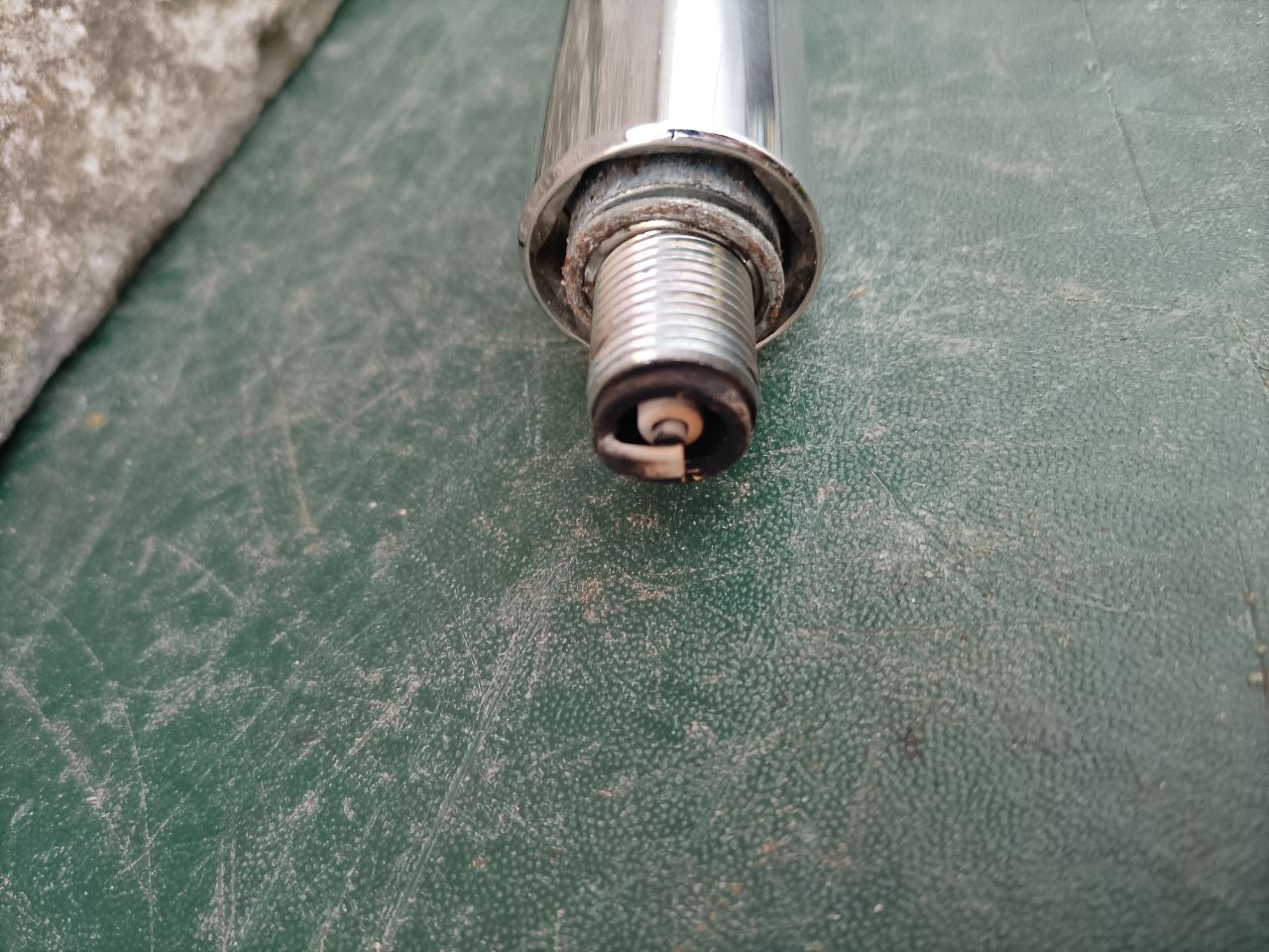

Pulled a plug to check t'mixture...
Seems ok to me, I'll keep an eye in case it veers towards lean?

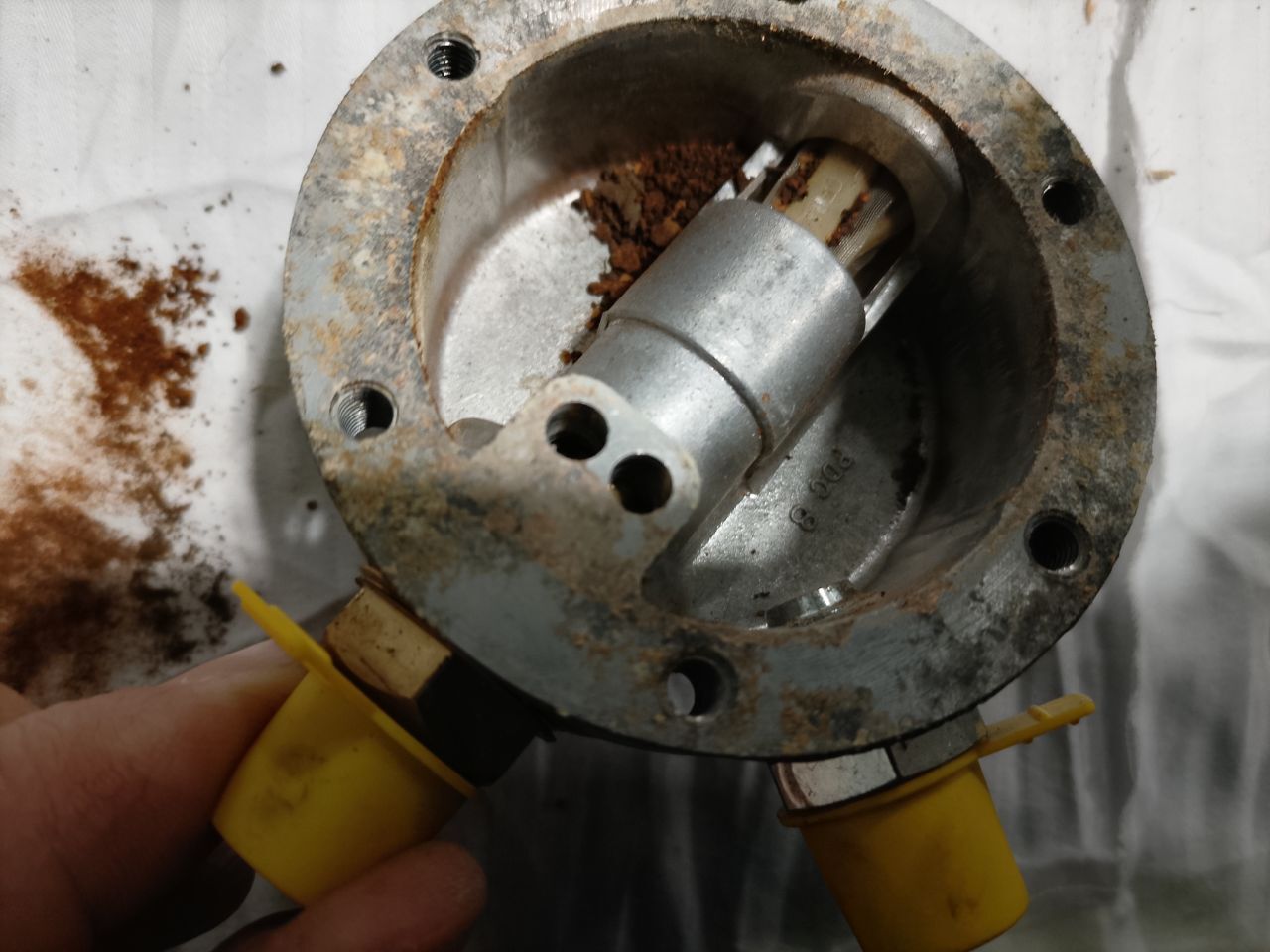

Then I turned my attention to the fuel filter...
Still pulling a lot of rust up then...!  It's very small particles now, but obviously the electrolysis didn't get everything.  A very small amount had made it through to the float bowl, so that's all been cleaned and blown out.

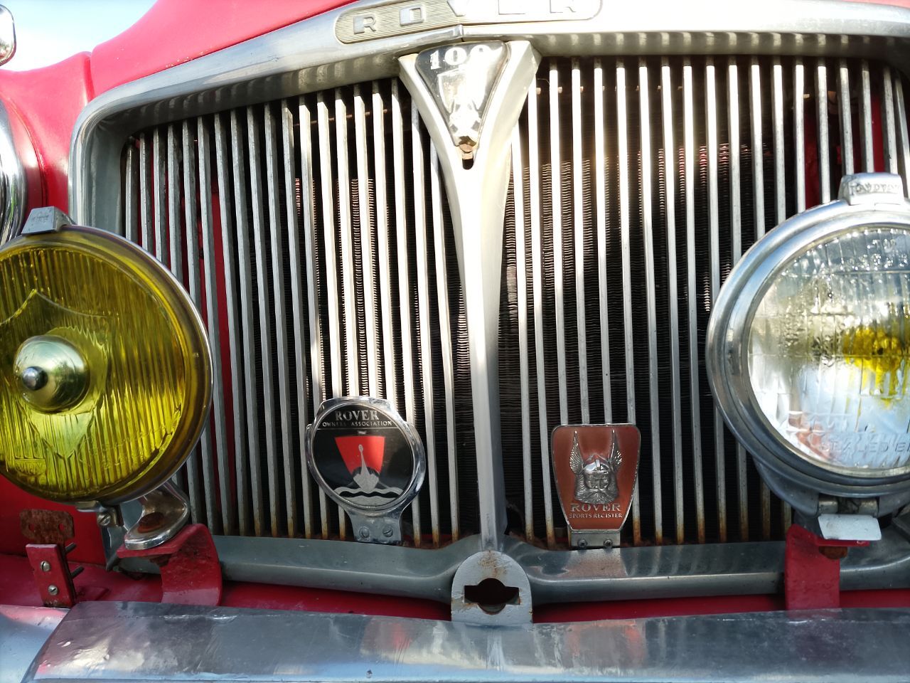

My pal with the Rover 75 discovered the badge pictured below in his boot, and I swapped him a couple of drams of the local brew for it.  Fitted today...
That reminds me I need to fix or replace my '100' grille emblem!

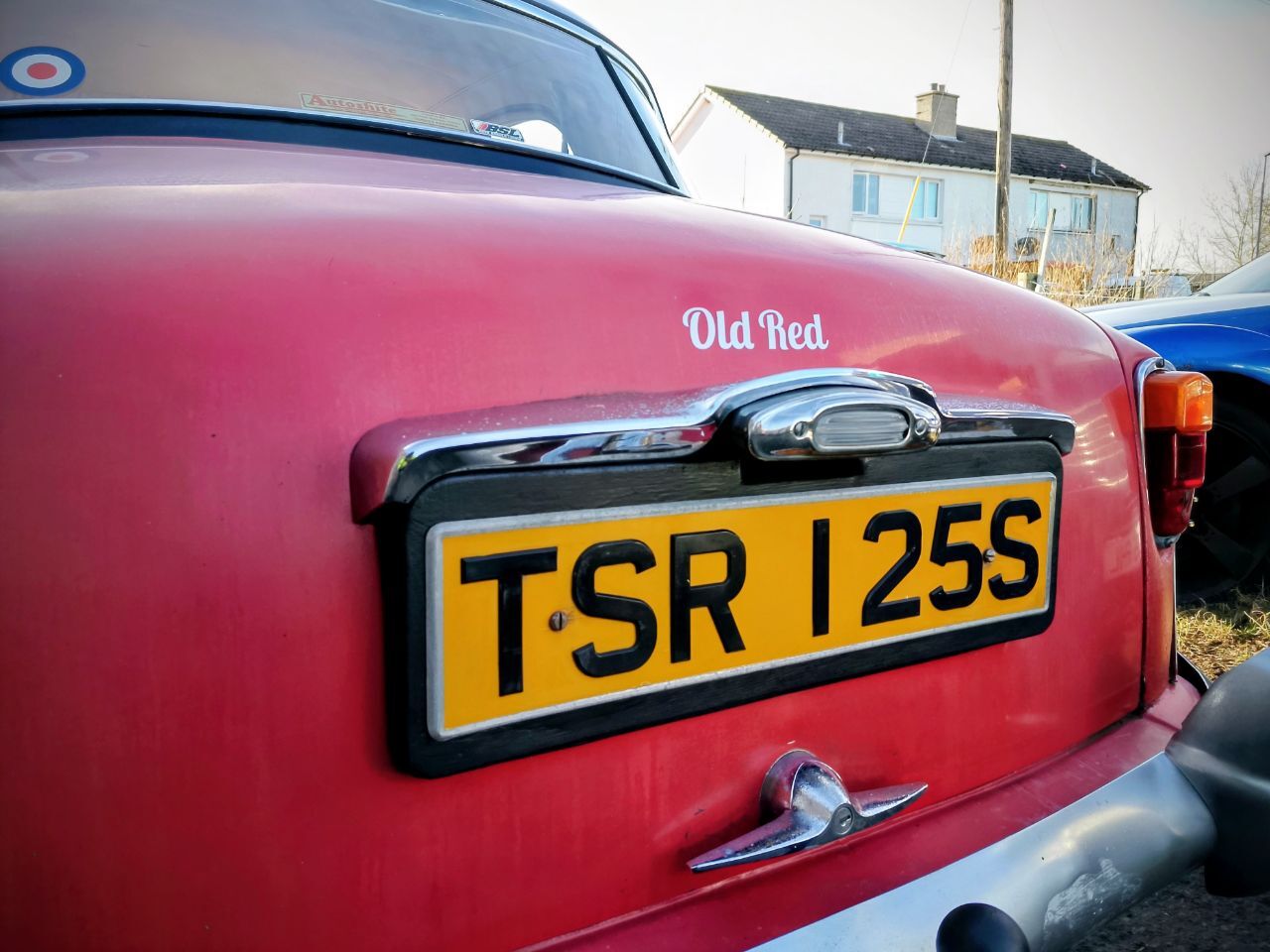

I then removed the rear numberplate for a clean up and repaint of its surround...
Really looking forward to getting stuck in to the bodywork now.  I have the paint etc. in stock, and am going to erect the old campervan awning as a makeshift booth.  Just a few other jobs in the way first (currently refurbing my old trailer, so I can knock down and get rid of an old lean-to, which would be blocked by the Rover during painting).

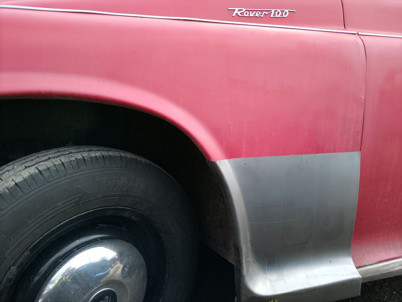

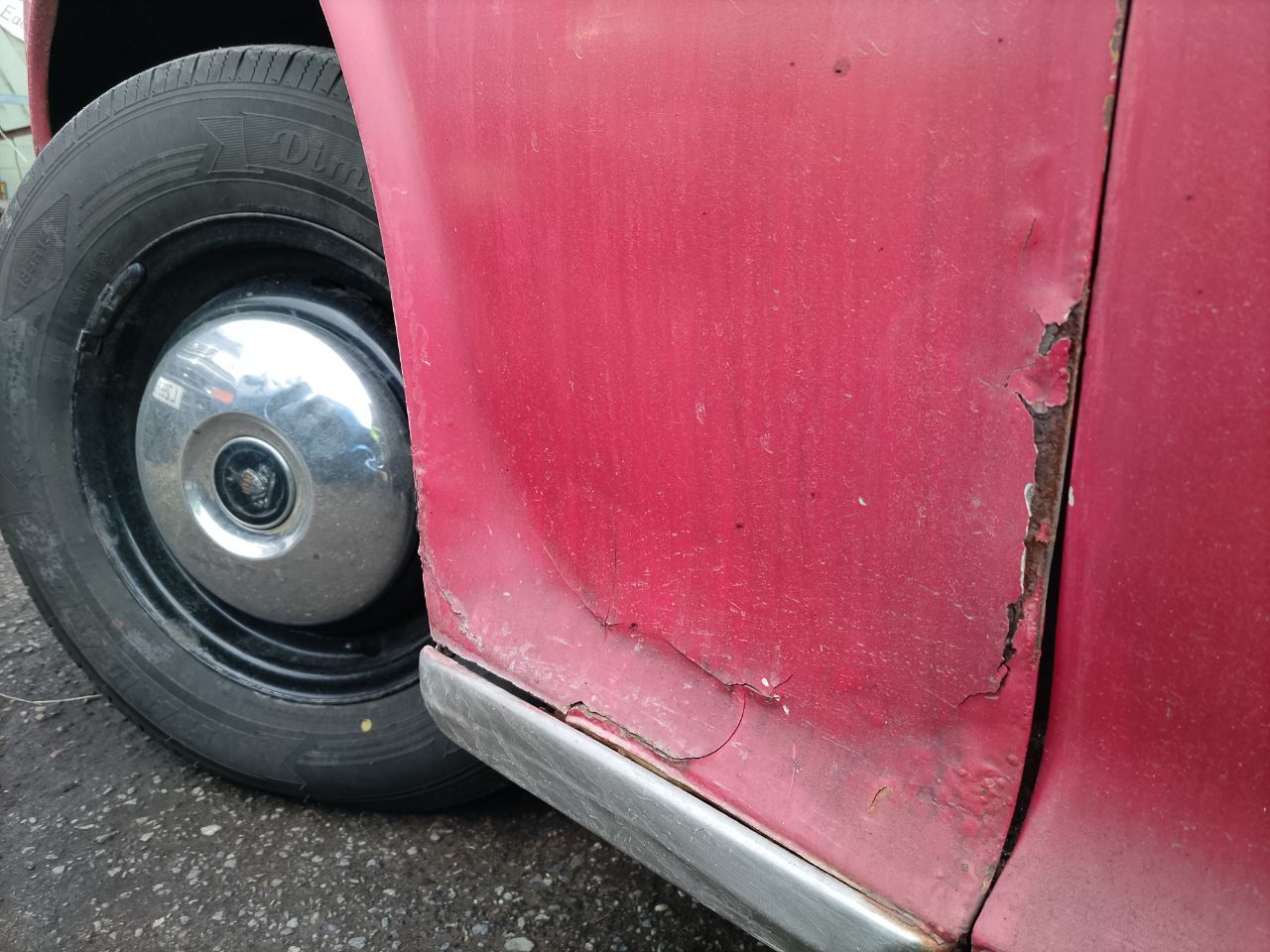

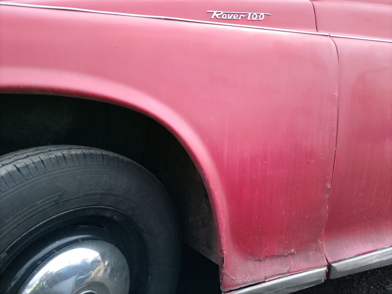

Well, I'm up to my eyes in welding my old trailer, but I've had a delivery...
This lower wing is the only really bad bit of bodywork on the old P4, and I know as soon as I 'investigate' it I'll be left with a gaping hole.IMG_20260314_144458.jpg.00c6fd56f2b4a0ef0f270ba42d29c9c2.jpg
There's a lot of filler towards the bottom I suspect...
Anyway, Wadhams stock these repair panels, here it is mocked up...
Yet another reason I'm enjoying doing this car up, everything's available!  This bit was £130 delivered, which isn't nothing, but I'd struggle to replicate the shape I think.
The upper front end of the wings are bad as well (around the indicators and sidelights), but not enough to warrant buying the repair panels for them yet.  They'll get the fibreglass and filler treatment this time round.

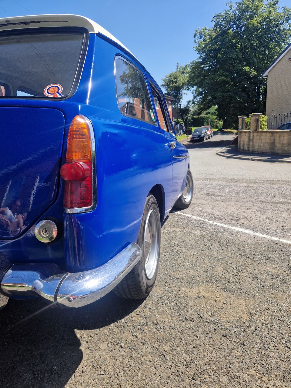

Oohh brilliant!! Ill be watching closely. Mines a brush paint job but not in enamel. I think what happened was the previous owner of mine spent a lot of money on metal work. And it must have been done right as ive had it since 2022, its seen rain and its never come through with rust. But then he must have run short on funds. So i have the original factory roof in cream but body in brush painted rustoleum blue instead of the almond green it should be. Its the only thing i dont like about the car, but much like yourself, the thousands needed to do it proper just doesnt exist. For what its worth mine would be old english white with a black roof. Or Farina Grey with a black roof.
Believe me its not this shiny in the flesh

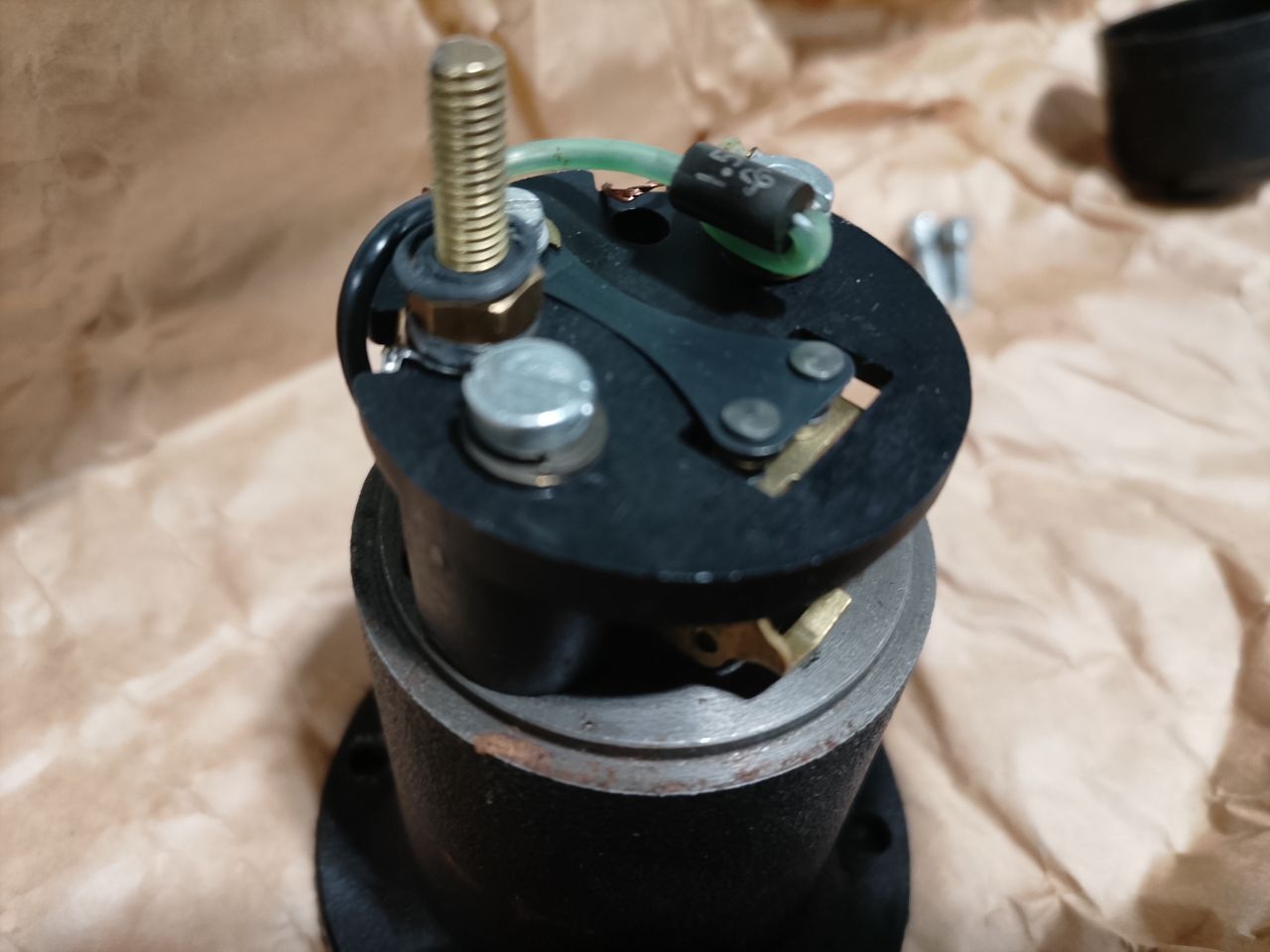

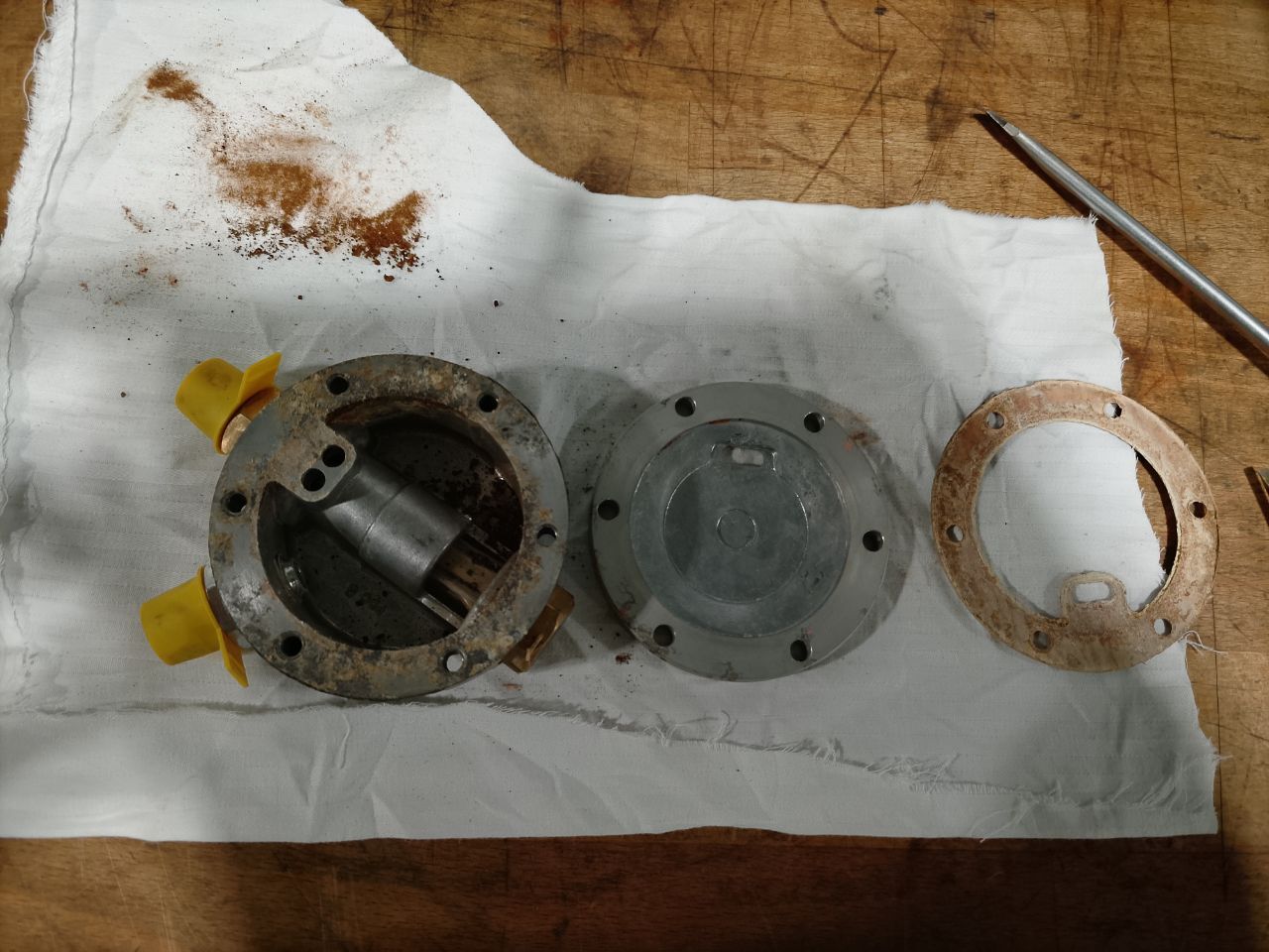

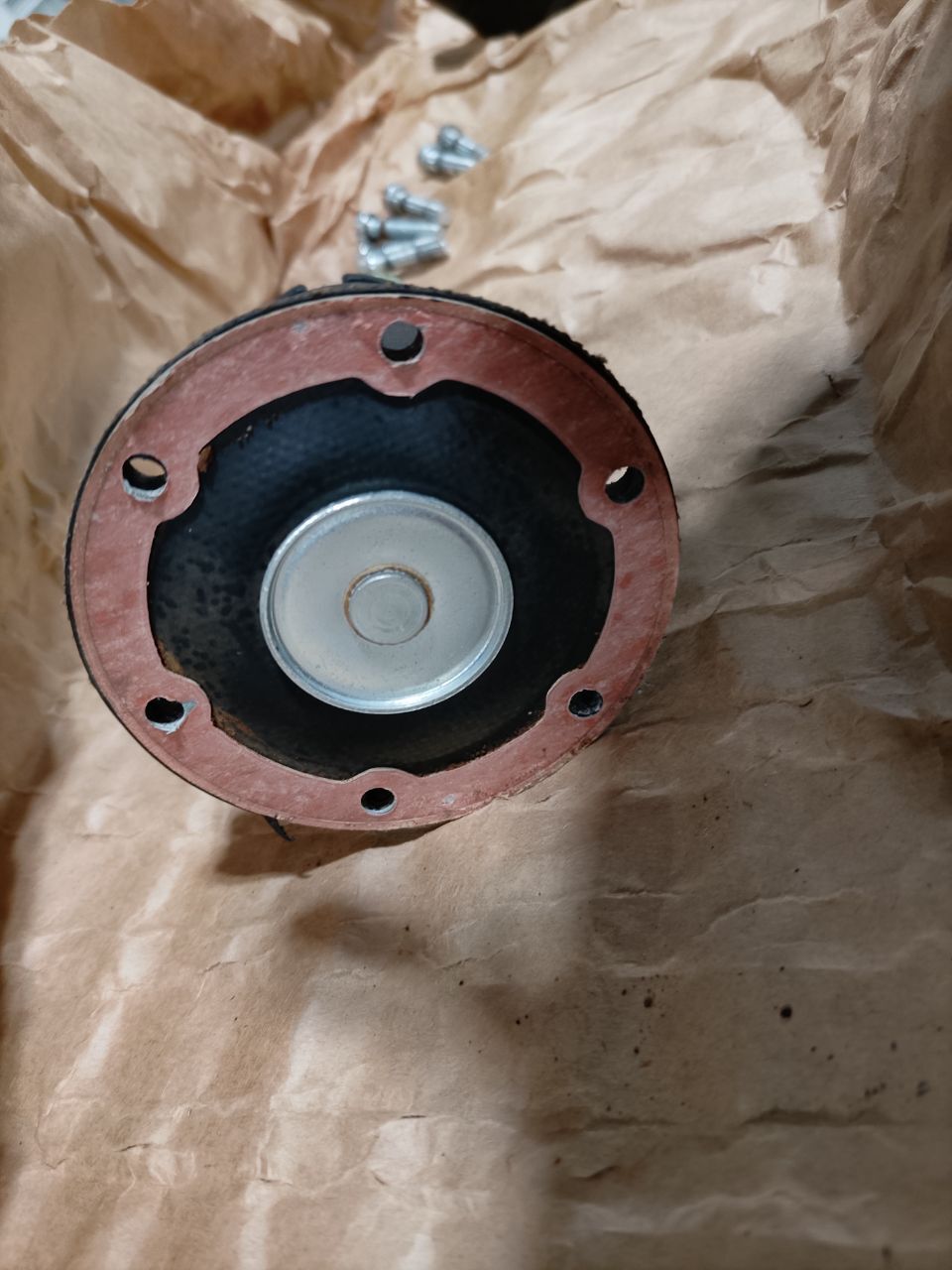

Very little to report from me, but I am once again on back shift and so have refurbed a bit of old Rover.  My old fuel pump should be able to act as a back up, following a strip and clean out.  The points were dirty but have cleaned up ok...
Diaphragm looked ok to me...
And all this filth has been removed...
It will now live in the boot until required, hopefully years hence.  Old Red is running beautifully, I'm just waiting for better weather for the bodywork phase.  I have been commuting in the P4 so much that I thought I'd better use the big Audi today, as it doesn't like to sit too long I find.  It's going well too, if not quite with the same sense of occasion...!
