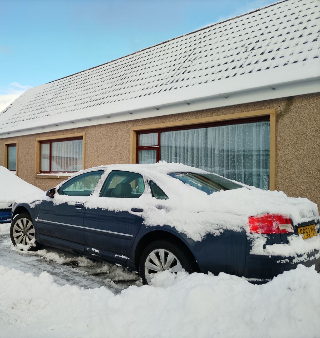

Big blue Audi sailed through for another year yesterday too, the eml stayed off long enough!
(It puts it on for the failed hydraulic parts of the 'active' engine mounts, which make no difference to anything, the light usually returns a few days after reset).
It's been a godsend this winter, and I think there's another dump of snow due next week, so it's a weight off knowing it's legal...

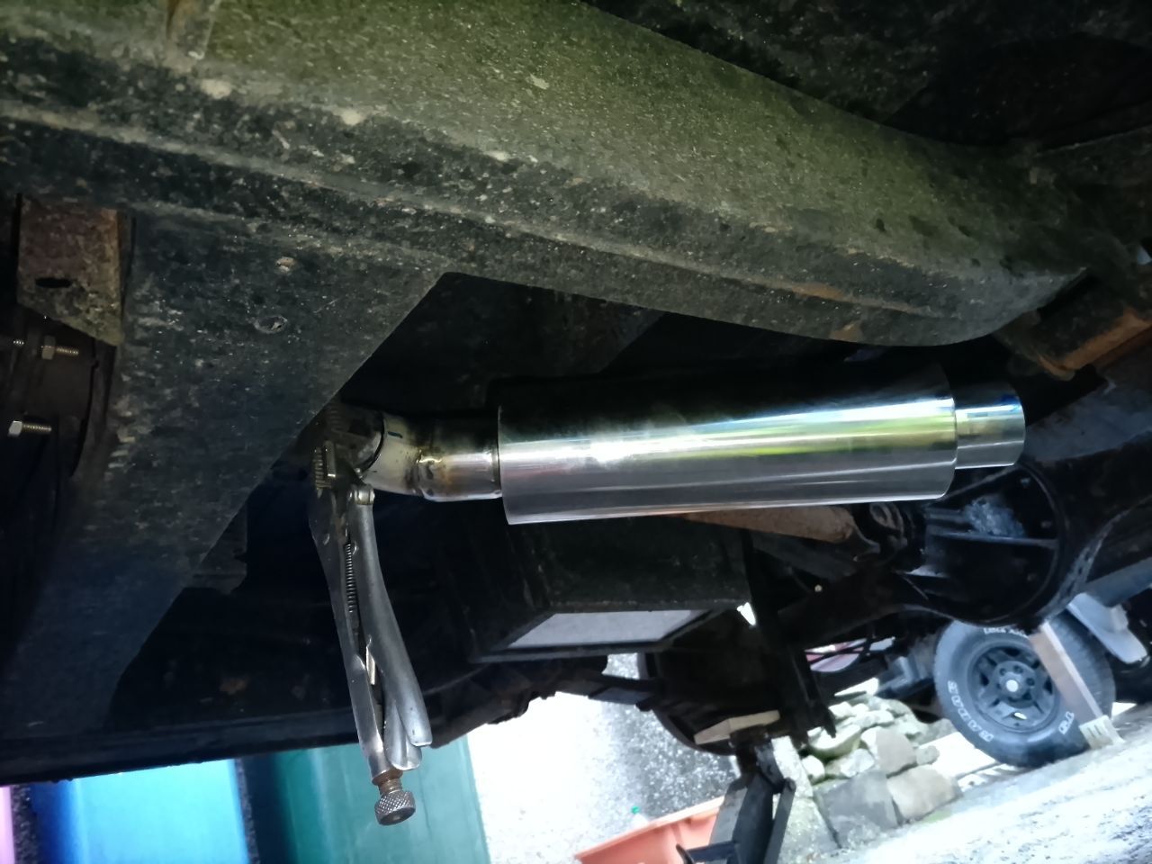

Well, because I am a big kid and couldn't wait to hear the old girl, we hooked up a very professional fuel system...
...and let 'er rip!
My lad cobbled a vid together for me, sounds a lot better on a TV than my rubbish phone, quite happy with the results here!
Still to trim the pipe to suit once I've refitted the lower door trim... and the blue smoke is the two-stroke juice she was chewing on, that's not usual I promise!
Just the tank to go back in and I can burble about the place to my heart's content...

Sounds lovely, and surprisingly muted if it's just that single silencer.
Yes, very quiet at idle, and only really any louder when revved quite high.  Sounds deeper altogether though.
On a side note, the engine started first turn, being bottle fed and having sat for weeks...  It's also noticeably smoother and quieter on that zinc-rich Pistoneeze oil.
