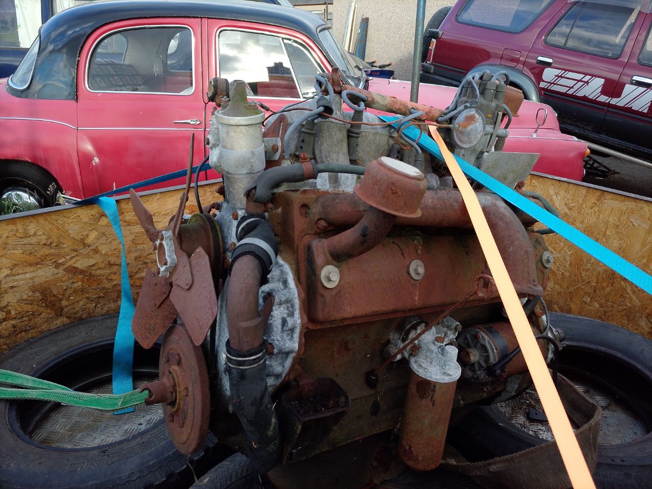

I'd arranged to pick up the spare Rover P4 engine from my pal's yard on Saturday morning, and the weather played ball.  By lunchtime then, the lump was out and in my driveway.  The Surf and my old trailer provided the transport, and my mate's ancient but very stout forklift provided the lift.
Before...
And after a couple of hours swearing, after...
I know... imagine the joy of living next to me!  However, even if the big lump never turns again, there are plenty of bits there that can be refurbed and fitted if needed.  It has been exposed to the elements for years, it may well be scrap, but t'was free at least.  A thorough soaking in diesel is in its immediate future, see if she's for turning.

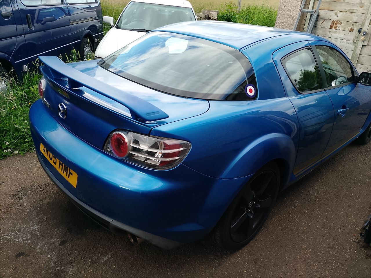

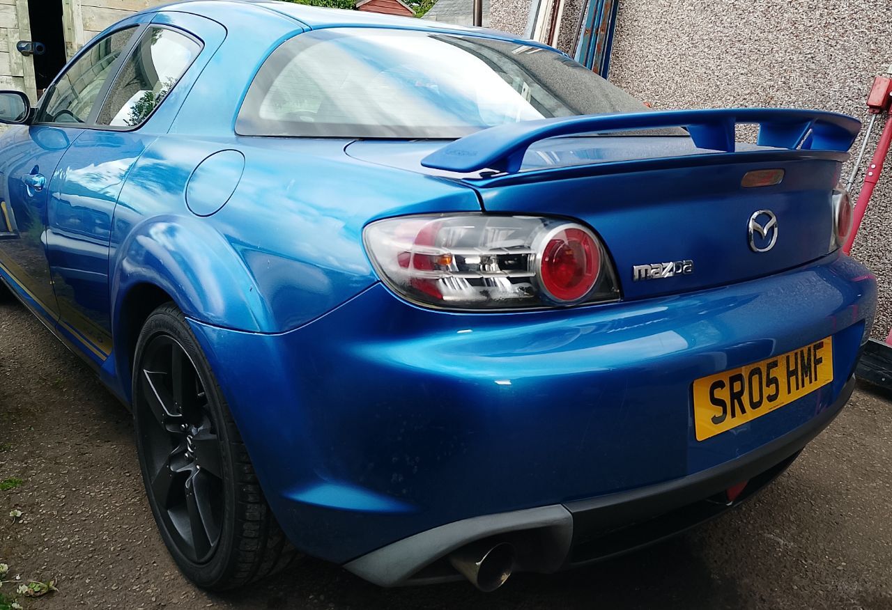

Second planned job was to sort a couple of rust blebs on the RX8's bootlid, in preparation for the attachment of my newly-blue spoiler.  I forgot to take a proper 'before' pic, this is a zoom in from a previous one...
The bit just under the Mazda badge was the worst, but the wee bits around the third brake light were bugging me too.  Angry grinder, Fertan, filler and paint were all applied, I'll need more cans of Winning Blue now to tackle the front wings.
And the results, final cut and polish pending (badges not stuck on yet either)...
The works included the wet-and-drying of the third brake light lens, as it was not looking good.  Nice and bright now though...
The spoiler itself got primed and it's first coat of colour, needs more, and lacquer I think, but good enough to imagine the final fit...
I'm not 100% sure on it tbh, but it uses the same holes as the original diddy spoiler, so I'm not going to damage anything trying it.  It is a factory (PZ/Prodrive) jobby, so isn't too offensive... thoughts welcome as always!

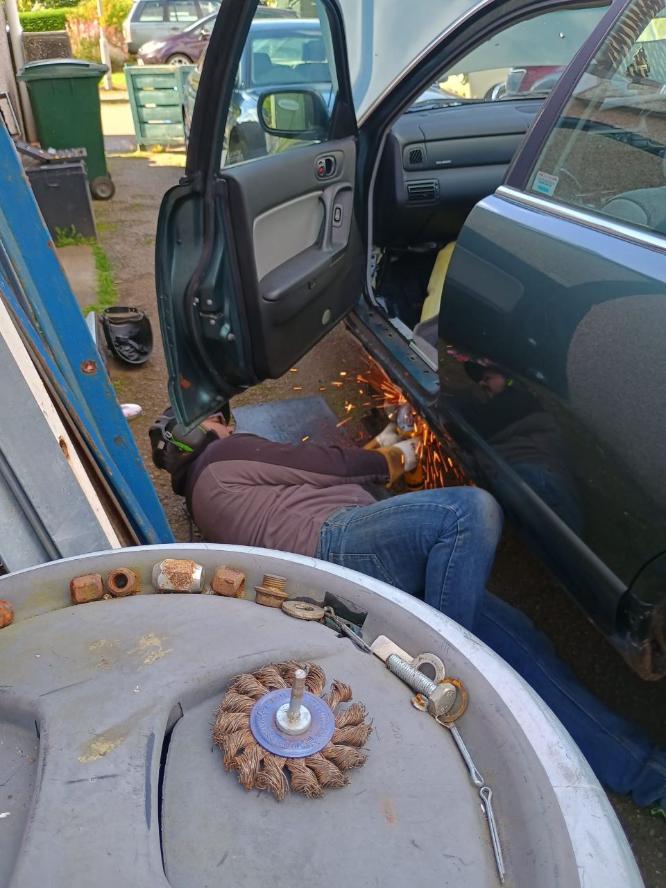

Final job was an unplanned one, as my youngest sheared two bolts on the anti-roll bar mounts under the venerable Surf.  This during some enthusiastic off-roading I'm told.
We cut and bashed the captive nuts out with the sheared bits still in, and replaced with nuts and bolts from the stash.  There were new rubbers in his parts box too, so she's much improved.  Here's a rubbish pic of that job to end on...

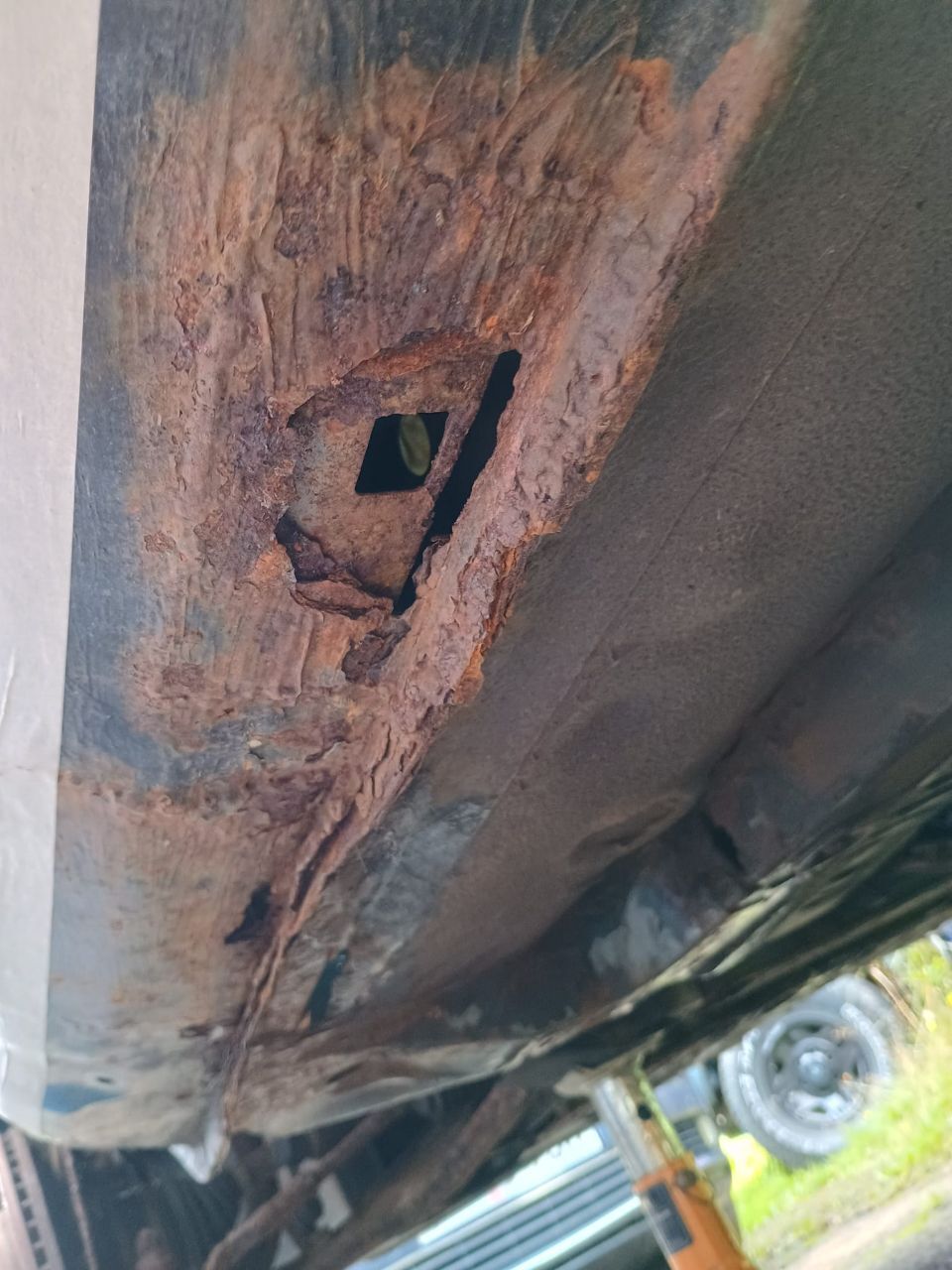

Regular readers may remember my eldest's next car, the mighty and mythical Xedos 9.  What we should have done, is held out for a good one (Schaefft's for example...), what we did was spend £900 on a rusty one.  Yay!
Well, I had a grumble about not being a mug spending my weekends under somebody else's motor, whilst said individual gallivanted around just generally being young and happy.  This meant that the welding work (to the outer sills) was farmed out to a local lad, famed for his quality work on expensive classic cars.  He said he would slow-time the job as we were mates, a nice little arrangement.
However, he is snowed under and the Xedos has, after 6 months waiting, made it's X-odus back to my yard.
The repair position then, has been assumed...
This itself took some time and effort, these cars are seriously low.  Many bits of wood, and several jacking operations left us as above.  The tilty ramp is of no use, as it can only lift the car by the bits I'm needing to cut out and weld up unfortunately.
The old thing is thankfully still running beautifully, the non-Miller cycle V6 is the quietest engine I've ever known...
Cambelt change looks like fun...
Anyway, I'll update with photos of the damage when I next drag my sorry carcass underneath it, I'm off to the pub.

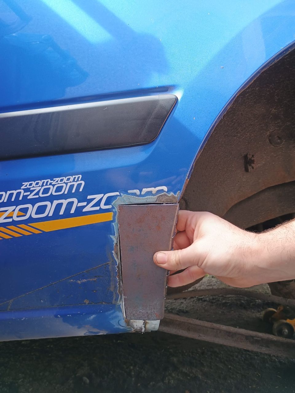

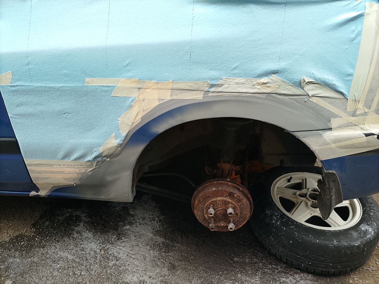

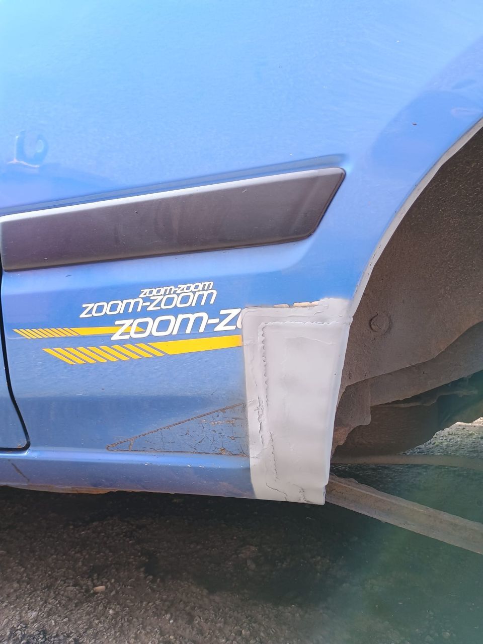

Well well,
Thanks to an oversight on the part of my eldest 'shiter, his wee (ex-of-this-parish) Mazda 323 is out of test.
So, with a bit of time off today (what else do you do with holiday leave?!), I set about it... the tin worm has been a bit brutal on the car, at 34 years old it is doing serious miles, all over Scotland.  I'm tackling the worst of it in the hopes that the MOT man takes a kind view of the rest!
An initial dig in to the wheel arch resulted in chasing out a fair bit of rust...
The stickers will never be the same!

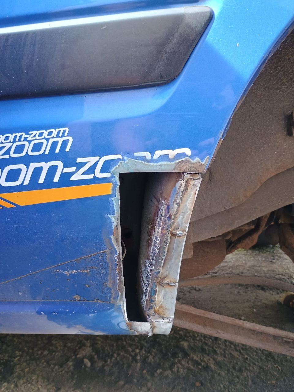

Anyway, got a new piece made up to replace the inner curve...
...and welded that all up.  Much care was required, there's no thickness to the original steel.  No picture, but all this got a good spray of weld-through primer, and I plan to spray inside the void with some form of oily goodness when we're done.
Next up was the outer skin, which I had to make up with 2mm plate as that's all that was left in the stash...
Worked ok though, I welded up all the slots I'd cut for the return edge folding, and it's certainly strong!

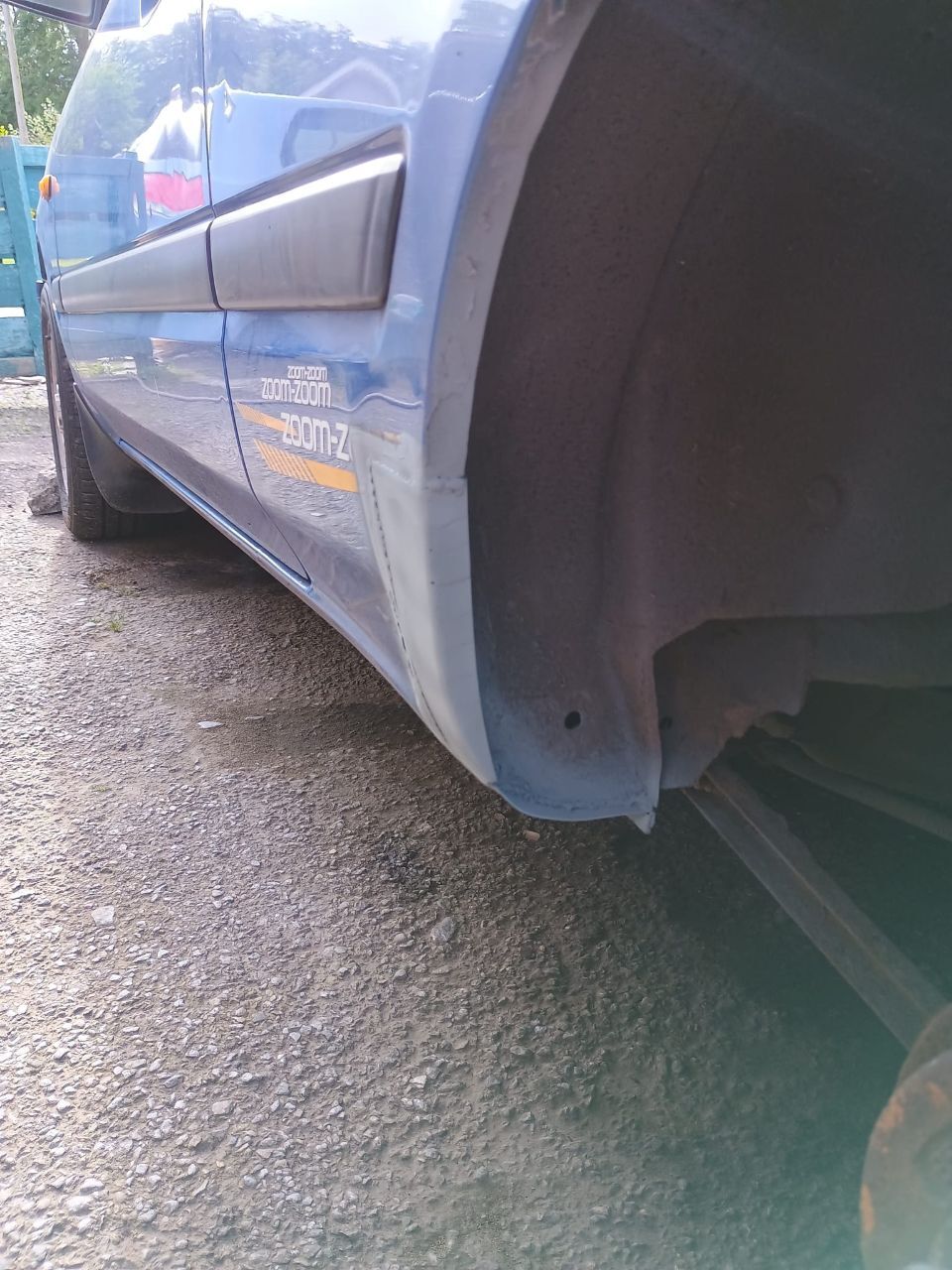

More primer, and then some tiny tacks...
...until eventually it became one with the Maz...
A quick coat applied just to stop it flash rusting tonight...
It has puckered inwards a bit near the top, obviously I put too much heat in at once.  However, tomorrow will see the filler out, and the Perky Blue rattle cans of course.
A new sticker will then distract the eye from any remaining dodginess!
So far, the rest of the car seems testable, a new set of tyres on the rear possibly required, but we're trying to keep the spends down a wee bit as the Xedos is waiting it's turn with the welder in order to replace this one on the road.
I'm going to need shares in a welding gas company for that particular example of Mazda's masterpiece though, everywhere I look there's more metal work required...
Cheers all.
Today's progress...
As ever, looked good before I put the primer on...
Will see if I can be bothered with any more smoothing tomorrow, probably just whack the topcoat on and call it a day though...  Soul-destroying stuff this bodywork lark.

i like the spoiler !! suits the car well
Yes, I'm coming round to it myself.  Will need some more paint and then I'll stick it on I think.

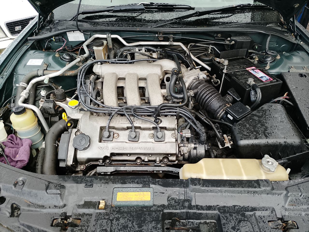

My old 3.7 version has covered 57,000 miles in my time with it now, and has a few issues to attend to.
The front brakes have picked up a wobble, I've finally got the correct new pads in stock and will check the discs when they're out.
The boot handle, although you'd think it was plastic, is actually aluminium and has corroded (TADTS).  This has basically let water into and ruined the numberplate lamps, so I've got some nice aluminium body filler, paint and new lamps in.  This should tidy up the rear aspect, which is letting the car down a bit just now.
The main issue however, is under the bonnet.  These engines use a rubber cambelt, but it drives the second camshaft in each head via chains, adjusted by oil-pressure-fed tensioners.  There are check valves fitted to prevent the oil draining down to the sump on switch-off, avoiding a 'dry' start of these tensioners.  Mine, like most at this mileage, have failed or are failing.  The symptom is a clattery couple of seconds on startup, if the car has been left for more than a day.
The engine is smooth as silk thereafter, so I'm hopeful the issue is simply as described, but it could be that the tensioners themselves are tired, a much bigger job... we will see.
Getting to the check valves means the removal of the air intake plenum, so I've ordered gaskets etc too.
The clatter is more of an annoyance than anything, but I'll definitely regret it if anything suddenly worsens!

My old 5V Audi 80 Cab had the same setup albeit in 4 pot form and made the same rattle on startup for years, probably still does 🤣
Yeah, I don't actually think it's doing much harm... Just sounds shite!  I've little enough street cred as it is... 🤣
Bits for the Audi are still en-route, so a start has been made, on our driveway ornament  down-on-its-luck example of Mazda's flagship super saloon...
Regular readers will remember it's back home for welding after an aborted attempt with a local professional.
Basically, wherever the plastic sill covers were clipped to the car, the metal mouse has had field day.  Add to that a bit of careless jacking in the past, and behold...!
The masking tape is just a guide for a first exploratory cut...
You can make out the carpet lifted out the way a bit below, there is a bit of floorpan needing replaced there too.  Inner sill is good though, which is something...
And post cutting out.  This is over half the sill cut away, the length of my previously cut repair pieces.  I'll do the rear section once this one is tacked in.  Always good to see the rusty mess away...
Bit of Fertan for luck...
And a trial fit if the new steel...
Lots of work ahead, but good to have started...  Plan is to tack 6mm bolts to the bottom of the new plate, which will pick up the holes in the bottom of the plastic sill cover... a penny washer and nut will then hold the plastic on, but allow easier removal for rust-proofing in future.
The other side is just as bad, and the rear wheel arches are needing attention too.
I'm sure most would say it's past it (economically, it certainly isn't worth the bother I suppose), but there really doesn't seem to be many left now, and it runs and drives beautifully.
Once the Fertan's gone off, we'll get the weld-through primer on and start the weld-a-thon!
Cheers all.

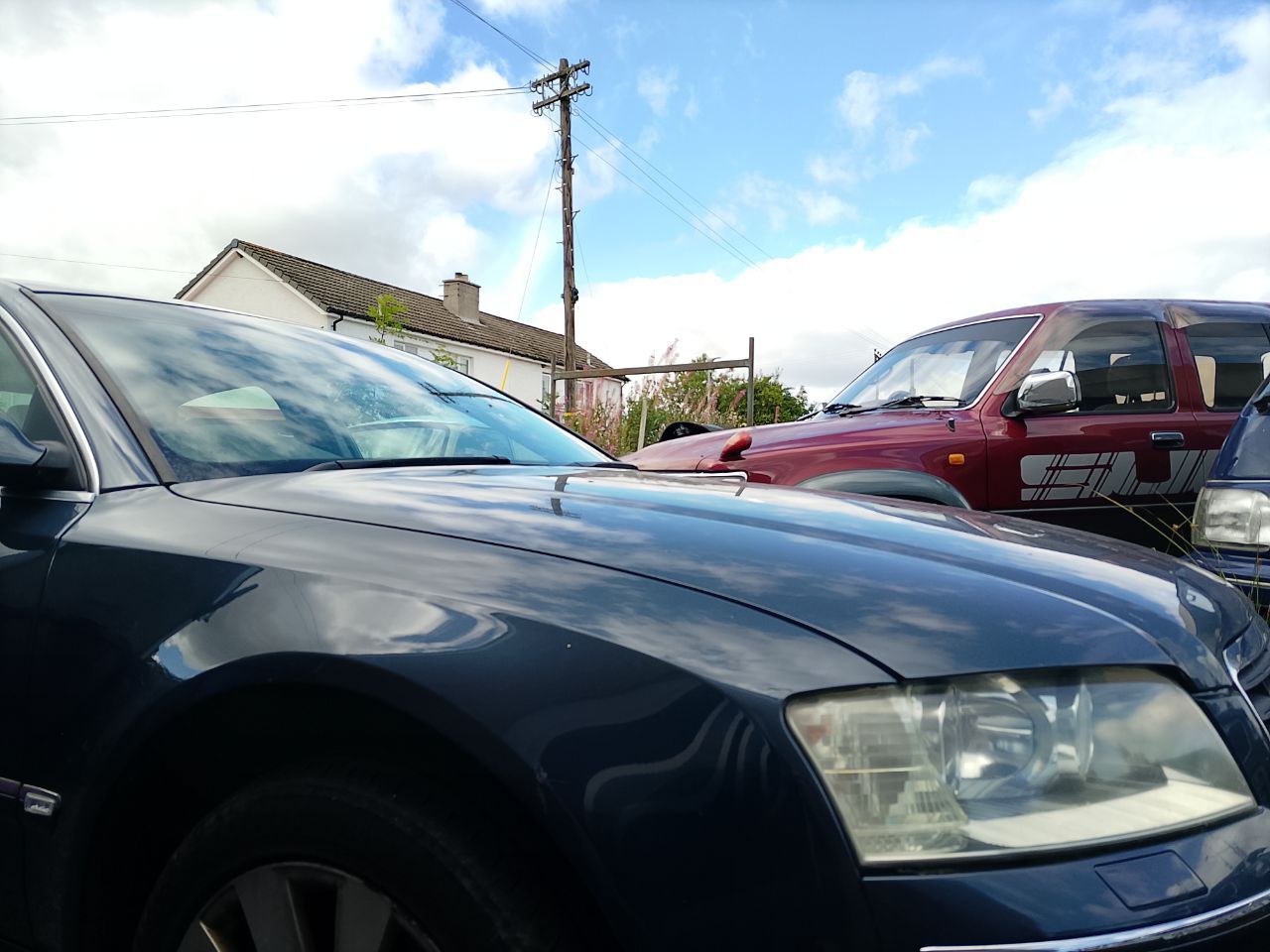

Well, minor progress on the big Audi, although I immediately gave up on the engine work due to the wind continuously trying to slam the bonnet shut!
I went aft, and am in the process of completing two repairs.  As I have mentioned, my boot handle was in a terrible state.  Removed, rubbed smooth and now coated with etch primer.
Reading up on aluminium body repairs, time seems to be a factor... the quicker the primer is applied, the less instant oxidisation occurs.  Anyway, I will smooth it off tomorrow and see if more primer or even filler is required for perfect smoothness.  It's a pain to get this part out, so I would rather it lasted a while!
Amazon supplied new numberplate lamps, which are an almost perfect fit in the recesses too!
I also noticed that the boot opening switch was stuck in 'open' (could have been for a while, I usually use the fob to pop it).  That's all cleaned out and un-stuck too now...
All this is related to the handle corrosion allowing moisture in I think, the gasket was not a good seal on the rough surface.  Bit of a pain.

Before my aborted attempt to replace my RX8's wheels, I had been playing with colour options... Thoughts welcome, I'm aware the Gold is a bold choice, however, we're only here the once... and there's not many cars could carry it off!
Or black as is of course...
