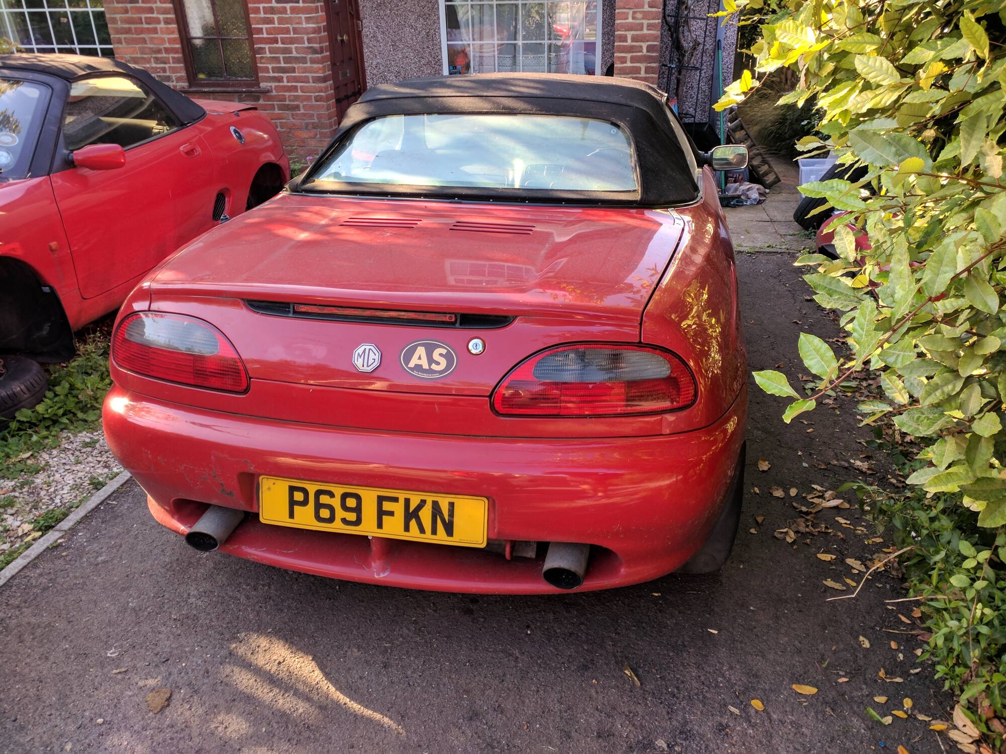

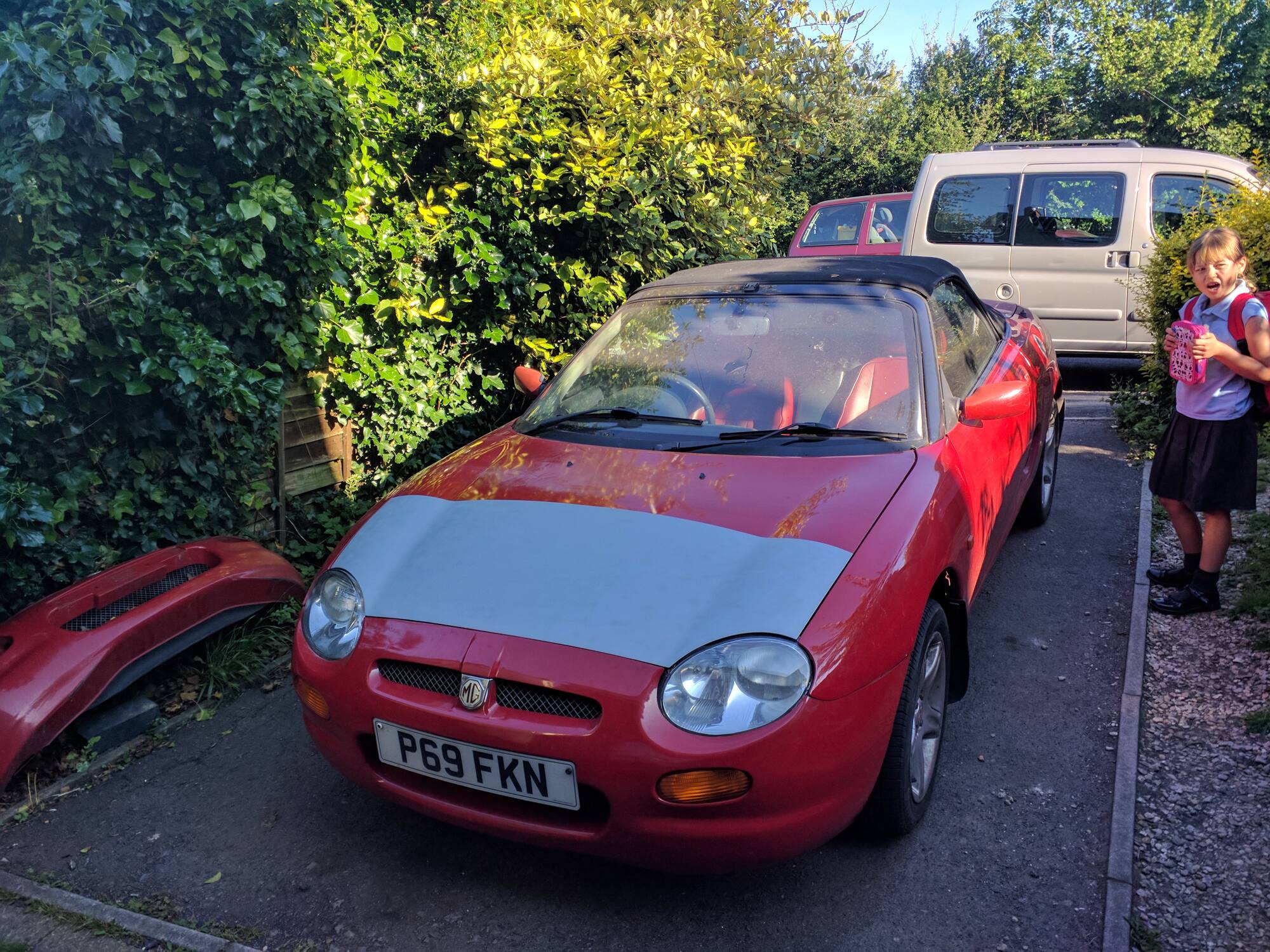

Here are a couple of pictures taken yesterday morning.
The eagle eyed amongst you will notice the bonnet. Red MGFs seem to suffer from nasty lacquer peel. The original bonnet had a bit, and the bonnet off the spares car was worse, but it was all at the bottom of the bonnet. I swapped the bonnets over and sanded down the peeled lacquer - it had had a funny reaction in places, which meant I had to go down to bare metal - and sprayed it over with zinc galvanising spray. It's very much a 10 foot job - I might still satin black it instead which I think would look better. The winner can have the original bonnet too/instead, which has a patch of lacquer peel too, but is at least all red.
Wheel change; I put the VVC alloys (as shown) back on it, and then some fucker stole the 6-spoke TF alloys from my driveway anyway, so it will come on the 5-spoke wheels shown.
There's still some lacquer peel on the rear bumper, as you can see. I'm planning on swapping on the one from the spares car, which is in better nick.

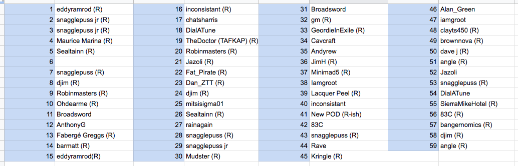

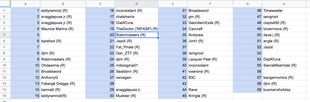

Up to date roffle list.
One left - but I think there may still be a few dropouts as people see this thread has been resurrected. Tentatively we could be on for a draw next week.

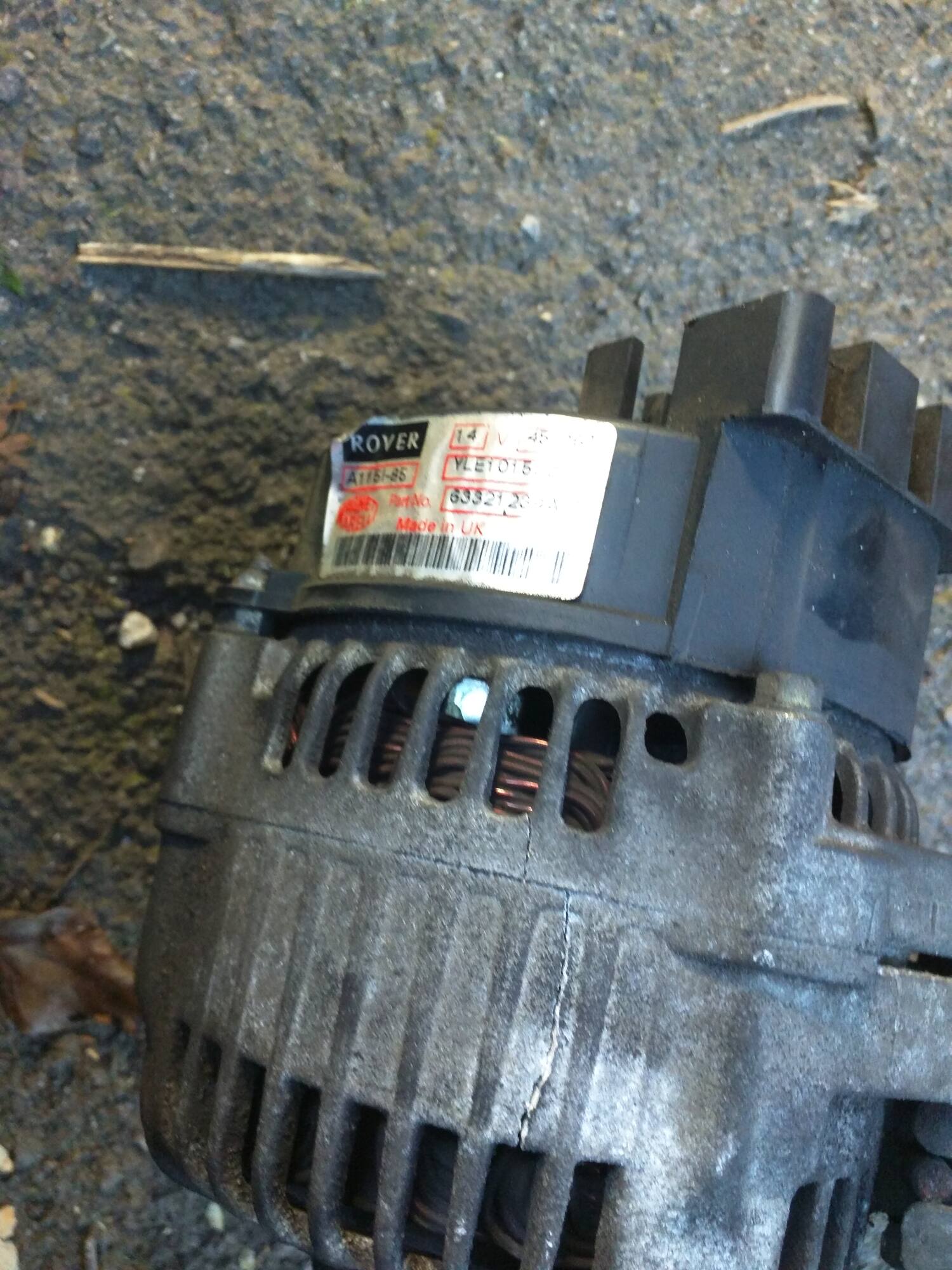

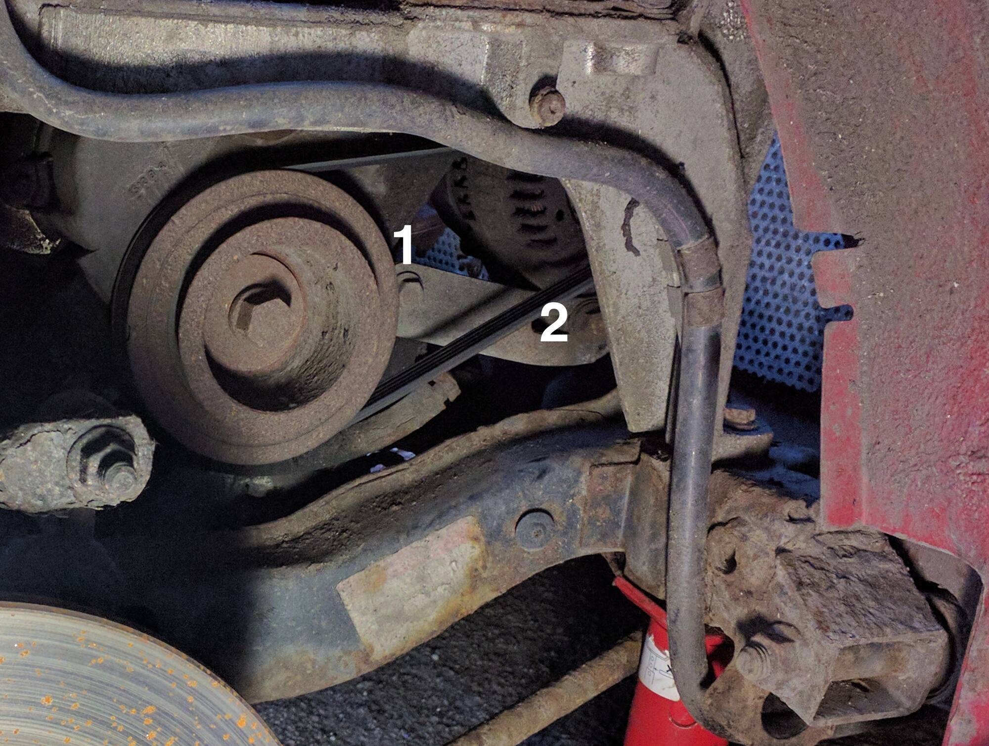

So meanwhile, next job was to tighten the alternator belt, as it has been squeaking for a while.
The alternator is retained by two bolts, with the bottom one being in a slot so that you can adjust the position (2) attached to a plate which bolts to the block (1). Unfortunately the adjusty nut (2) is completely inaccessible.
I had a go at it with various implements but there isn't even one click of swing on a socket ratchet and an open spanner just looked like it would round it off.  The only thing to do was to remove the alternator and bracket from the car entirely, then free off the bolt.
It came off easily once off the car and I reassembled it with copper grease.
Looks like the genuine original alternator too!
Refitting is the reverse etc etc.
