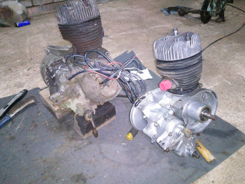

After taking the heads off of both engines i'm shifting strategy, the plan will now be to make a good engine by starting with the 3R engine as a base (the clean unseized but incomplete one from ebay) and putting all the required parts from the 3F engine (XWC's original seized up engine) on it. I'm not going to bin the original engine but it's just not feasable to use it at this point in time.  I'd rather start with a base that's already %30 toward being done instead of starting from square 1 with the seized engine.
Here's XWC's original engine that i'll call '3F' for simplicity with it's head off:
The head gasket is obviously blown, i assume that's what originally took XWC off the road (presumably in the 90's) unless it happened in the space of time between it getting taken off the road years ago and when it was parked on the verge in the wreckers yard all the way back on page 1 of this topic.
(above is 3F's jug with manky piston and 3F's head, all pictures below are from 3R)

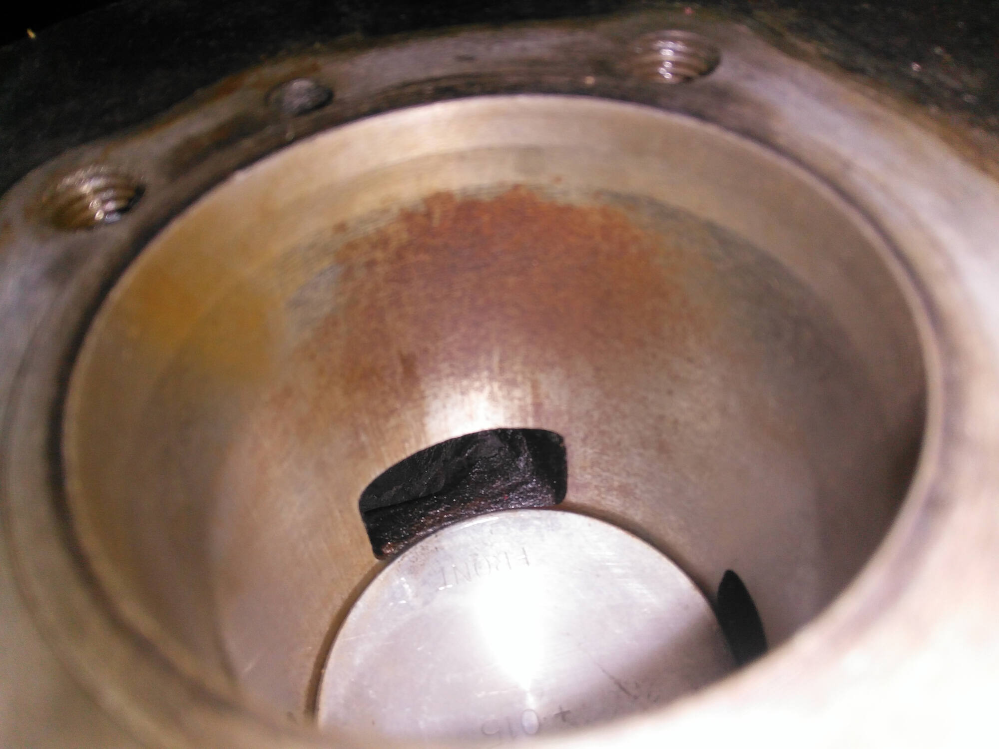

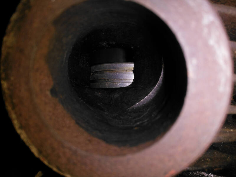

3R on the other hand is clean inside apart from some light rusting from lack of use which shouldn't be too bad (please correct me if i'm wrong though, this goes for anything i say btw)
^ this bit on 3R's cylinder wall is the worst, still savable though? (correct me if wrong)
If you look closely you'll see the piston on 3R is a +.015" oversized one and that means the cylinder has been re-bored oversized too. That would entail +.015" oversized piston rings so i checked they were installed and...

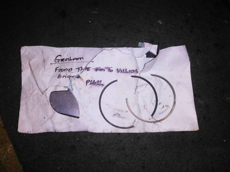

The replacement engine has no rings! :P
Then i rememberd egg writing in a post that the replacement engine's rings were in an envelope separately so i checked them out and..
..bugger, both are broken. :wacko:
As the relacement engine is an oversized jobbie i'll get the corresponding rings for it, it's still got a far better chance at functioning than the seized engine.
The replacement engine seems to have eaten its own rings at some point in the past, the ones included in the envelope might have been what was left of them. The damaged head looked like it was possibly going to be re-used by the engine's previous owner (before egg), i'm undecided on whether i want to use XWC's original non-pitted head or the one that came with the replacement engine.
This is the pitted head that came with the replacement engine:
^ that pic has the head gasket placed on top to show where the jug would meet it when bolted down. The mating surface is smoother than that on the actual head, the pitting however is part of the head and not the gasket.
3R (clean replacement)'s gearbox goes through all the gears correctly which is good and all the parts that need to go on it (apart from the rings) are comptible with 3F's parts for swapping over.
Still unsure specifically what seized on the original engine (3F) but during the engine assembly of 3R i'll peck away at the original one until i find out.

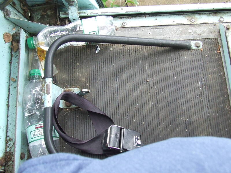

i've got a few more close up pics of JBY here, doubt they add much  - but just in case - thought I'd share
Modified fuelling arrangement:
Control close up
Can't remember what this is!
Wheelchair storage arrangement
Dynastart on rear shelf
Engine
