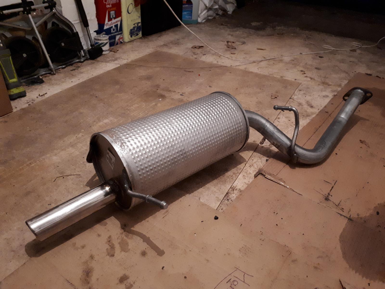

NS CV gaitor is split, and the back box has seen better days...
I spent ages pouring over eBay listings to make sure I got the correct one, as not all of them were showing the kink in the pipe the current one has. £42 for a cheapo part that will no doubt be a sod to fit anyway! Will have a go at that myself if I can get it on the ramps.

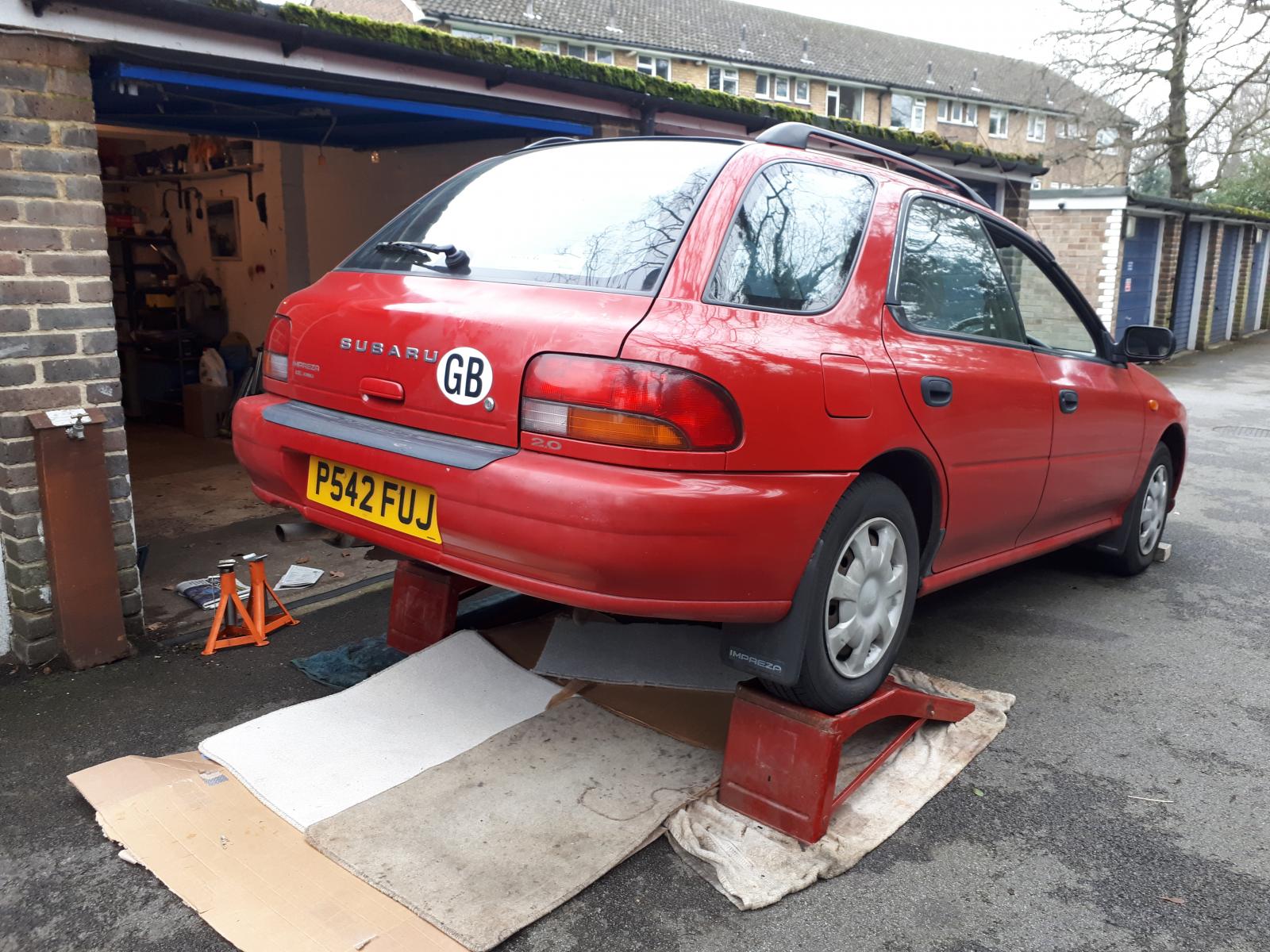

The MoT on this expired on the 27th, and I haven't had time to fix the exhaust and get it tested.  So yesterday I had a go.
Part to be replaced.  £50 quality* item, although it does have a fancy chrome tail pipe...
This is the first car I've managed to get up on these ramps.  They normally skid away backwards.  Maybe the AWD has something to do with it.
