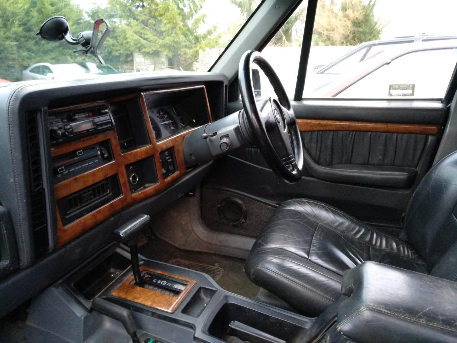

Well, I watched Doug De's video, and there are a few differences between that facelift one and my leather clad rhd pre-facelift.
I then realised I'd not really posted many interior pics, excuse the grubbiness, as I've just given the worst bits a quick wipe for now.
Yes the steering wheel does protrude quite a bit, and no it does not move in/out, just a little tilt up/down.
Everything on one stalk, including cruise.
The small stalk behind does the tilt of the wheel, no telescope in/out.
If you watched Doug's video you might have noticed he said none were produced with rear headrests, and they didn't move the spare to the drivers side on rhd. Well, mine must be quite rare then.

The steering wheel being quite a long way back seems to be quite a common thing in US cars. Glad you don't have the airbag - say what you like about safety but there's no escaping that the early airbag wheels were utterly HIDEOUS!
The dimmer for the dash lights is controlled by turning the knob on the headlight switch.
Had one we sold come back with a complaint the dash lighting didn't work once...they hadn't been able to work that out!
That also controls the interior courtesy lights …. which the seller of this vehicle wasn't aware of, so removed bulbs to turn the lights off.

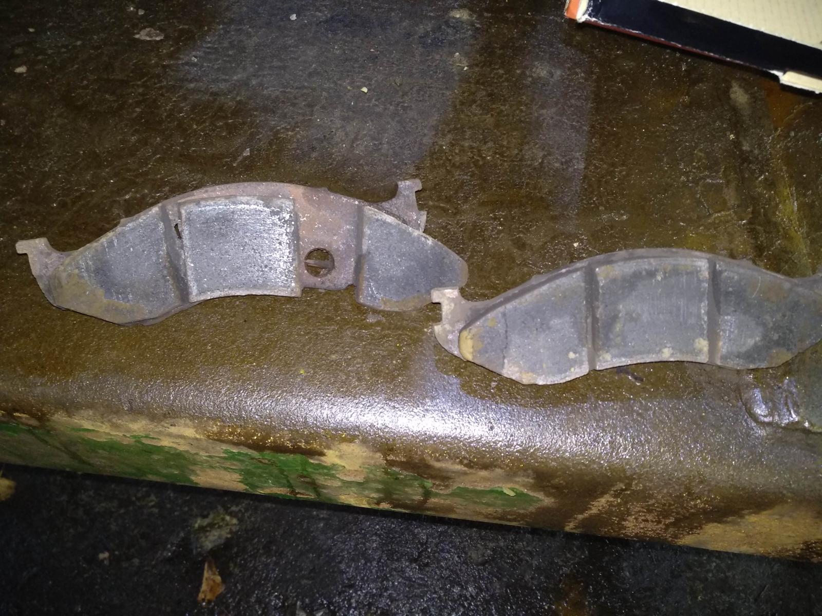

About 4 miles or so from the garage I got the "death wobble" again, similar to when the nsf brake was locking up, about 250 miles earlier. I pulled over, and went to feel the wheels for heat .. osf was hot. Great, so that's both now that have been playing up. I wasn't in the mood for roadside shenanigans today, so drove slow(ish) to the garage.
What was supposed to be a check over of a few things then became a brake examination....

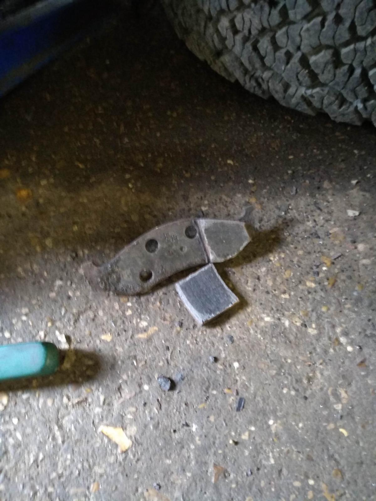

OSF wheel and caliper removed - the pad then proceeded to fall apart.
We then phoned around local factors and found one in Boston had some in stock, so I borrowed a Vauxhall and hastily drove to collect the pads.
1.5hrs later I got the Jeep on the ramp and both front wheels off.
The nsf pads didn't look too clever either, cracked and scorched, so it's probably good that I'm changing the pads.
There was a bit of trouble getting the new pads fitted as the pistons didn't want to compress far enough, but with a little persuasion everything was refitted.
On pressing the brake pedal we discovered very quickly that both wheels locked up, solid and wouldn't turn. We couldn't free them off enough so it was drivable. We then discussed stripping everything down and dismantling the calipers/pistons to see what the issue was.
I'm now fed up of writing, so  TLDW:
Pistons not compressing enough, bleed nipples seized solid, hoses have seen better days.
We could strip the callipers down, clean, sand, scrape stuff, fight with the bleed nipple, fail to get the hoses off in one piece and still not be happy with the end result.
To save messing about I am now ordering 2x new front callipers and hoses to go with the new pads bought today.
That'll be another £170 on to the cost of the "cheap jeep" oh and I think a new aux belt might be added to the shopping list.

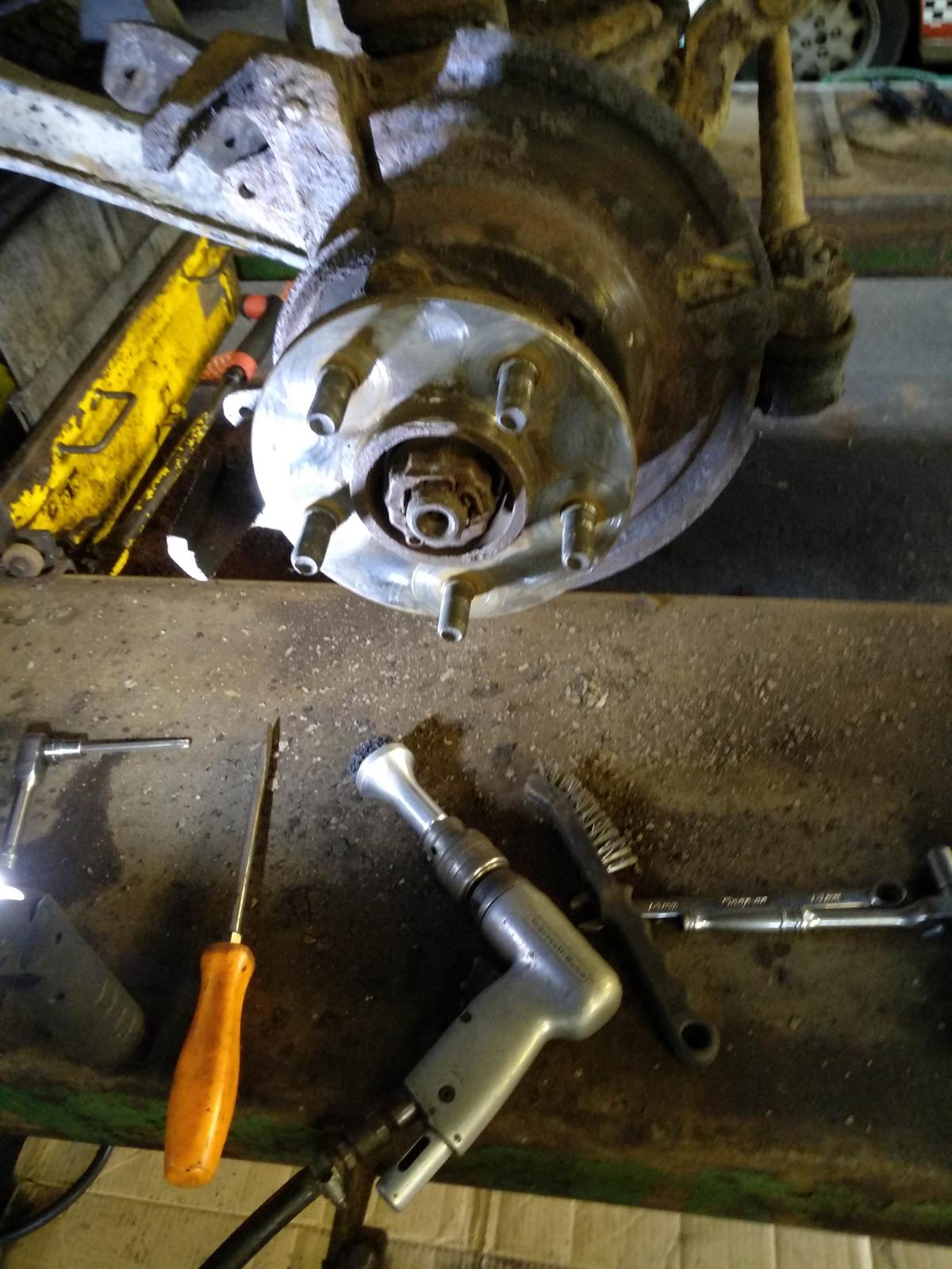

I've been to the garage today and changed pretty much all the front brake system on the jeep..
First off, remove crusty old brakes:
I like working on cars at the garage, not only does it mean I get to work on a lift at a variable height, but it also means I get to use lots of tools I don't have.
Cleaning bits:
Shiny things fitted, £150 worth of shiny things (new hoses not pictured).
