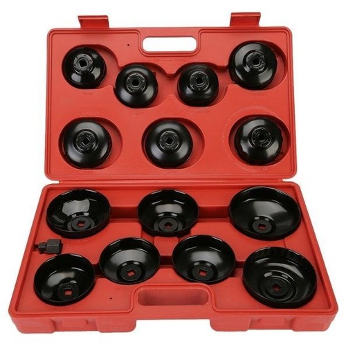

I've got one like those for my bike, makes life much much easier between the downpipes.
I'd say it depends how many of them you'll use.  If only one or two, then they're suddenly not so cheap.   I have an old chain wrench which never fails to get the filter off, even if they're over-tight, in which case they get a bit squashed in the process.  It's not the pleasantest tool to use because the chain sometimes flops around until you get it tight on the filter,
