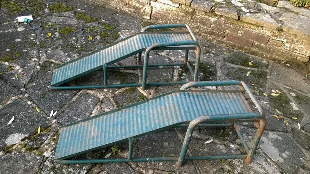

SiC Posted September 24, 2016 Posted September 24, 2016 I was just about to post a ramps vs axle stands question! Ramps or axle stands, which is safer?What potentially could cause a car to come down on ramps? I.e. what is commonly done wrong and fuck it up. I only have stands atm and I have to admit, I'm always petrified of going under cars using them! I end up putting the jack under and anything else I can find, to safe guard against the car coming back down. I also don't like to spend any more than the bare essential time underneath. What stops the ramp scooting forwards when you try driving up them?
SiC Posted September 24, 2016 Posted September 24, 2016 Axle stand question too... I have 1.5tonne rated each, 3 tonne rated pair of stands. Am I in the rated limits (and so safe) to use them to support a 1.8tonne car? I.e. the Saab.
dave21478 Posted September 25, 2016 Posted September 25, 2016 You are well within the spec of the axle stands. Remember that you are not lifting all the cars weight, you still have one end or one side on the ground.Even fully in the air with two pairs of stands, thats six tons capacity holding up 1.8 tons. As for ramps, I have a couple of pairs of the cheap ones made from angle iron....They can slip forwards as you try to go up them with the non-driven wheels, ie reversing a FWD car up. I try to wedge them with bricks or something or in extreme cases a length of rope tied around the bottom rung and laid flat under the car and under the front wheel will hold it. Once up, chock the wheels that are still on the ground to prevent the car rolling down off them. I spotted this on youtube a while back.....looks nifty. https://youtu.be/RYGpagLSKEk?t=581 saucedoctor and SiC 2
nigel bickle Posted September 25, 2016 Posted September 25, 2016 Put a short plank on the bottom rung. Drive onto plank, ramp then can't slip. With axle stands, put the wheel ( inc the spare if just one side) under the sill. Then if it topples, it will land on the rubber, not you! dave21478 1
DeeJay Posted September 25, 2016 Posted September 25, 2016 Storage is a pain for ramps.If you hang them on the wall make sure they're above head height.(Mine are now stored in the garden.) AMC Rebel and Station 2
twosmoke300 Posted September 25, 2016 Posted September 25, 2016 You can wrap a 6 inch or so wide strip of carpet around the bottom rung of the ramp too . About 6 foot in total ( 3 foot doubled up ) . The car then drives on the carpet and holds the ramps in the right place SiC 1

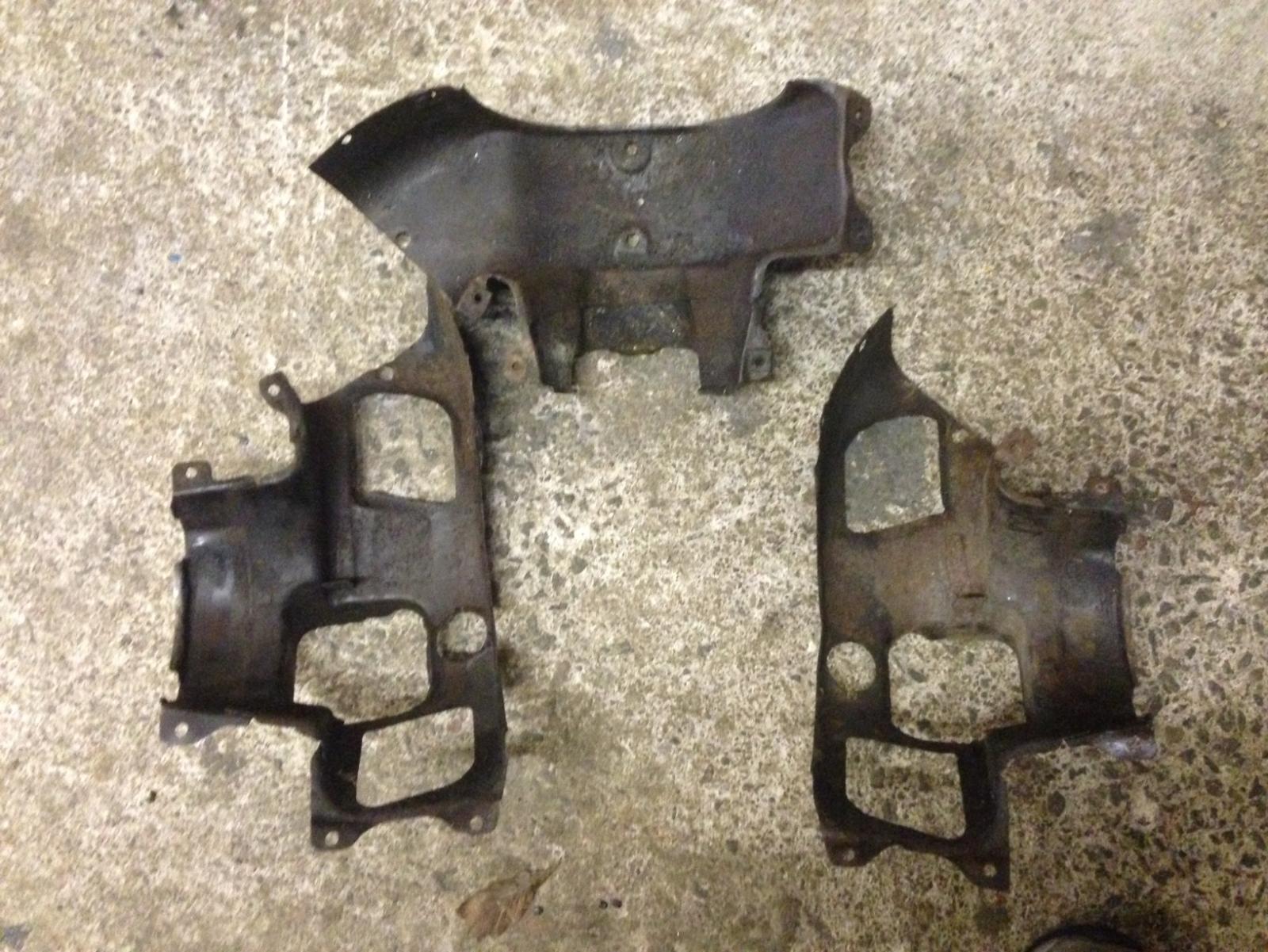

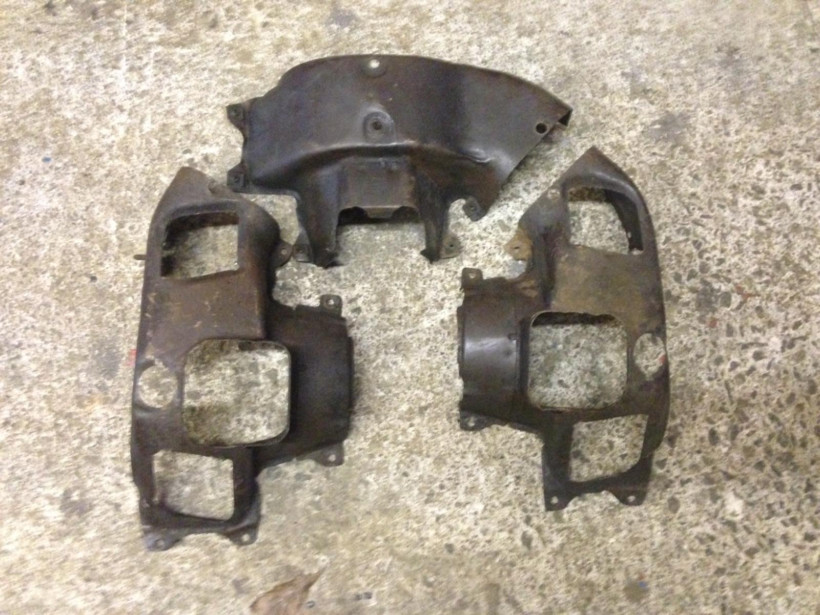

rainagain Posted September 26, 2016 Posted September 26, 2016 I was clearing out my Dad's garage at the weekend and found these 2CV bits from when I was going to take delivery of a free ex-race 2CV until inter-department politics meant it was scrapped instead Does anyone know what they are (they look like part of the heat ducting system?) if they are worth selling and if so for how much? I could do with some money for new drop links!
