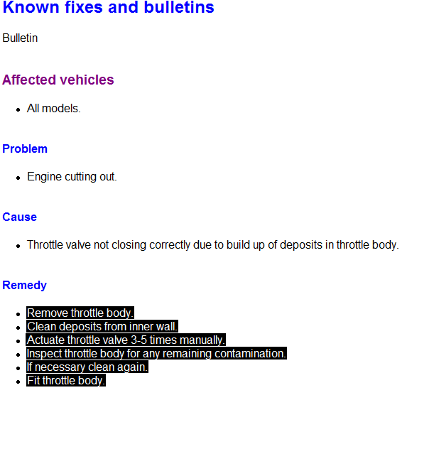

saucedoctor Posted November 16, 2013 Posted November 16, 2013 IACV fault should only prevent the car from idling. I can't see how it would cause the car to cut out at speed. The IACV on my Rover failed recently, but it drove home just fine after I adjusted the throttle stop screw on the throttle body. It just idled a bit high/lumpy. EDIT: Autodata says that the 850 cutting out problem may be due to the throttle valve not closing correctly due to a build up of shit in the throttle body. Take the throttle body off and give the bore a damn good clean is the way to go.

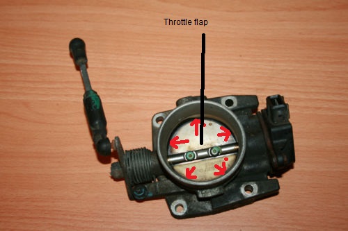

saucedoctor Posted November 16, 2013 Posted November 16, 2013 Should I be using carb cleaner on the IACV and throttle body too?Yes and yes. If there is muck and crap on the areas where I have crudely drawn the red arrows (this area is the throttle bore), then the throttle disc cannot close properly. Clean the whole thing, both sides of the throttle disc too. KruJoe 1
