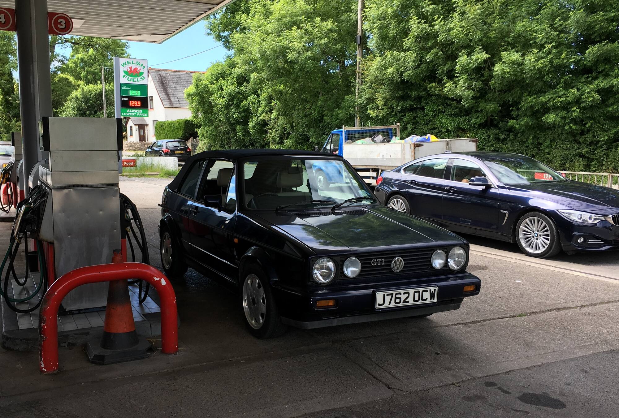

I am delighted to report that the Golf now has a full complement of MOT, tax and insurance.  I'm off to collect it shortly from the MOT place.  Pics to follow.
Ok, well, there’s good news and bad news.
Good news: it’s MOTd and taxed and insured so road legal for the first time in ten years.  It now idles fine.
Money shot:
Bad news is it runs like crap on the road - it won’t rev so maxes out at 30mph in third and struggles to get up even baby hills in second.
I suspect the K-Jetronic is still finding new and creative ways to be set up wrong, or a fuel blockage or something.  Alex the garagiste (good guy) and I both assumed fresh fuel would transform it but it didn’t.
It also started giving me an oil pressure warning light and buzzer - but there was oil showing ok on the dipstick and we’d changed the oil  a few weeks ago so I suspect that was another electrical gremlin as it comes out of hibernation.
So it’s gone back to the garage for more fixerage.
