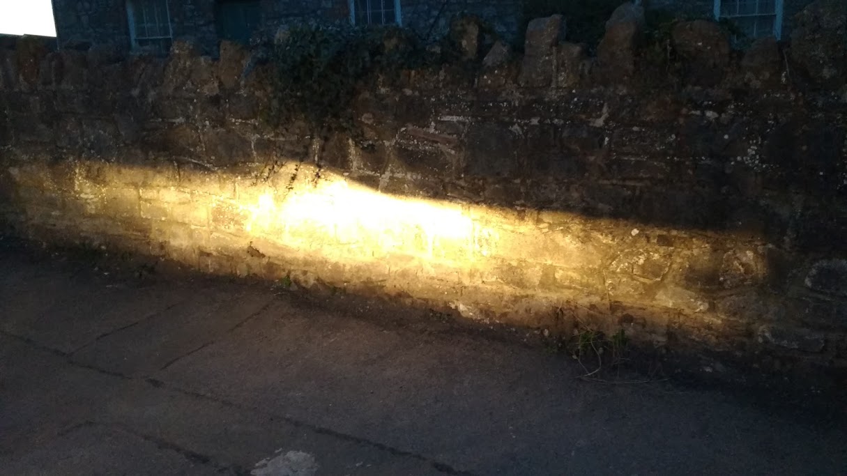

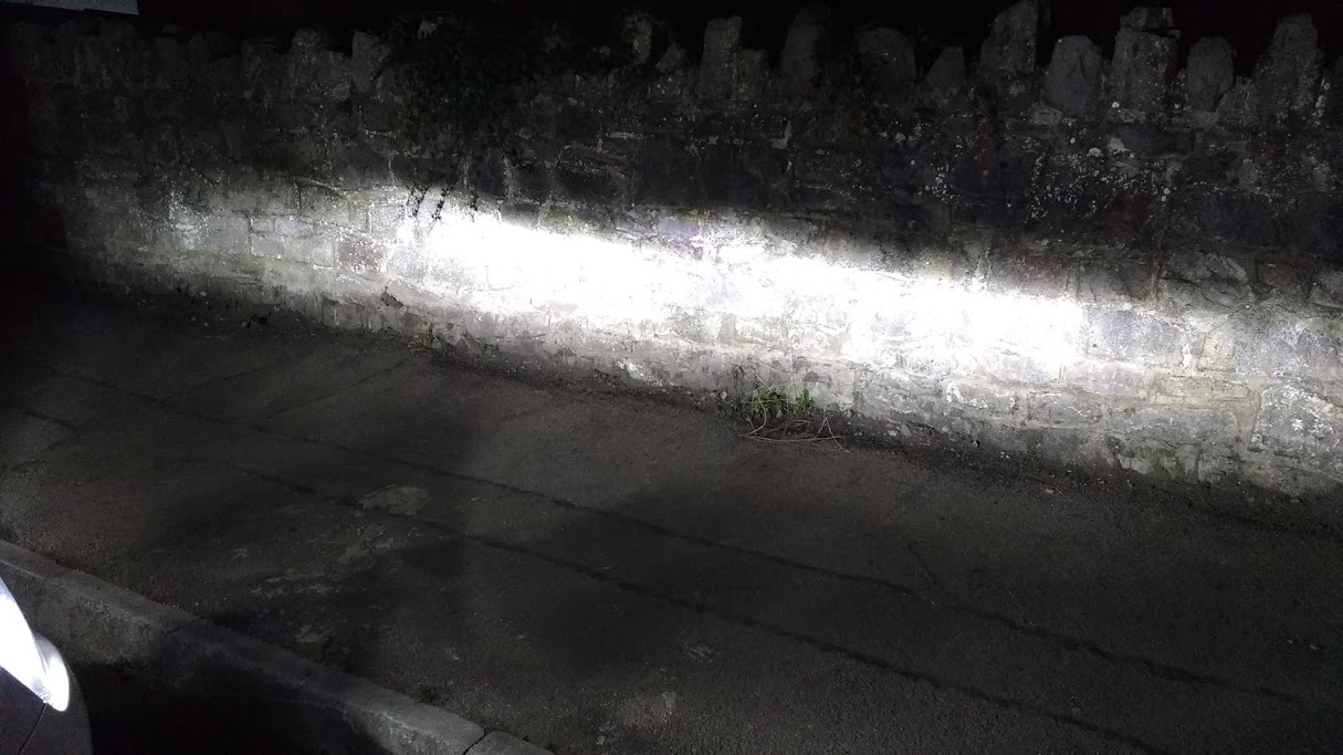

pilninggas Posted October 4, 2018 Posted October 4, 2018 Just stuck some H7 leds in the Duster: Seem pretty good, went for a quick run. the light in the middle ground is much better, cleaner and crisper. No one flashed me and the cut off seems perfect. I wonder how long they will last, they are fanless and the heatsink is touching the lamp access boot. Shep Shepherd 1
pilninggas Posted October 4, 2018 Author Posted October 4, 2018 Why?Better quality of light. Brighter, whiter, more even. Seems to work well.

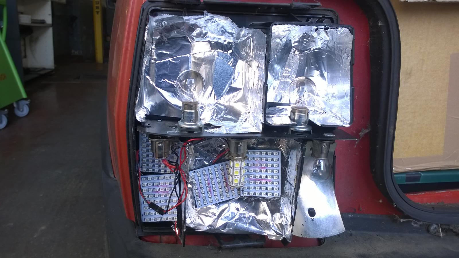

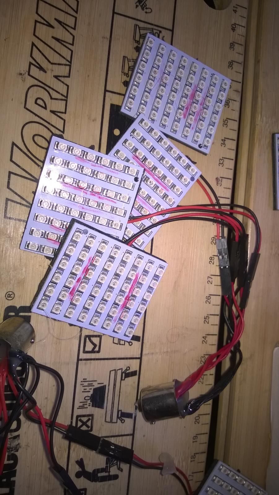

uk_senator Posted October 6, 2018 Posted October 6, 2018 I`ve tried various LED & HID`s in several of my shitters, but still not found a decent H4 replacement. HID`s have great output, but cause too much scatter, LED`s have better than halogen output, but more dead zones.None have good high beams, several you can barely see a difference between high & low beam.I usually convert tail & brake lights to LED`s though, using flexible red LED strips (the reds last, the whites don't), 48 SMD `dome` panels in parallel & high output 382`s.I also use 2" ally duct tape to improve the rear reflectors on my Fiats, as from factory they are plain black plastic, so the silver tape instantly improves them whatever bulbs your using.Obviously you can only use dome panels in some light units, ones where you cant remove the lens restricts you to traditional style LED bulbs, like my Jags. In single filament applications, they can be ok, but I've not yet found a twin filament (380) replacement that I`d be happy to use on the road.My Mk1 Uno, done last month, improved output massively: GrumpiusMaximus and Shep Shepherd 2
