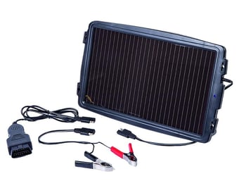

LightBulbFun Posted October 28, 2024 Author Posted October 28, 2024 8 minutes ago, wuvvum said: Would it be worth buying a solar charger to try and keep the battery topped up? As has been mentioned before, if you're doing lots of local runs, especially in the winter with lights and wiper in operation, the Dynastart might struggle to keep up even when it's working properly. I have wondered about those, but are they any good? I looked at a few back in 2021 and the reviews at the time where not great, but maybe I was looking at the wrong ones? also being winter I do wonder if it would get enough sun? I do agree the short runs and winter situation is a little bit of a problem, Ironically this is one of the reasons that I have never really considered an electric car, despite thinking one would be good for the very local trips where REV would not get warm, is that somewhat ironically given I am in Central London there are no charging points anywhere on the estate *begins to eye up the lamp post behind REV...*
GrumpiusMaximus Posted October 28, 2024 Posted October 28, 2024 Just now, Dyslexic Viking said: Good idea but is there enough sunlight in a UK winter to charge a battery? Definitely not between the months of January through to December. FakeConcern, Mally, RoverFolkUs and 8 others 11
wuvvum Posted October 28, 2024 Posted October 28, 2024 1 minute ago, LightBulbFun said: I have wondered about those, but are they any good? I looked at a few back in 2021 and the reviews at the time where not great, but maybe I was looking at the wrong ones? also being winter I do wonder if it would get enough sun? The cheap ones are pants, you'd need to spend a few quid to get one which can put any charge in at this time of year, but it might be worth it to avoid having to lug the battery up and down the stairs. LightBulbFun 1
LightBulbFun Posted October 28, 2024 Author Posted October 28, 2024 Just now, wuvvum said: The cheap ones are pants, you'd need to spend a few quid to get one which can put any charge in at this time of year, but it might be worth it to avoid having to lug the battery up and down the stairs. do you have any links? I was thinking you could just get a big enough regular PV panel and a DC-DC converter/charger and make your own, basically what they do on camper vans, and just hope no one nicks the solar panel LOL
wuvvum Posted October 28, 2024 Posted October 28, 2024 Just now, LightBulbFun said: I was thinking you could just get a big enough regular PV panel and a DC-DC converter/charger and make your own, basically what they do on camper vans, and just hope no one nicks the solar panel LOL That's probably the cheapest way of getting a decent solar charger to be honest - that's what my uncle does on his camper van and he uses that year round with no issues. Decent solar panels aren't cheap but they are a lot less expensive now than they were a few years back. You'd probably have to put the solar panel in the windscreen if you wanted to avoid it being nicked mind. LightBulbFun 1

egg Posted October 28, 2024 Posted October 28, 2024 I use an AA Solar charger (can use OBD too - not an issue for you!) which kept a dying battery going another 6 months (until it didn't!)* * I do live on the sunny Kent Coast though. Dyslexic Viking 1
plasticvandan Posted October 28, 2024 Posted October 28, 2024 I have used a large panel,it only really works on the outside of the vehicle rather than inside the screen,but really should fix the problem not the symptoms. Most likely needs brushes and commutator cleaning,and presumably there is a regulator box that would need cleaning and adjusting.of course,unless recently replaced,five years of inactivity the battery is probably past it's best now anyway. IronStar 1
