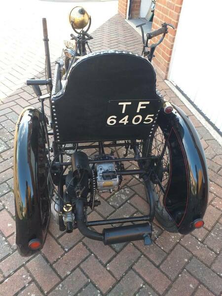

TF6405 is the 2nd Oldest Petrol Argson known to still survive for those curious (and the oldest Standard Petrol Argson), its one I have known about for a fair while and it sold at a couple auctions in the past
https://www.andybuysbikes.com/archivehtml/6984mis - Stanley Argson.html
https://www.bonhams.com/auctions/24121/lot/404/

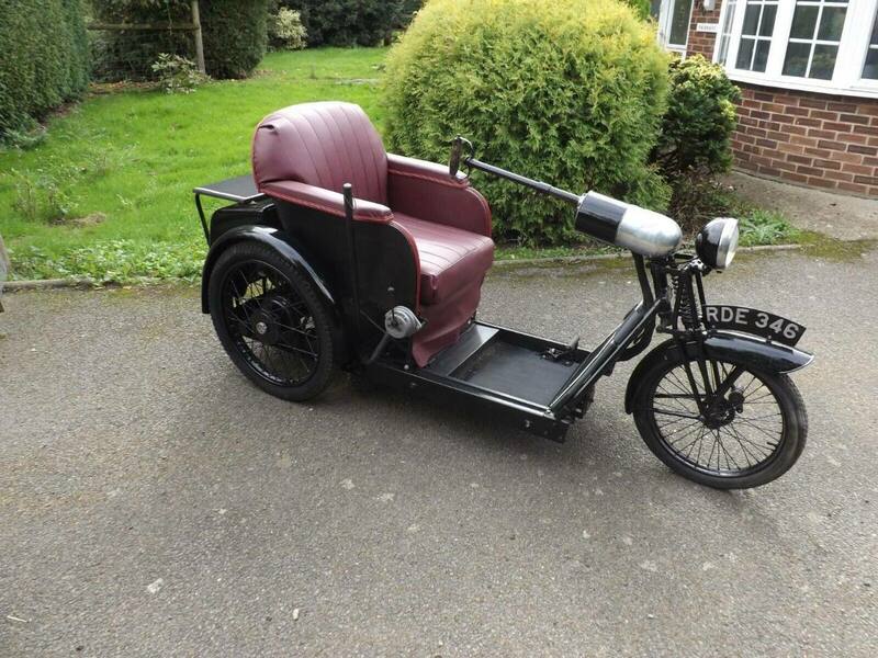

somewhat unsurprisingly sadly, TF6405 is now back up for sale having simply had its shiny bits polished and punted on for significantly more
https://www.ebay.co.uk/itm/265885674545
registration mark is not really transferable, but sadly im not sure anyone at the DVLA/DVSA know their own rules anymore, so I do fear for this machine!
hopefully this time round at least it can find a good home! I noticed the Nelco Solocar finished up at nearly £3K which is a lot for a fairly obscure electric carriage
so I do wonder if we are seeing the spillover from that listing?

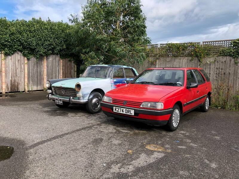

For those wondering why I haven’t posted anything about VJN in a while it’s because she’s been sold on, I recently went through the process of buying a house which unfortunately only has room for 2 cars so the 2 most practical ones remain, and the rest were sold on. I now only have my 2 Peugeots and my Lada is in a mates garage getting some work done and will be sold once it’s complete. It’s rather sad I had to sell VJN but she’s gone to a well known enthusiast

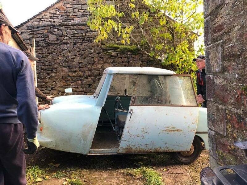

I suppose then it’s time to announce that Brian now has a stablemate. I had been waiting to get a chance to make progress with one or other car to post something of a progress report but time has been short. When Harry realised he had to thin out his fleet due to the prospect of becoming a homeowner he kindly thought of me, sadly I did not have the funds to buy VJN, however, I asked my cousin ( who had been following Brian with interest and assisting when possible) if he would like to adopt an InvaCar. He did. Actually today we did manage to get VJN (now Bryony) out for a little attention and can report that she now stops as well as goes! She has had a new stub axle fitted as well as both rear wheel cylinders. Rear wheel bearings were given a clean out and fresh grease as it appeared water had managed to get past the seals at some point. Other small jobs have been addressed and myself and Russell (Rust ole, my cousin) hope to find more time before long to continue helping both Brian and Bryony back toward the roads on which they belong.
Best wishes with the house Harry.

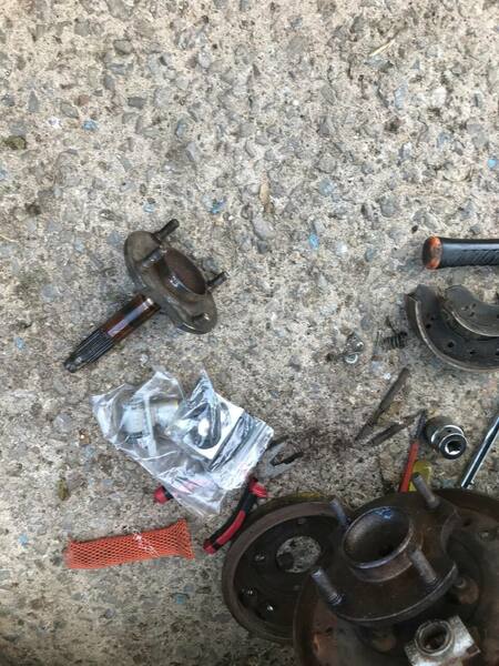

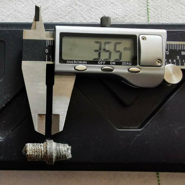

Where did you find the stub axle?!?  I've been after one of those since September 2019!
Russell appeared with it from the parts bin that came with the car after finding that one of the wheel studs had been sheared and another cross threaded. What is the problem with yours? I know the old one that came off is still kicking around under the bench and is in good shape other than the studs which could be drilled out and replaced.
Funnily enough mine had to be reworked for the 12e (different but very similar stub) as the main retaining stud was chewed up badly, it was machined off and drilled out to accommodate new.
One broken and one bent stud originally.  Since drilled out to accept bolts, but I don't 100% trust it.  The original studs are emphatically not standard.
I do have an original Fiat hub (they were modified to accept studs in the Mini etc pattern by the Invacar factory as far as we can tell), but so far have drawn a blank on finding anyone who will machine it to accept either standard studs or bolts.
I can't remember exactly what the thread sizes involved were - but the studs have a different thread on the bit that goes into the hub versus the bit the wheel nut screws onto - and there's also a blob of weld on the inner face to prevent them (in theory) from being able to unscrew out of the hub.
Edit: Wait...that hub is totally different to mine...
Mine has the original (4x100mm I think) Fiat wheel bolt pattern, with the studs having been added afterwards...also doesn't have the two cutouts in.  Odd!
I can't remember either, but Six-cylinder did manage to get a pack of them, as Dolly has a snapped stud also. IIRC they are Land Rover exhaust manifold studs. I'll ask him...
That would be about right...something readily and cheaply available that's been sitting under my nose the whole time!
I was pretty sure they'd be off something common as it seemed totally out of character to have had a part used in such numbers specifically machined for the car.  I was buggered if I could figure it out though.
The one hole got well and truly mangled though which is why it was drilled out to accept a standard metric wheel bolt, guess welding and re-drilling would be the correct way to sort that.  Though it wants doing with the hub off the car.  Trying to sort it in situ is how I screwed the threads up in the first place.
6 hours ago, Zelandeth said:
Those cutouts will make working on the brakes immeasurably less awkward...
They were noted at the time as being a big help.
Russell did bring another hub with him which was a full disc but I'm almost certain it was for a Mk12, keyway for a drive flange rather than splined as with the model 70. I should get chance to double check tomorrow.
If the one you've replaced is something you'd be willing to part with I'd definitely be very interested in as it sounds far more easily sortable than my one, which I don't reckon I'll ever have 100% confidence in.
Especially as it sounds like we've possibly tracked down what the damned studs actually are.  That's a job any good machine shop should be able to do I'd hope.
Would be nice to not be silently slightly distrusting my workmanship every time I turn right!
are you sure about this? I seem to remember there being a bag of studs purchased at the time as you say for Dolly, but dont recall them being the right type
obviously very happy to be proven wrong here, but Model 70 wheel studs are 3/8th inch BSF on the hub side and standard 3/8th inch UNF 24 TPI (like what you find on a classic mini) wheel side
and I have never found anything that was 3/8th inch BSF one one side and 3/8th inch UNF on the other side
AFAIK the these wheel studs are bespoke to invalid vehicles (I BELIVE they are also used on Pre Model 70 AC's and maybe Invacars too)

This.  BSF/UNF is an unlikely "stock" combination, as it is mixing standards from 2 different eras - I would be surprised if even Land Rover did that, but it's possible.  Also it is not a conventional stud, as it has the central shoulder to locate the brake drum.   It is almost certainly an AC /Invacar special.
Now, grumpy time.  There is no problem in making a few of these.  I have a lathe and the tooling, and I discussed it with someone here when the matter first arose.   Don't recall who it was now, and it doesn't matter, but I know what it is like being stuck for silly parts and I was only trying to be helpful.   I made a couple of trial pieces, but obviously I needed accurate dimensions, or a genuine stud to copy, before going ahead.   I never heard any more from the guy.
If he wasn't interested, fine, but a polite "thanks but no thanks" would have been appreciated.   I won't be making any more.
The response I got from the couple of machinists I spoke to was that they couldn't replicate it because the original threads were roll formed which they didn't have the kit to do.
I'd gladly have sent an original one as a pattern for you though I don't think I have any of them left now as the three intact ones all were sent to potential machinists and never came back.
I really hope it wasn't me who left you hanging back then, given how bloody awful I can be of keeping tabs on multiple threads I wouldn't have put it past me.
Russell says it’s all yours Zelandeth.
the other three studs look fine, it must have been the nuts that were mangled and they have also been replaced.
4 hours ago, Mr Pastry said:
@ZelandethI honestly can't remember - as you say we all have loads of stuff to keep tabs on, and I had forgotten about it until reading the posts yesterday.   I think I binned the trial ones!
They don't need to be thread-rolled if you are only making a few and are prepared to faff around a bit.  As far as strength goes, the originals don't seem to be too clever, so I think it would be possible to improve on that or at least equal it.
I was going to make them individually on the lathe and die-cut the threads.  Possibly try a couple of different materials and make a few spare ones for testing - as in, torque them up and see how much it takes to break them.
Wouldn't necessarily need a pattern but it would be up to you, or whoever, to supply the correct dimensions.  The shoulder is the critical bit.  I'd also be concerned about the fit in the hub flange without having a hub to try it in, so that would be up to the fitter to assess.

I had three "good" studs after extracting them from the hub - though they were all mangled somewhat, either before or during removal.
All three of those were sent off and never seen again, so the only ones I have now are currently holding wheels onto the car.
These were the measurements I got of the ones I had (that I can still find).
Of course I can't find one of the shoulder - though I had a dig around earlier and found the remains of the broken stud, so I'll grab measurements from that tomorrow.
12 hours ago, Mr Pastry said:
Yep that all looks good.  Just need the diameter and length of the shoulder - max. dimensions if it is mangled - failing that, the corresponding dimensions of the hole in the brake drum although I guess you don't have a spare one to measure.
The drums aren't (in my case anyway) an especially snug fit over the shoulder.  It mainly seems to be there to just help centre things during assembly as best I can tell.
Just measured the remains of this one.
Which equates to exactly 1/2" if I remember right.
It was actually properly in the jaws when I took the photo by the way, I just placed things there for clarity after taking the measurements.
3.9mm leaves a fractional amount of play between the lip and the feeler gauge - though I've just taken a look at a spare drum and the depth of the shoulder could easily be a little larger.
The depth of the face of the drum is 5.4mm on the nose (0.2125" - sorry, this thing doesn't do fractions!), so your suggested value should be fine.

Getting the old ones out basically involved locking two wheel nuts together and unbolting them.  There's a little blob of weld tacked on the inside of the hub that needs to be cracked off first.  Now I know that it's something I'd do with the hub off the car (which I've always resisted doing given how much of a song and dance the manuals make about setting the wheel bearing preload), would be a simple matter of buzzing that off with the grinder.
Three of my four came out pretty easily, however there was one which just kept snapping closer and closer to the hub eventually ending up totally flush to it.  Which is the one I drilled out - made a meal of and wound up having to drill oversize, tap, had the tap mess up the threads, drill out again and retap...
With the hub off the car it shouldn't be a difficult job.  To be fair 99.9% of the headaches I had were because I was trying to do the work in situ.  That was an absolutely bloody stupid idea, I should have just taken the damned hub off.
If there wasn't anything to grip on the front of the hub I imagine you could grind a slot in the back of the stud then whack it with an impact driver that way.
