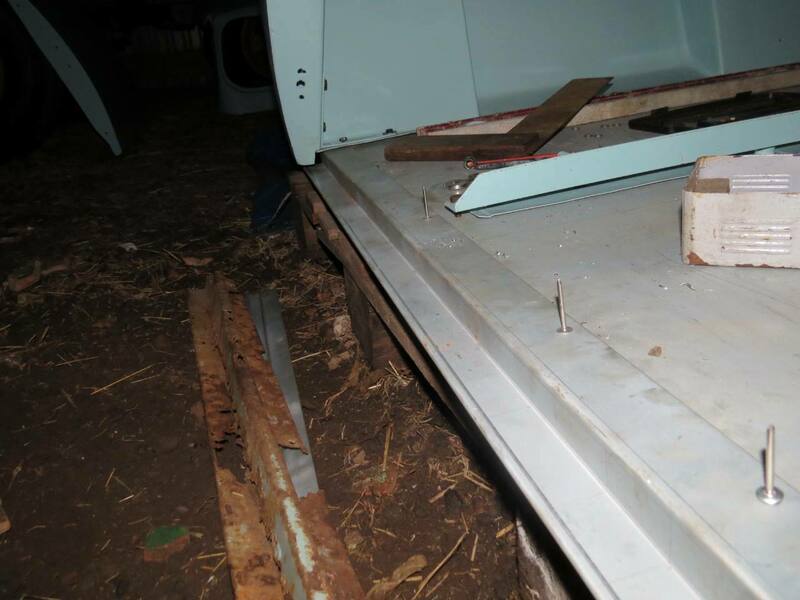

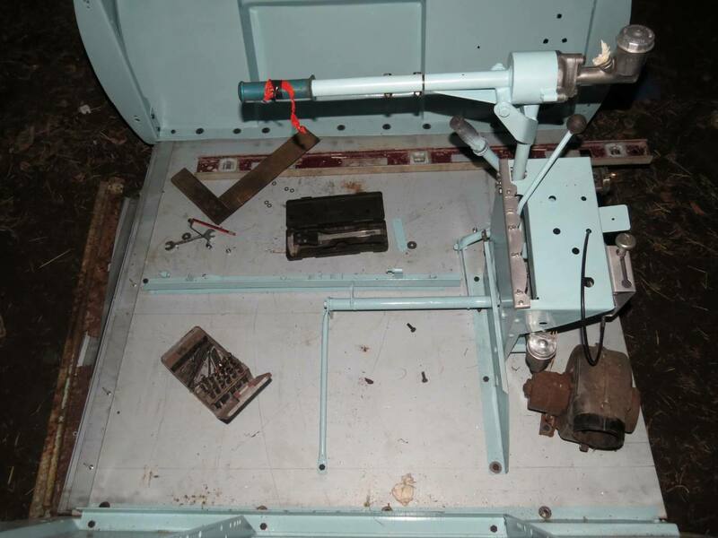

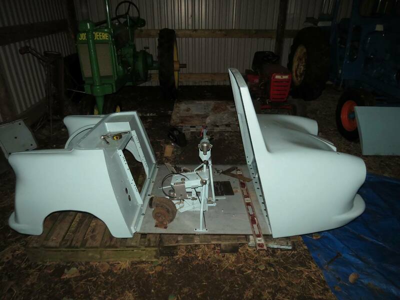

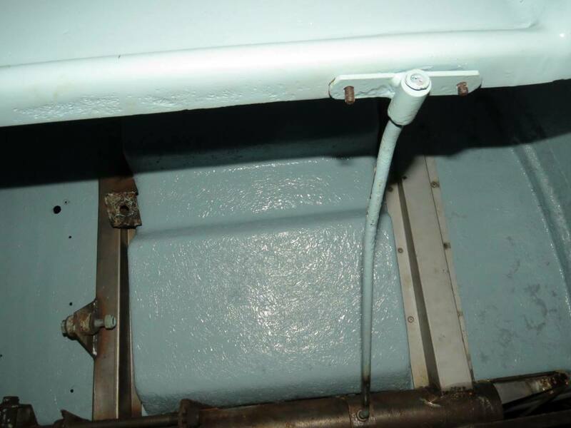

AdgeCutler Posted December 30, 2021 Posted December 30, 2021 At last I've managed to sneak out of work and family commitments and have a day out with Brian the Mk12e. The task was to get the chassis, floor and some reproduced fixtures drilled to enable it all to fit together, I'm not quite finished but most of the more critical holes have been drilled. All this was made quite tricky due to the fact that the original components are so rotten and lacking rigidity and also have great chunks missing entirely due to rust. It is also true that InvaCar must have hired a Chimp or drunkard to do this job originally as a lot of the holes on the old chassis had been double drilled or slotted, this also made the job harder. All that remains to be done drilling wise now is to drill a series of rivet holes along the outrigger flanges/floor, this shouldn't take so long as the six hours taken measuring, measuring again, fitting up, removing, measuring again and marking, drilling, re-fitting (yes I'm a slow worker!). Once they're drilled it can all come apart once again, clean and wire brush the new chassis which is still covered in flux and also starting to show surface rust and then slap a bit of paint on. Mr Pastry, LightBulbFun, Mrs6C and 7 others 10
LightBulbFun Posted December 30, 2021 Author Posted December 30, 2021 3 hours ago, AdgeCutler said: At last I've managed to sneak out of work and family commitments and have a day out with Brian the Mk12e. The task was to get the chassis, floor and some reproduced fixtures drilled to enable it all to fit together, I'm not quite finished but most of the more critical holes have been drilled. All this was made quite tricky due to the fact that the original components are so rotten and lacking rigidity and also have great chunks missing entirely due to rust. It is also true that InvaCar must have hired a Chimp or drunkard to do this job originally as a lot of the holes on the old chassis had been double drilled or slotted, this also made the job harder. All that remains to be done drilling wise now is to drill a series of rivet holes along the outrigger flanges/floor, this shouldn't take so long as the six hours taken measuring, measuring again, fitting up, removing, measuring again and marking, drilling, re-fitting (yes I'm a slow worker!). Once they're drilled it can all come apart once again, clean and wire brush the new chassis which is still covered in flux and also starting to show surface rust and then slap a bit of paint on. its really awesome to see how Brian is continuing to come together! I trust that you do plan to rust proof and paint the chassis before everything is put together for for the final time? after you done with Brian you should be able to write a proper old school haynes manual on the Invacar Mk12E with how in depth you have gone!
