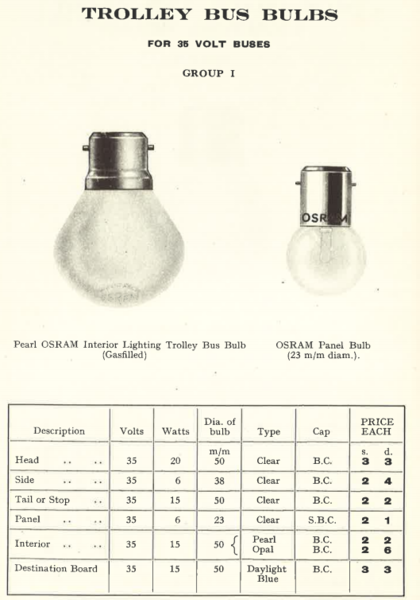

Mr Pastry Posted October 22, 2021 Posted October 22, 2021 2 hours ago, LightBulbFun said: I mean im still trying to figure out what the saloon lighting in London Trolly buses was I was thinking about that. My recollection (from 1962?) is that they had golf ball shaped lamps like RTs. And you wouldn't run the headlamps on 600 volts either. I would guess that there would be a motor-generator set to produce low voltage to run the lighting and the motor control system, and of course you would need a compressor set if using air brakes. But I am guessing - @Inspector Morose? LightBulbFun 1
LightBulbFun Posted October 22, 2021 Author Posted October 22, 2021 39 minutes ago, Mr Pastry said: I was thinking about that. My recollection (from 1962?) is that they had golf ball shaped lamps like RTs. And you wouldn't run the headlamps on 600 volts either. I would guess that there would be a motor-generator set to produce low voltage to run the lighting and the motor control system, and of course you would need a compressor set if using air brakes. But I am guessing - @Inspector Morose? and then theres this thing which I have been able to find 0 info on which may just have run on 600V being a discharge lamp, I swear I recall finding it in an Osram GEC catalog somewhere but I just checked a few from the 1930s, 50's and 60's and was not able to find it there, what is it to be indicating for exactly I wonder... Osglim was the Brand name GEC used on its negative glow neon lamps back when it was restricted to only being able to use its Osram band name on tungsten filement lamps and also why its carbon filament lamps where branded Robertson, but I digress I did however find this in the 1938 catalog, which might give us some clues as to the mystery of the trolley bus bulbs catalogs from the 50's and 60's do list trolly bus lamps, but the big difference is the interior lamps where all listed as having 38Mm diamiter bulbs but all the London Transport trolleys iv "seen" have used 50Mm bulbs (again same as the RM/RT, etc) so perhaps they used a development of the 1938 version? heres the same section from the 1960 catalog, note no 50Mm bulbs but I would not be surprised at all if London Transport had some sort of bespoke Light Bulb made, the interior Light bulbs used in RTs and RM's for example is a bespoke type for London Transport I have not been able to find in any period catalog (22W 24V 50Mm diameter bulb) Yoss 1
Mr Pastry Posted October 22, 2021 Posted October 22, 2021 2 hours ago, LightBulbFun said: and then theres this thing which I have been able to find 0 info on which may just have run on 600V being a discharge lamp, I swear I recall finding it in an Osram GEC catalog somewhere but I just checked a few from the 1930s, 50's and 60's and was not able to find it there, what is it to be indicating for exactly I wonder.. There is a reference in this video at about 3.44, to an indicator light fitted high up on the trolley poles (at the roadside, not on the bus) to show which way the points in the wires were set. In which case a compact but bright 600 volt lamp would make sense. How it works is another matter. LightBulbFun and Yoss 2
Inspector Morose Posted October 22, 2021 Posted October 22, 2021 London trolleybuses used 24v lighting circuits fed by a motor-generator set mounted on the chassis on the offside. Other operators who didn’t want the complication of all that just used series circuits of 5 110v bulbs. There generally was generally no shunt so if a bulb failed, that circuit went out. As there were three other circuits lighting the interior of the bus, it didn’t matter that much. There was low voltage lighting for headlamps, trafficators/indicators and the cleaners lights which could be either 12v or 24v depending on preference of the operator. This simply used a battery that was charged by a dynamo belt driven from the output shaft of the traction motor via a standard control box. On the Bradford front loaders, the lower deck side panels had resistance wire embedded into asbestos blanket material mounted behind the facia. This 600v ‘electric blanket’ made for quite an efficient heating system and was enough to take the chill off on a cold day, the platform doors helping to keep the heat in. adw1977, Mr Pastry, busmansholiday and 1 other 3 1

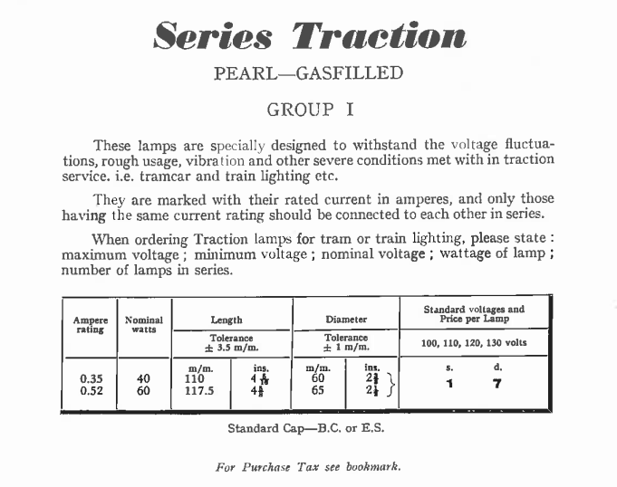

LightBulbFun Posted October 22, 2021 Author Posted October 22, 2021 5 hours ago, Mr Pastry said: There is a reference in this video at about 3.44, to an indicator light fitted high up on the trolley poles (at the roadside, not on the bus) to show which way the points in the wires were set. In which case a compact but bright 600 volt lamp would make sense. How it works is another matter. interesting I always assumed, the lamp was for something on the trolley bus itself but you are right it could be something to do with their infrastructure as well (I know of a few odd ball London Transport specials there as well like the Dual filament 100V lamp used in London underground signalling) 3 hours ago, Inspector Morose said: London trolleybuses used 24v lighting circuits fed by a motor-generator set mounted on the chassis on the offside. Other operators who didn’t want the complication of all that just used series circuits of 5 110v bulbs. There generally was generally no shunt so if a bulb failed, that circuit went out. As there were three other circuits lighting the interior of the bus, it didn’t matter that much. There was low voltage lighting for headlamps, trafficators/indicators and the cleaners lights which could be either 12v or 24v depending on preference of the operator. This simply used a battery that was charged by a dynamo belt driven from the output shaft of the traction motor via a standard control box. On the Bradford front loaders, the lower deck side panels had resistance wire embedded into asbestos blanket material mounted behind the facia. This 600v ‘electric blanket’ made for quite an efficient heating system and was enough to take the chill off on a cold day, the platform doors helping to keep the heat in. ooh interesting! thank you for the info (im guessing then if LT Trolleys used a standard 24V lighting circuit then they also used the standard LT issue 24V 22W lamp, I wonder in general when that lamp first came to be...) the 5 110V bulbs you talk about, they are not the traction lamps I mentioned above are they? as the lamps themselves where often of about 110V although nominally rated by the burning current rather then voltage (because its a series string) I do wonder what they did on the gas filled ones to prevent internal arcing at end of life on the 600V supply if there was no shunt device later at some between 1938 and 1951, Osram GEC did introduce a Lower voltage higher current traction lamp that did have an internal shunt always found it interesting that these Low voltage ones where Edison screw only, given the high vibration setting they where to be used in id of expected them to use a bayonet base
Inspector Morose Posted October 22, 2021 Posted October 22, 2021 Traction lamps are exactly what it says on the tin - lamps for traction (i.e trams, trains, trolleybuses). They were specifically extra super duper heavy duty because of the harsh environment they existed in. With voltage fluctuations, power could go up as well as down as there were some instances of operators specifying, or at least trying out, regenerative braking. Here the line voltage could rise quite high (not to Maidstone 72 levels) so lighting had to cope with that too. In the cab, there was the dewirement indicator with a single bulb and a buzzer that would sound if traction current was lost. At Sandtoft there used to be a multitude of dead sections for their overly complicated overhead set-up so the bus sounded like it was sending messages in Morse code every time it ran a circuit! That London film might be showing an auto frog. Here, there was no manual operation by the conductor, the frog would operate only if the driver drew power over a particular section, hence the greater need for an indicator. Most frogs were manual ones operated by the conductor (or frog boy on particularly busy junctions or at rush hour) so there was no need for any other indication - if the poles went the wrong way, a shout and waiving conductor would suffice to draw the drivers attention that something was wrong. I must stop going on about trolleybuses and leave you all alone. LightBulbFun 1
LightBulbFun Posted October 22, 2021 Author Posted October 22, 2021 1 hour ago, Inspector Morose said: Traction lamps are exactly what it says on the tin - lamps for traction (i.e trams, trains, trolleybuses). They were specifically extra super duper heavy duty because of the harsh environment they existed in. With voltage fluctuations, power could go up as well as down as there were some instances of operators specifying, or at least trying out, regenerative braking. Here the line voltage could rise quite high (not to Maidstone 72 levels) so lighting had to cope with that too. oh yes I know what they are I was just verifying that it was that was the type of lamp you where referencing when you said 110V lamps 5 in a string does anyone still make dedicated traction lamps still or do museums etc just use regular 110V lamps these days I wonder but the one thing I was wondering about the traction lamps is what did they do for arc suppression, even on 240V an incandescent lamp can and does arc over at end of life its why they go PINK or BANG when they burn out see an electric arc (as you probably know) is a negative resistance thing, so the more power goes into it the more its resistance drops which allows more power to flow etc etc until something blows up (this is why discharge lamps have ballasts you need something to regulate that current flow) so mains voltage lightbulbs (good ones anyway) have built in fusing that blows when arcing happens but on something like a series string found in a trolley bus, this method of arc prevention does not work as the other lamps in the string will act as a ballast limiting current flow so no fuse can do its job, and as such an arc can burn away until total destruction happens, heres a fun video demonstrating that so in lamps used in such series strings (be it Traction lamps or 6.6A US Series street-lighting lamps etc) some alternative method of arc quenching is usually used, (normally something that just shorts the lamp should it go open circuit or an arc form) and so im curious on these series strung traction lamps what that might be (especially as it does say they are gas filled and are not vacuum lamps) 1 hour ago, Inspector Morose said: In the cab, there was the dewirement indicator with a single bulb and a buzzer that would sound if traction current was lost. At Sandtoft there used to be a multitude of dead sections for their overly complicated overhead set-up so the bus sounded like it was sending messages in Morse code every time it ran a circuit! That London film might be showing an auto frog. Here, there was no manual operation by the conductor, the frog would operate only if the driver drew power over a particular section, hence the greater need for an indicator. Most frogs were manual ones operated by the conductor (or frog boy on particularly busy junctions or at rush hour) so there was no need for any other indication - if the poles went the wrong way, a shout and waiving conductor would suffice to draw the drivers attention that something was wrong. hah thats quite amusing, a fun mental picture of some 12 year old running across a busy london street dodging road traffic franticly switching frogs about to keep the trolley buses moving which amusingly is quite similar to the video game Frogger LOL 1 hour ago, Inspector Morose said: I must stop going on about trolleybuses and leave you all alone. no no please do continue when you want to, I very much enjoy the stories and info Trolley buses are one of those things I find quite mysterious almost, because even Old motor buses you can still go and see them in action etc and bus rallies etc or randomly driving about as their owners take em out for a spin but you just cant do that with a Trolley bus of course, they are outside of a few special locations, forever barred from the road! which is quite sad tbh

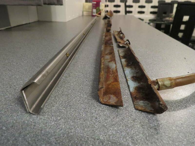

AdgeCutler Posted October 26, 2021 Posted October 26, 2021 It's been a good while since I checked in properly and Brian has been somewhat neglected for a while as life has been somewhat of a blur. Looks like I have plenty of posts to catch up on in the thread. Anyhow a few little jobs have been done including a new door rail and the two front floor mounts being fabricated. I'll be back to completing the new chassis before too long with a little luck. LightBulbFun, Mrs6C and 500tops 3
Mrs6C Posted October 26, 2021 Posted October 26, 2021 14 minutes ago, AdgeCutler said: Anyhow a few little jobs have been done including a new door rail and the two front floor mounts being fabricated. I'll be back to completing the new chassis before too long with a little luck. Well done! LightBulbFun and AdgeCutler 2
LightBulbFun Posted October 26, 2021 Author Posted October 26, 2021 18 minutes ago, AdgeCutler said: It's been a good while since I checked in properly and Brian has been somewhat neglected for a while as life has been somewhat of a blur. Looks like I have plenty of posts to catch up on in the thread. Anyhow a few little jobs have been done including a new door rail and the two front floor mounts being fabricated. I'll be back to completing the new chassis before too long with a little luck. Oh awesome! I had been wondering recently how you and Brian where doing given it has been a little bit since we last saw a post glad to hear things are progressing still with Brian I look forward to seeing more! and I hope the rest of things are going well with yourself AdgeCutler 1
AdgeCutler Posted October 26, 2021 Posted October 26, 2021 Yep, all fine here thanks Dez, it's all just been a very crazy time with work, work, work, responsibilities, family, favours, a few more of them and a bit more. I do like to moan about it at times, "Ee wunt be 'appy if ee wunt moaning" but I do bring a lot of it on myself and I'm happy with the life I've forged apart from when playtime becomes short. Ssshhhhhh, don't tell anyone! LightBulbFun, Mrs6C and CaptainBoom 3

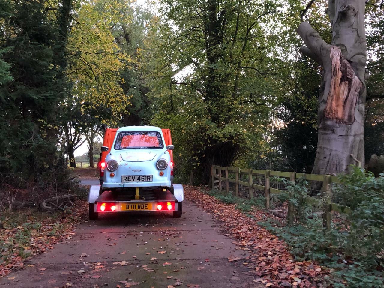

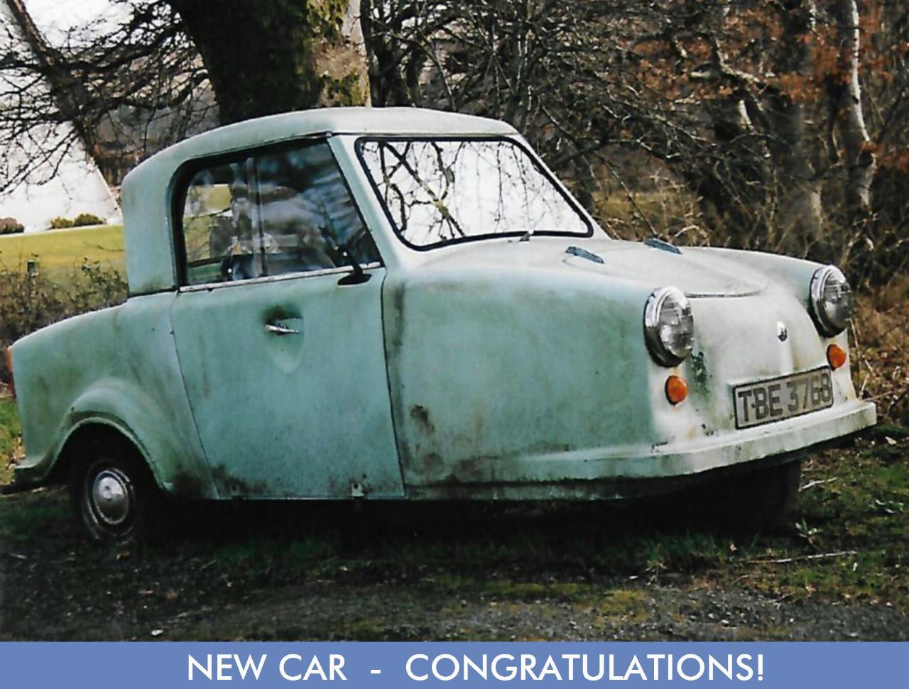

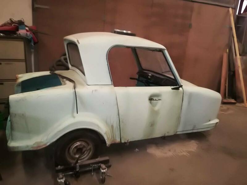

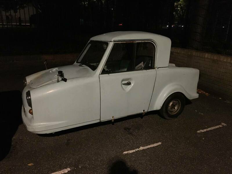

LightBulbFun Posted November 6, 2021 Author Posted November 6, 2021 Today (well yesterday if you want to be technical LOL) was a big day today! not only was it REV's 45th Birthday but at long last after over 2 years in the making with regard to REV, she is home! Finally! its quite the momentous occasion for me, and in general its been over 3 years in the making from when I first started hunting for a Model 70, I have my very own Model 70 at home! I give a massive thanks to @adam1db for taking her on for me and getting her road legal and @st185cs for moving her between locations for me now the journey of my personal independence can finally start hopefully! it was all a bit sudden and touch and go hence why theres not been many posts about it! but she is finally home Woo! not yet had a drive as it was quite late when she arrived but hopefully tomorrow I will do so I am very much looking forward to it, hell it was just nice to sit in her for the first time in forever but I am also quite nervous LOL this will be my first time driving on my own without someone else with me on the public highway and the first time on the public highway in my Invacar! main thing im hoping is I really hope she has good brakes now LOL and there are a few smaller bits and bobs that ideally need sorting out like her twist grip still needs replacing and general throttle cable setup is still very stiff/takes a fair bit of force to actuate and I have been told that she apparently has developed a charging fault where the light goes out when you get moving as it does normally, but comes back on once your at speed, which is a bit of a weird fault not one iv heard of before! but we will see if that crops up or not tomorrow! I just need to stop thinking about all the things that could potentially go wrong and start thinking about all the good things! in the meantime heres a few pics from the collection caper from Adams to Mine hopefully tommorow ill have pictures of her parked outside my local chippy or something such once again many thanks to @adam1db and @st185cs for everything and many thanks to everyone else who has been involved and supported me during these 2 years! heres to the next 2 and many more as they say! 3VOM, brownnova, Mr Pastry and 34 others 37

JJ0063 Posted November 6, 2021 Posted November 6, 2021 Great news! If you haven’t already sorted something, please please please buy some decent security for it. If I recall you live in London? This will be very easy to break into and hot wire for a joy rider. Get yourself as much obvious security as you can, be it a wheel clamp, some kind of steering lock if you can, a battery isolator etc too. Get a Sold Secure Gold motorbike chain, literally anything and everything you can. Id hate for you to lose it after all this effort but I know from my job how much vehicle theft goes on in the world! LightBulbFun, Eyersey1234, Dick Cheeseburger and 3 others 6
Mrs6C Posted November 6, 2021 Posted November 6, 2021 Just realised that the last picture is REV's parking space behind your neighbour's SD1! That space has been waiting all these years for a smoll Invacar to turn up and fill it! LightBulbFun and Eyersey1234 2
brownnova Posted November 6, 2021 Posted November 6, 2021 This is superb news!! Honestly, from the day you joined (and much longer too) this is all you have wanted... and now you've got it! Enjoy it. And I thoroughly expect you to do AS zoom from inside Rev this week like I did when I bought the TransSport! Dick Cheeseburger, Mrs6C, LightBulbFun and 2 others 3 2
LightBulbFun Posted November 6, 2021 Author Posted November 6, 2021 Thanks all it happened all so suddenly its still a bit hard to believe it happened, but I just checked and she is still there! indeed security is one of those things I have thought quite a bit about I have some ideas, but I am also worried if I do something like put a big fuck off chain around one of her chassis legs and tie her to a lamp post, that might draw more attention to herself, but it is an idea I am thinking with! 40 minutes ago, Mrs6C said: Just realised that the last picture is REV's parking space behind your neighbour's SD1! That space has been waiting all these years for a smoll Invacar to turn up and fill it! indeed its amusing just how well she fits in there! and quite impressive that @st185cs managed to squeeze her in there! I just hope Ill be able to squeeze her back in there after my drive! 35 minutes ago, brownnova said: This is superb news!! Honestly, from the day you joined (and much longer too) this is all you have wanted... and now you've got it! Enjoy it. And I thoroughly expect you to do AS zoom from inside Rev this week like I did when I bought the TransSport! Yeah! Just crossing all of the appendages now I have it, that I hope I can keep it going! and Yeah the thought did cross my mind! ill have to see if I can at least for a short period of time! (ill have to tether my iPad to my Phone which means finally activating my PAYGO phone voucher I have managed to nurse along for about 2 months now LOL) Eyersey1234 1
