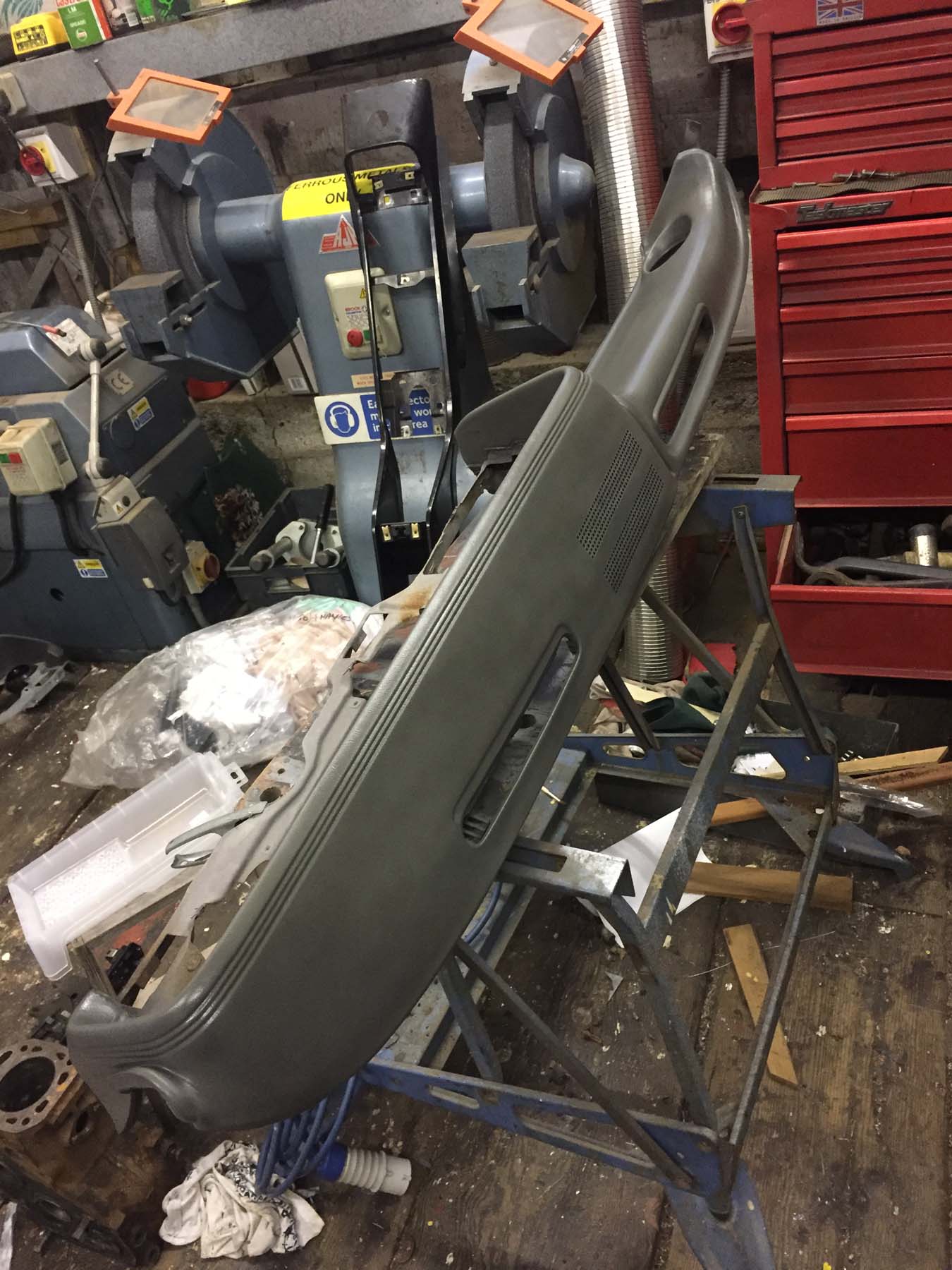

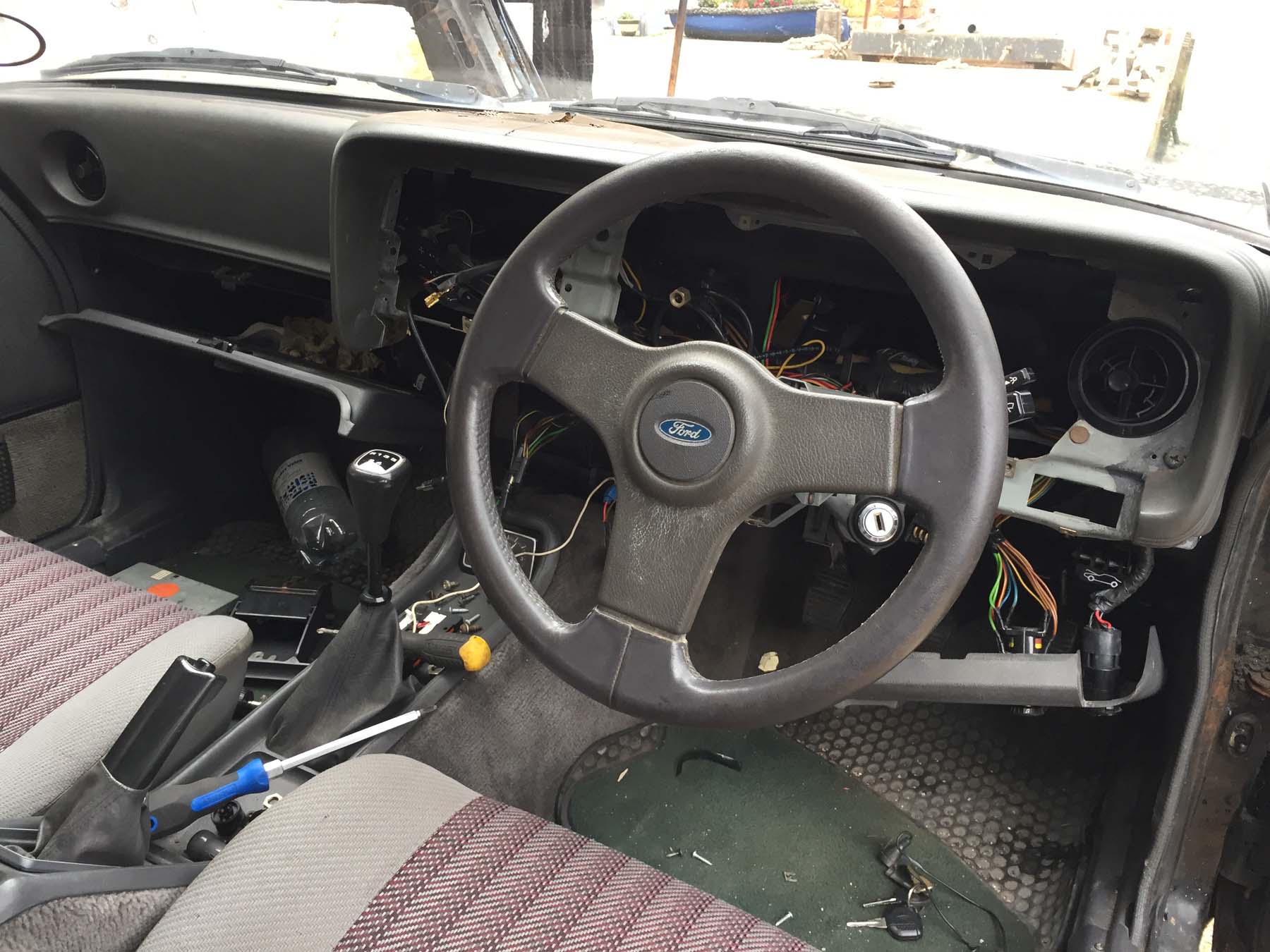

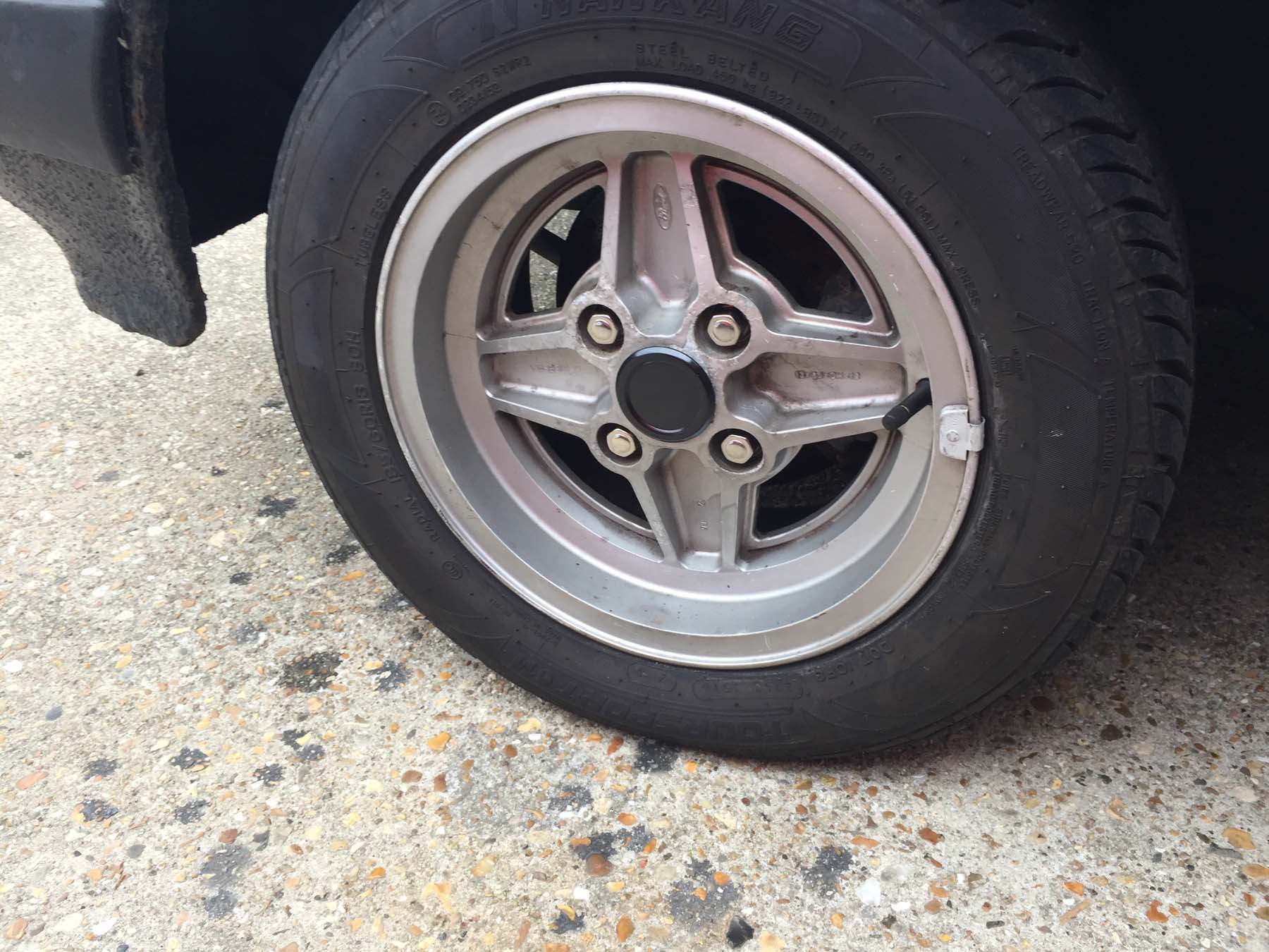

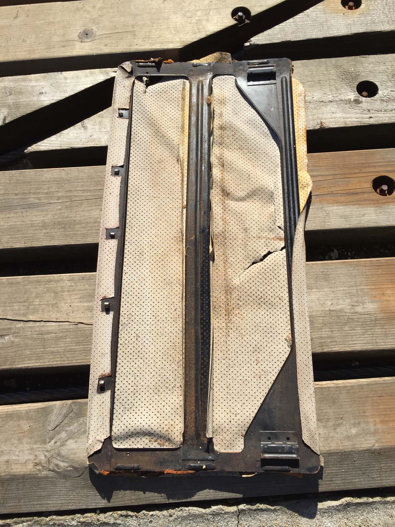

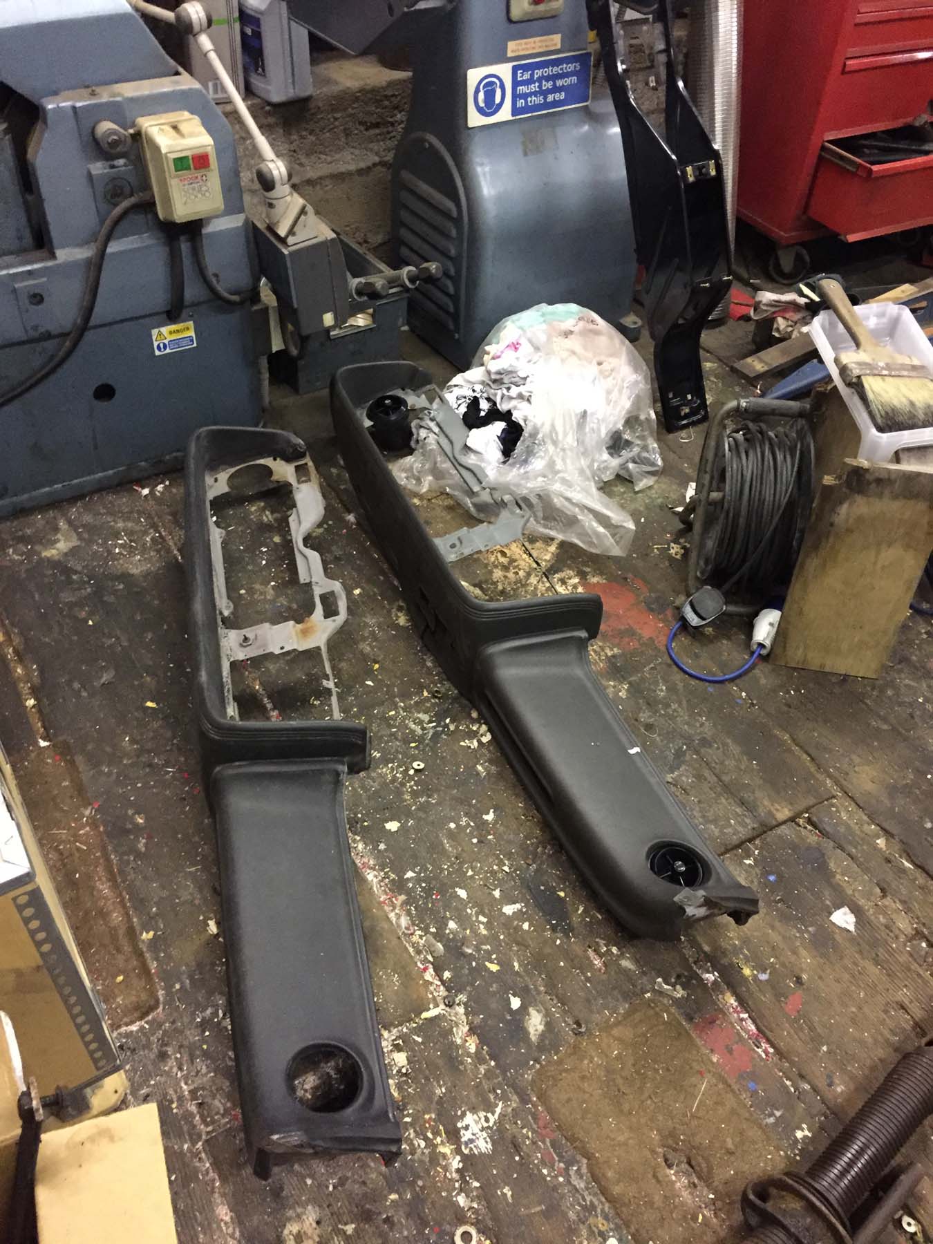

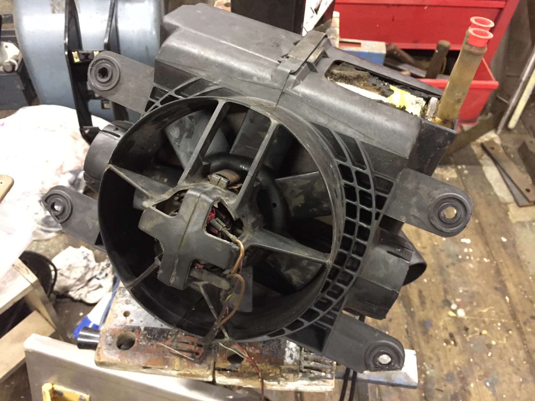

coalnotdole Posted November 4, 2018 Author Posted November 4, 2018 Well predictably the whole "spend the minimum and just use it" plan has gone to sh*t almost immediately! Money was spent on centre caps and correct nuts for the four spoke wheels: After the peak district trip I removed the dash in order to get the non functioning heater out, At the same time I sorted out some lash up wiring and fitted a replacement electric aerial wired as per factory. I then realised my mint replacement dash was black rather than grey and given the rareness of undamaged ones ended up spraying it in vinylcote which came out pretty well. Sorted out a non functioning ammeter and replaced a lot of missing trim clips while it was all apart. Fan motor turned out to have seized and melted one of the brush holders - I managed to unstable the motor body and get the bearing out and freed up and its back together and working now but only has a few mm of brush left on the damaged holder. I managed to pick up a 2ltr rocker cover from eBay with the correct captive nuts for the weber air filter but its a narrow rim cover rather than the wider type so I drilled them off and have mig'ed them to my existing rocker cover: Also fitted a new sunroof seal from the capri club which turns out to be a different construction to original (flocked rubber as opposed to velvet fabric on a silicone core) and a bit crap for the £40 it cost - Apparently the £80 seal from a mk2 golf is actually the correct type and still available from the OE supplier to ford, in hindsight I should have gone for that instead. I have popped out the headlining carrier while there and am waiting for our cover maker to stitch up a new panel to fit to it: Next post is where it really starts to get out of control... Dave Skizzer, dome, vulgalour and 13 others 16

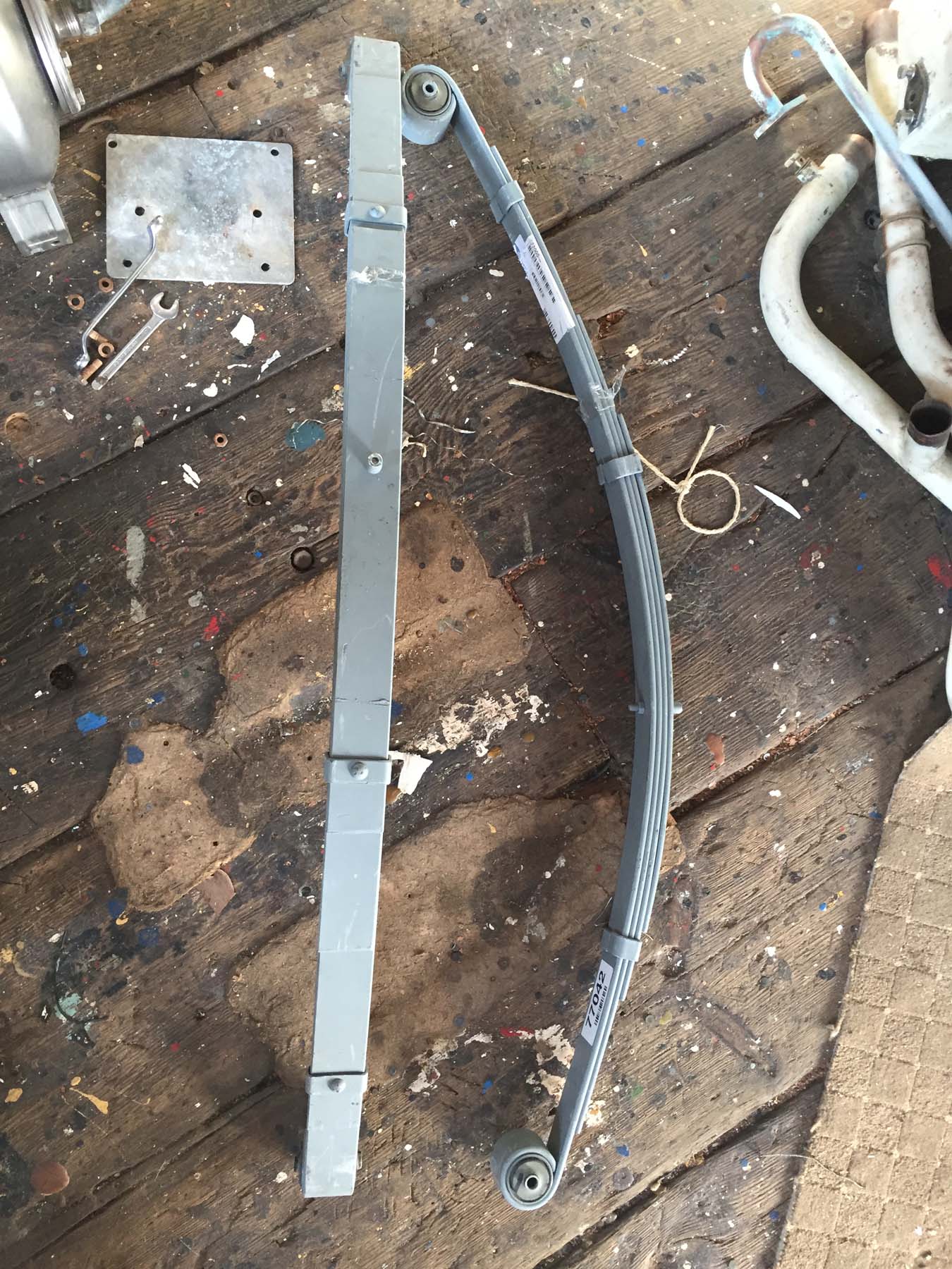

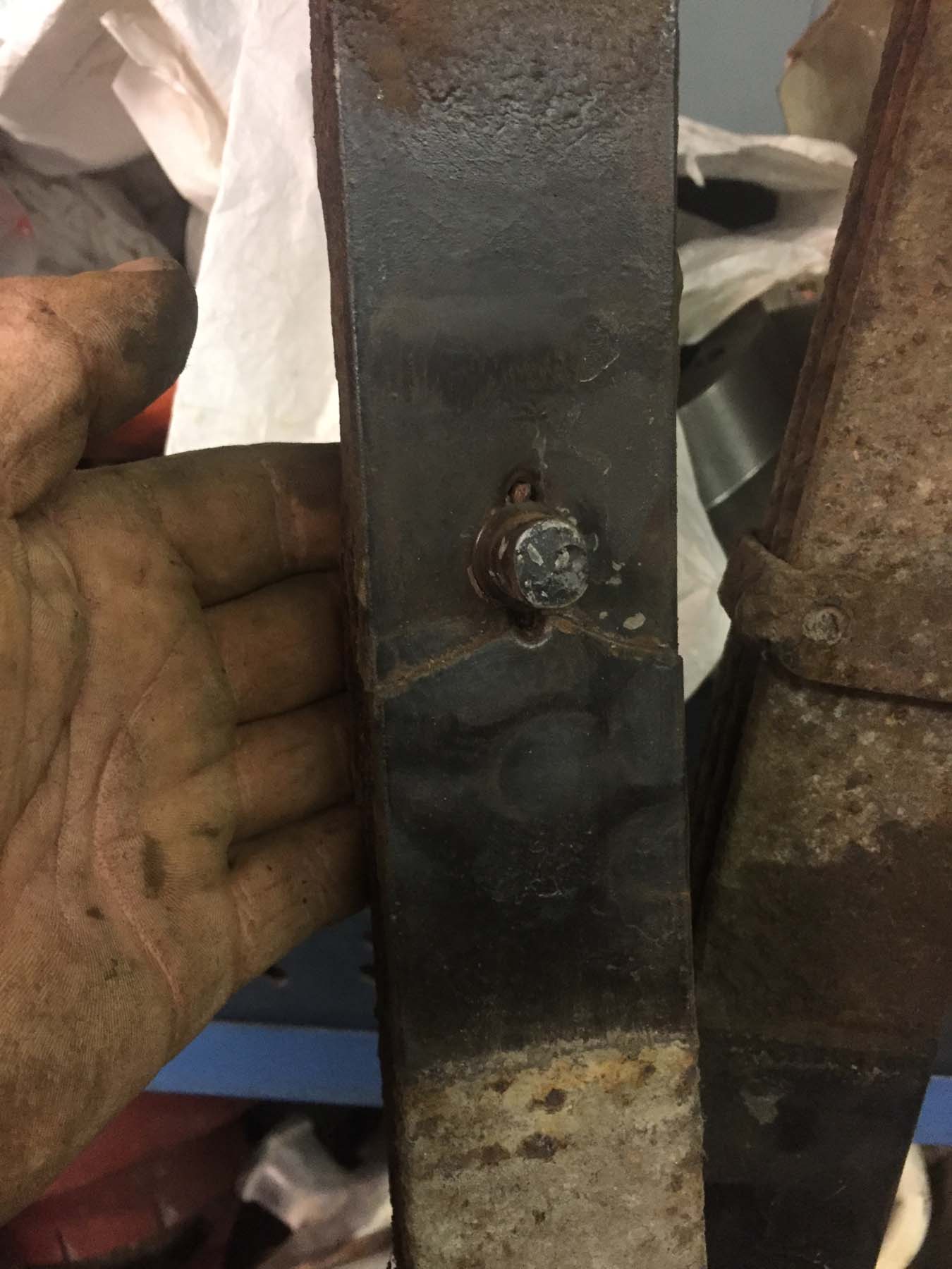

coalnotdole Posted November 4, 2018 Author Posted November 4, 2018 The car has always seemed very low at the back - in fact the MOT man made comment on the springs looking very decambered. With a full tank its sat about 1/2" off the bump stops and with a passenger in the car the stops are just touching. Its low: (note matching rear lights!) Everyone I spoke to about springs said to get a set of single leaves from a 2.8 as un "upgrade" but this view seems to have pushed eBay prices up to over £100 for a used pair of 30 year old springs which I'd still need to get different u-bolt clamps and rubbers to attach to my multi leaf axle. So I shelled out £250 for a set of new multi leaf springs from Kilen (quality british made springs were available but were more than twice the price) They seem to look ok although are lacking the nylon wear plates of the originals: First problem was getting out the NS front hanger bolt as the hanger had been overplated in the process covering up both access holes so I had to crack out the hole saw: After waiting for the water to stop pouring out i managed to dig out enough foamex to get a socket on and get the bolt out, all the other fixings came undone with the exception of the U-bolts which all snapped even with heat. With both springs of it became apparent why it sat so low, almost all the leaves of both springs are cracked and so much rust has blown them apart that somebody has rewelded the straps around the springs to hold them together Now this is the point where I should have just bolted the new springs in place and driven off, but I had to have a poke at that overplating... With a lot of seam sealer and underseal removed: Looking forward from the wheel arch with the spring hanger on the right: There were also a couple of scabby bits on the NS front floorpan which had been coved in body filler and underseal: So I decided I'd order some handmade replacement spring hanger panels from a bloke in france and do a proper job of it... Plate off: Foamex out of the void which the sunroof drain also ends up in: Rear corner of floorpan: Beneath the rear seat: Front floorpan/bulkhead joint: Inner sill: Test fitting new sections: Thats about where it is now - I'm waiting to get some zintec to start welding up the floor and front lower edge of the inner wheel arch before putting the new plates in around the spring hanger. Then my intention is to stick the springs back on and drop it back onto its wheels and probably rip the wing and outer sill off so I can repair the inner sill. I've ordered a pair of full outer sills along with lower A post repair sections and a N/S front chassis skid section as thats also been badly plated over in the past and if i'm going to repair the floor above it and replace the outrigger I'd rather do a proper job... Have ordered a load of new tips for .6 wire and upgraded my old black and decker powerfile to a fancy makita one which should hopefully make weld finishing easier. I'm wanting to achieve invisible repairs with a factory fresh look - I do expect to possibly lower my expectations once I start though... Dave BorniteIdentity, cort16, Tickman and 25 others 28

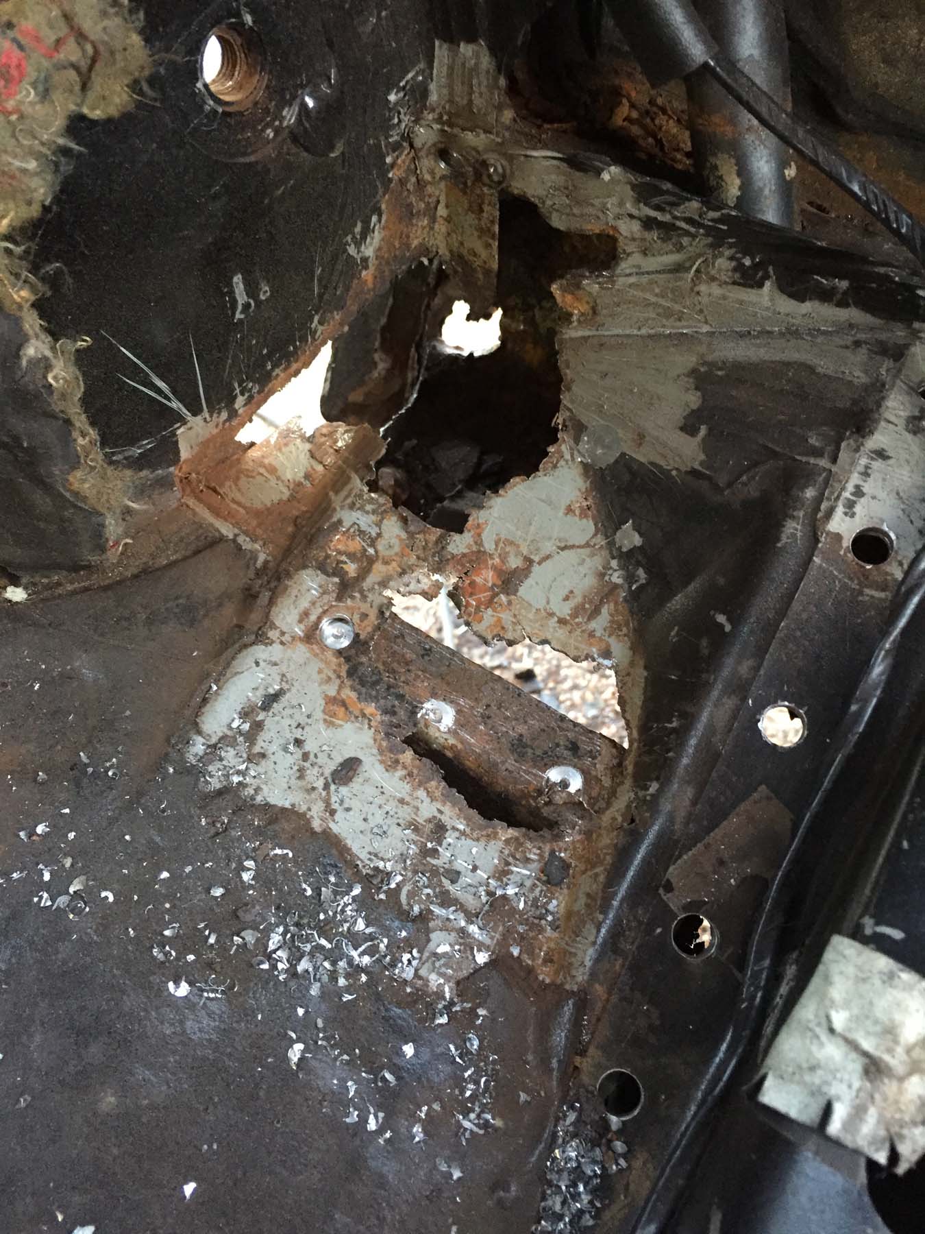

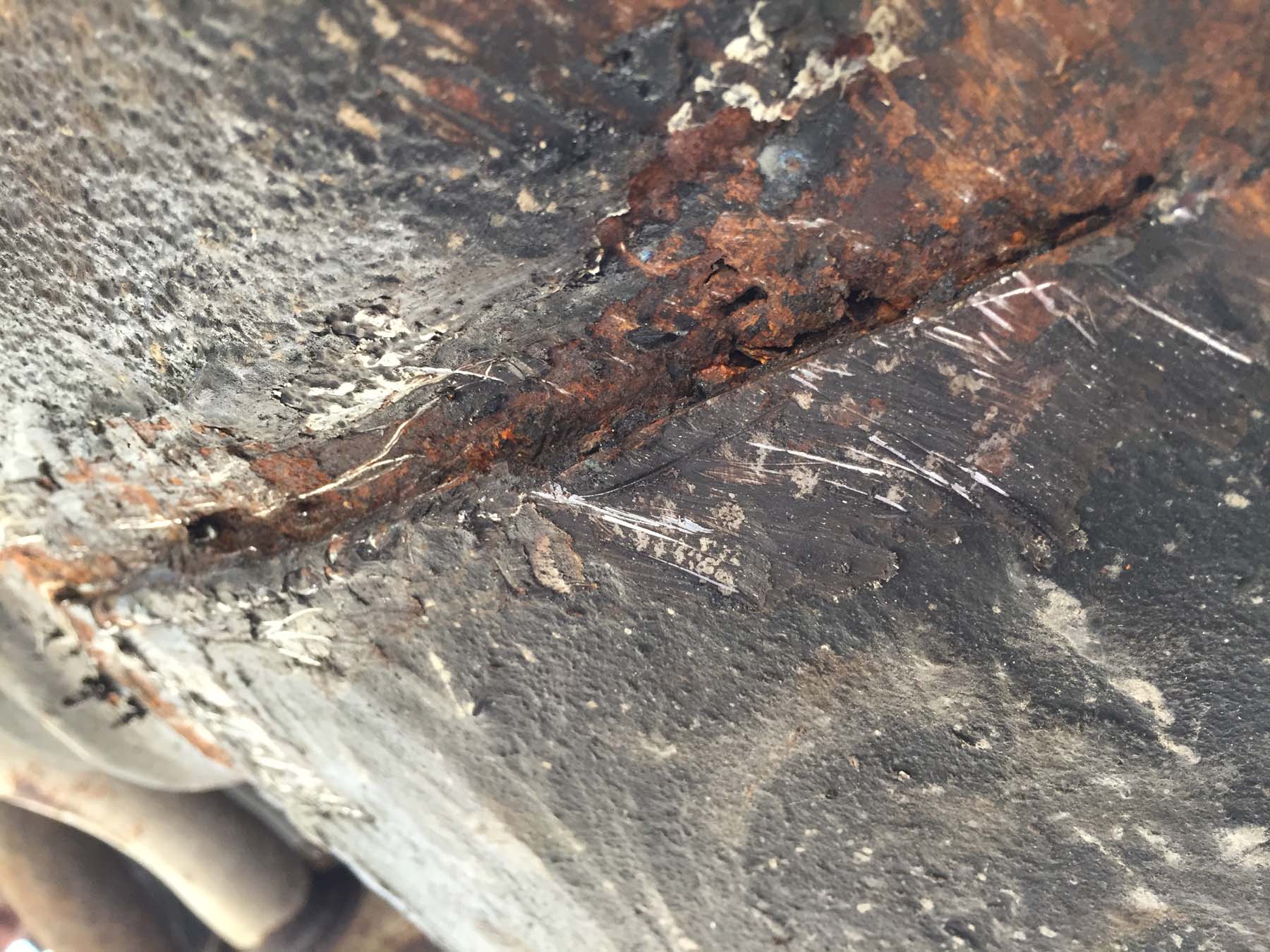

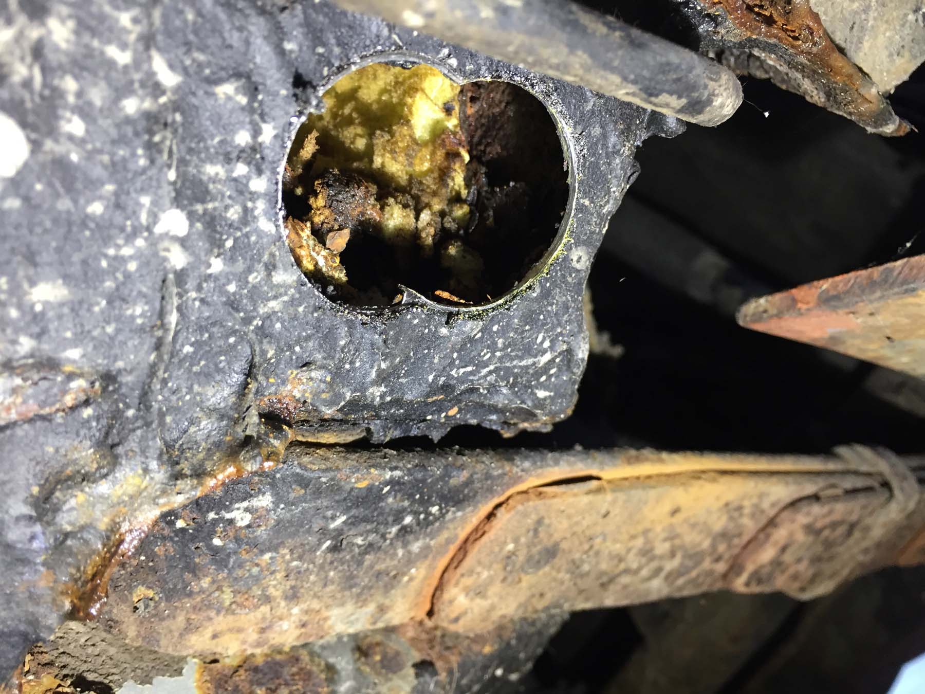

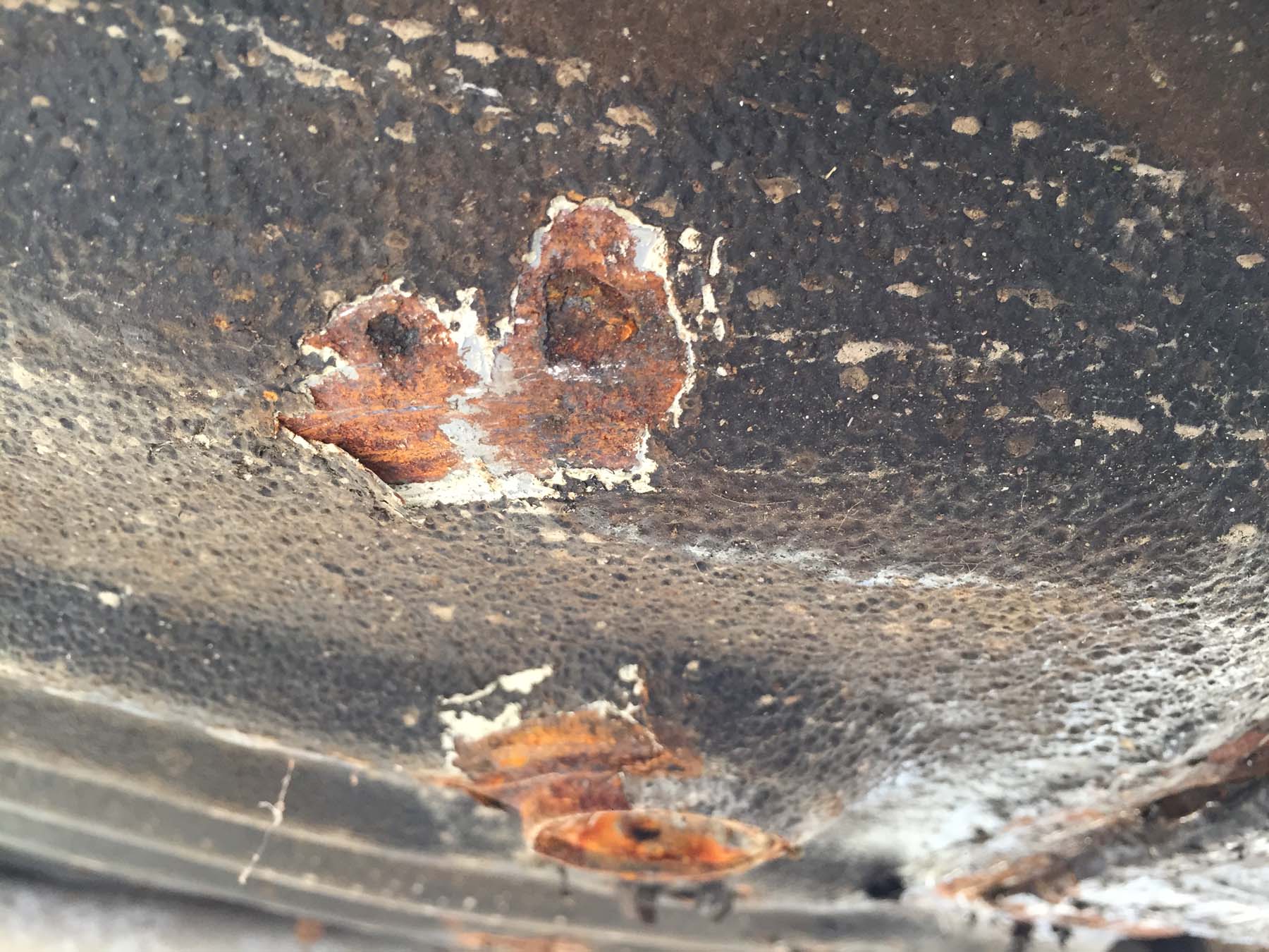

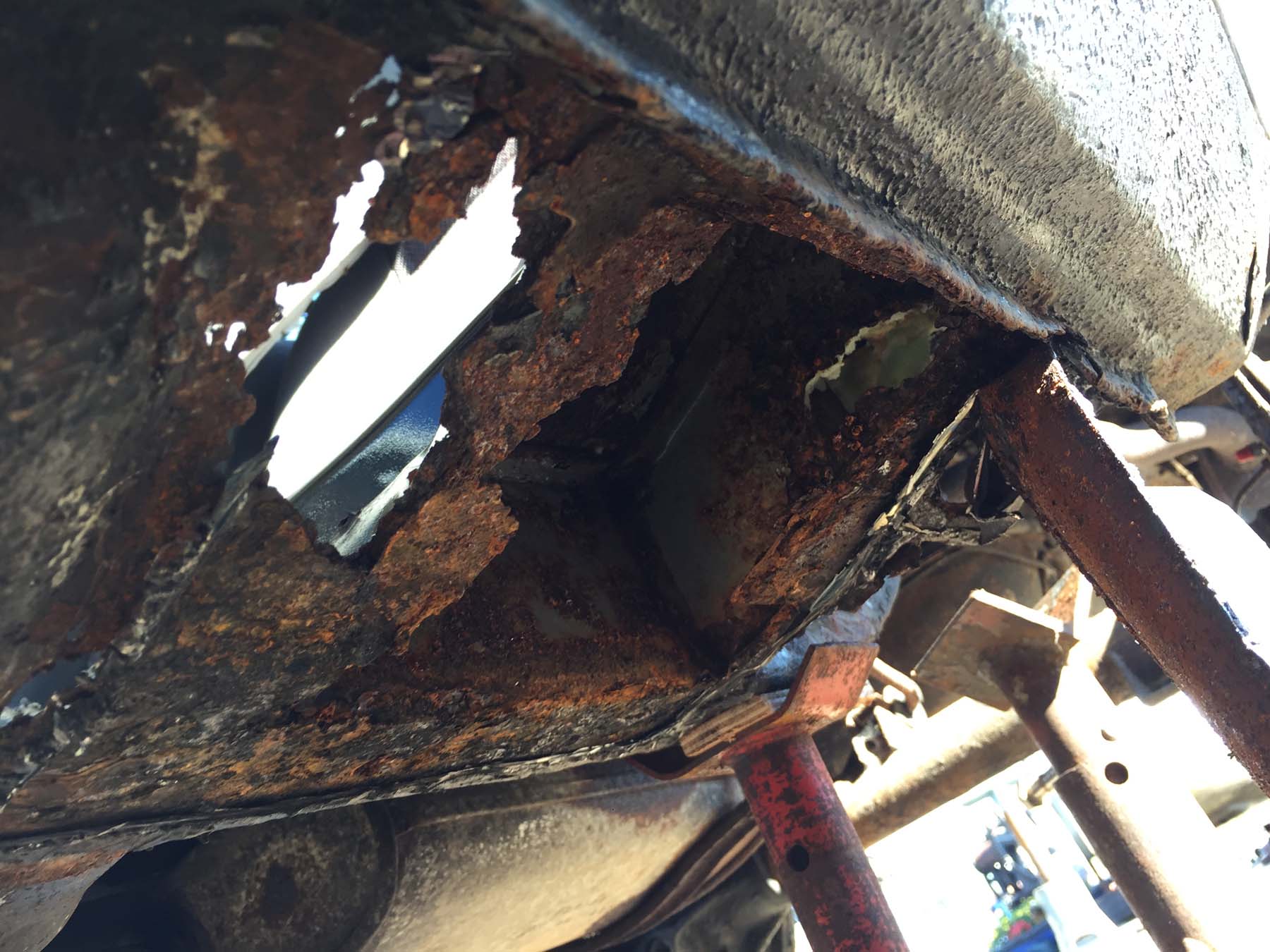

danthecapriman Posted November 4, 2018 Posted November 4, 2018 You shouldn’t have poked it! Seriously though, your plan sounds good. Don’t piss about leaving things, ignoring things or doing it half arsed. Sadly that stuff is about normal for an unrestored Capri after this long.Make sure you get everything painted and/or filled with cavity wax as you go too, keep the rot at bay. If you need any pics of how things should look or even want to have a look yourself at a car in as new body condition your welcome to have a look at mine. It does help sometimes to have a look at how one should look if your having to get rid of other peoples bodge jobs and rusted deformed mess! Sometimes other people’s ‘handy work’ doesn’t even remotely look like it should do! mat_the_cat, Burnside, mercrocker and 8 others 11

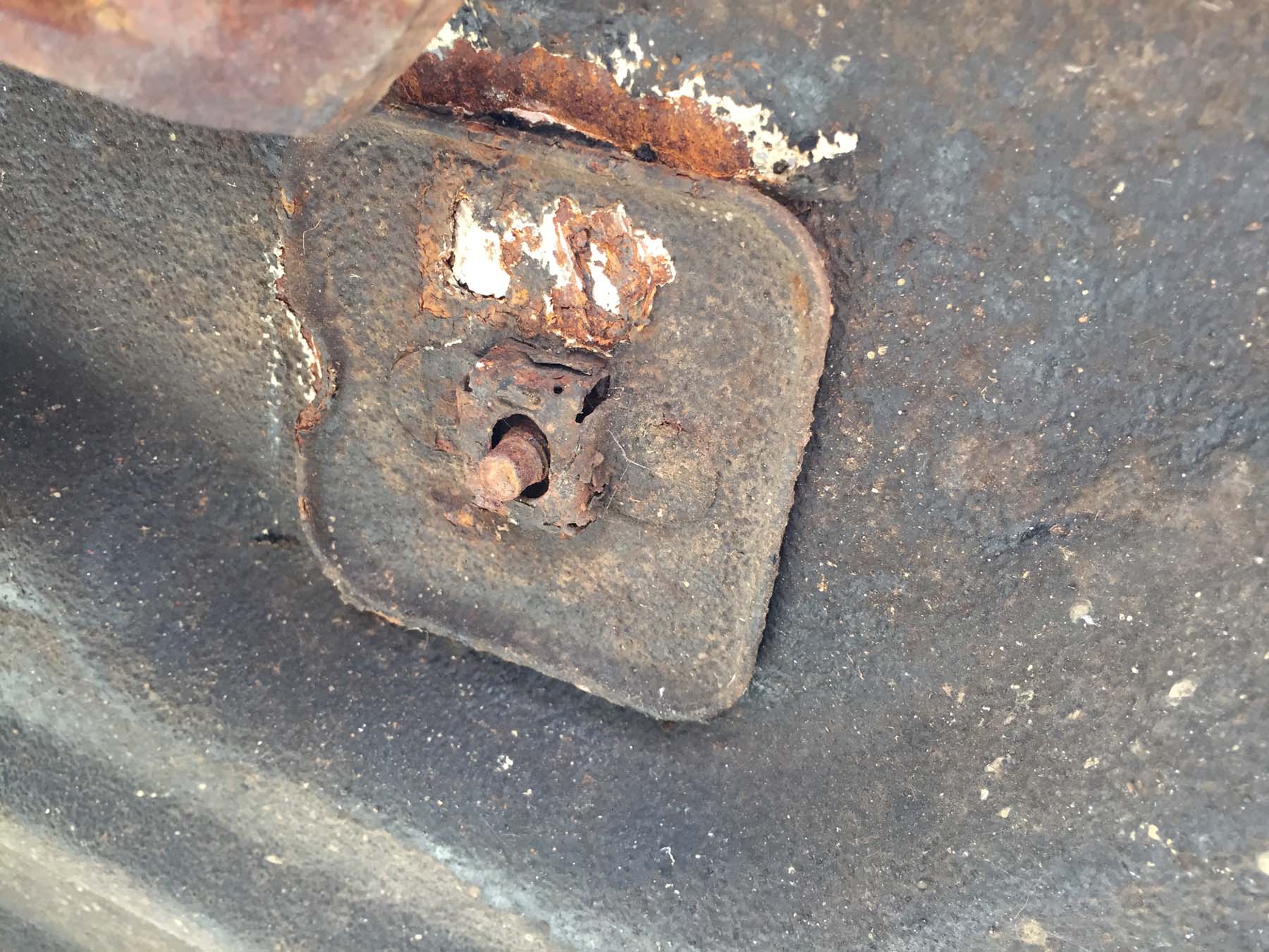

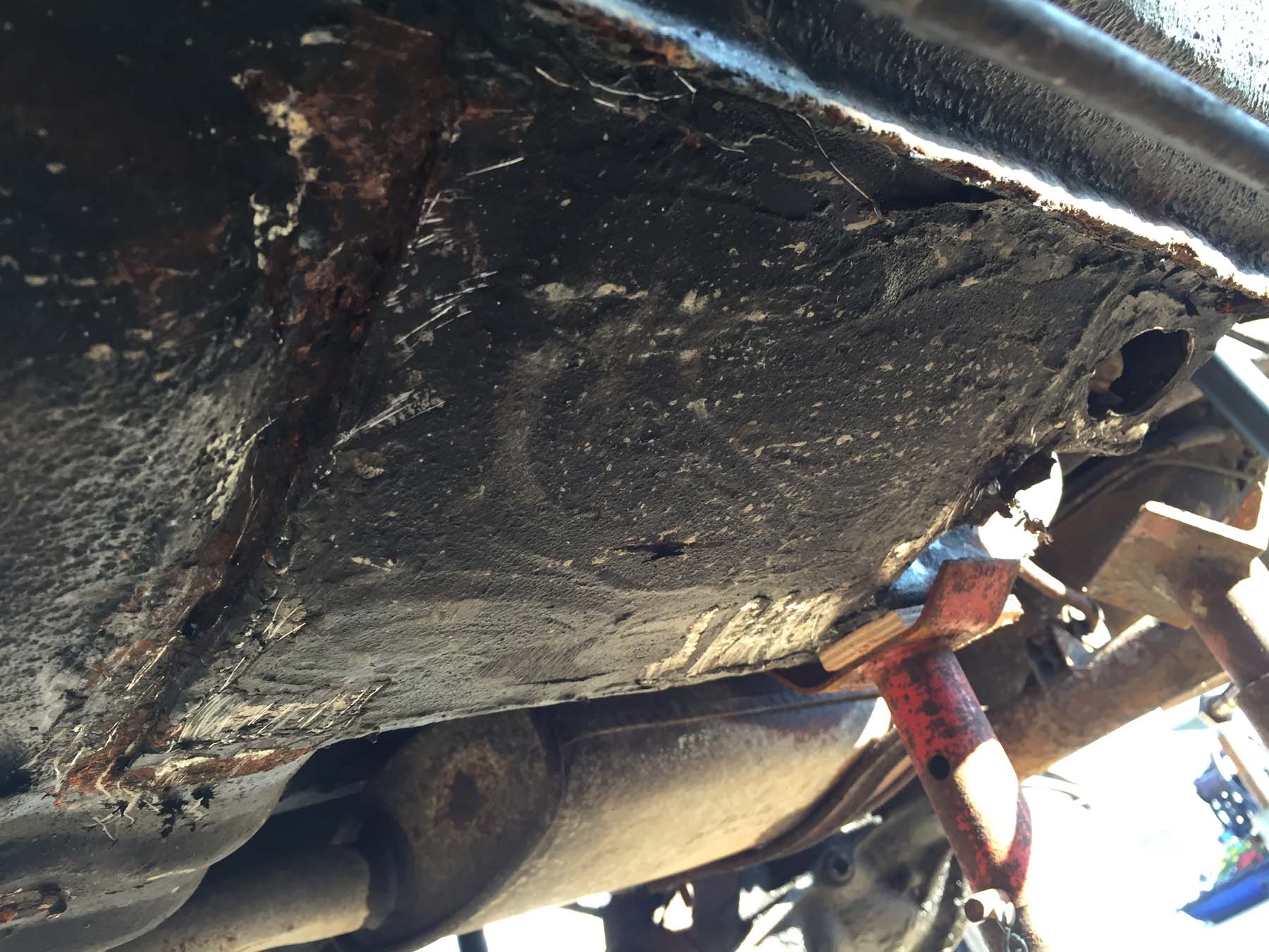

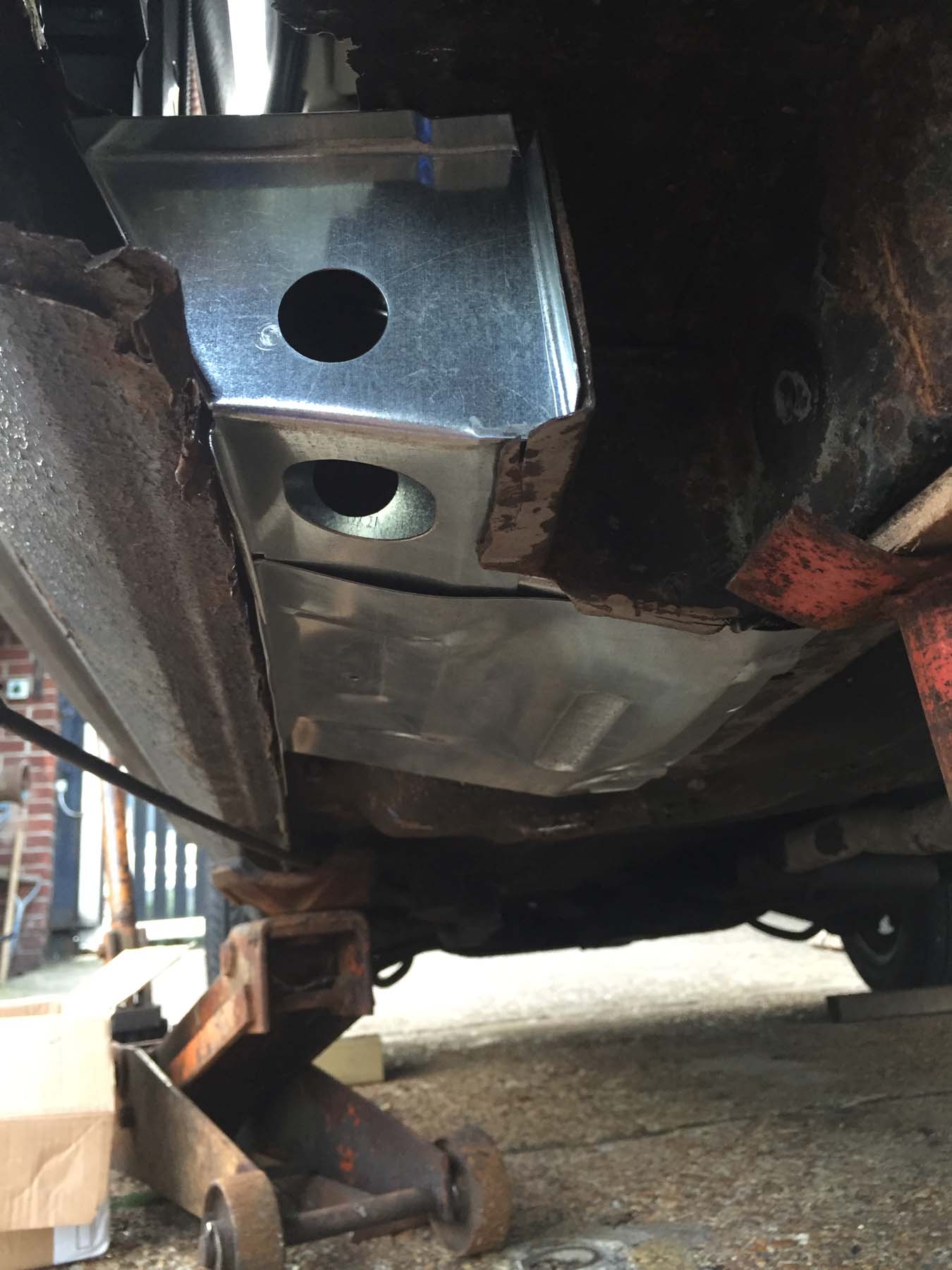

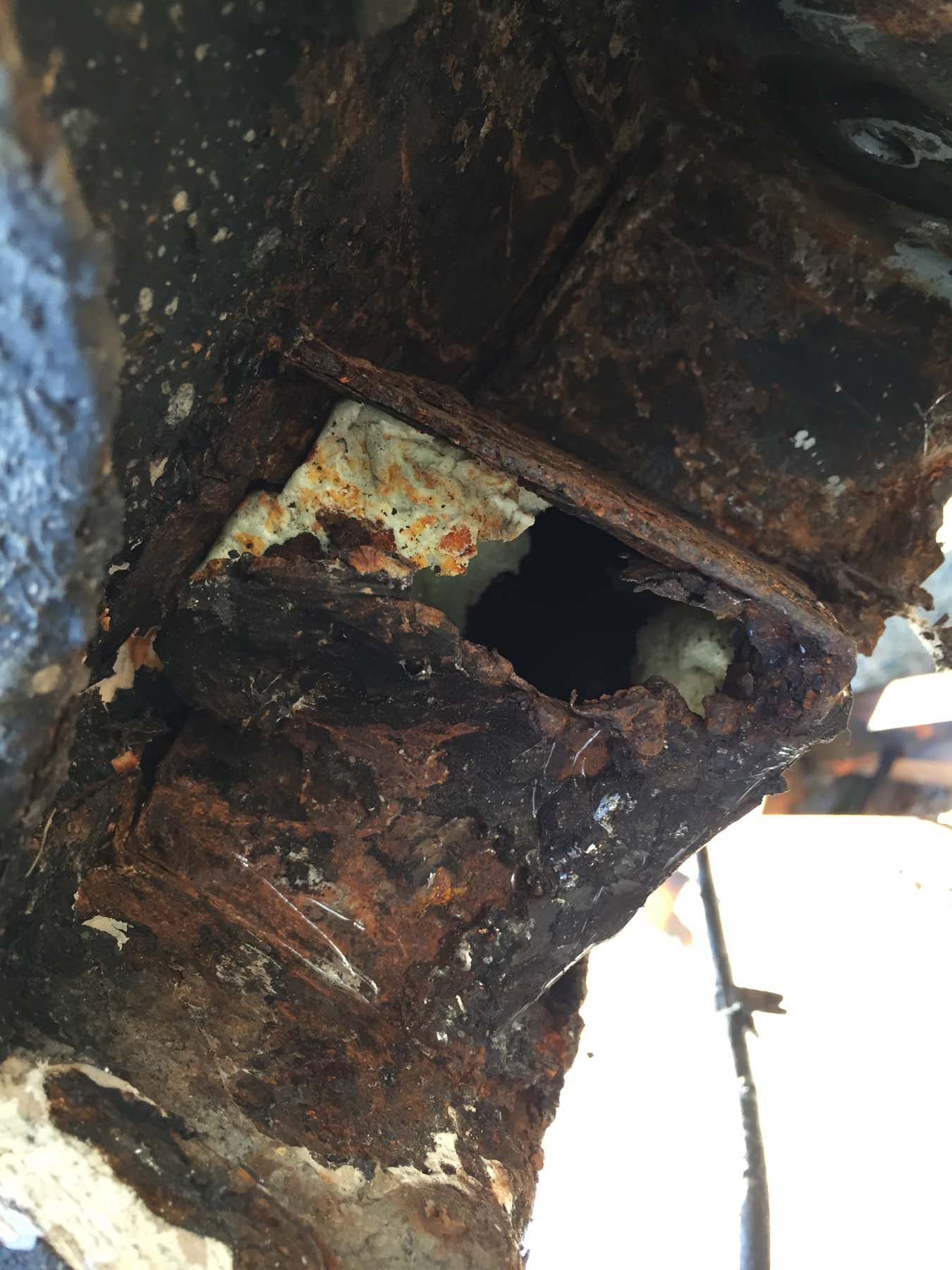

fordperv Posted November 4, 2018 Posted November 4, 2018 Your brave jacking it up on the sill lip, also one of my pet hates people doing that, Stereotypical capri rot spots, fire the mig up danthecapriman and tooSavvy 2
coalnotdole Posted November 4, 2018 Author Posted November 4, 2018 Your brave jacking it up on the sill lip, also one of my pet hates people doing that, Stereotypical capri rot spots, fire the mig up The jacks actually only there loosely for peace of mind whilst I was hammering at spot welds underneath - the weight is all on axle stands under the chassis members! Also one of my pet hates, the sills on my suzuki carry had rotted out as the drain holes are either end and the sills hang down below the chassis - whenever someone puts one on a two post lift unless they use spacers the arms crush the sills upwards and make a massive water trap as they no longer drain! Was a load of grief to take the outer sills off and straighten out the inner sills... fordperv 1
DodgeRover Posted November 5, 2018 Posted November 5, 2018 I'm just adamant that people don't jack anything of mine under the cills under any circumstances, people just have no concept of older vehicles.. richardthestag and Angrydicky 2

tooSavvy Posted November 5, 2018 Posted November 5, 2018 Re FORD alloy wheel nuts (stainless cap) If yours are the same as Focus/Ka alloys... I got 16minters for £5 at my local breakers

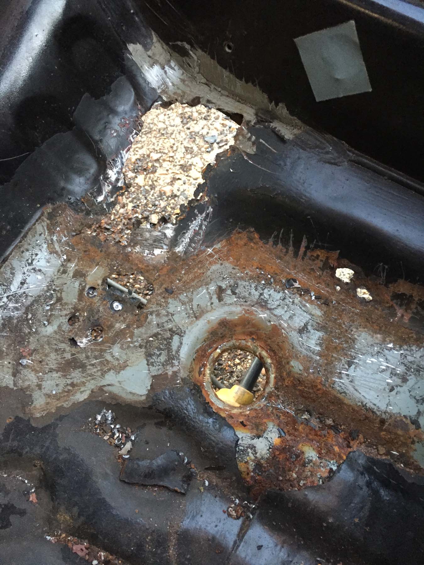

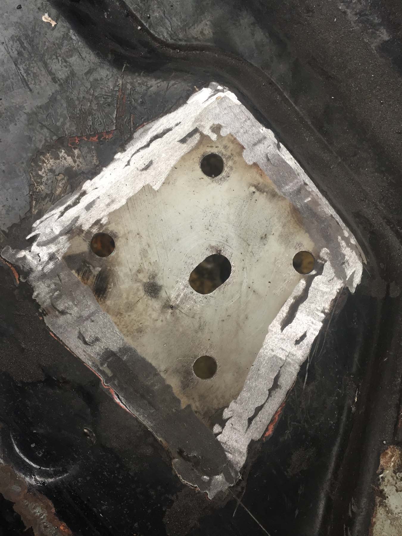

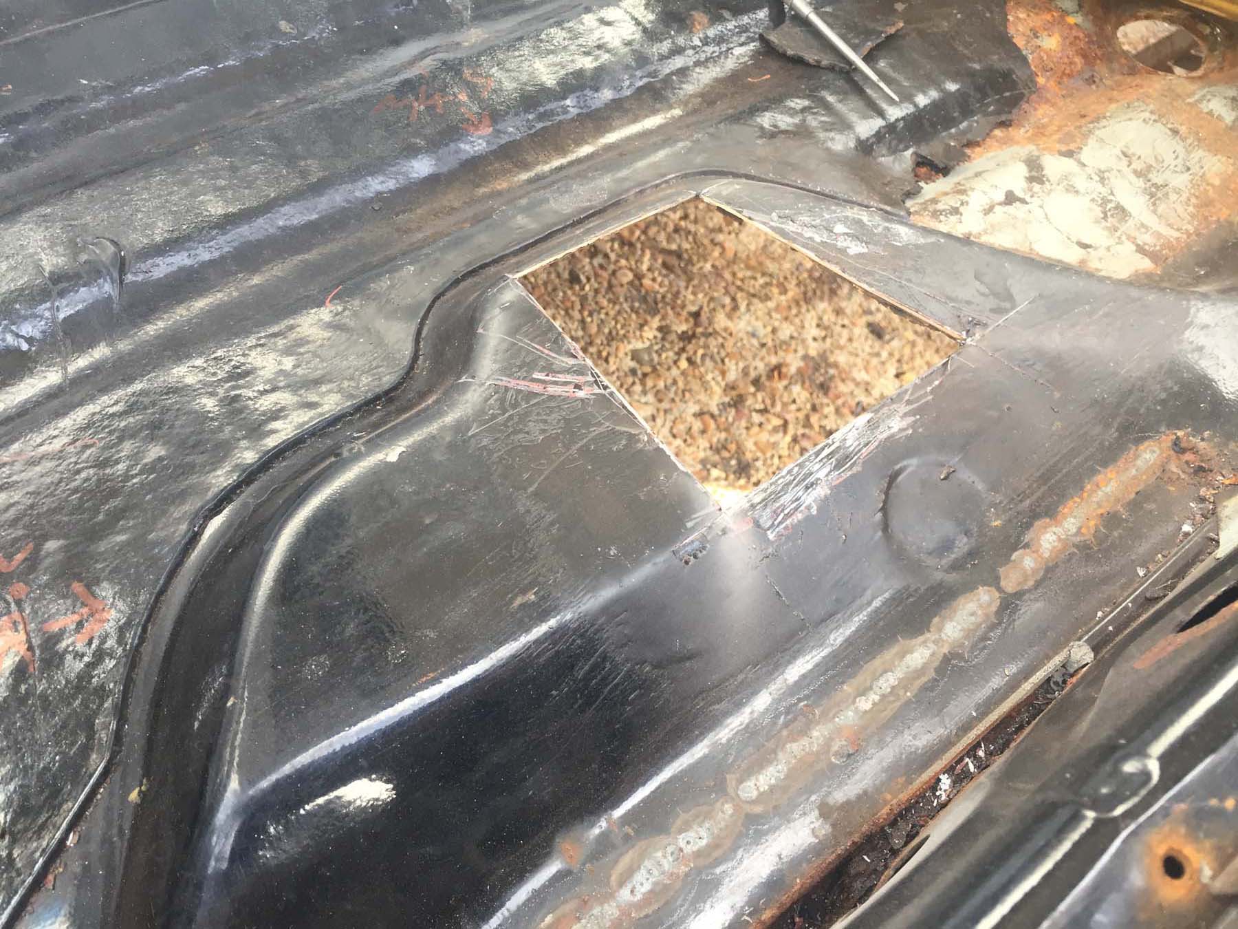

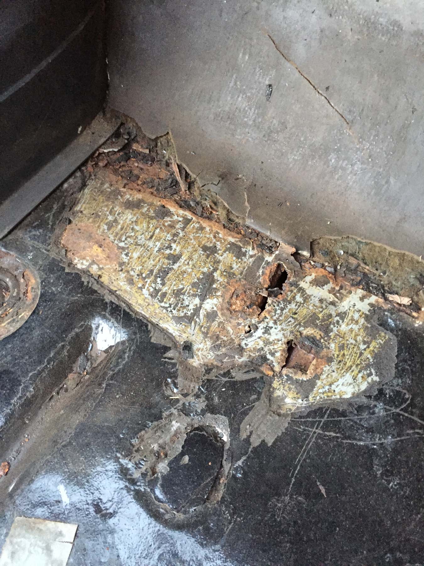

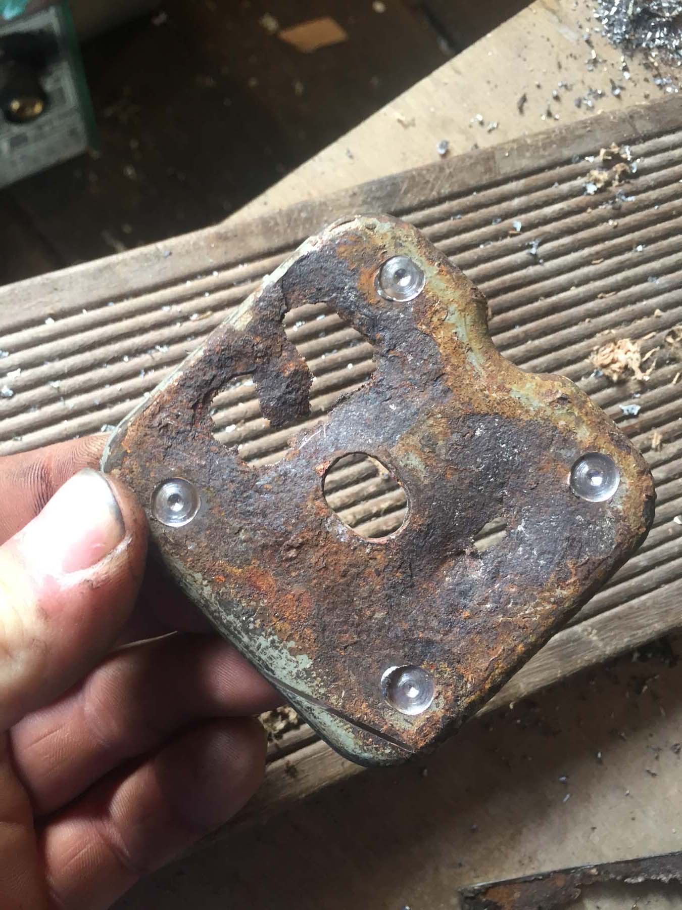

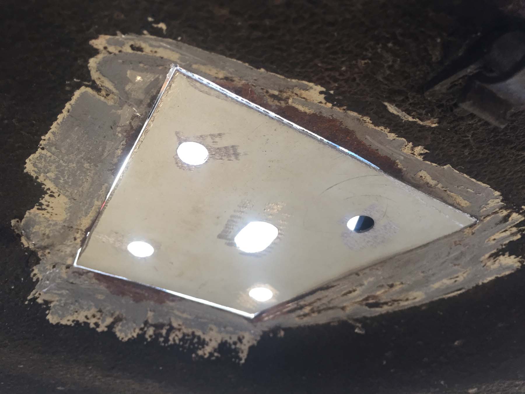

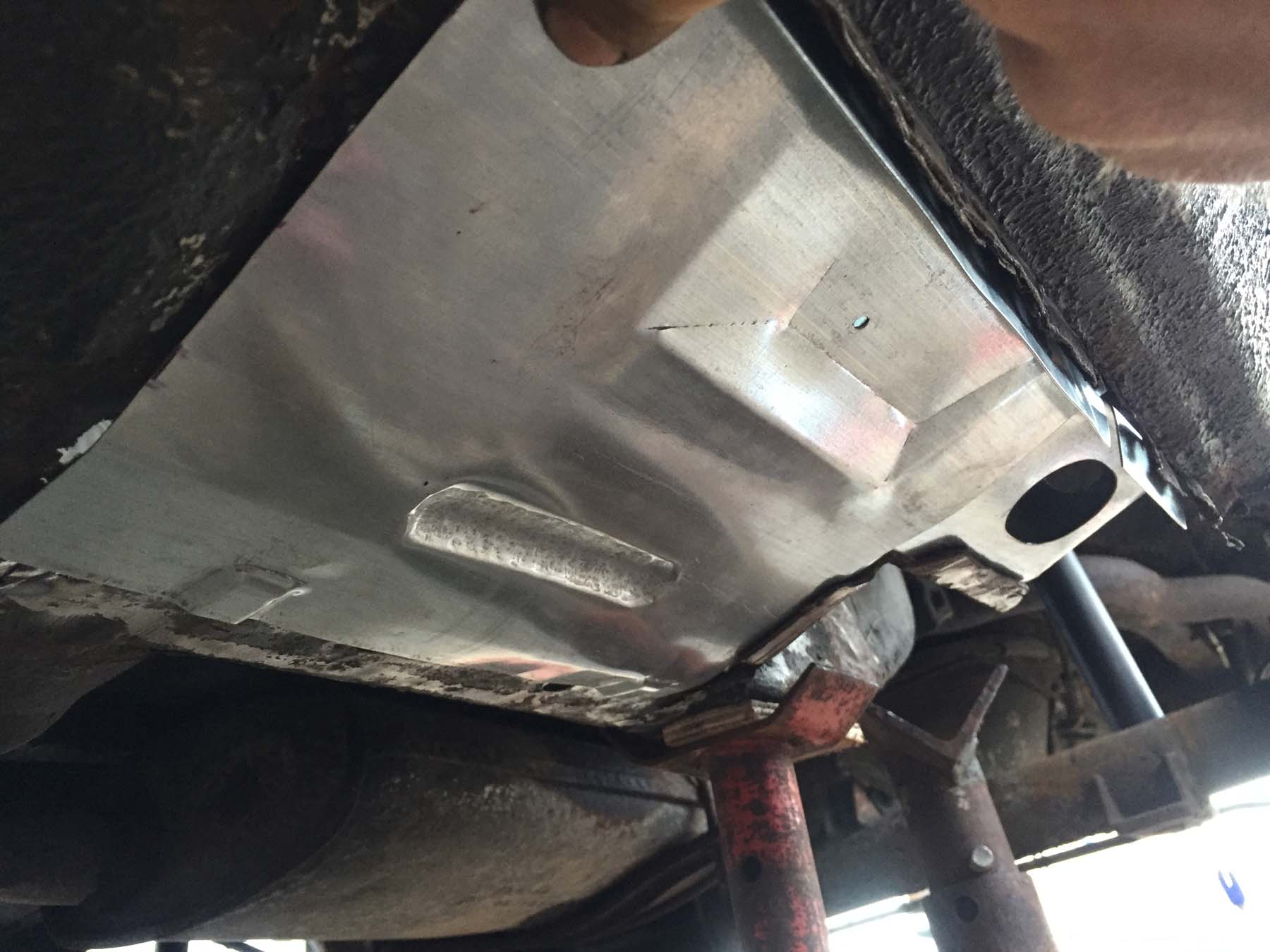

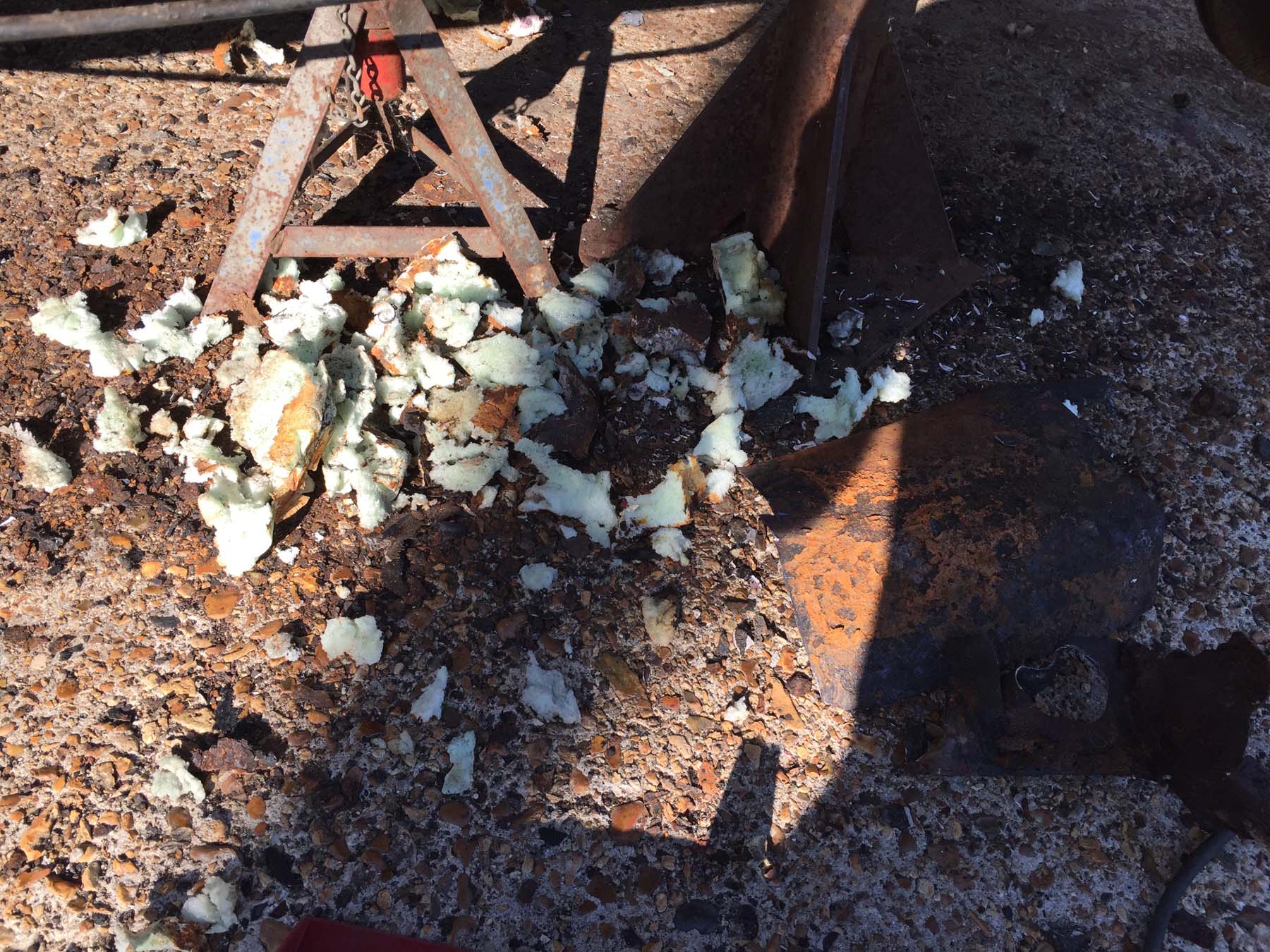

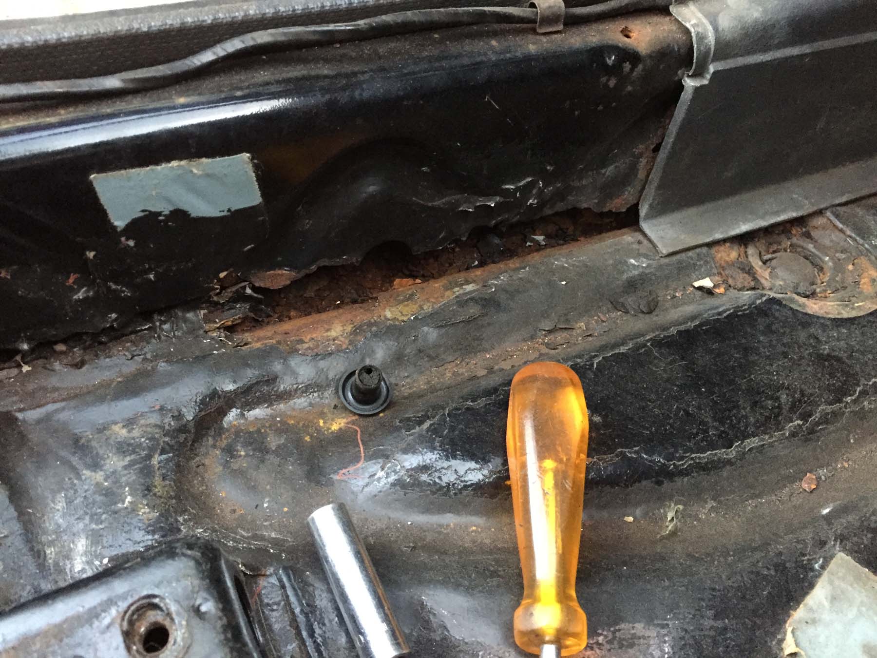

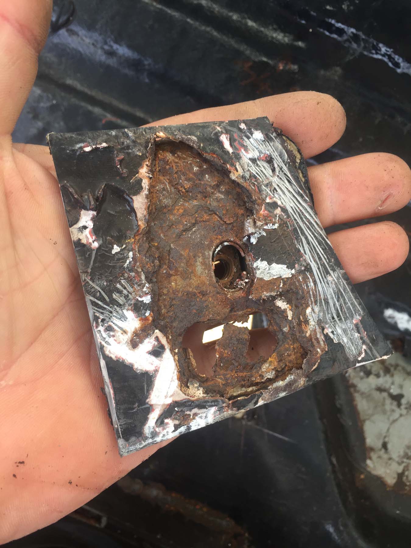

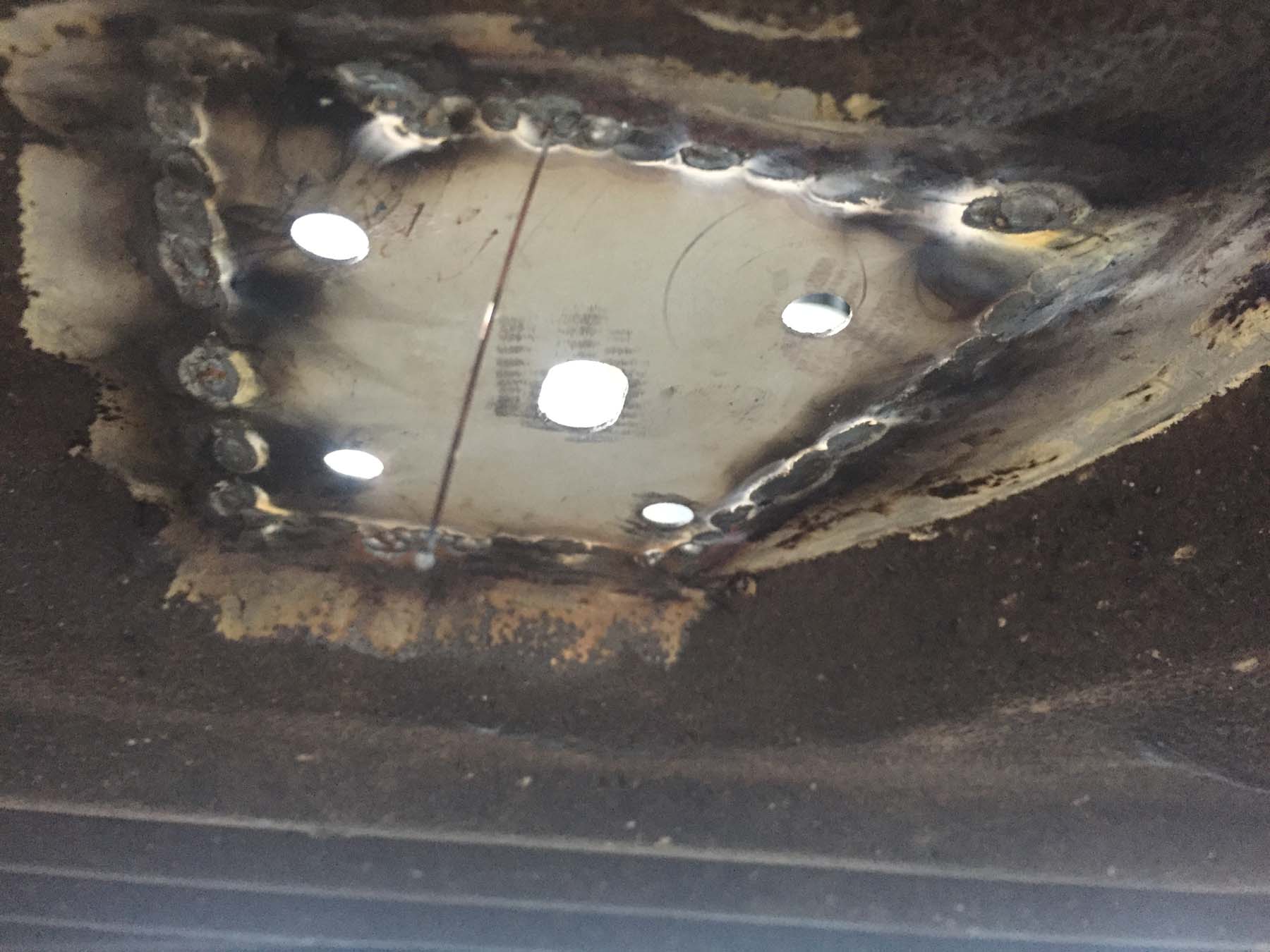

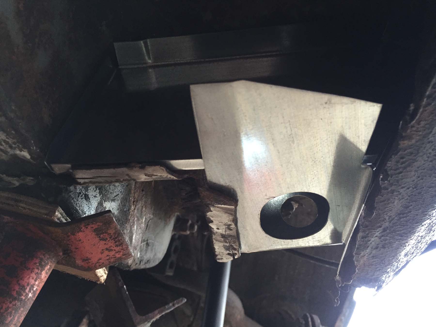

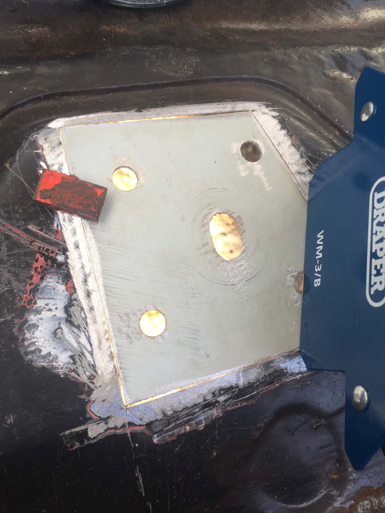

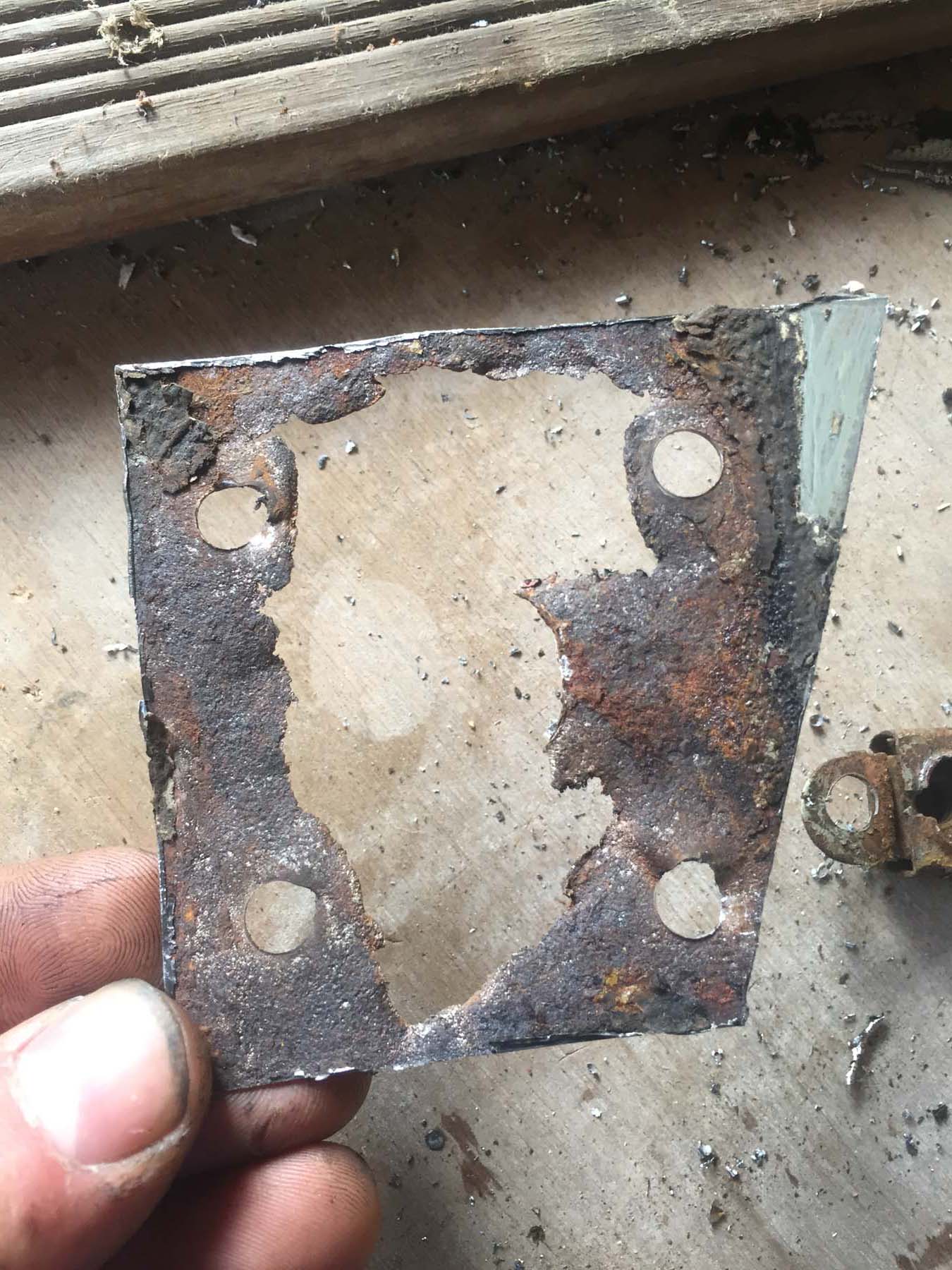

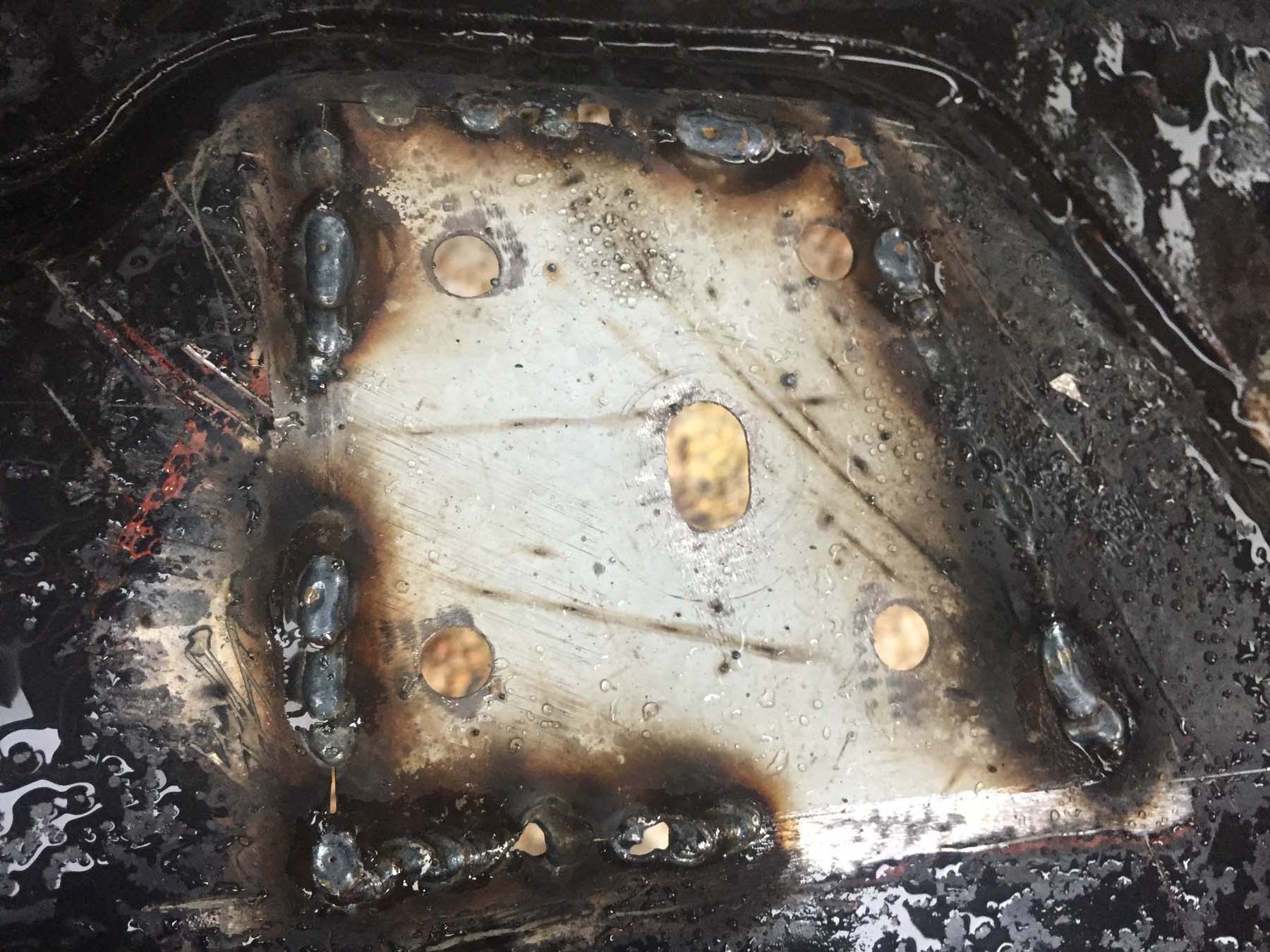

coalnotdole Posted November 10, 2018 Author Posted November 10, 2018 Well I'm now in possession of two 8'X4' sheets of zintec steel in 1.2mm and 1.5mm thicknesses which I'm rather hoping should be more material than I need! Had a crack at one of the simplest repairs this morning where the floor has rotted out around the passenger side seat mount. Unfortunately as the car is outside the sporadic torrential rain and gale force winds didn't really help. After being electrocuted for the second time trying to drag the mig welder, gas bottle and extension lead back inside in a hailstorm I kind of lost interest and vowed to come back to it on a dryer and less windy day! The first cut: Previous repair appears to have involved body filler and tinfoil: Underside: Floor panel: Doubler plate: Captive nut fitting which I will reuse when I repair or replace the doubler: New metal: Gives an idea of just how wet and hopeless the weather was!: Underside, penetration seems ok. will probably be a few bits that want another blat of weld from this side though: Topside quickly dressed off with the power file: And thats it for the moment, feel that with some better weather I'm probably capable of doing the repairs to a standard I'm happy with. Which is a relief as I'd worried it might just end up a horrible mess covered in more underseal and tinfoil! Thanks for reading / commenting Dave vulgalour, theshadow, Burnside and 7 others 10
Tamworthbay Posted November 10, 2018 Posted November 10, 2018 I still want a Capri but I can't weld & haven't won the lottery so I'll enjoy it from a bystanders point of view.Welding to a decent standard is a piece of piss. Not the tig welded gorgeousness you see on jap bike frames but decent structural welding can be taught in no time at all. I have taught loads of folk, two to three hours is easily enough for someone vaguely practical to get the basics. Then it’s just a matter of logic to unpick what needs to go where. Making repair panels is just basic metalwork with a bit of lateral thinking if you need an odd shape. I made the circular dips seen above for the rear spring front mount by hammering sheet metal into the end of a piece of metal tube then drilling the centre out. It’s a very satisfy process. fordperv, LightBulbFun, richardthestag and 2 others 5
danthecapriman Posted November 10, 2018 Posted November 10, 2018 Nice job, especially given the wank weathers best efforts against you. I really really wish I had your enthusiasm! Must be a good three months or so since I did anything on mine.
