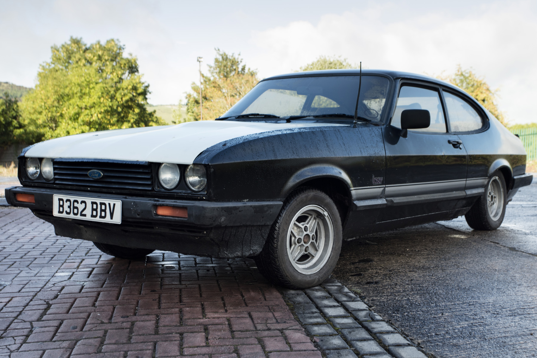

coalnotdole Posted September 1, 2018 Author Posted September 1, 2018 Well with several hundred more pounds thrown at it and a lot of hours of swearing this now has an MOT! All new rear brakes, brake hoses, master cylinder. New bulkhead reinforcing panel and various gators replaced as well as fitting the correct carb and manifold. I'll whack some photos up next week. Just need to tax and insure it now... Dave JeeExEll, LightBulbFun, Dirk Diggler and 36 others 39

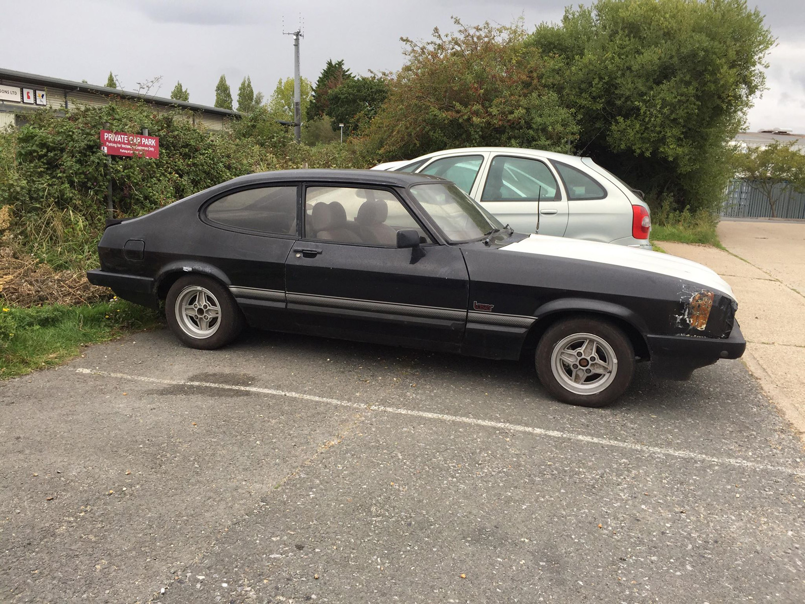

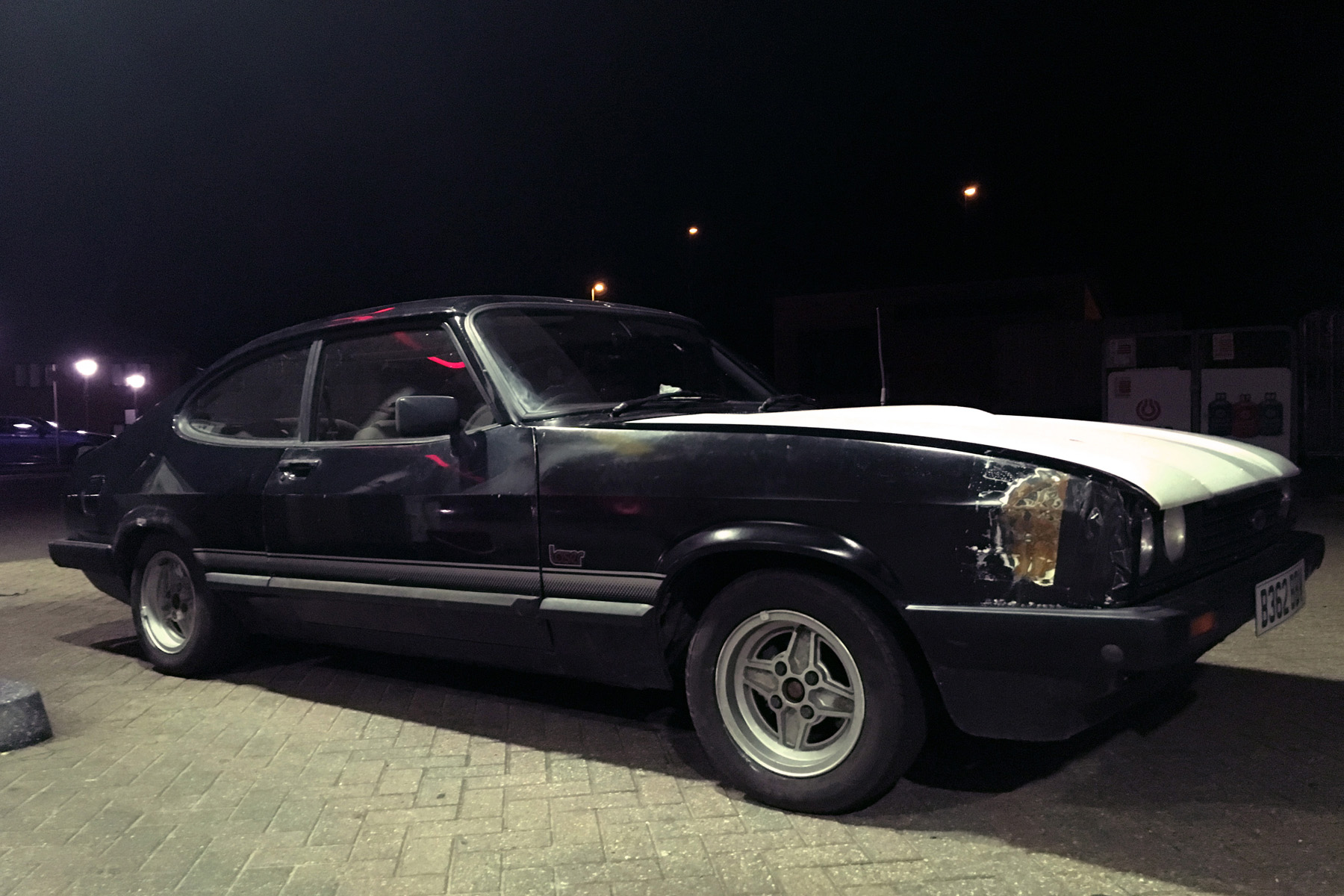

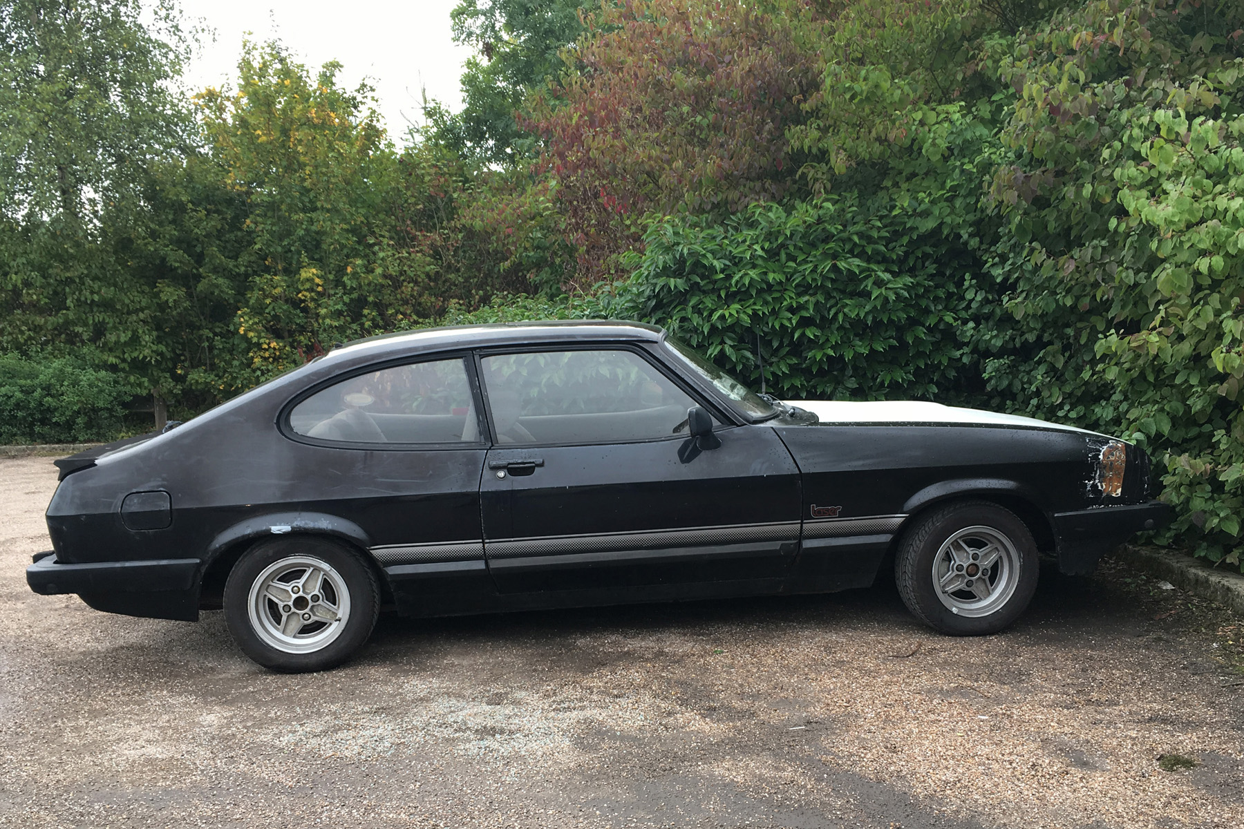

coalnotdole Posted September 11, 2018 Author Posted September 11, 2018 Something is happening... Its 1am, The Capri is full of fuel and ready for a road trip.... Joe dome, mat_the_cat, Tamworthbay and 19 others 22
Guest Hooli Posted September 11, 2018 Posted September 11, 2018 Now that's a scene that could be from the late 80s. fordperv, Vince70, oldcars and 1 other 4
fordperv Posted September 11, 2018 Posted September 11, 2018 It should take that journey in its stride, good to see a capri being used
Dannyk Posted September 11, 2018 Posted September 11, 2018 My dad had a "white" 2.0 laser in the mid to late 90's,it was rottern.big holes in wings filled with expanding foam,rust painted over with white hammerite. couldn't go more than about 2 days without breaking down,(usally on a roundabout in rush hour). Often gave me a headache as it stunk of yellow magic tree mixed with very strong petrol and a hint of burning oil, brakes worked when they felt like it. it was seriously shit.....I absolutely loved it and have wanted one ever since! Nice to see that one getting used.

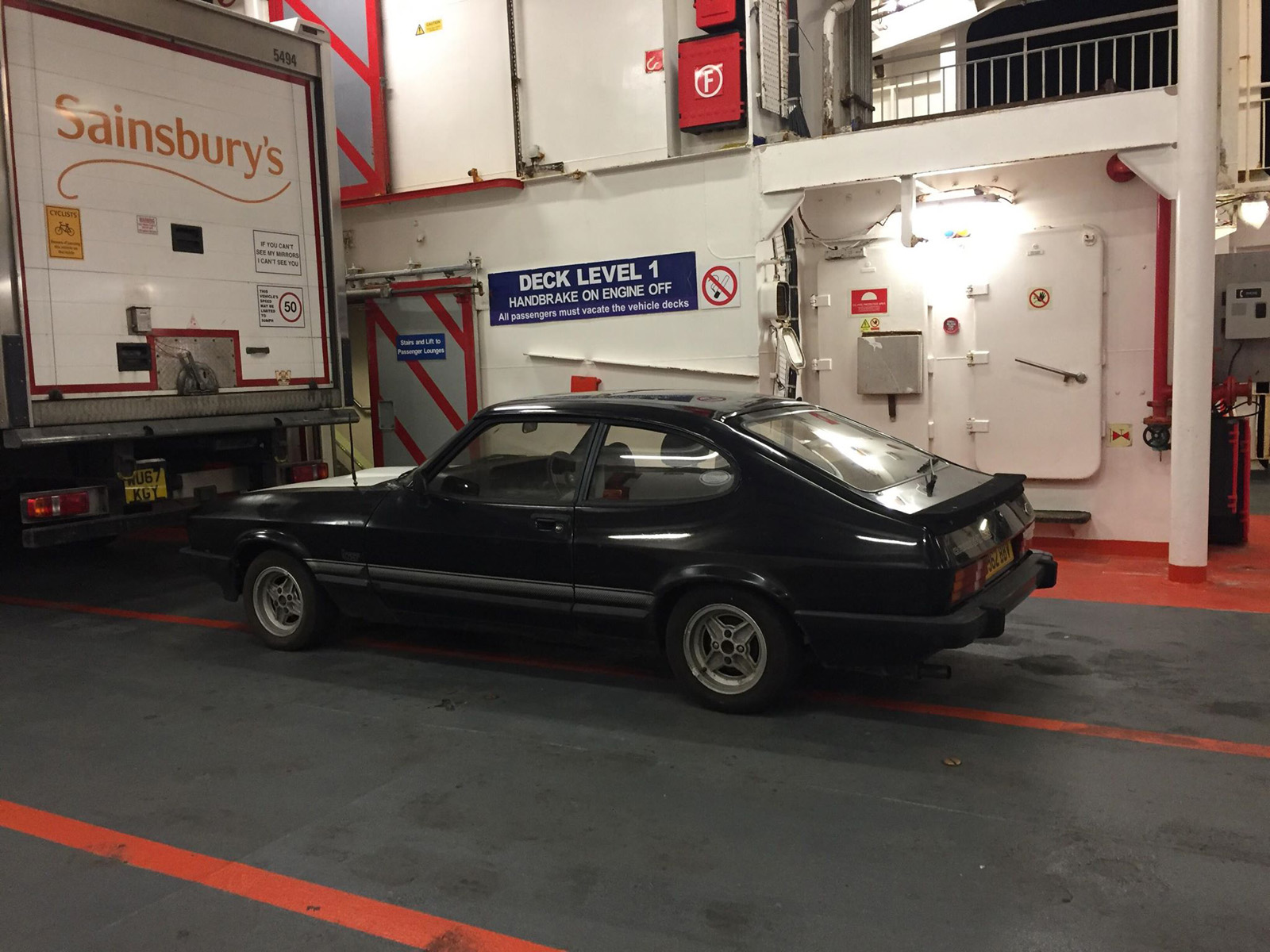

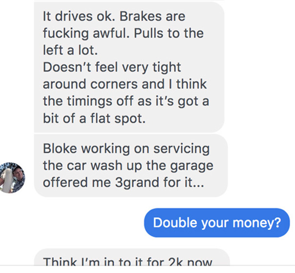

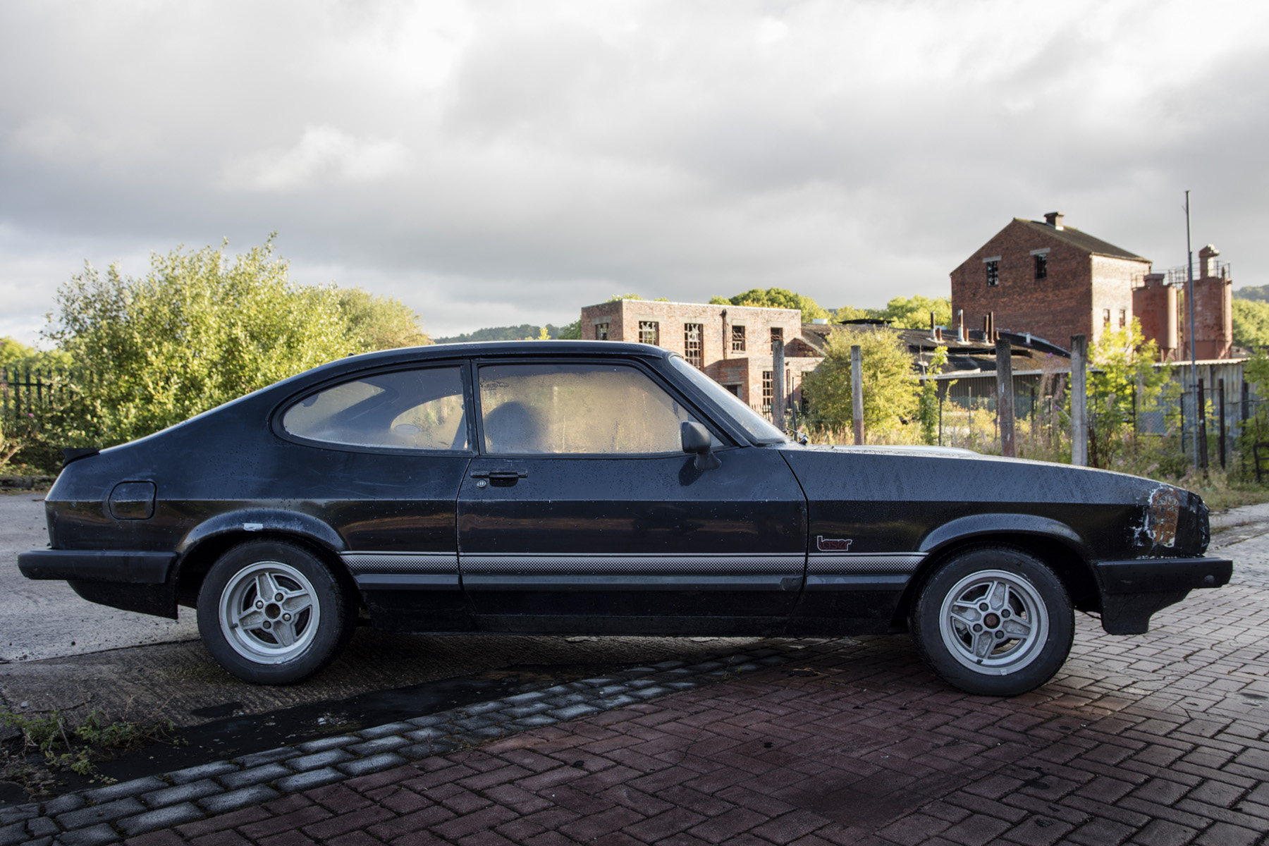

coalnotdole Posted September 11, 2018 Author Posted September 11, 2018 600 miles in an untested 80's Ford... WCPGW?It took a few days between the MOT pass and Dave actually having enough the spare cash to tax the Capri...Monday saw Dave take the car on its the first decent test drive... His initial comments were as Follows:We had an invite to an end of summer / social party in Derbyshire and after some agonising over which of our cars to use we elected to take the Capri! (other alternatives were A scimitar SS1 or A Reliant rebel or a Suzuki carry van.Dave did a bit more prep work on the car managing to get the speedo working, changing the engine gearbox and diff oils. Setting the valve clearances (horrible job on a pinto) and tweaking the timing.The tyres were also swapped onto the 4 spoke alloys as the profile of the tyres better suited the narrower wheels.Trip Ready?A ferry was booked....On the drive to mine the fuel gauge started to drop alarmingly, going from a full tank to just under half way in 40 miles! a look under the car revealed no obvious leaks and a trip to the petrol station showed it had only used about 7L. So we added dodgy fuel gauge to the list of quirks and set off north.I'm not winning any awards with this picture but at least it sets the scene.To the best of my memory this was my first time in a Capri, as a passenger its a comfortable enough place to sit. Ford seats from around this time seem to be generally quite good. The amount of trim rattles, cabin noise and vibration were slightly less impressive. Age, neglect and original cheapness are all factors here.Even before we reached the M25 I had resorted to attempting to get the original cassette radio working to drown out some of the noise! Sadly my efforts with a cassette cleaning tape met with failure. In the end all I managed was to make Camels's Stationary traveller sound like it was being played through a broken speaker inside a fish tank..!Just south of Oxford Dave was feeling tired and I took over as driver, I was surprised how similar it was to drive to the mk3 Cortinas I had driven in the past. There is something oddly barge like about the steering in the corners and it has a quite a bit of body roll. Its got style in bucket loads but its no performance machine.By 5am I'd reached our stop off point in Pleasly, just north of Mansfield where I was able to get some sleep.The following morning and I took my first daylight look at the car. Heres some detail shots...We then went for a look round Pleasly Colliery a small preserved pit who were holding an open day.This was quality, probably had an 80's restoration and was covered in NUM stickers!Always amazed by the graphics signs and other stuff you find in smaller museums.The pit scrapyard with derelict steam winder...We then headed off to the party on the way we passed this overlander and I actually managed a rare spottage photo.The Capri seemed to be running well, a stop for some petrol and a quick mpg crunch and we'd managed around 30mpg so far.That afternoon we arrived at the party location beer was drunk, bbq cooked and music happened.The next morning I got the decent camera out and took a few more pictures. Spoiler alert: in the next post we drive to Stoke... bolognasal spray, nacho man, catsinthewelder and 25 others 28

GeordieInExile Posted September 12, 2018 Posted September 12, 2018 "It drives ok."*List of ways in which it drives badly*
Guest Hooli Posted September 12, 2018 Posted September 12, 2018 Shabbytastic & sheddy, it's great. JeeExEll 1

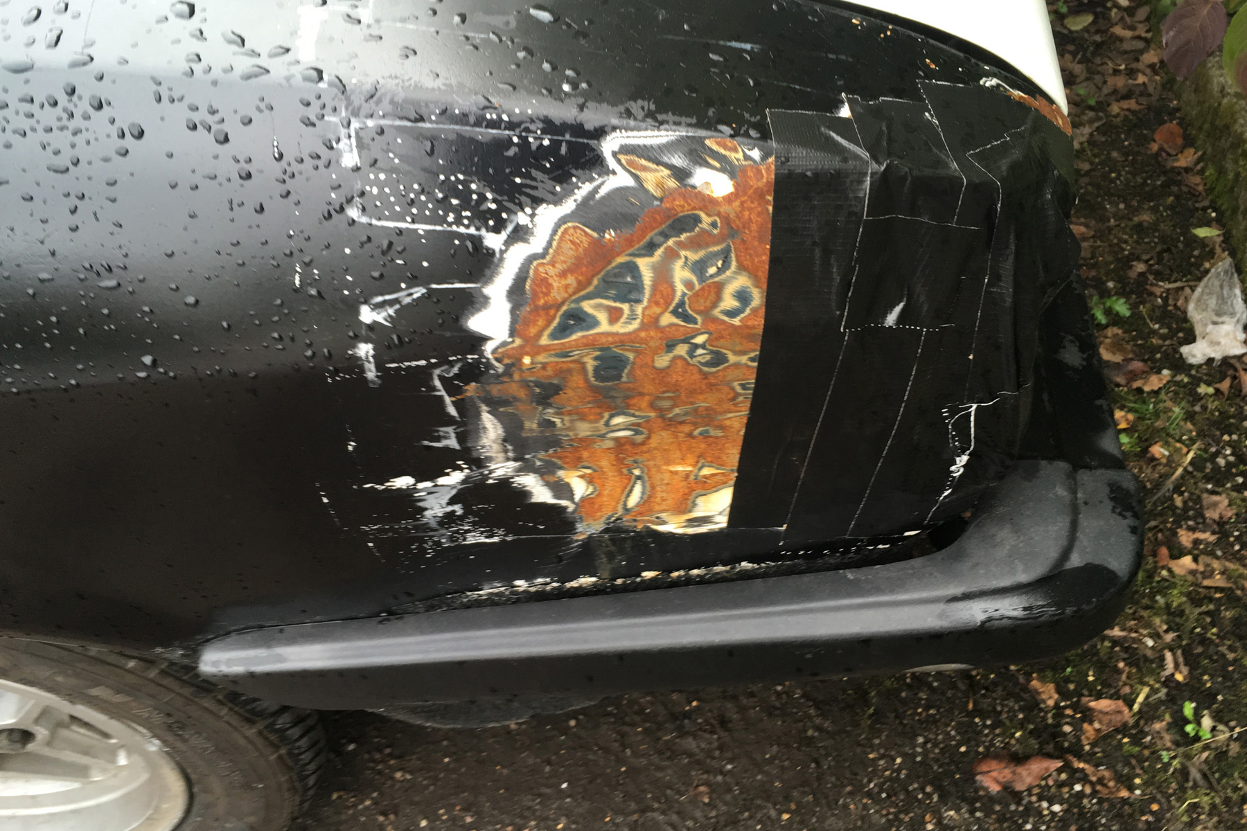

danthecapriman Posted September 12, 2018 Posted September 12, 2018 Brilliant!I must say, I really love that battered rusty front wing with the gaffer tape repair! The rattles you’ll most probably find are down to age and past owners pissing around. Mine used to make a racket inside and all it was were all the little screws and trim fixings were either loose, broken or missing. Replace them and tighten the screws and it makes a big difference. Check your undercarpet sound deadening too, it might be missing?The handling is much as you’ve found. They aren’t and never were performance cars. You might make it better with new springs and shocks as yours are all probably getting old and tired by now. I notice in a few pics yours looks a bit lower at the back than mine does.When mine had its original leaf springs it sat like yours but now it’s got new ones fitted you can see how low it had actually sunk! Top effort though, they are great cars and will eat a trip like that no problem. I went to Yorkshire in mine once and it was fine, actually a nice thing to sit in on a longish trip. Skizzer 1
