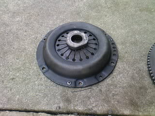

Just pulled the engine off the gearbox again. Bits of clutch mechanism came off in my hand... We're going to have to try to lift the engine out again...
Favorit estate has gone. Will TWC tow the crane back to your place?  Thought not.  Reliants can be so awkward when it comes to major engine work.  The Foxache may become a battle of willpower.  Good luck with the heaving.  Rather you than me.
Yeah, that's f*cked.
Guessing it got biffed when trying to fit the engine.

I think even with a better clutch kit that could have happened to it too. Looks like the gearbox input shaft was in and the engine shifted as it was being mated up. Thus ripping the arm off that plate.
Just bend the duff spring back into shape and hook the thing back up, it'll be grand. Just don't touch those finger nuts (not unless you put the back exactly in the right place as it'll affect how square the cover plate is)

Just bend the duff spring back into shape, it'll be grand. Just don't touch those finger nuts (not unless you put the back exactly in the right place as it'll affect how square the cover plate is)
Doesn't it look like those nuts may need to come loose a bit to have half a chance of getting those springs back into place? One looks like its making a bid for freedom already.
(Also every chance if they do make a bid for freedom, they'll never get back into place again!)

Ugh. Finally managed to get some time in the garage, but that just confirmed that this clutch is f*cked.
I feebly tried straightening that spring out, but one of the coils has been pulled tight, so it ain't coming back. Clutch written off. Now contemplating whether to upgrade to the later diaphragm type.

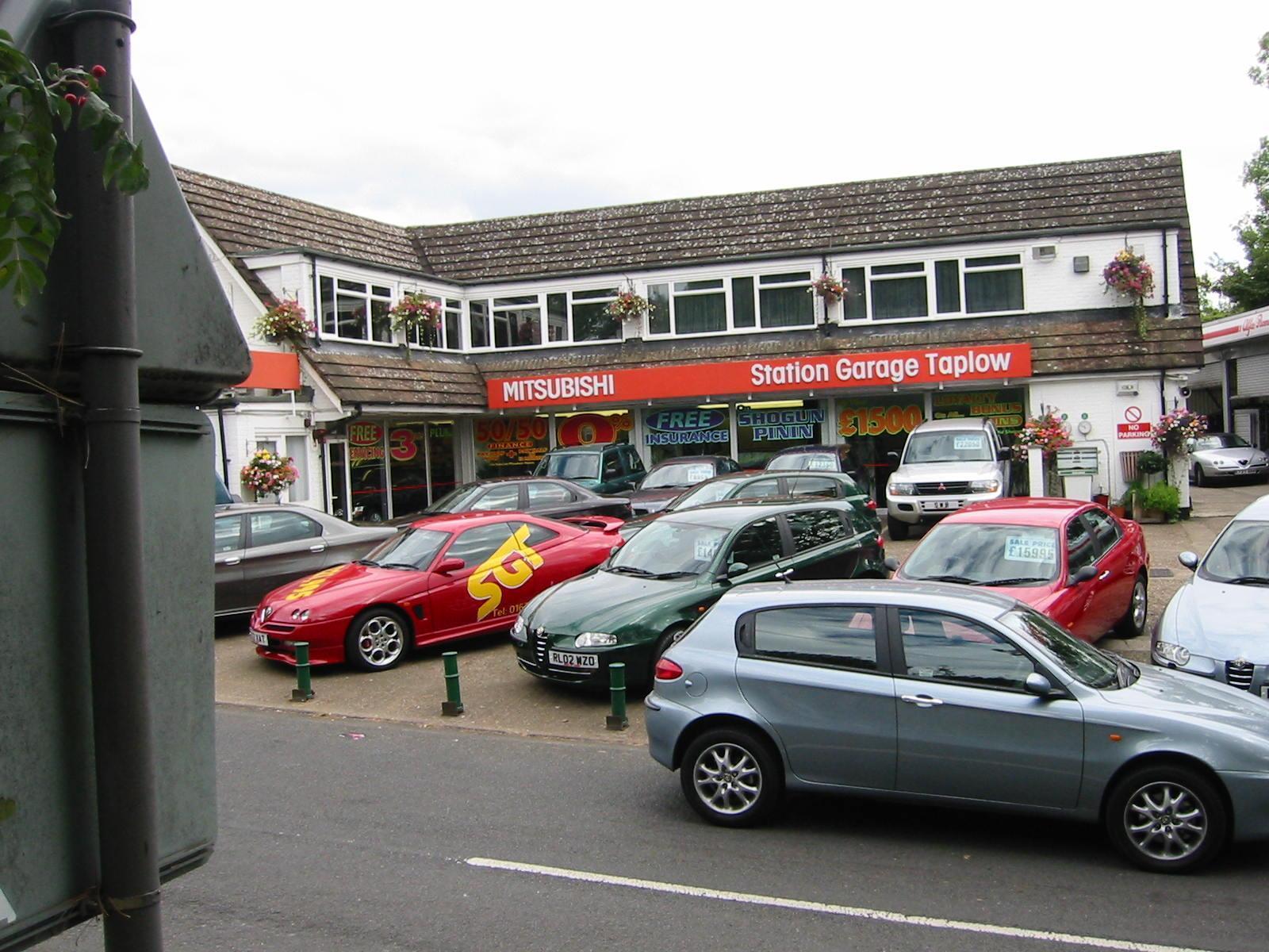

I was watching one of the early videos on the Fox and something caught my eye.....no not your cluttered garage LOL BUT does that say SGT on your number plate? In which case these are the original dealer plates.
NOW.....SGT.....Stands for Station Garage Taplow. I grew up less than a quarter of a mile from here and over the years have known and my family known quite a number of people of whom have worked here. I even did my work experience at this garage back when I was at secondary school for a week. I was then asked back as I was seen to be such a good valeter to valet the brand new cars to go out to the customers....
Anyway, I digress. Station Garage Taplow (a franchise owned by the Langton Family) originally run by Alan Langton .Many many many years ago this garage sold Silk and Triumph motorbikes before becoming a Reliant dealership (I have tried and tried to locate photographs but alas have been unsuccessful). They have always been 'performance' orientated and tended to aim for folk interested in buying Scimitars - in fact you can see one in the background of the second black and white photo (not sure if I've spelt that correctly). As time went on and Reliant died out, they took on Morgan, Lotus, Mitsubishi, Subaru, Alfa Romeo. I even rented space at the back of one of their storage lots for my own cars back when I first got into trading...
As is the story all too often this happened ( they have since relocated to the opposite side of the railway tracks in new buildings purposely built for them but no longer a dealership. Simply an independent workshop that has reused the SGT name. Very sad, I believe Alan Langton lived upstairs above the dealership!
Tony Tappin was the chief tech in charge of the workshops and he was a relic from the Reliant days.
Scroll to page 4 in this link - http://www.taplowsociety.org.uk/twiki/pub/Newsletter/NewsLetter101/Newsletter-101-screen.pdf
It's just the spring that is fucked, not the whole lot.
Get on the blower and speak to
http://www.fleetwayclutches.co.uk/
Tell them what you have done and see if they will furnish you with a replacement spring / replace it for you.
A whole new clutch is a rather drastic step.
Thanks, but my friendly Reliant Owners' Club chap has offered me a diaphragm cover assembly, which should work with the carbon throw out thingy and the brand new clutch plate I now have.
