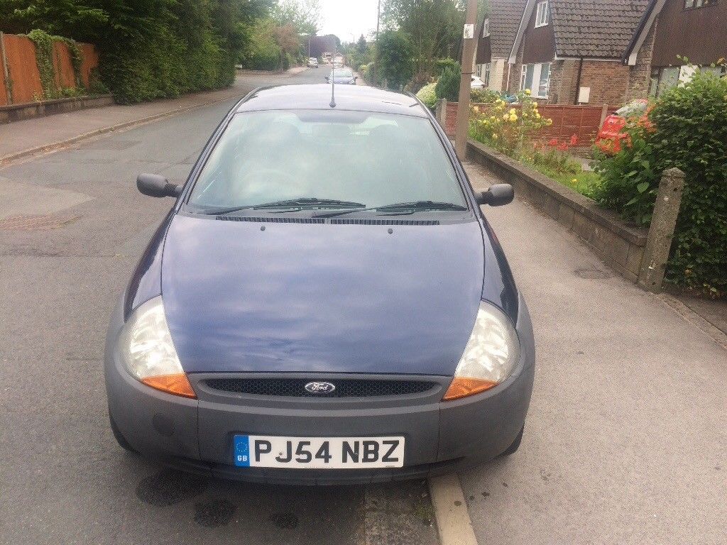

just collected

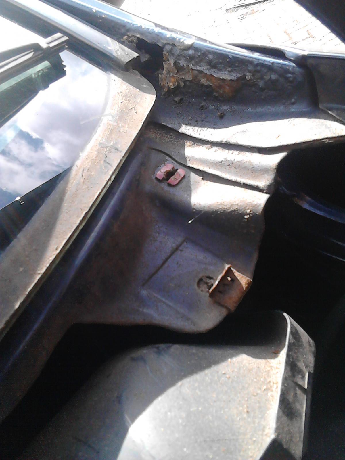

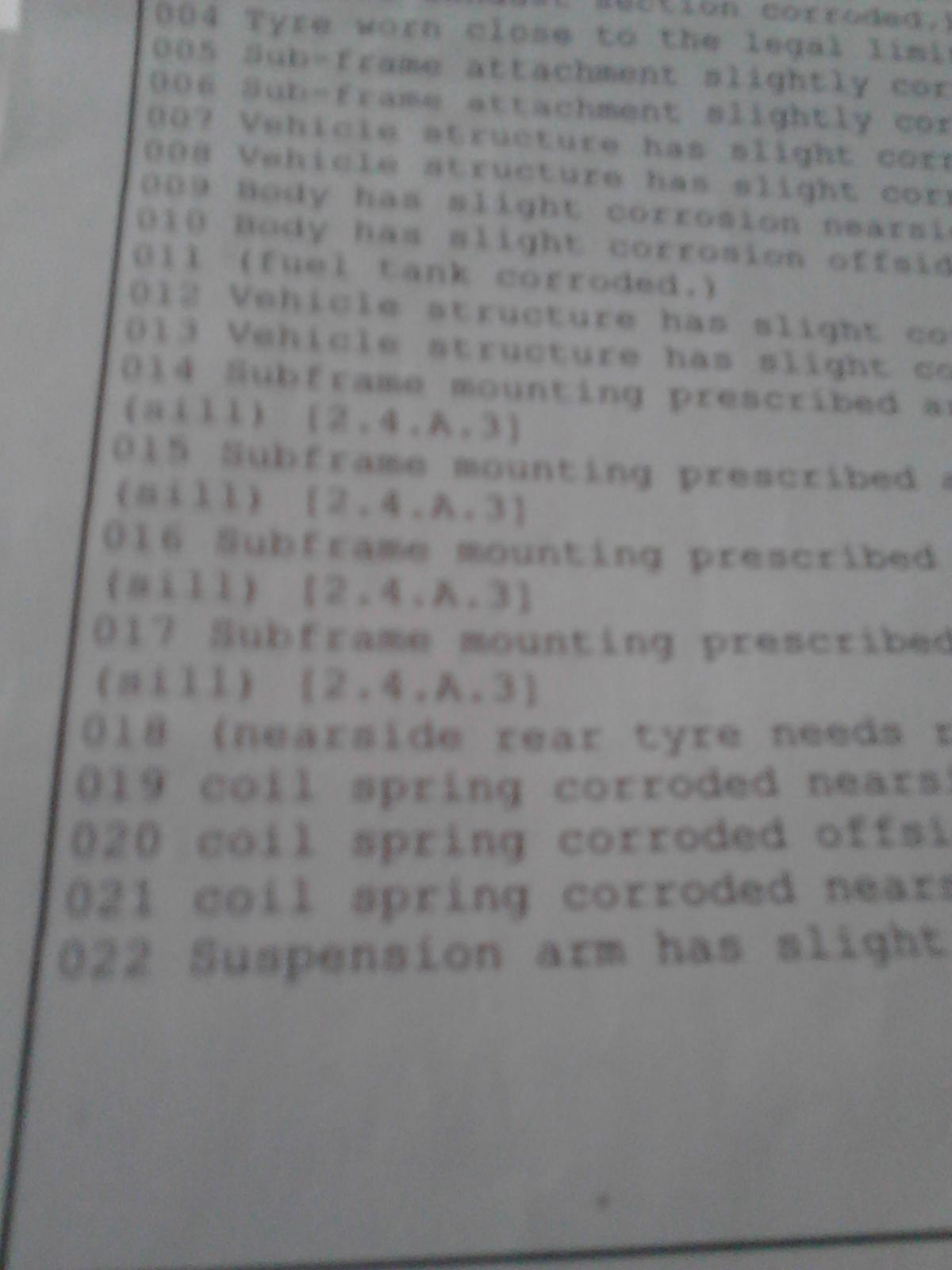

some one was abit advs happy,post-19591-0-96651500-1528095329_thumb.jpgpost-19591-0-96554400-1528095352_thumb.jpgpost-19591-0-45715100-1528095418_thumb.jpg half tank fuel,dare to print more pictures soon
Someone's used to MOTing classic cars that have been kept in a dehumidified storage facility, clearly. He's gonna wear out his "slight corrosion" key.
I'll bet he was a newly qualified person, scared to get caught out. That or some utterly miserable streak of piss.
Either way, Hurrah!

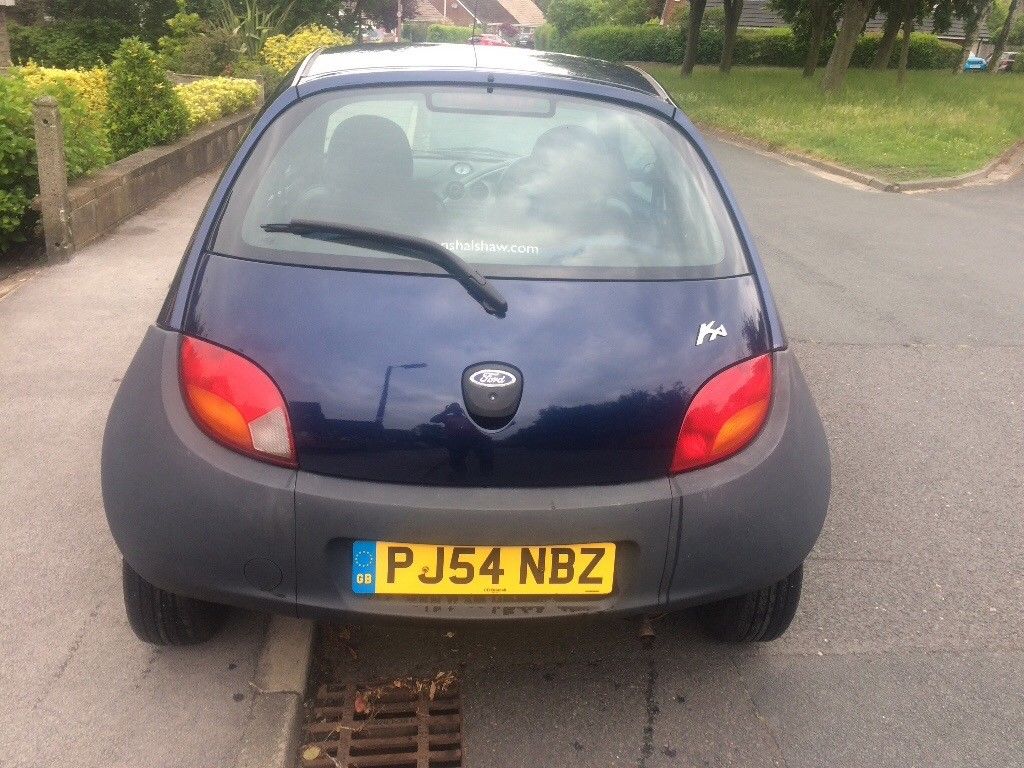

latest piccies,fords finest,or not,has the newer engine,for more power!usual rattle from front susp,needs heater valve,you sweat like a piggie,as the heater is hot all the time,even with windows open,brakes suspect,the good half tank fuel,....poverty spec windup windows,grey bumpers,radio/cass,interior shot,for interior lickers,...

Can’t be a tester in the land who won’t advise on rust on a Ka for fear of losing their ticket when it’s inevitibly as rotten as a pear 3 mins after the test and someone gets all “won’t someone think of the children” on them
MOT sheet makes it seem as if you're trying to get this on the road.
Looks a good one though.

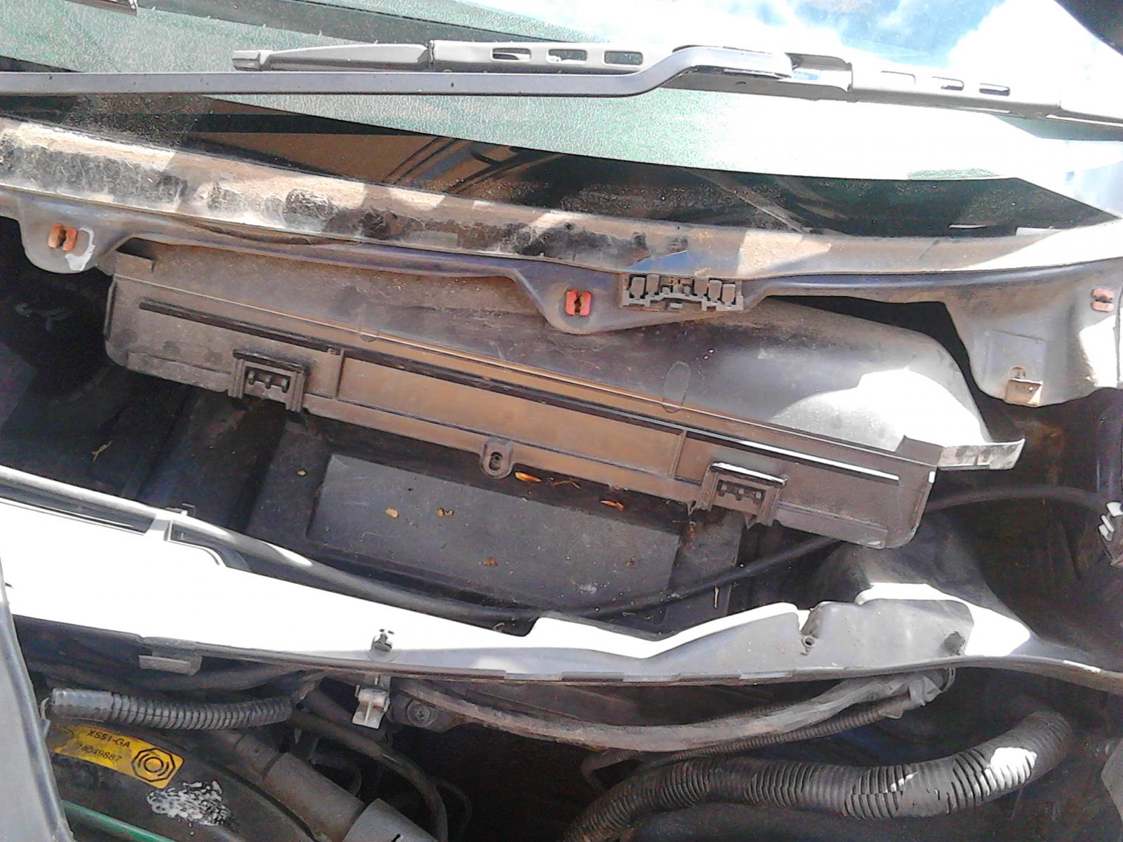

Whats the cause of the hot blower? Had this before with a few ka’s...stuck on hot...is it some sort of switch gone bad?
^ the electrically operated heater valve usually, not uncommon, easy to change aside from skinned knuckles.
That actually looks perfectly decent considering how these normally look when 14 years old. Pray tell how much you managed to wangle this one for? If it’s low enough I will contact Velocity TV Productions and let them know that if they ever get bored of Mike Brewer.....
has about 6 mths mot left,prev bill for last years mot was for lower arm,welding on the sills,£300 odd ,cost on this ,and bought for £40. :-D :-D :-D :-D
Sorry, did you just say £40? Forty quid? As in four - zero pounds sterling?

Have heard that aftermarket heater valves are variable in quality, not that that matters if you are selling it on (some are less than £15 on Amazon, genuine Ford ones are four times that). Scrapyards might be able to help but as these fail so regularly it might be a job finding one. Car Mechanics have done this very repair, and the internet is full of instructionals and vids covering the fix so you should manage just fine.

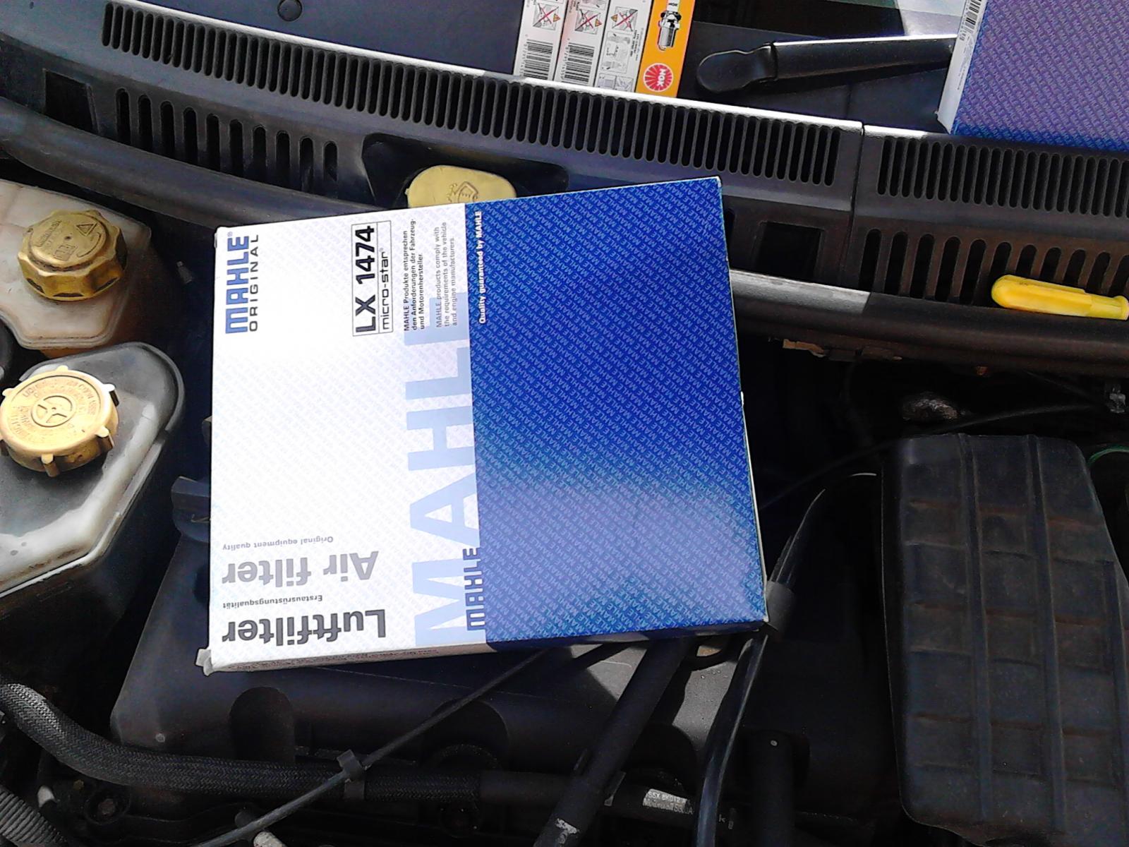

will be doing the valve on thurs, with pictures £10. hong kong,mate has one hes never used,found the front suspension arms fine,passenger side top shocker mount,you can move it side to side,tyres excellent,except for bald one drivers side,new parts to  buy shocker mount,front pads,air filter,pollen filter,oil,have topped up screenwash for now.

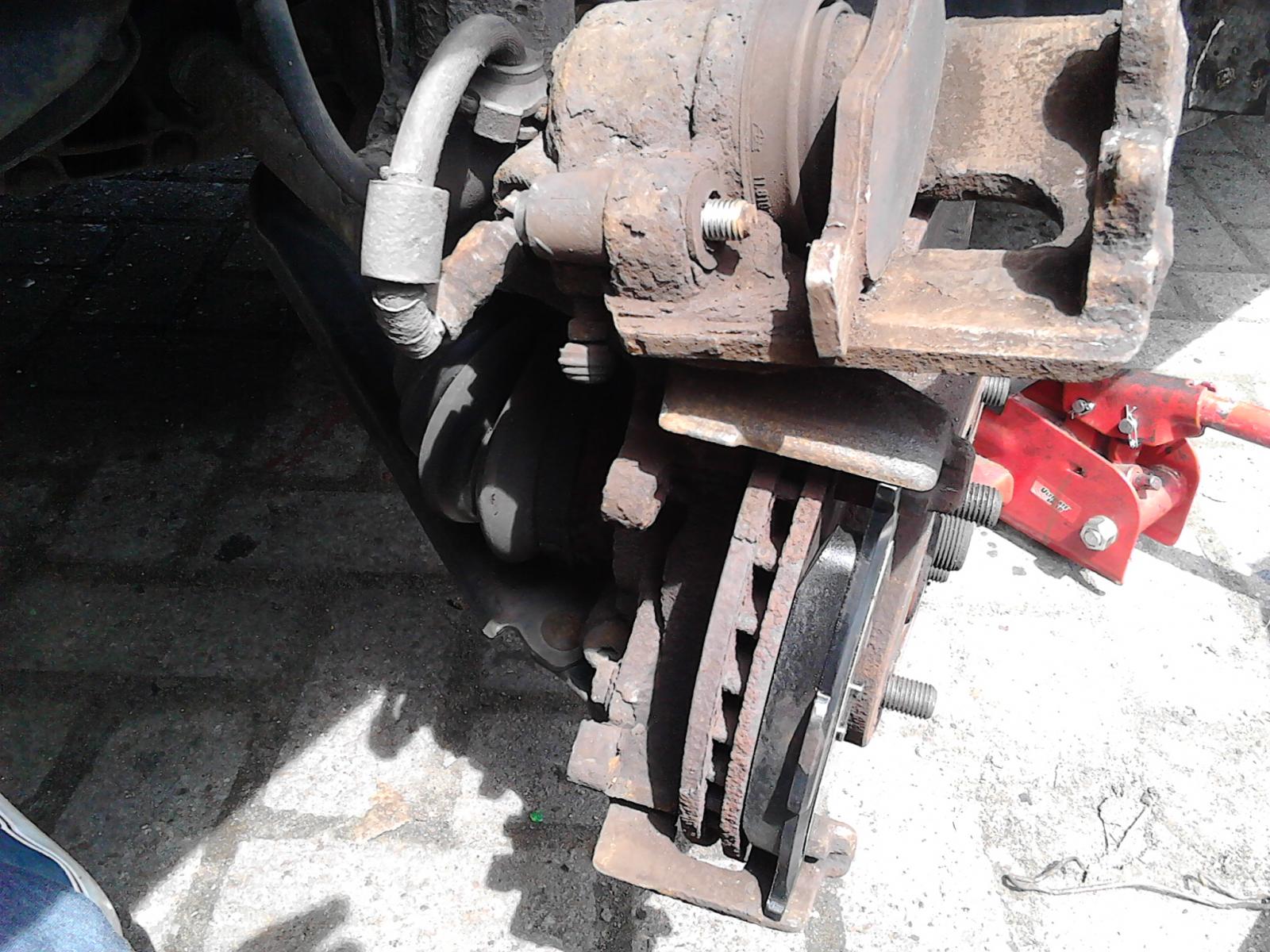

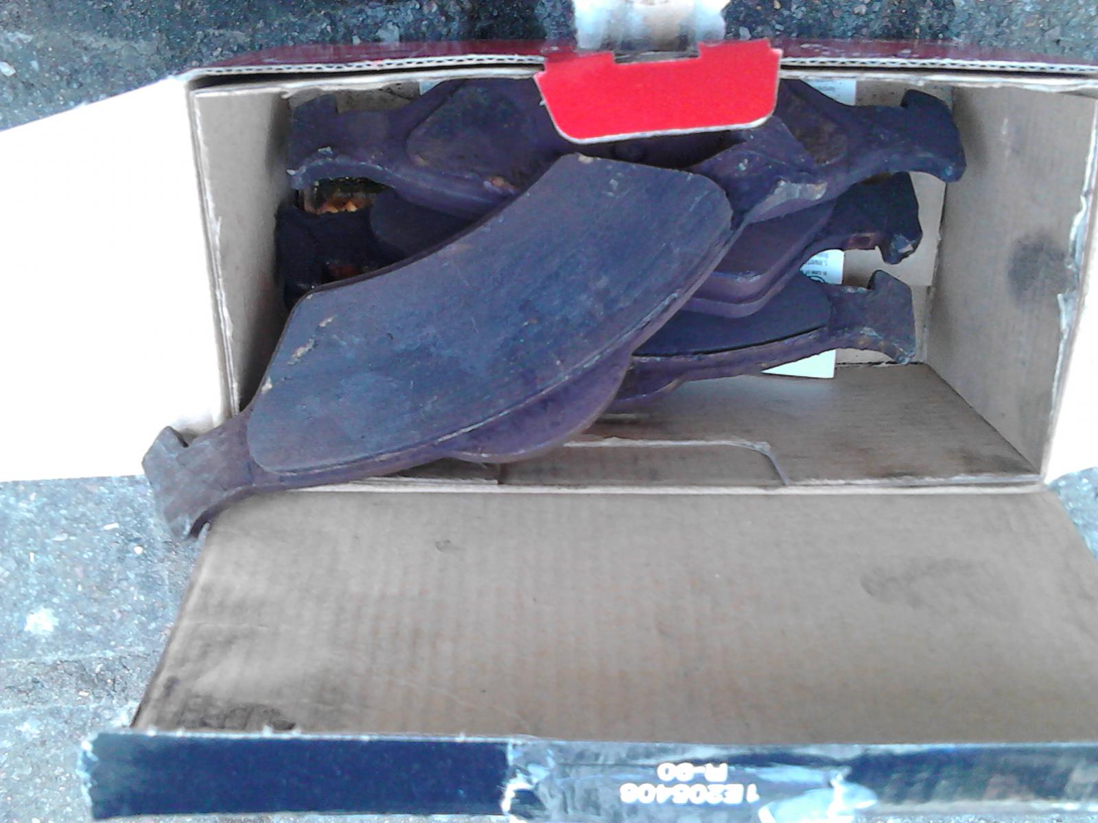

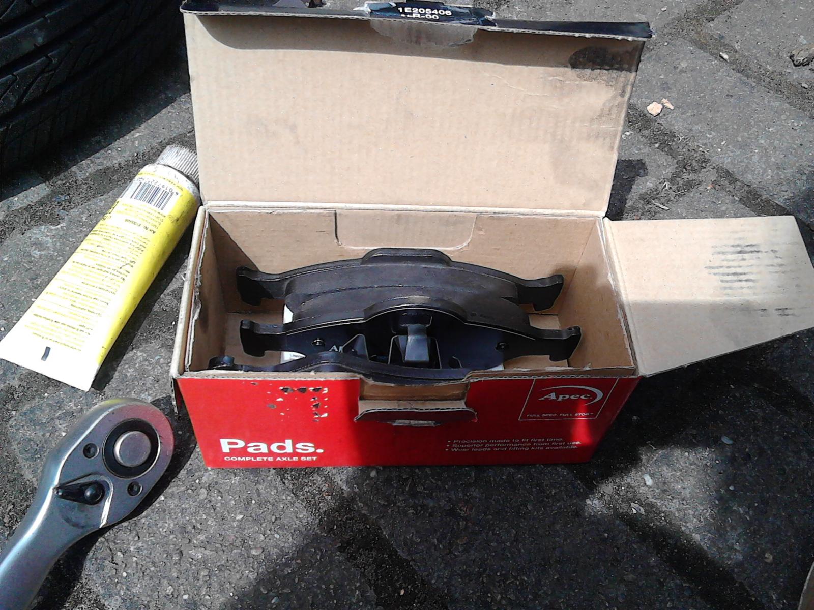

small update today front tyre done a new one for £20 made in some far flung country,got most of service jobbies,had a spare fuel filter mann,got apec pads,they were needed,have put them on pretty quick,see pictures,
Oooh, that was well timed with the pads

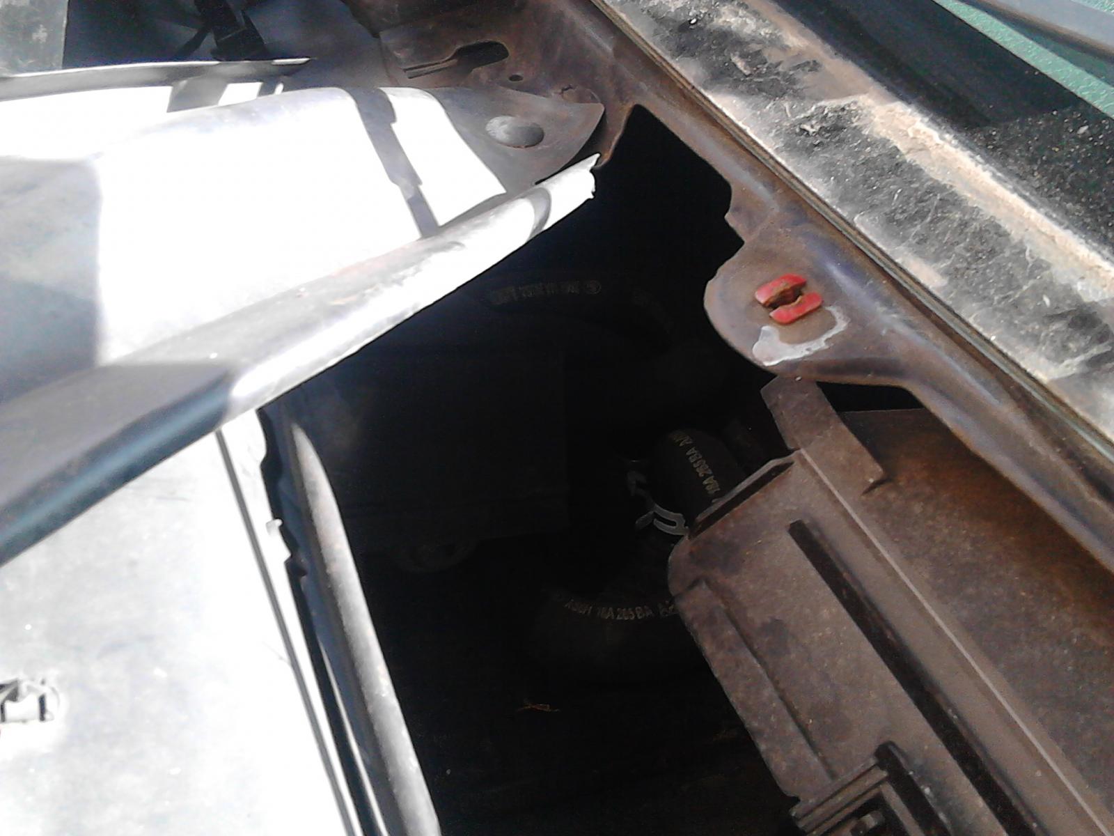

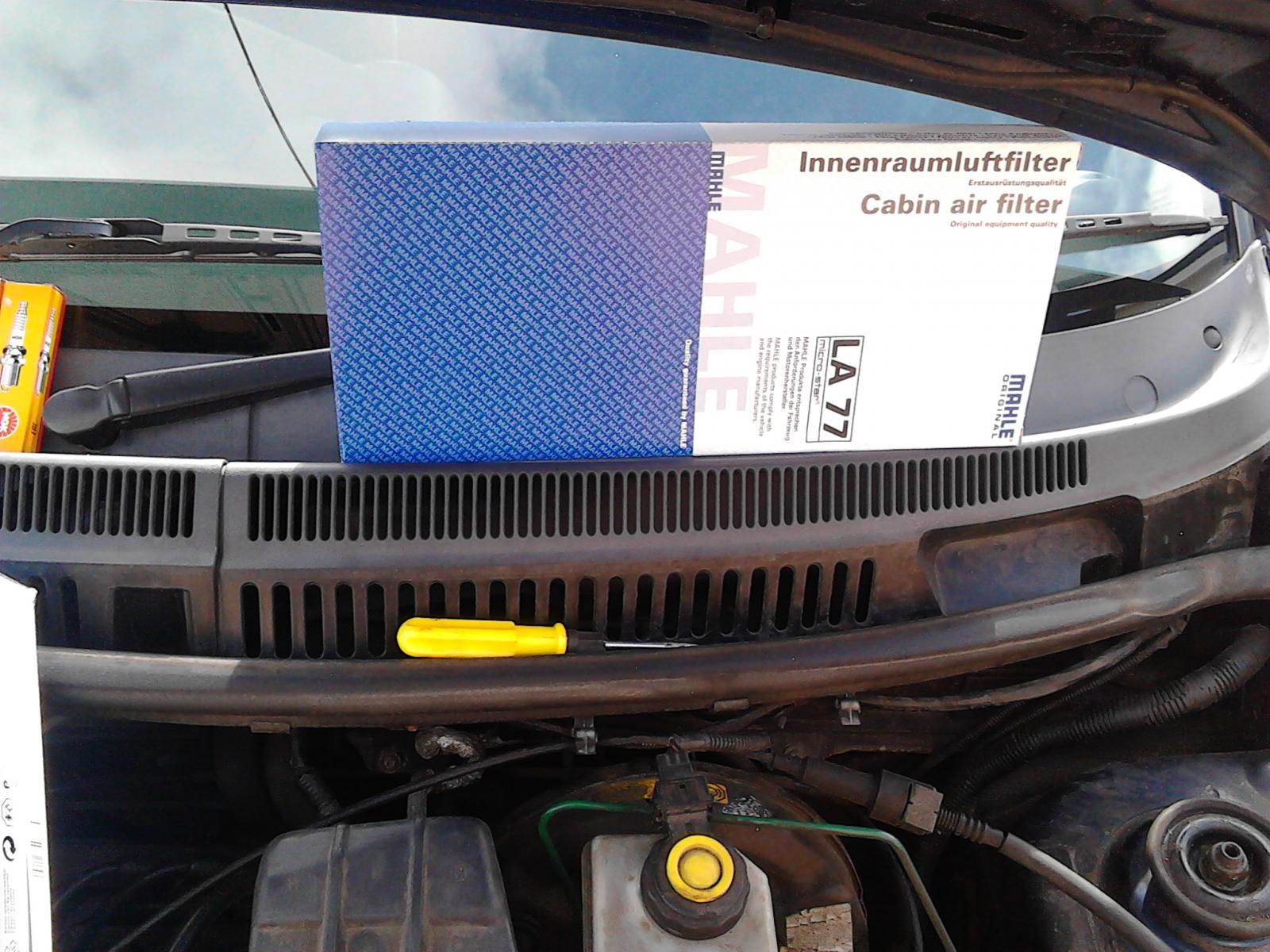

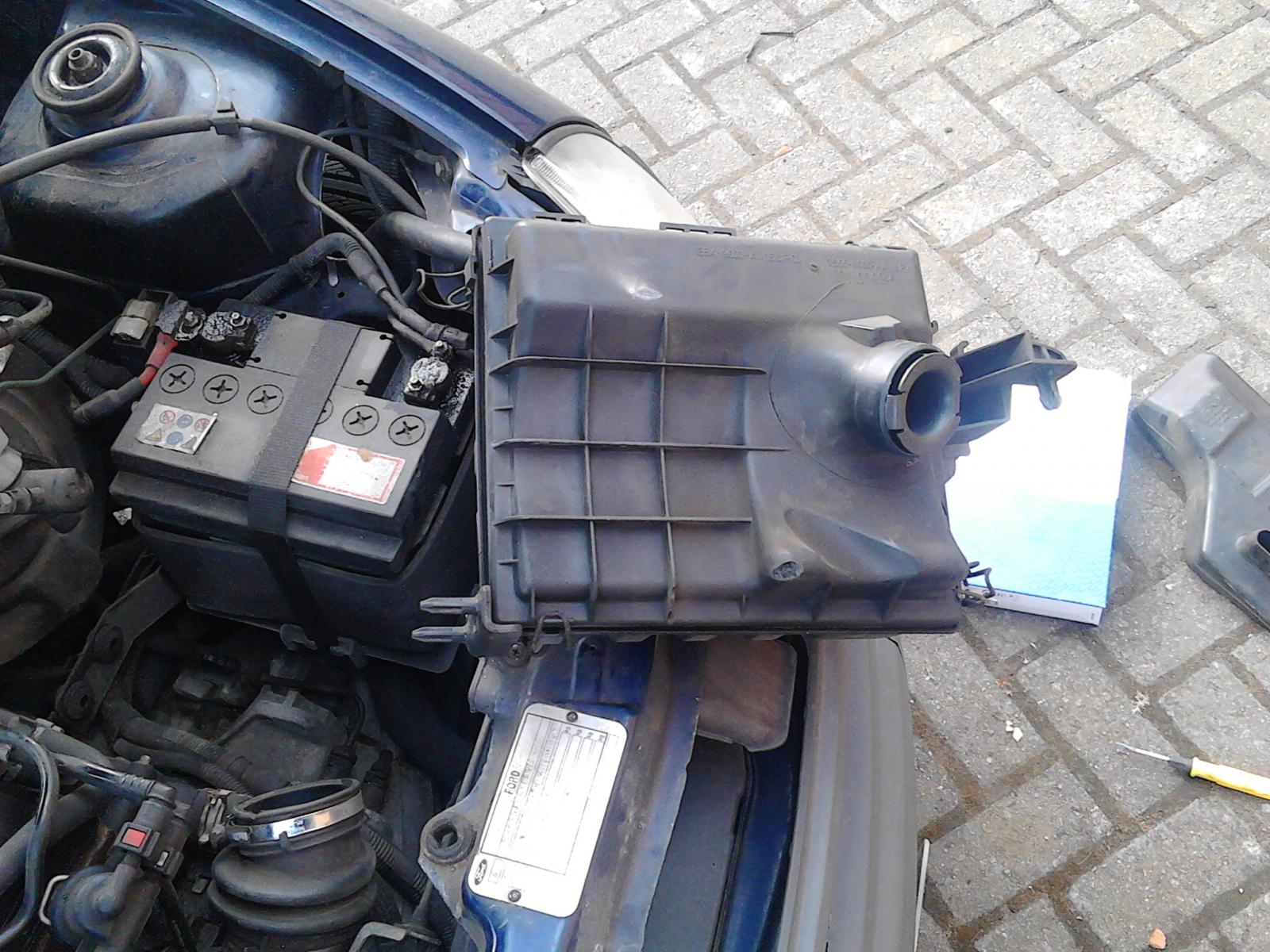

done the small service,pollen filter was missing,spark plugs fomoco was fitted,new ngk plugs fitted,have found a hole,filled it with fibreglass,than brush painted with blackjack,great for felt roof etc,

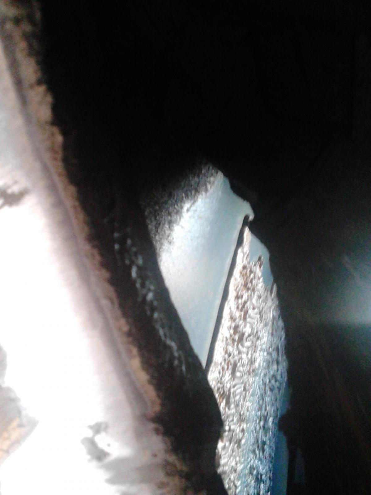

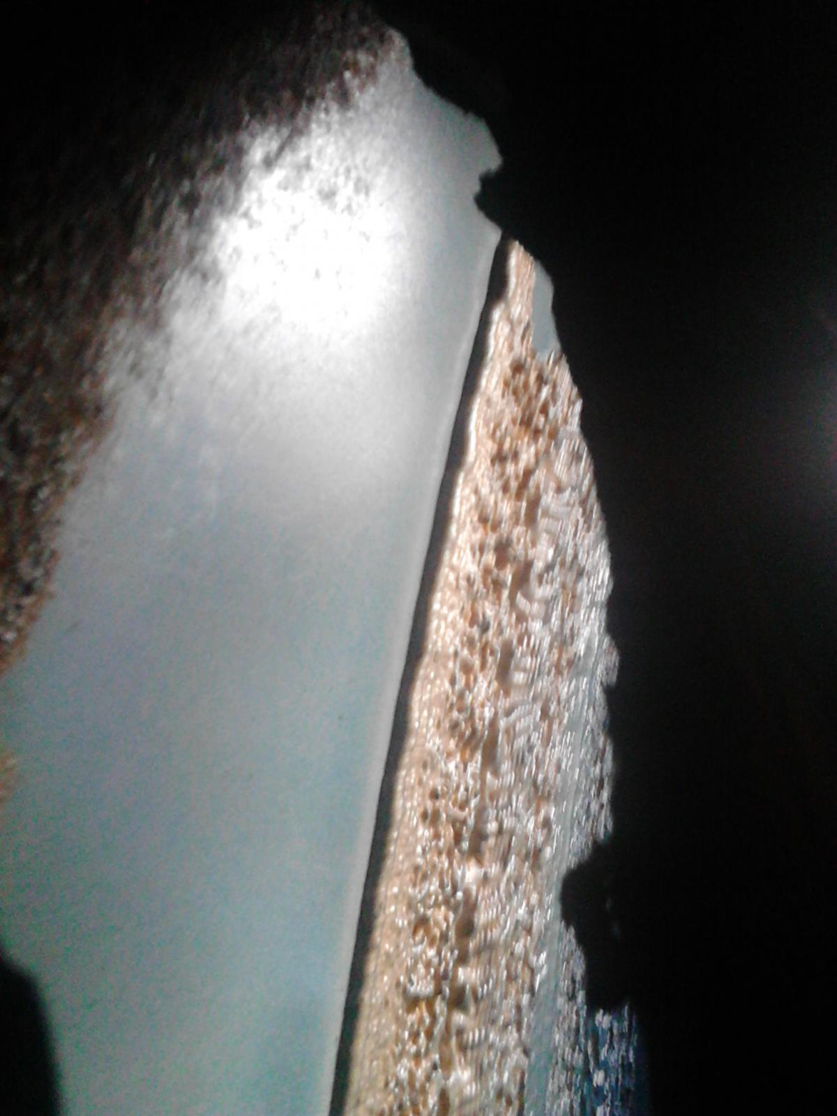

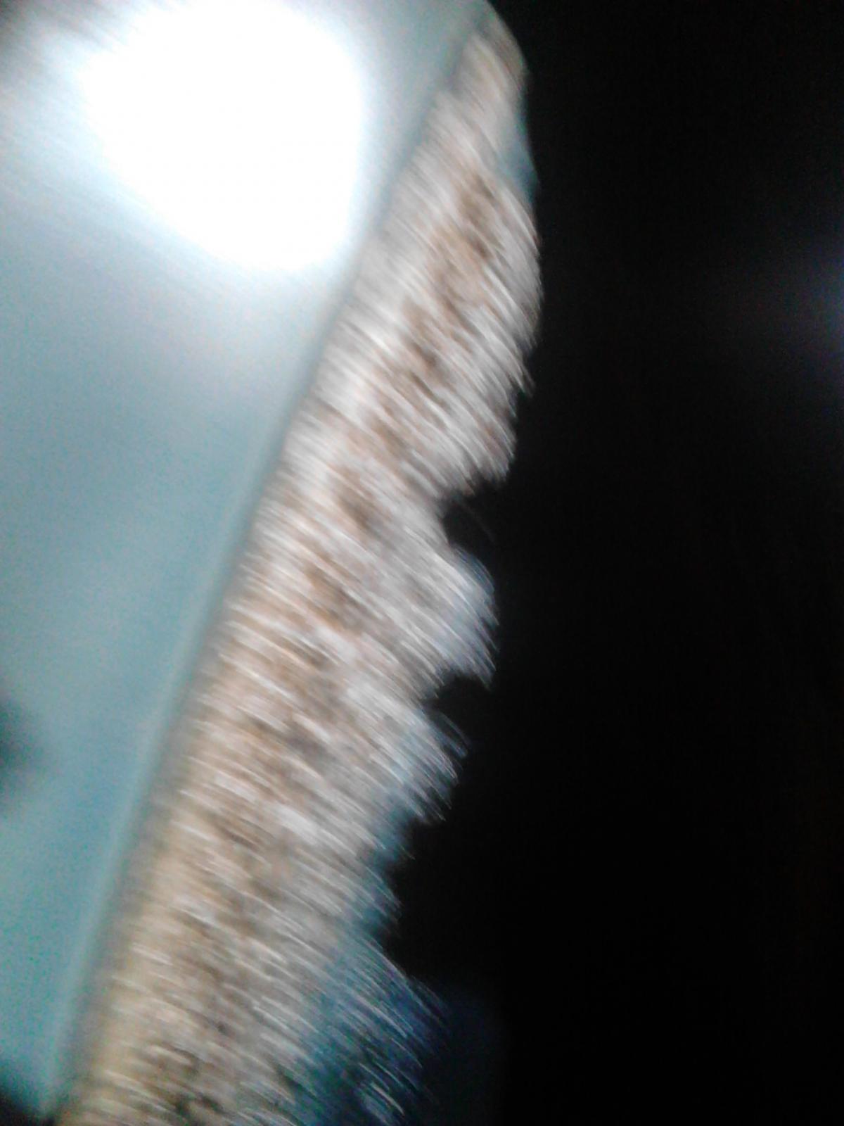

went pokeing about rear w/arch were they all go petrol pipe, found a largish hole,so had to get mig welder out,put a plate in as best as possible,with being so close to fuel etc,than slapped on seam sealer,than fibre glassed,than sprayed on bituman £4.00 spray,the other wheelarch is good...
