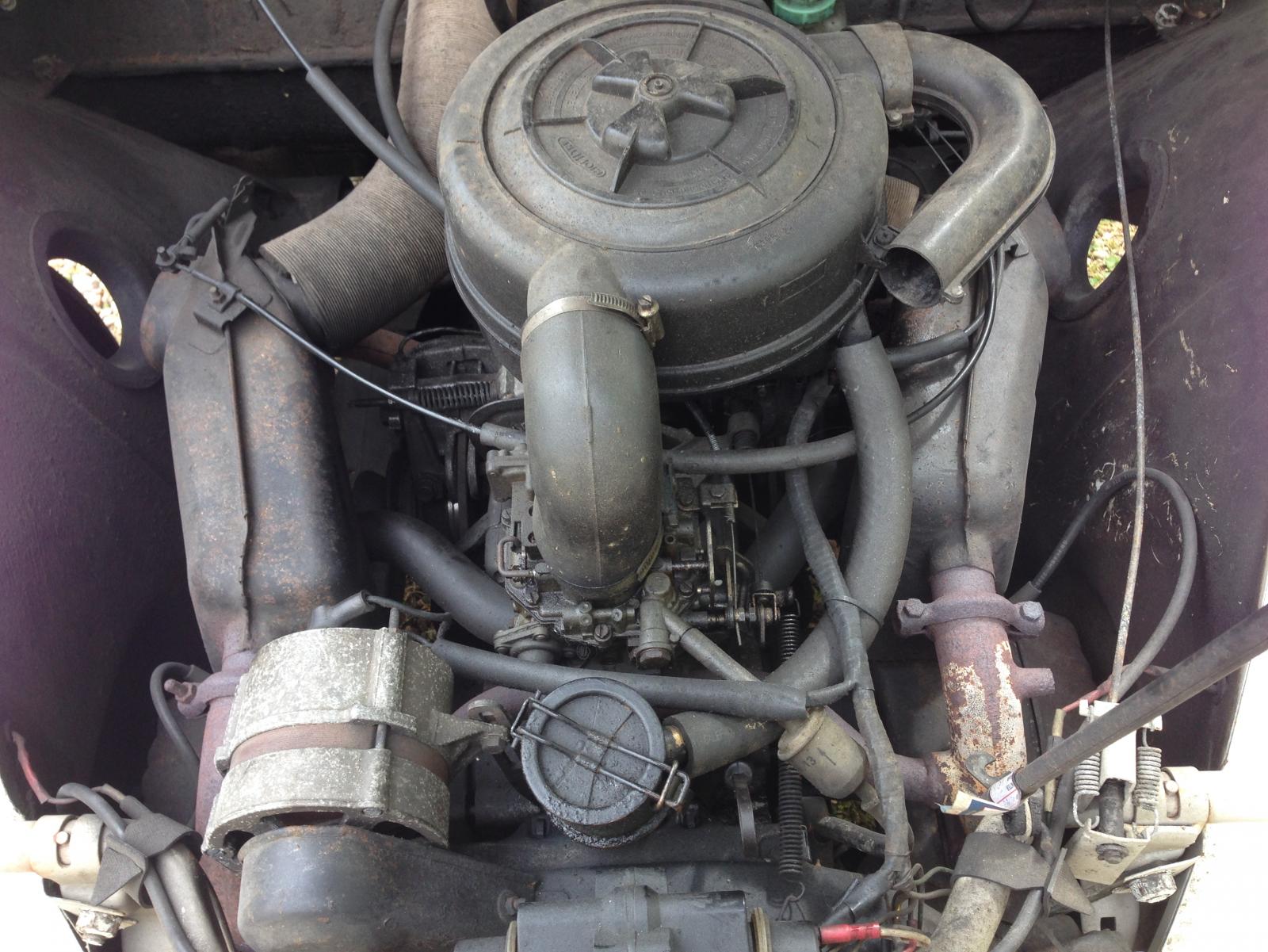

I checked the car over (oil etc) and it would appear that most of the work it was in for was completed. The owner did say that a bit had fallen off when she went to the shops, and was in the boot. I had a look and found this:
It is covered in old engine oil, so was obviously low down in the engine compartment, and is obviously for ducting air, but I cannot see where it has come from. Anybody recognise it and can tell me where it goes please? The HBOL is typically useless.
Its a brake disc cooling duct. I used to take these off and chuck em away. Only ever used to rattle and eventually fall off.
It's the front disc cooling shroud.
The pipe come off the back of the fan shroud. Most have been removed by now as the mounts fracture and they rattle like bastards!
Some leave the pipes in place, aimed at the discs. If there's no undertray, I wouldn't bother. Heater output will be improved if the pipe stubs are blocked off on the cowling.
