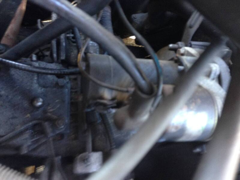

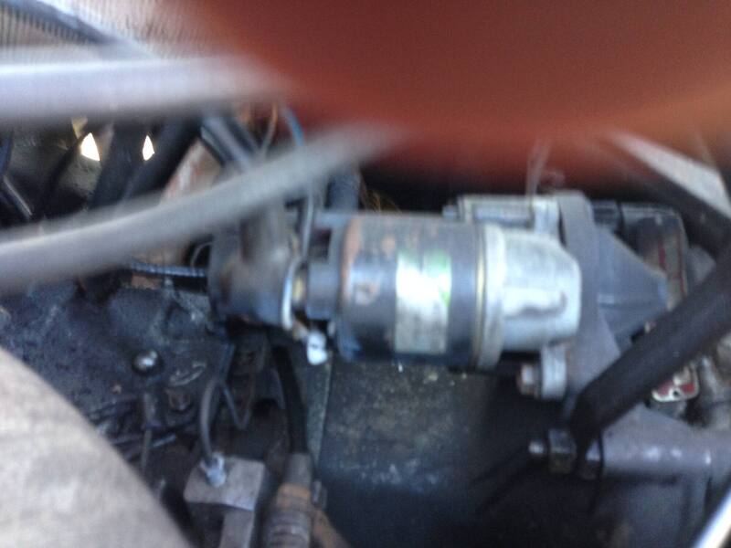

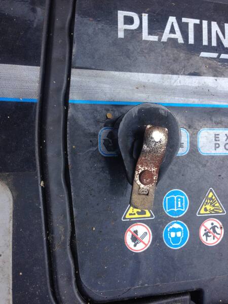

Saabnut Posted July 30, 2019 Author Posted July 30, 2019 Yesterday evening, I was just settling down for the evening when I got a "help" phone call from my friend with the white 2cv - this one The owner was stuck at a local supermarket and needed a jump start. Last trip down I fitted a new battery to it but of late it had been reluctant to start if left for a while, so I assumed the alternator was failing and decided to get it back home then investigate. I took my jump leads over, connected up to the 2cv and - nothing. The engine would turn over very slowly, but after repeated attempts it caught and was running, closely followed by a shout from the owner who was stood at the front of the car that it was on fire! I assumed it was a bit of smoke (as there had been no backfires or anything when starting) but jumped out to have a look and sure enough flames were coming from the top of the engine! The flames were coming from the side of the starter motor so I grabbed a bottle of water from my friends shopping and quickly got the fire out. Fortunately I had left the engine running, and all seemed under control, so we drove it back home, but it into the cave and I disconnected the battery to be on the safe side. Looking at the starter on returning home, the link wire from the solenoid into the starter had overheated and it was the insulation on this that caught fire. The power lead from the battery to the starter also showed signs of the insulation breaking down, so both starter and lead will be ordered and replaced. My friend was quite shaken by the experience and extremely thankful it happened when the bonnet was open so we saw it, and it had not happened when she returned to the car. A close call. but it will live on. Fraz, Bamboocarman, dome and 2 others 5

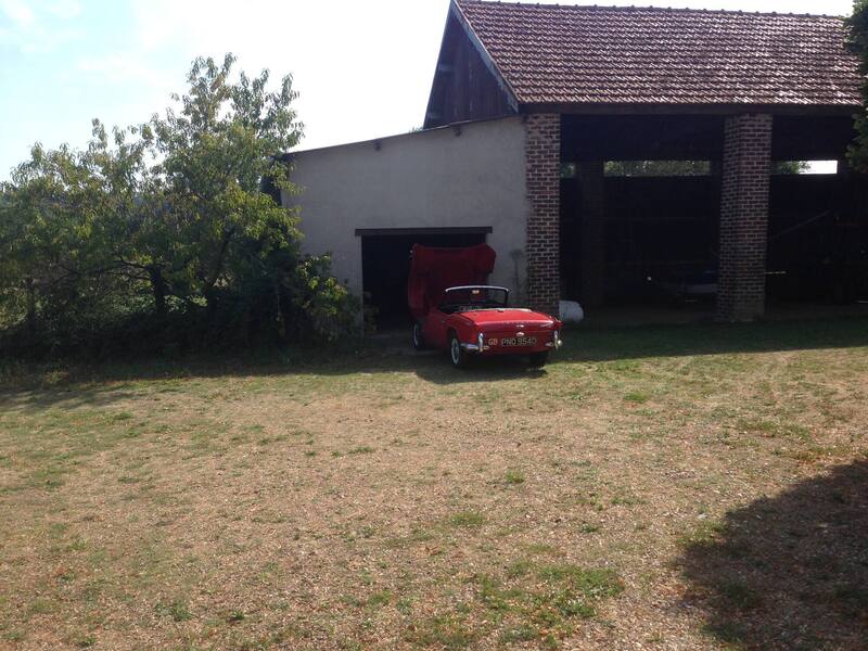

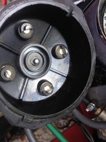

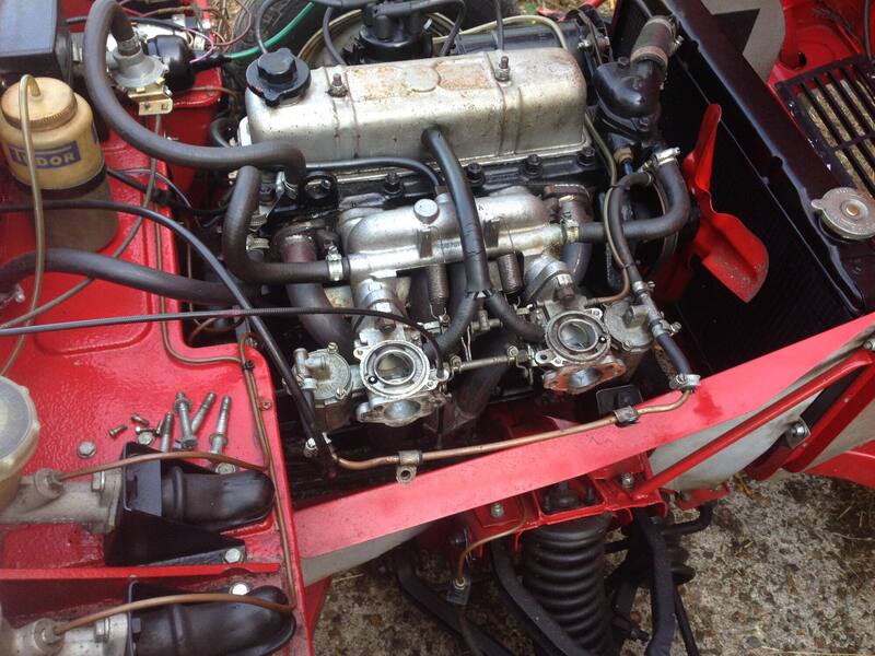

Saabnut Posted August 27, 2019 Author Posted August 27, 2019 Yesterday it was 38c so I was not too keen on more gardening (OK sitting on the mower with a beer) so I decided to have a look at my friends 1966 Spitfire Mk2 which I had used for the local Marcon classic weekend. It had been running far too rich and developed a missfire on the run back home. First job was to move it out of the barn that has a sand floor which is not helpful if you drop anything and park it in the shade of the garage Next was to remove the air filers and strip the carbs so I could set them at a known base setting One carb was well out so set the jet level with the bridge, and I found the choke is sticking partly on on the second carb. Set both but it is obvious that 53 years of use has taken its toll with a bit of wear present. Having said that, I have seen much worse so I am pretty sure they will be OK for a while. Put the carbs back together to start the engine and fine tune the carbs, and it started instantly, a good sign, but the miss-fire persisted, with backfiring in the exhaust occasionally when held on a fast tickover. It had cut out on mr the morning of the show and refused to restart for a while, before starting and being fine, so I suspected the ignition side, indeed the backfire showed the symptons of closed points. Off with the distributor cap, looked fairly new but some light corrosion on the contacts so cleaned those up with some fine sand paper. Next was the rotor arm and this inspired little confidence, though again cleaned up with sand paper S, that done, time to have a look at and clean/reset the points. Aaaaah...................... I am now suspecting the electronic unit, not sure if I can test it so will have to do some research, but before that that I will do the simple things first and get a new dizzy cap, rotor arm, plugs and leads then take it from there, so as I am heading home this weekend it will have to wait until my next trip. In other news, I was delighted this morning to see work starting on rebuilding the village shop here after a devastating fire back in January. It is a brilliant all round store and the lady who runs it is lovely, so really pleased to see this. However, the fleet reduction is not really going to plan as I now have FOUR cars to collect on my return home, I really must start getting serious about selling some. My friend checked on my Scottish pad the other day, and his comment of "your grass looks like it is having fun" means it looks like the Kubota will be abused again on my return... LightBulbFun, Six-cylinder, Jim Bell and 5 others 8

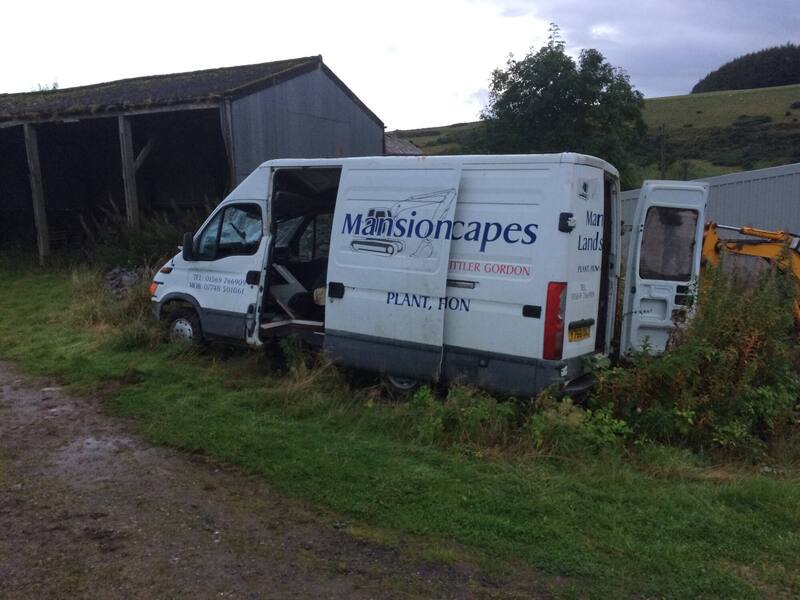

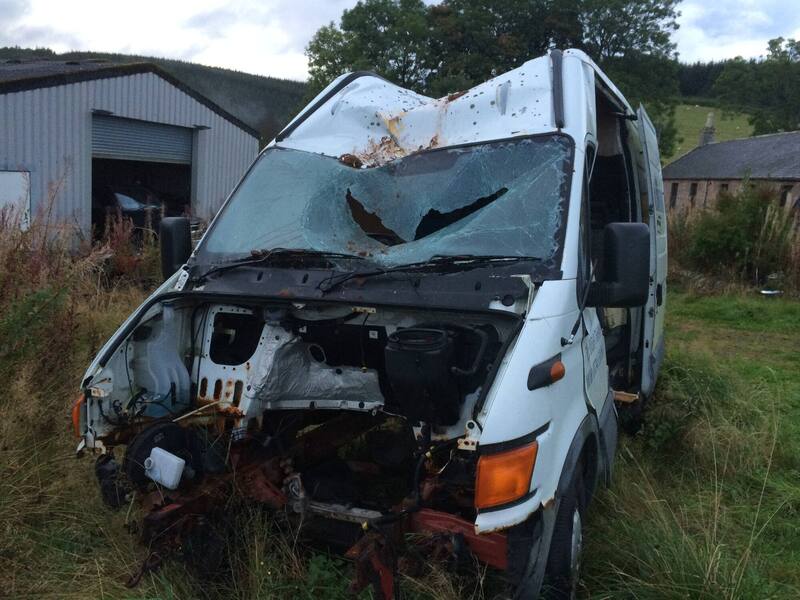

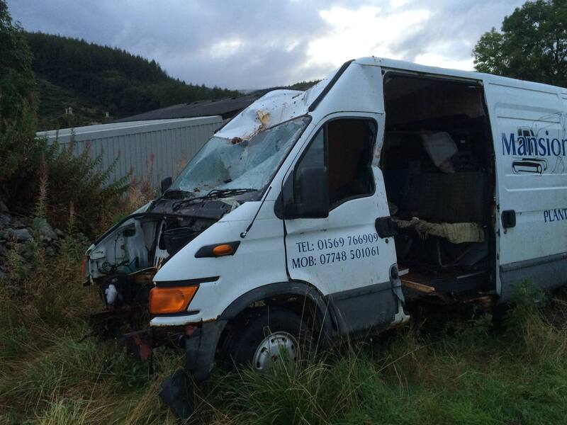

Saabnut Posted September 26, 2019 Author Posted September 26, 2019 In the battle against the world population of VWs, I scored a small victory and improved the world we live in by a tiny bit. My friend has also done the same.... Sadly, in the battle against the Ivecos, I was less victorious, photos later Supernaut, dome, Tickman and 2 others 5

beko1987 Posted September 26, 2019 Posted September 26, 2019 Did they go to drag the iveco and it just turned to dust?

Saabnut Posted September 26, 2019 Author Posted September 26, 2019 20 minutes ago, beko1987 said: Did they go to drag the iveco and it just turned to dust? Sadly, the opposite! I thought I may be able to cheer up @Cavcraft up a bit this evening, but it was not to be. Plan was to add the Iveco shell to the above load, but being a hightop would have attracted too much attention from the BIB or VOSA, so we decided to squash it down a bit first. This was available to do the job So we had a go! Turns out Ivecos are stronger than they look, even putting a kink in the B pillar made no difference! Yep! That is nice and flat now! Four options now. 1. Bigger digger - not going to happen as that will cost £££££ 2. My scrap man is heading home empty from the area and will pick it up. Easiest solution but could take a while. 3. Stihl saw around the waistline to reduce height. This inviolves effort. 4. I forklift it onto my trailer and take it away myself. Most likely solution, but we will see. Ohdearme 1
beko1987 Posted September 26, 2019 Posted September 26, 2019 12 minutes ago, Tayne said: Chop it up. Its how I managed to get a surfboard in a wheelie bin a few years ago. Need a big old bin to drip that away every 2 weeks... I smash vacuum bodies up and stick them in the general recycling bin almost every week, goes in when the bins been emptied. Technically it's fine because it is recyclable! paulplom 1

Zelandeth Posted September 26, 2019 Posted September 26, 2019 Sounds like a fine excuse to go play with a petrol powered 9" grinder... Saabnut and LightBulbFun 2

Supernaut Posted September 27, 2019 Posted September 27, 2019 Don't you have a forklift? Pick up something heavy with the forklift, hoist it up above the van, then drop it on top of the van.

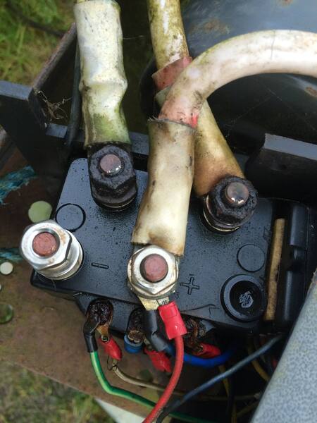

Saabnut Posted September 28, 2019 Author Posted September 28, 2019 Tomorrow I have a collection to do for a friend, a simple job of picking up the bodyshell from storage and delivering it to his garage about 5 miles away. To do this I will need the Discovery of Doom and my Ifor Williams trailer with the electric winch. This week another friend borrowed my trailer as I am going to store his project car in my shed whilst he moves house and he reported the winch immediately started paying out as soon as power was applied. Today I unloaded the trailer and investigated the winch. As the motor still turns, the problem must be the control box which I suspect has had water ingress, Opened it up, and yes, there has been water in there! Tried water dispersant but it would appear I am too late for that. On the right of the picture there is a small electronic type box which concerns me as I know sod all about electronics. I removed the complete box to further investigate then had a brainwave. I thought I would take power directly from the battery to the wires to the motor via jump leads, thinking that would solve the problem for tomorrow, but as said I know sod all about these things and that did not work! I have wimped out and organised some assistants for tomorrow and will investigate the control box later. I will take a long ratchet strab as an emergency if slow winch! As to the car I am storing, a couple of photies Six-cylinder and aldo135 2
