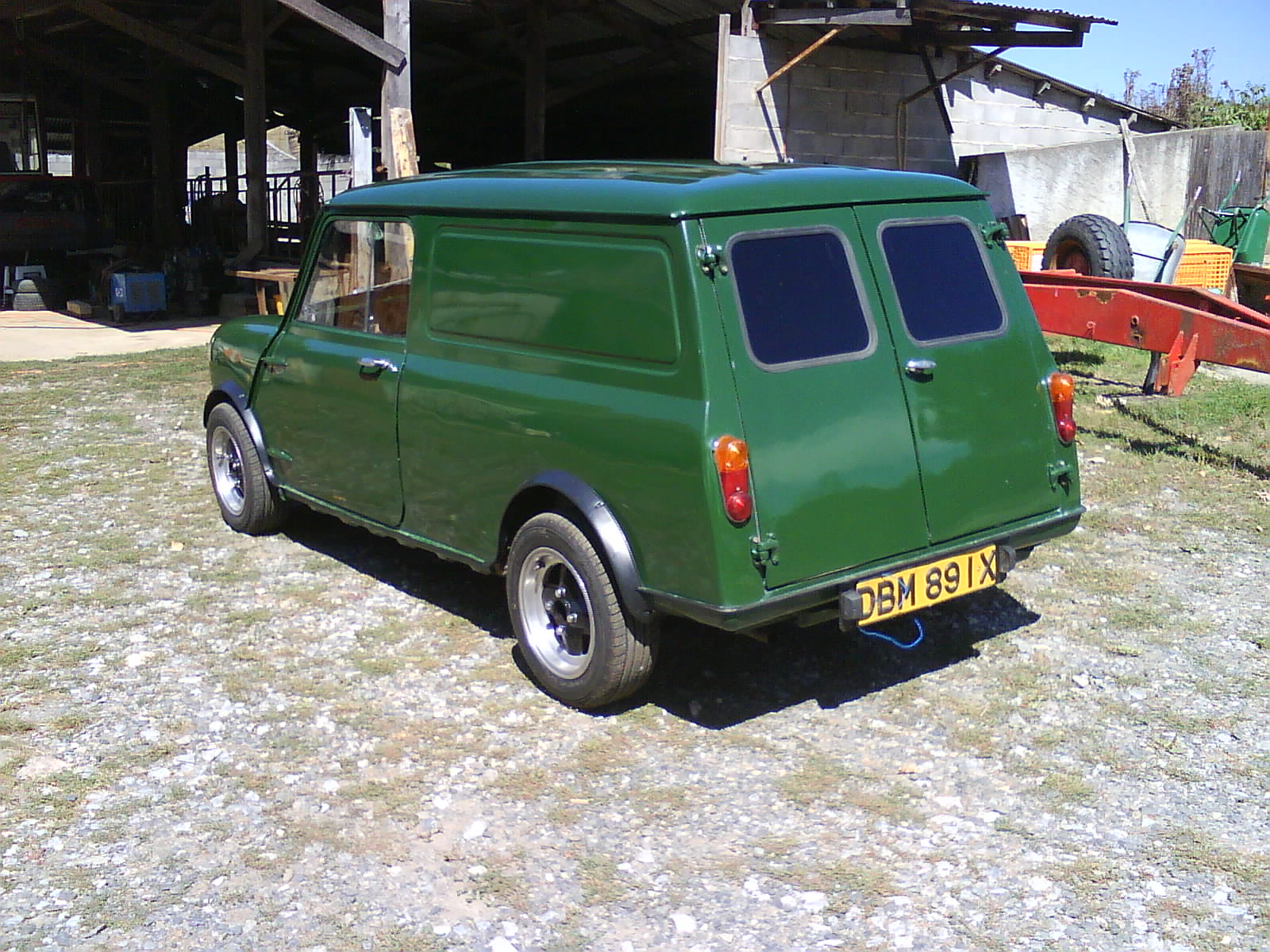

The last full respray I did was the Mini van and I got the paint from Jawel paints on ebay, but spent way more than the paint costs on all the consumables.
It was two-pack done in a wee shed with a compressor and a supposedly two-pack safe facemask which in reality probably knocked a few years off my life expectancy.
I dont know what I did wrong....but it came out with hellish orange peel all over. I managed to get a decent finish but it took several days of wet sanding as 2pack isnt easy to sand....you need the finish to be perfect straight out the gun.
