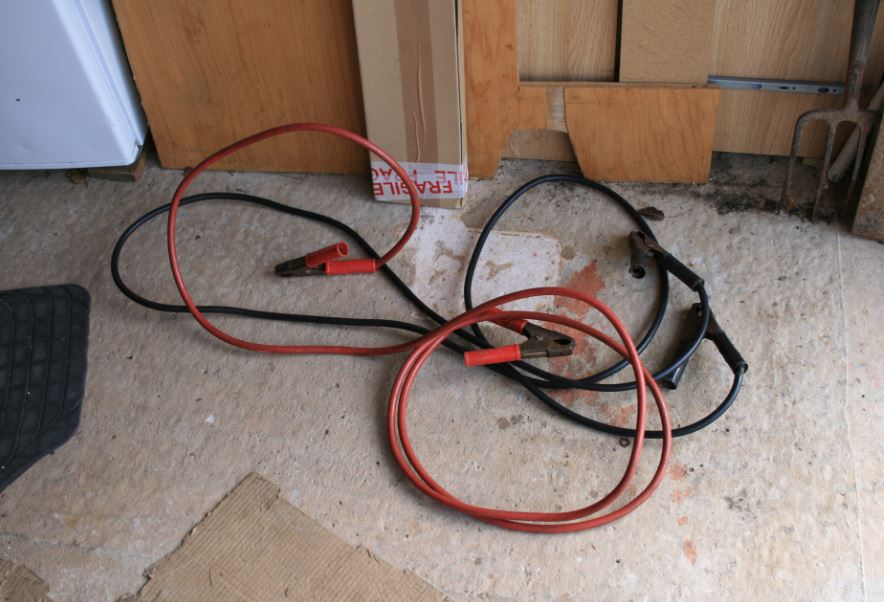

I wanted to give the garage a good tidy-up today as the weather was behaving itself for once.  I hadn't fired up the Fiesta in ages so gave the battery a good charge up overnight, but on reconnecting, absolutely nothing, not even the dash lights.
Time to bust out these:-
Along with the family Datsun:-
But still nowt.  Arsecakes.  Worked fine* in November.

Corroded off cable.  If you've not even got any dash lamps with jump cables on, then there's no connection at all betwixt battery and rest-of-car.
Check the ground first, as it's easier to fix.

Have you connected the small wire to the pos terminal aswell as the thick one?
If not the car will have no power.

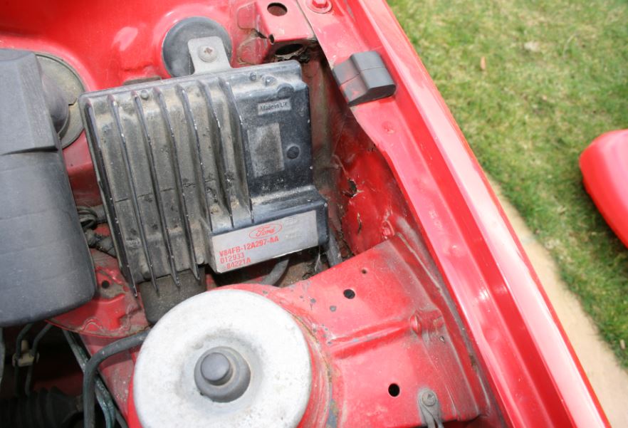

I woke up halfway through the night thinking "bet its the ignition relay". Had 5 mins in the garage before heading off to work - three screws had the fusebox out, swapped ign relay with the identical heated rear window relay, turned key. Dash lights on. Good. Turned key further. Starter operated. Excellent!

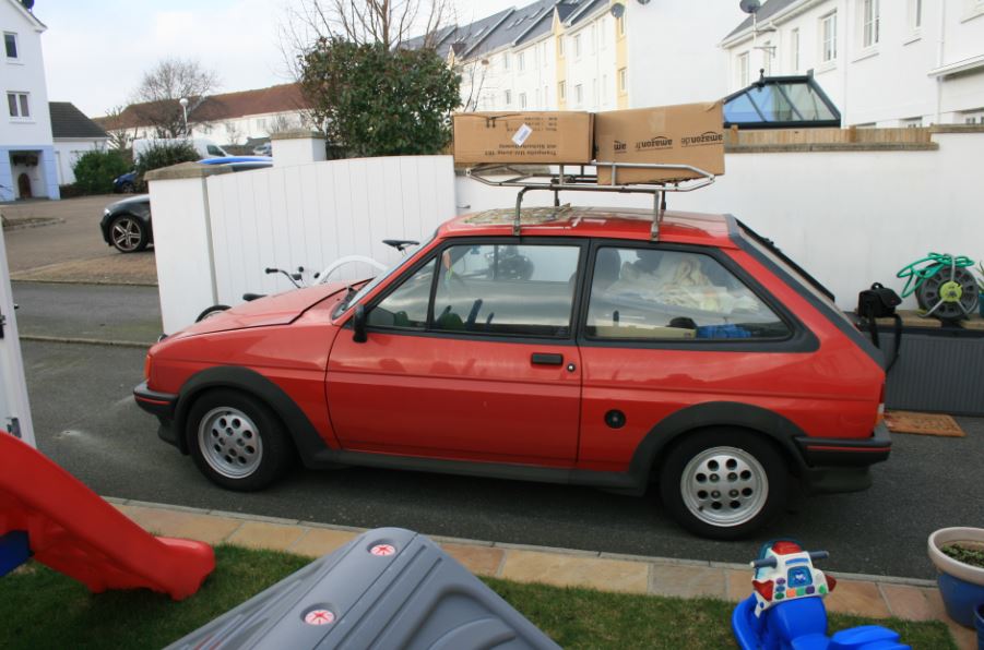

Got home sharp so that I could get another look at this old heap.
I appear to have been successful in reviving the battery, it held a charge and fired right up. So I pulled it out the garage then went for a nice piss.
On my return I took a few photos while letting it cool down. The roof rack is purely functional as my garage is CHOCK FULL OF YAD so I need the extra roof-based storage space for some of my son's outdoor toys and that.

Right about now I thought I'd start it up again, well after running ok earlier it was back to exactly the frigging same with a hot-start misfire. I noted the fuel feed looking worryingly aged and frayed, should swap that out ASAP really for all the time it'll take. Couldn't find my spark plug socket after a quick hunt through the toolbox (bet its rolled under some junk) so I whipped off the dizzy cap and gave it a light once over with some 80 grit, cleaned up that slightly rusty shaft too. Not that it made any more than bugger all difference whatsoever, therefore with daylight fading and weather rapidly worsening I shoved it back inside until whenever I get the next opportunity to troubleshoot. Thanks for watching!
  • 4 weeks later...
Right there's good news. I sussed that a set of these might get rid of the misfire:
Worked a treat!! I also found the rear wiper and bolted it back on.
