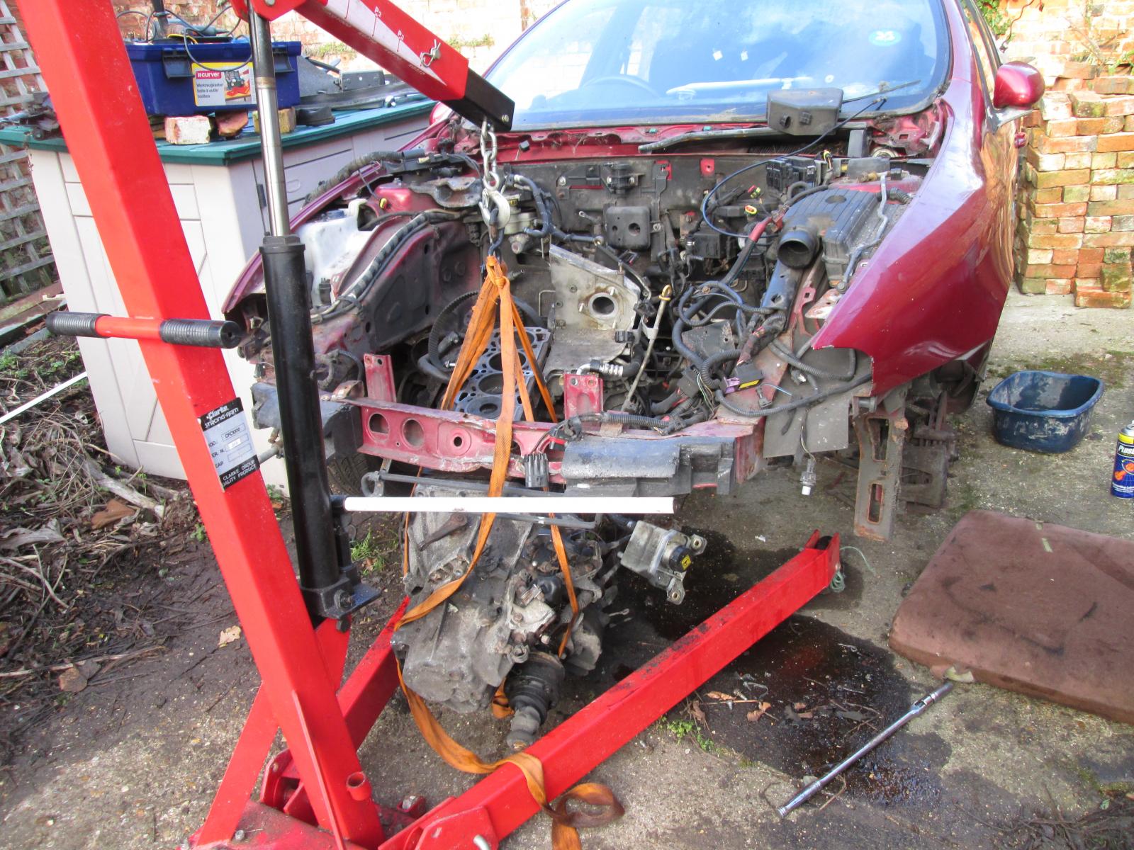

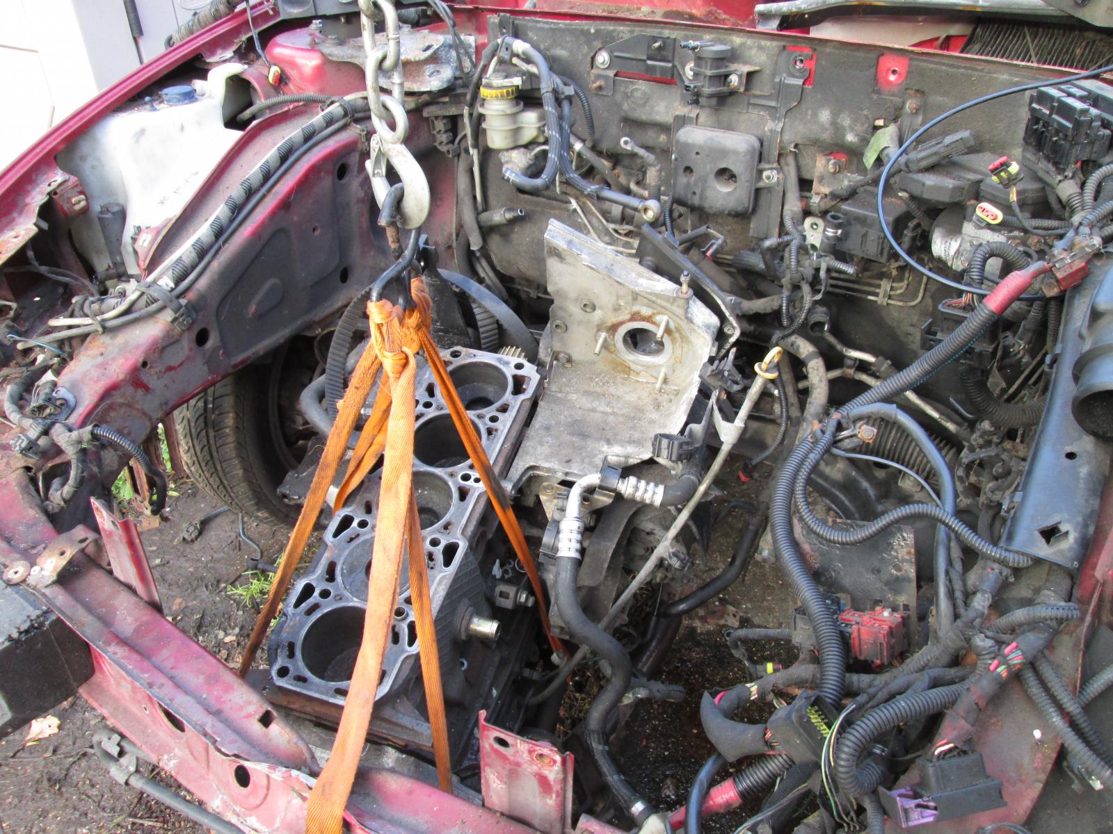

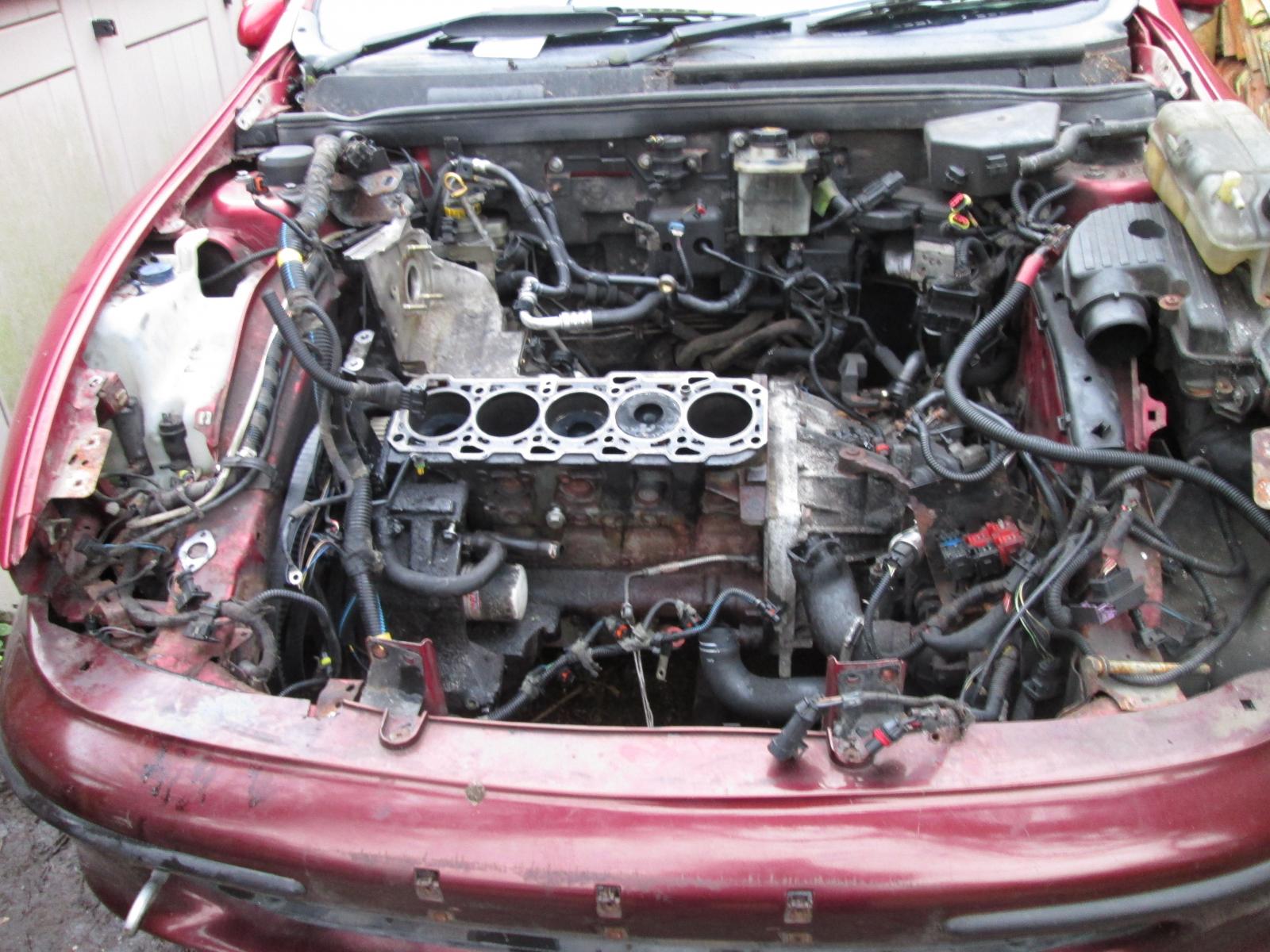

Last saturday I went back to Cambridgeshire to start the extraction of the engine and gearbox from the scrap Marea weekend that provided replacement tailgate and bumper after the accident before Christmas...
I got to the point where I got the cylinder head off and called it a day. I left with diesel and aircon pumps, inlet manifold, starter motor and everything that I took off as I was dismantling that lot...
I left it looking like this...

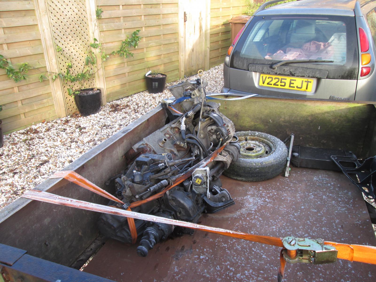

Yesterday I went back, this time with engine crane and trailer...
By mid afternoon it was out and loaded into the trailer...
As you can imagine it's a heavy lump, we had to lift it into the trailer with the crane. Today I started stripping it in-situ in the trailer. Removed the alternator and the Power steering pump and the bits off the top. Next week I'll set about splitting the gearbox and block and make it more movable and easier to store...
I've set to with cleaning everything before I store it all in the lock-up...
