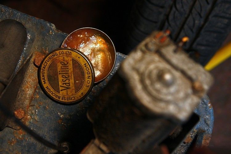

Finally got around to some servicing/tinkering on the Herald today. It was long overdue and oil/filter change.  Wiper motor terminals often misbehave over winter so treated them to some appropriately aged vaseline.

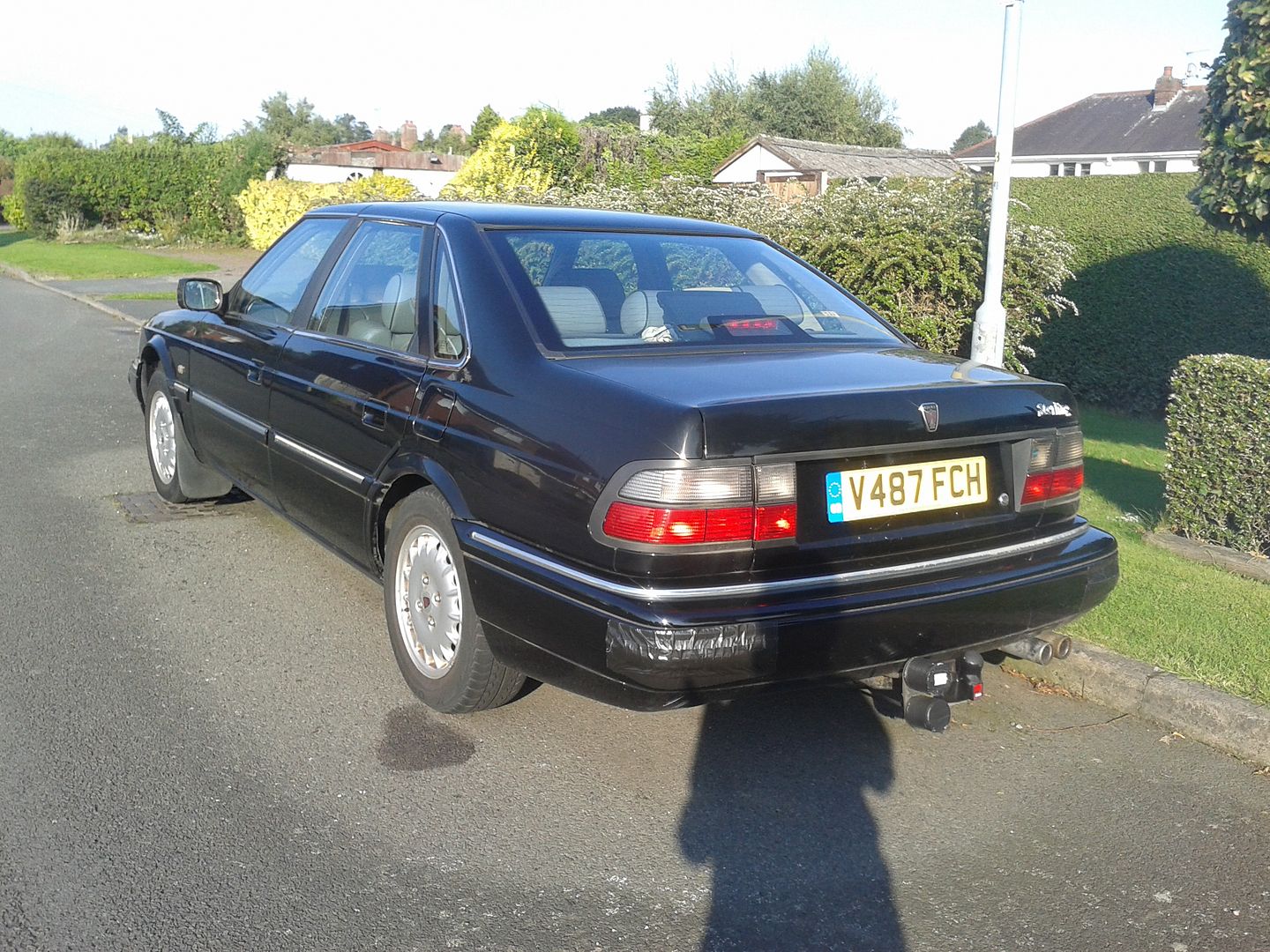

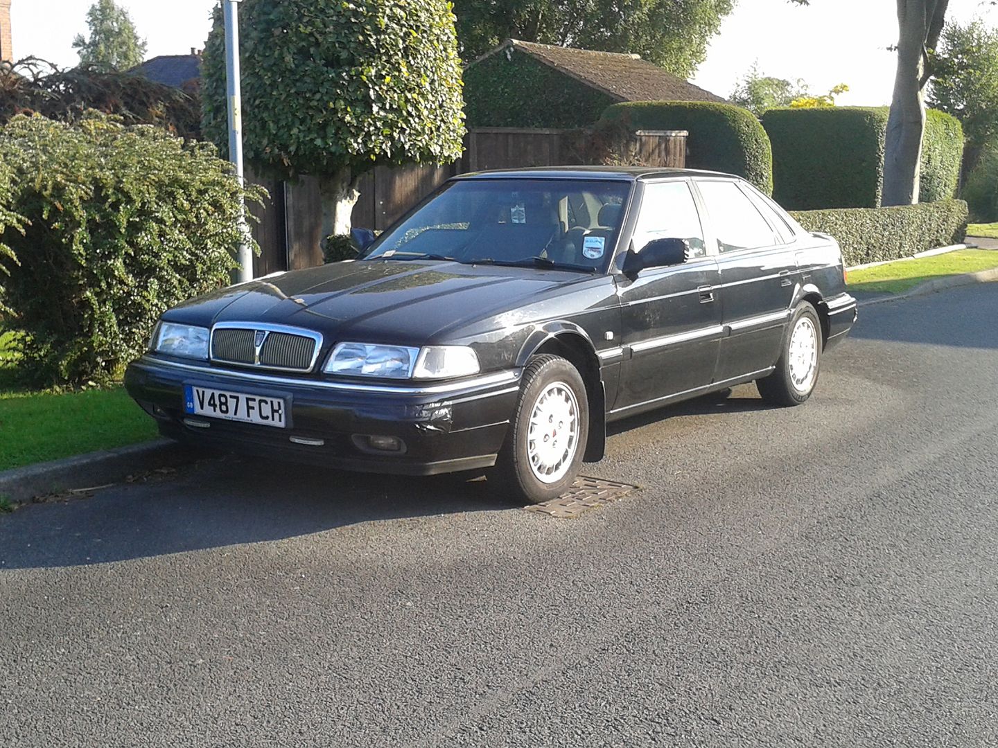

He phoned me after I flyposted his car a few weeks ago. We tried each others cars. It was nice to drive a well-sorted KV6 for once. His Rover sounded nice, sounded great and went well. It was very clean and seemingly looked after.

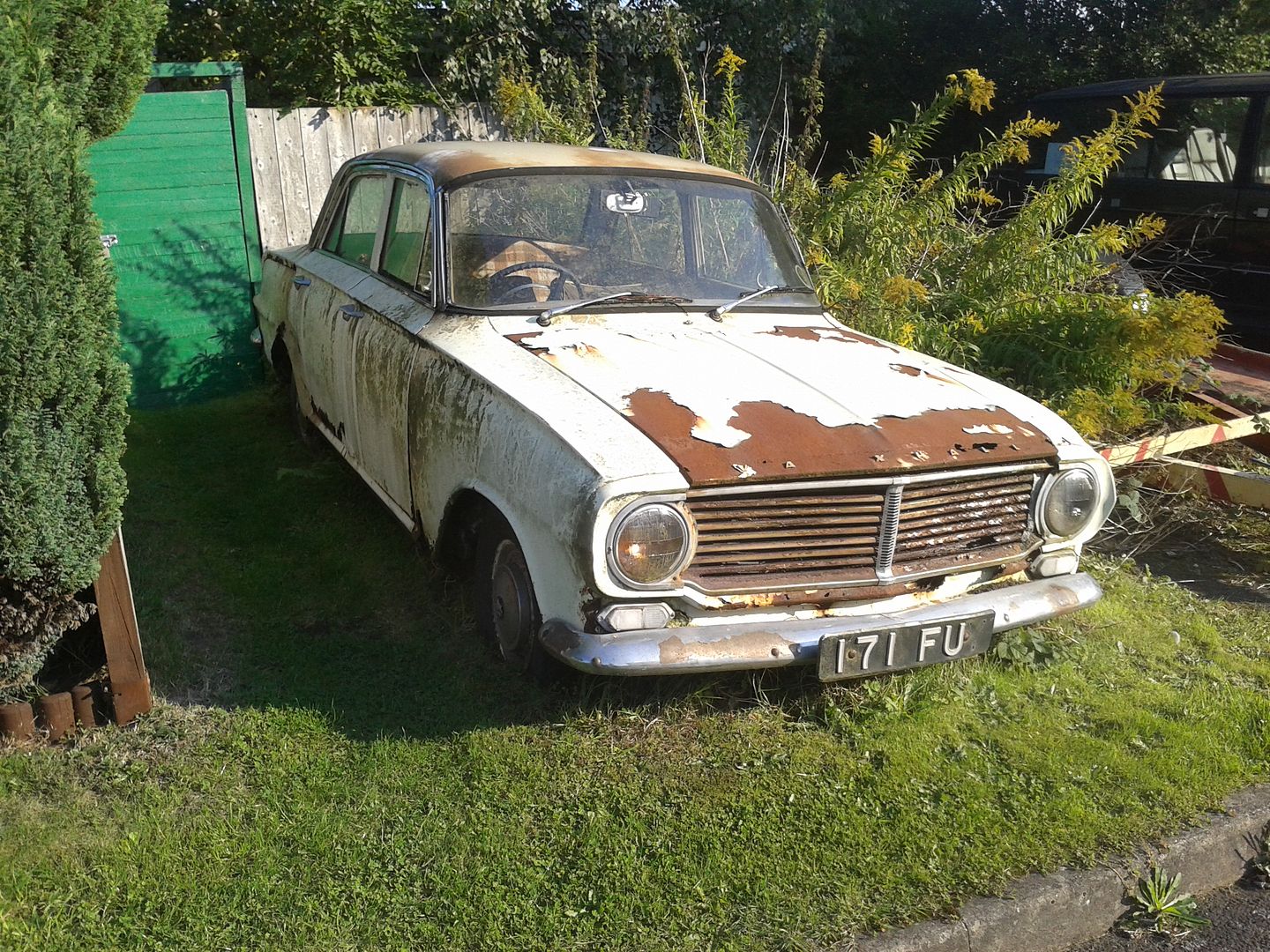

Vauxhall FB Victor, belonged to his father, last taxed and running in 1997.

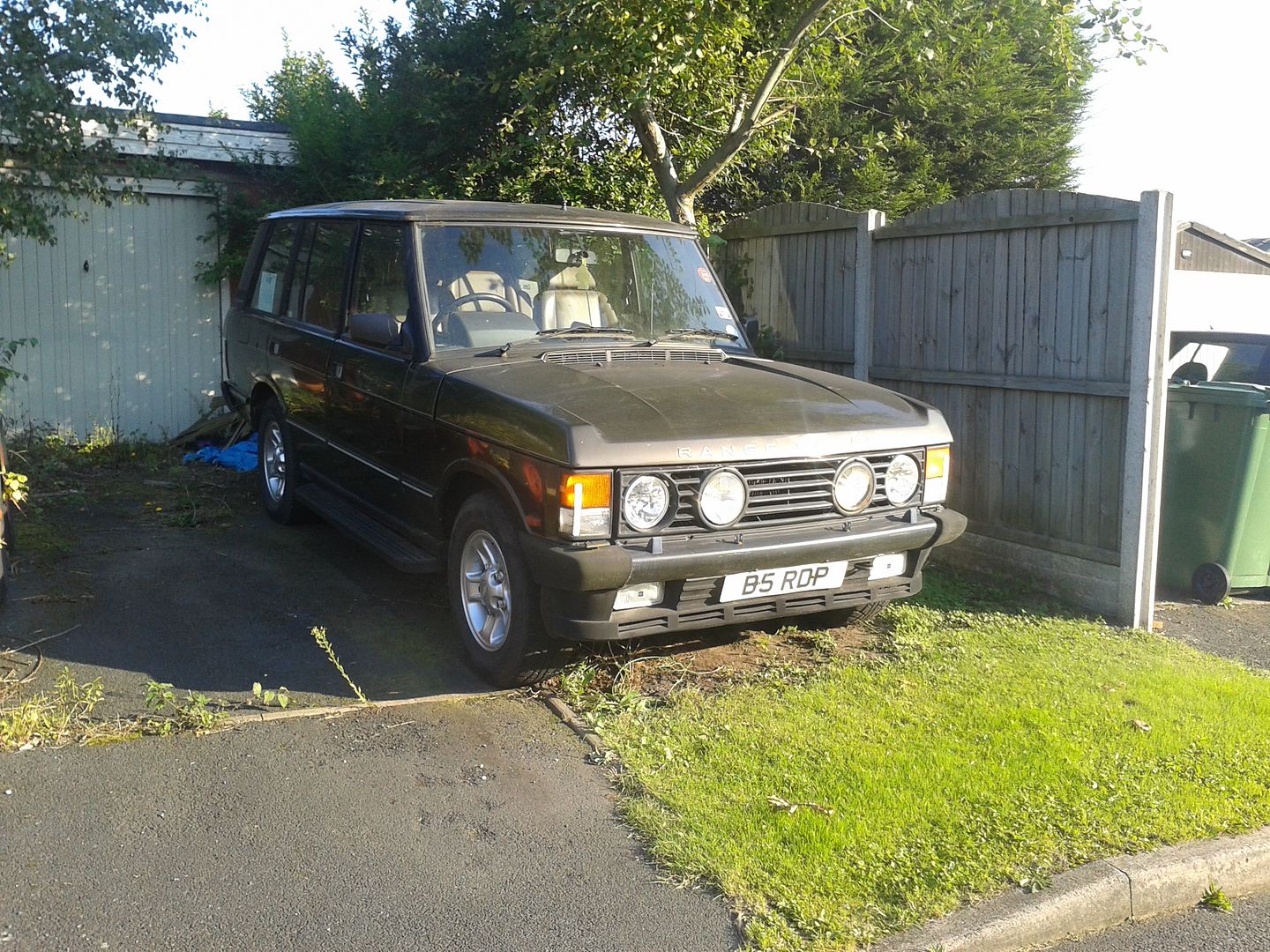

Range Rover, apparently a rare 4.2 LSE Long wheel base. Runs on LPG. Owned by the chaps brother and a running project.
