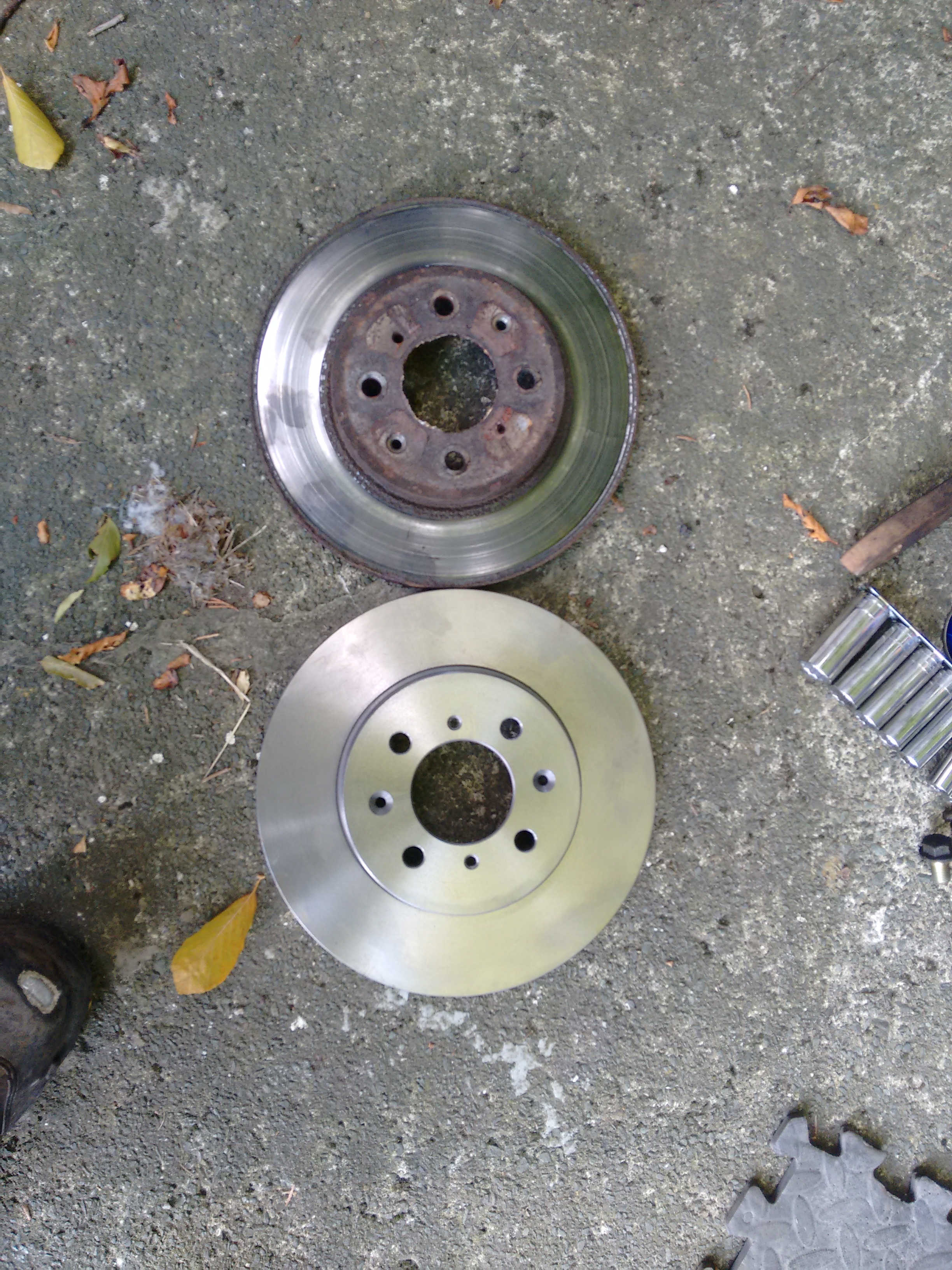

Missus moog has decreed that she likes her civic and wants to keep it long term. So took the opportunity to do a couple of jobs.

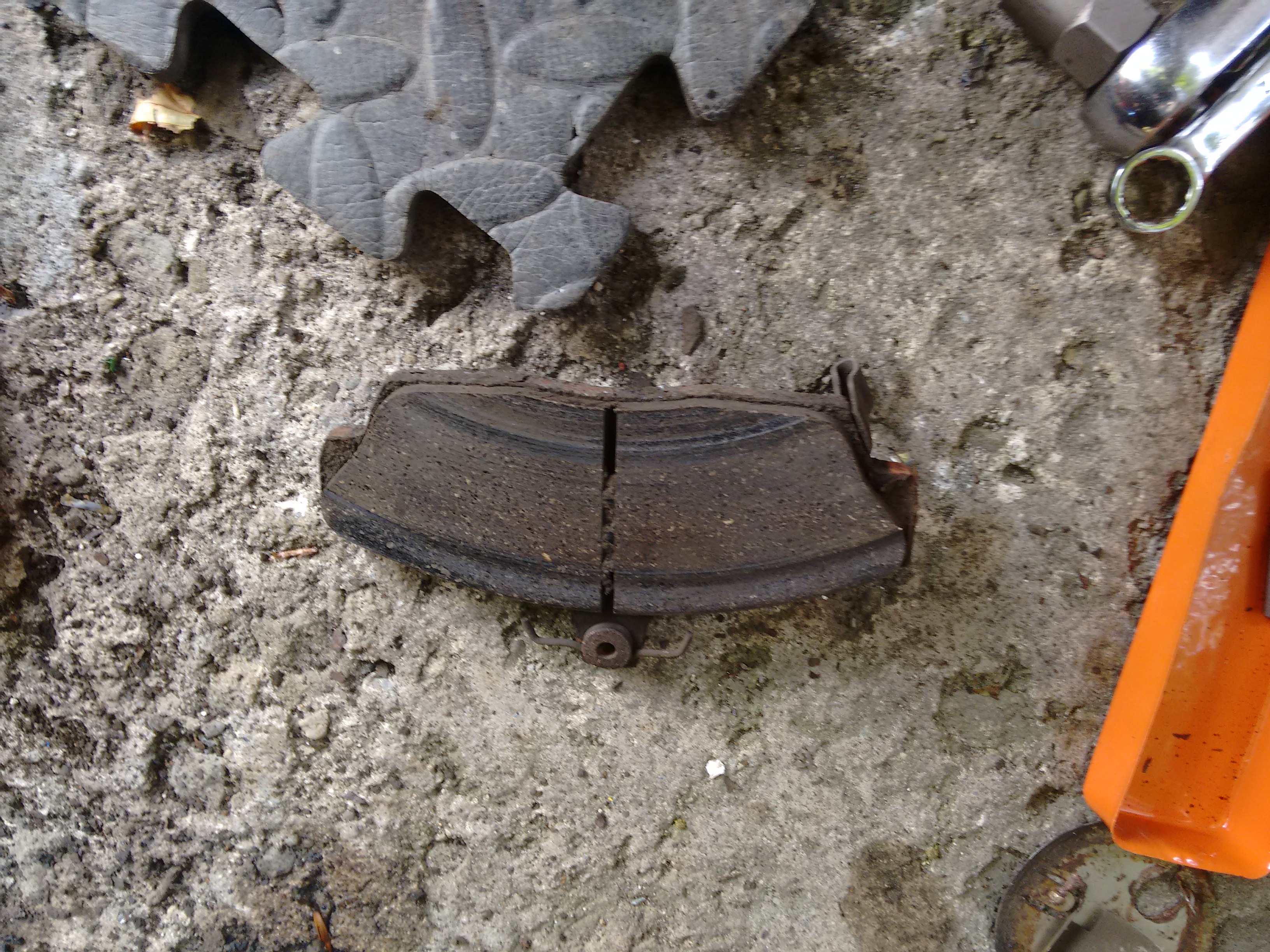

Stripped it down to find wrong pads. Will get them swapped. Looks like they have sent me rear onespost-3994-14426776122_thumb.jpgpost-3994-144267762332_thumb.jpg
I purchased an impact driver to remove the disc screws. I wish I had bought one years ago! I always ended up grinding head if screw off. post-3994-144267744299_thumb.jpg
New versus old disc.

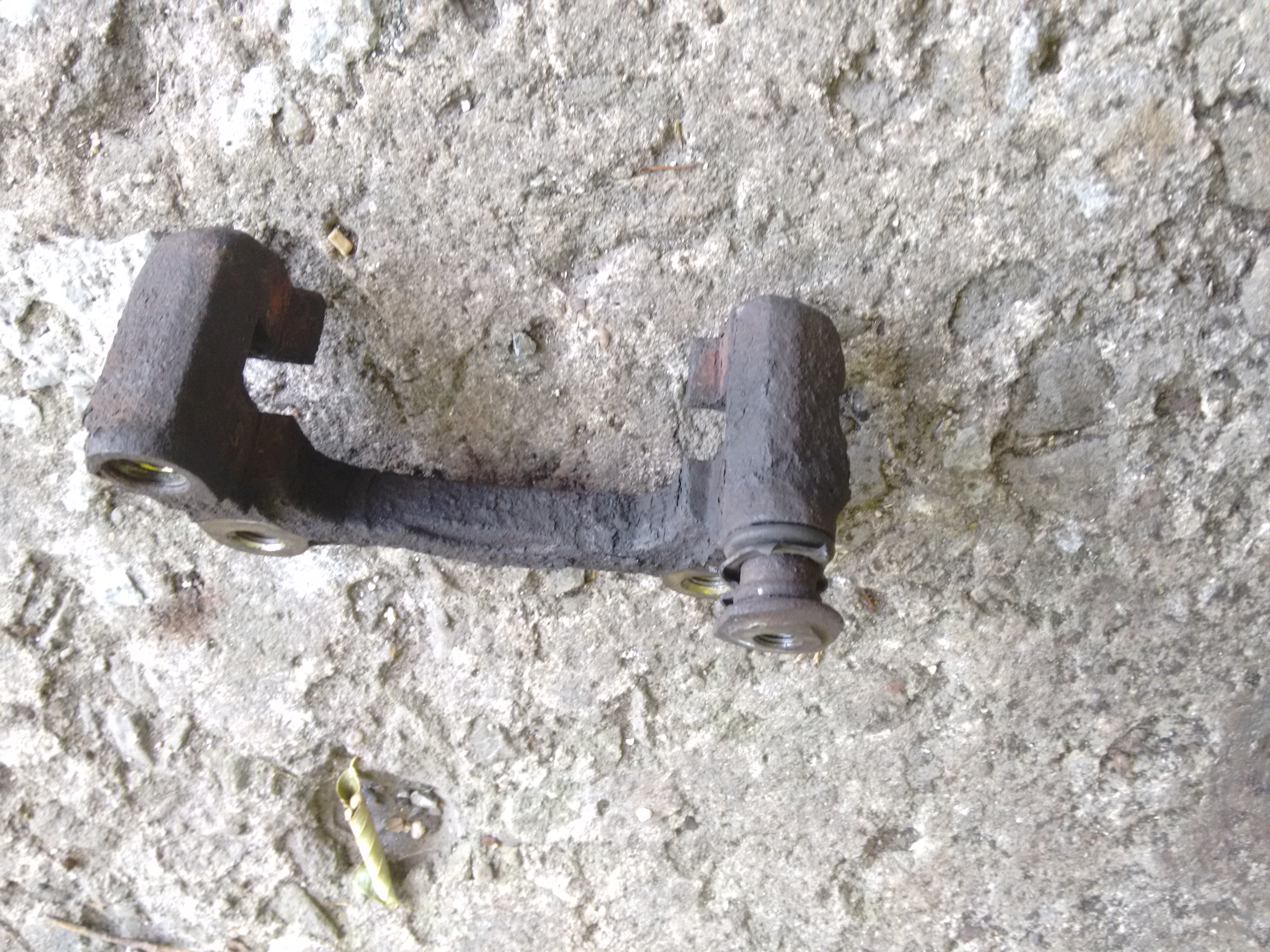

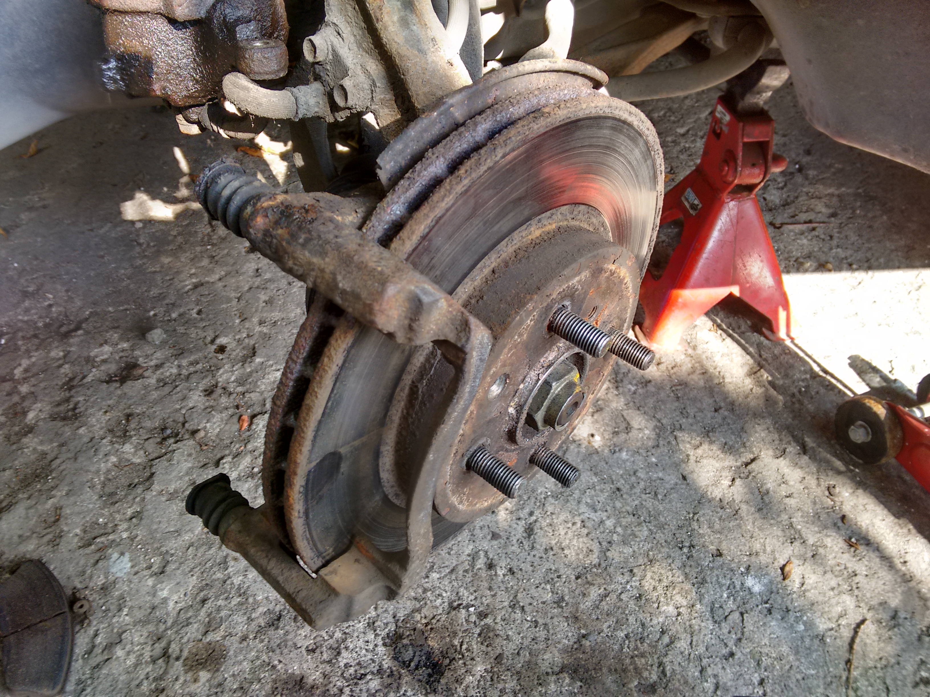

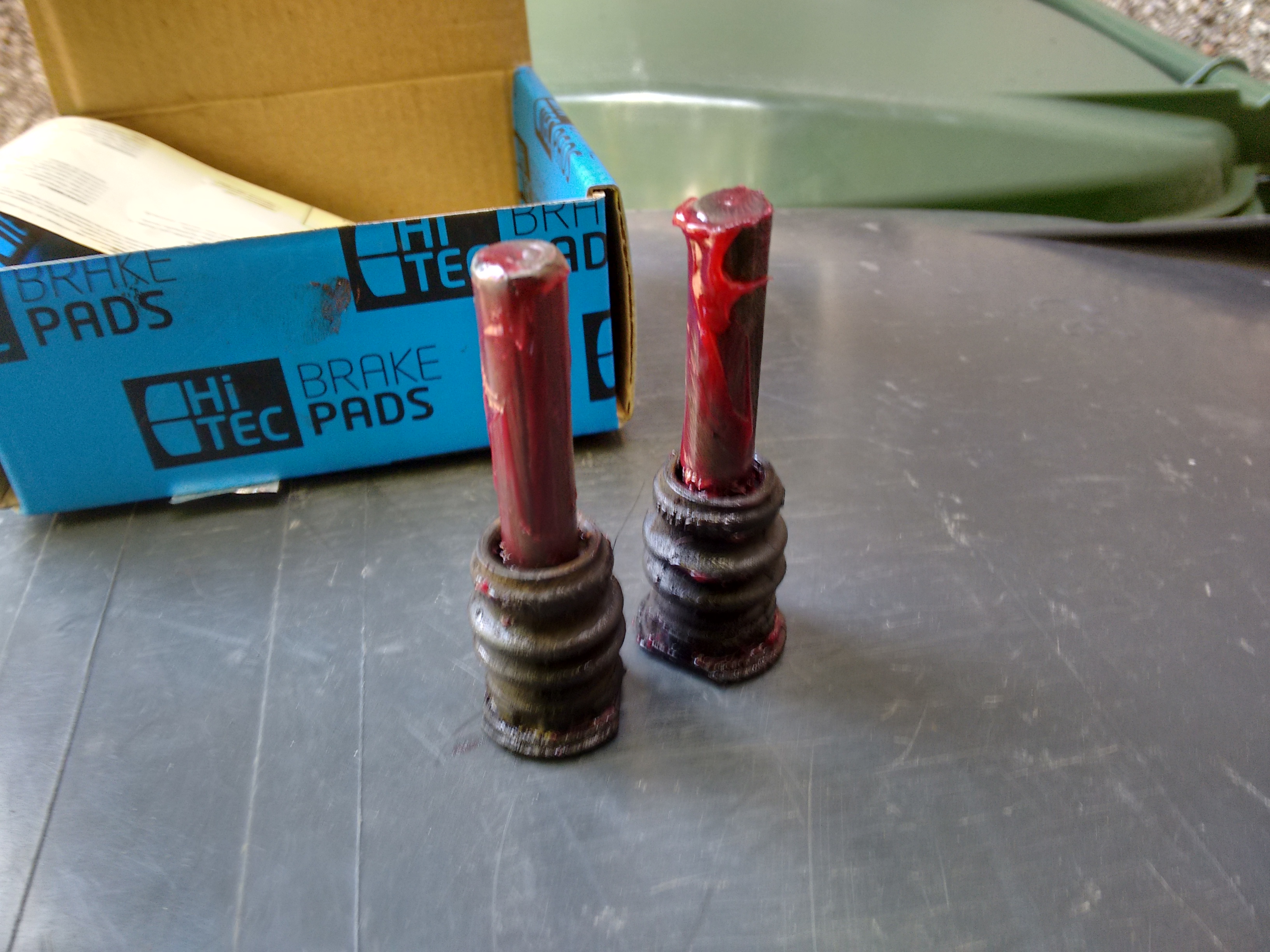

Then moved onto the rear. Osr wheel has been squeaking so was expecting a rear bearing. Instead found the wheel stuck solid. The culprit is the slider pin. Seized solid. post-3994-144267771565_thumb.jpg
So going to have to find new carrier and slider before I can get it back on the road.
That slider will come out no bother if you put it on the gas cooker, and it should still be usable if you give everything a good clean.

Careful with the slider they are hollow so can twist off . Using a screw driver carefully remove the rubber bellows then use heat / easing oil to remove

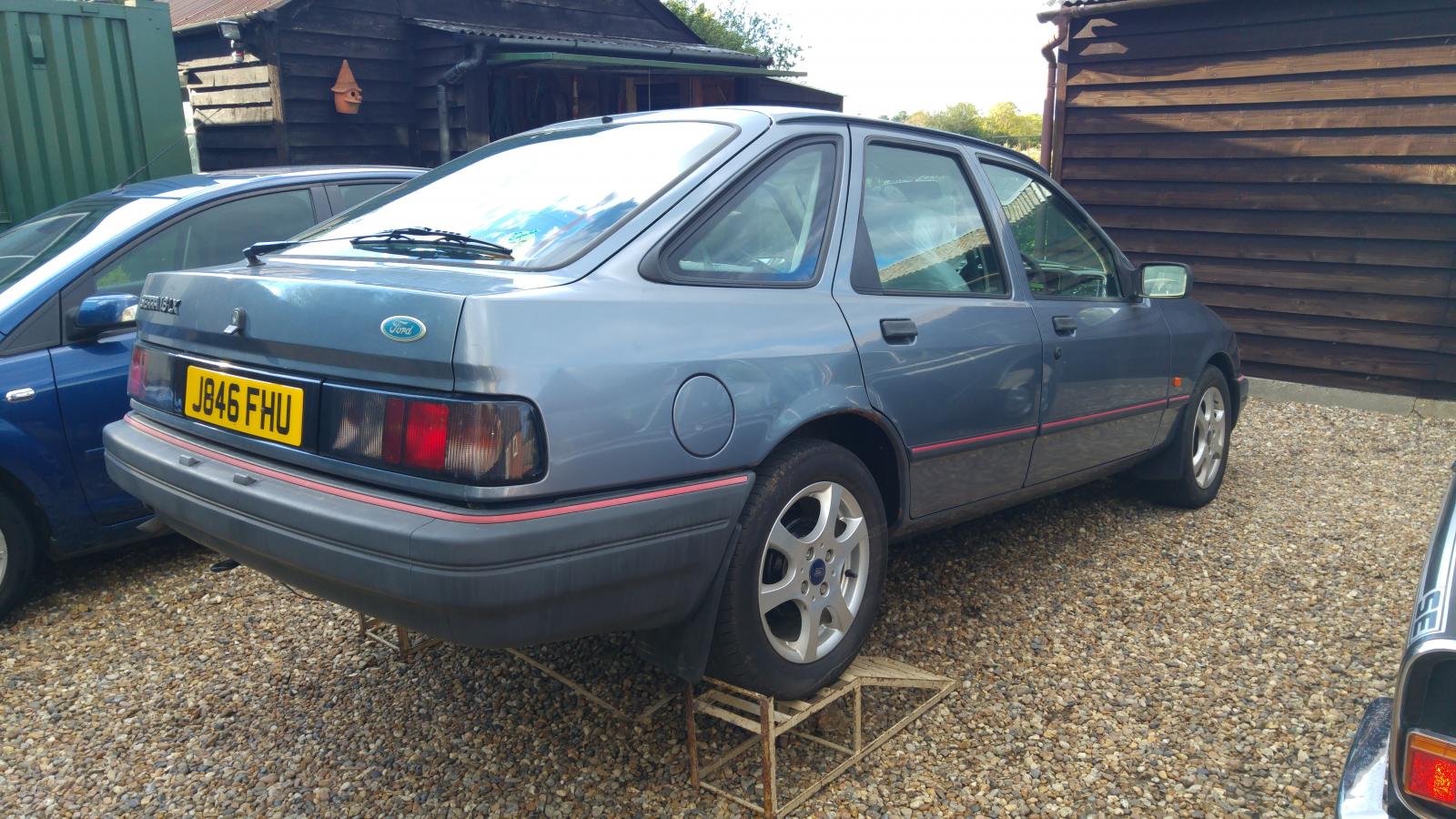

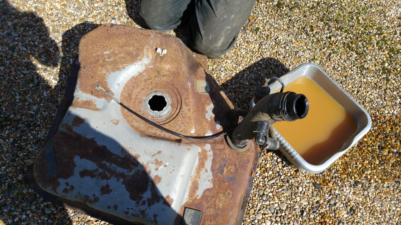

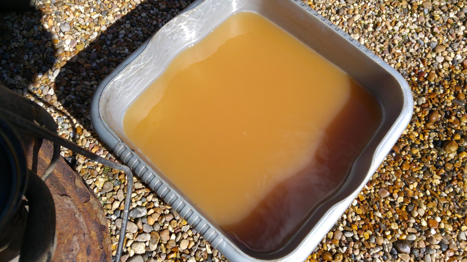

Sierra progress today, as it's been cutting out we decided to drop the fuel tank and to see what it's contents were like, removing it wasn't too bad although all three bolts holding it on snapped off, getting the broken parts out of the chassis was a right ball ache, managed to hacksaw them out in the end with a hacksaw blade with a handle on the end.

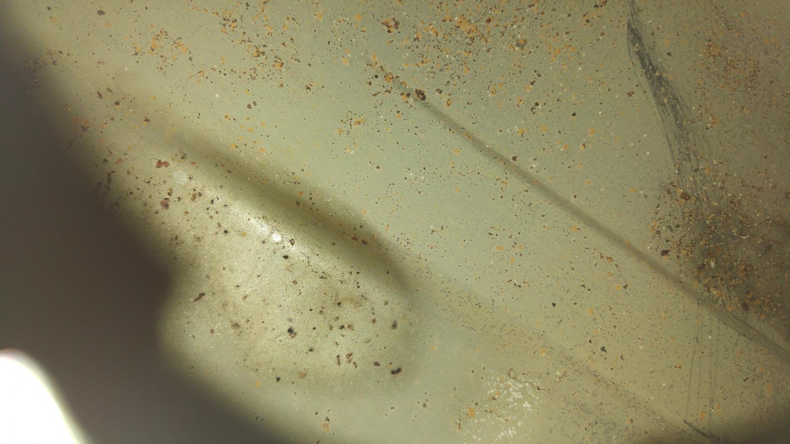

Once the tank was out of the car we poured the remaining fuel into a bowl.
That doesn't look good!

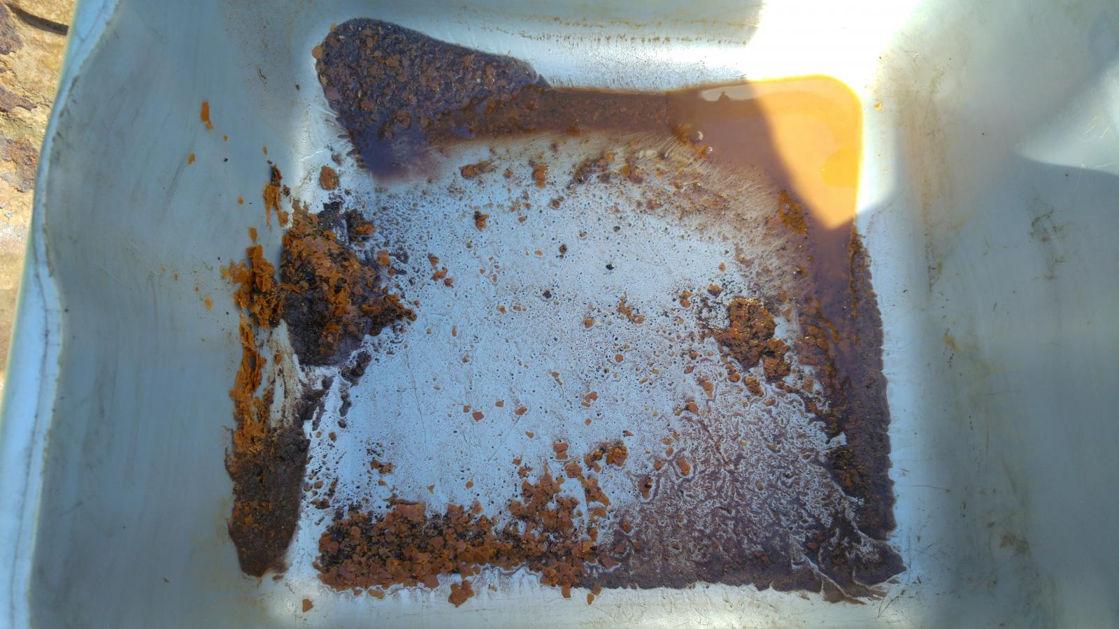

It was this rusty colour, after pouring out the fuel the bowl was left full of rusty particles.
That will be the problem then!, What was happening was when the car was being driven to and from the mot station all the muck was getting stirred up and blocking the little filter on the end of the pick up pipe on the sender, i gave that a good clean, a bit of WD40 on the sender even got the fuel gauge to work again, result!, After a lot pissing about and hoovering the tank out it was looking much better.
We also fixed the leaking pump diaphragm on the carb, bit annoying that as i had to pay £35 for a carb repair kit and only used this tiny diaphragm, what can you do?. Sadly as we broke the bolts we couldn't refit the tank as everywhere would have been closed this afternoon, I'll need to track some down so i can get it fitted.
On the plus side it now has a 12 month MOT certificate for the first time in 9 years! Yay! the only advisories are for the exhaust and fuel pipes so i call that a result!, I've taxed it tonight and I fitted a Autoshite sticker to celebrate!.

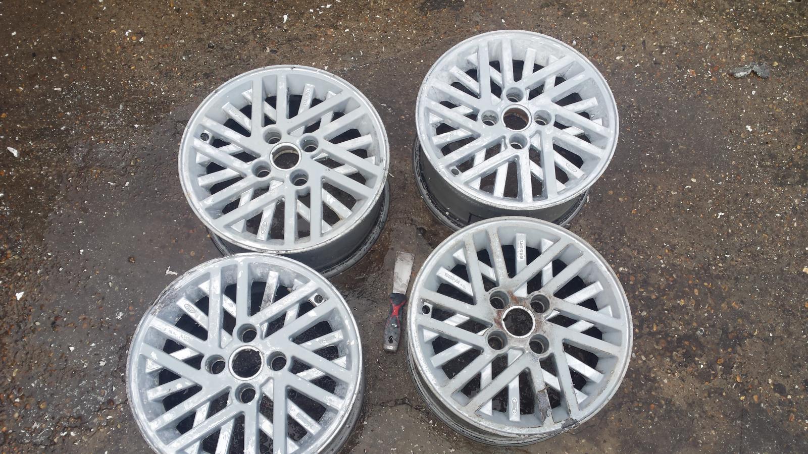

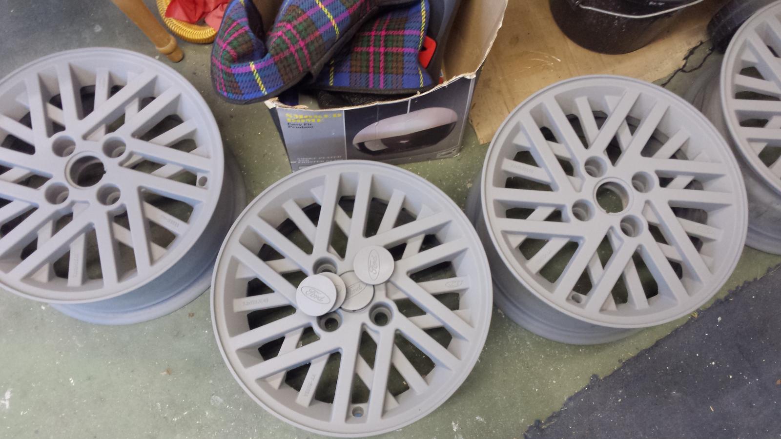

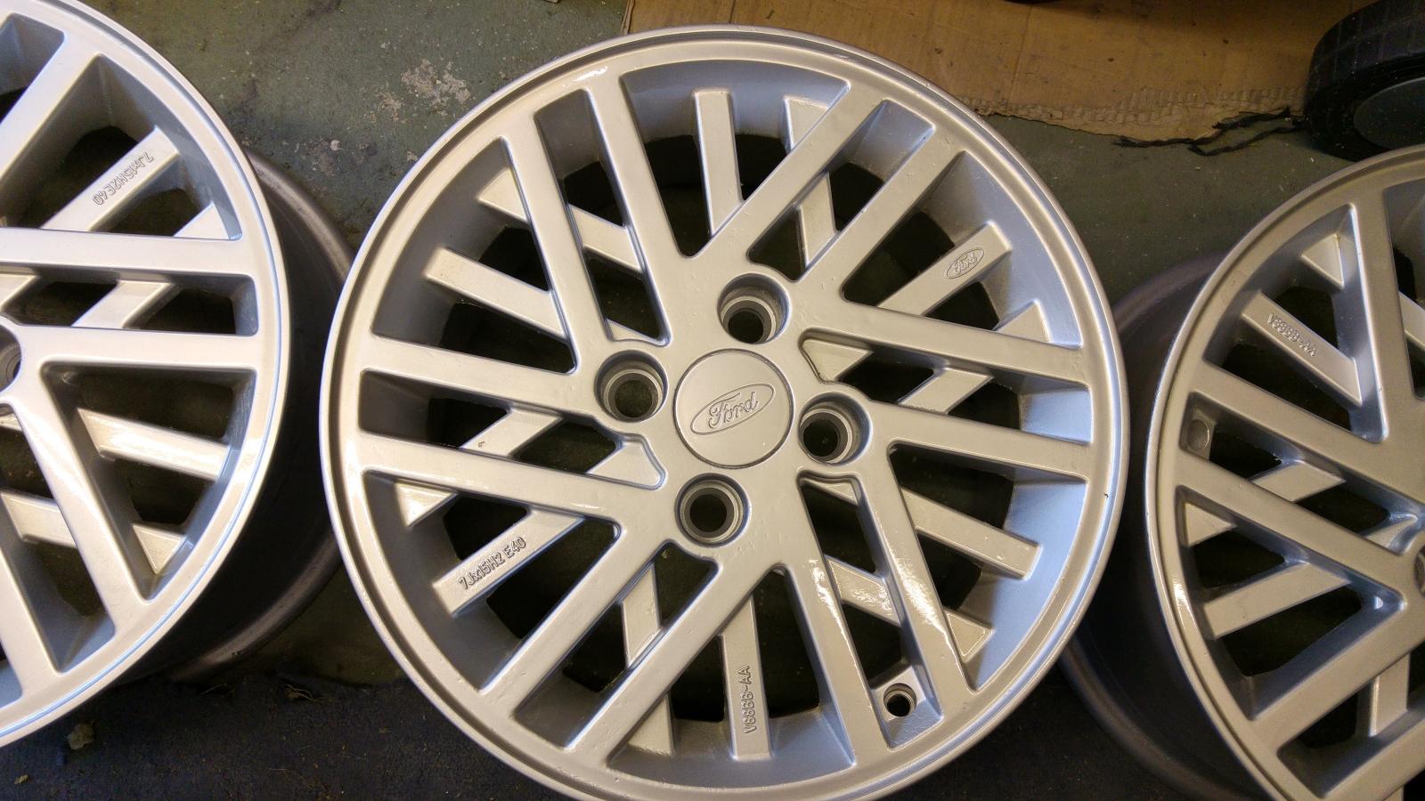

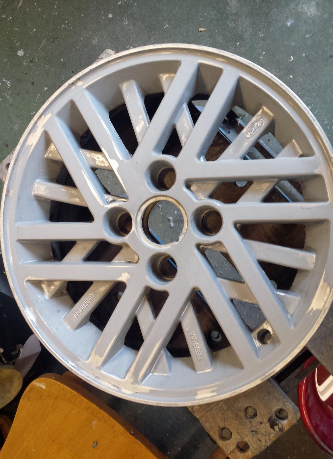

I've probably posted this before but I bought these of a mate for £25 for the Sierra, I spent a few weeks rubbing them back down and painting them, I got a banging headache painting them as like a twat i forget to ventilate the garage!
Another lad i know has offered to swap the tyres over and balance them for free in exchange for the old Focus alloys as he needs a set of 15" for banger racing so that's a result too!
To get a spanner in you have to deform the rectangular hole slightly on the edge a small amount on the opposite edge to the bolt hole so you can get the open end of a spanner in, then do the bolt up from underneath, i use 13mm head nuts and bolts it makes life easier
You can just make out what I mean on this picture
I used to dream of a set of these on my MK2 fiesta when I was 17, cos there was a bloke on the internet with a website with a MK2 XR2 that had them on and they looked ace. (He had a massive crash in it which ripped the car in half, quite interesting to read but it's long gone off the net in the last 13 years since I last looked)
I got some of the 14" knockoff XR3 ones with massive tyres on for £45 and they wouldn't even go round so I gave up and ran sierra steels from the scrapyard.
Anyway, looks like you've done a nice job of them - Painting wheels is pretty satisfying but not ones with loads of spokes and awkward corners that you can't properly sand into like these!
