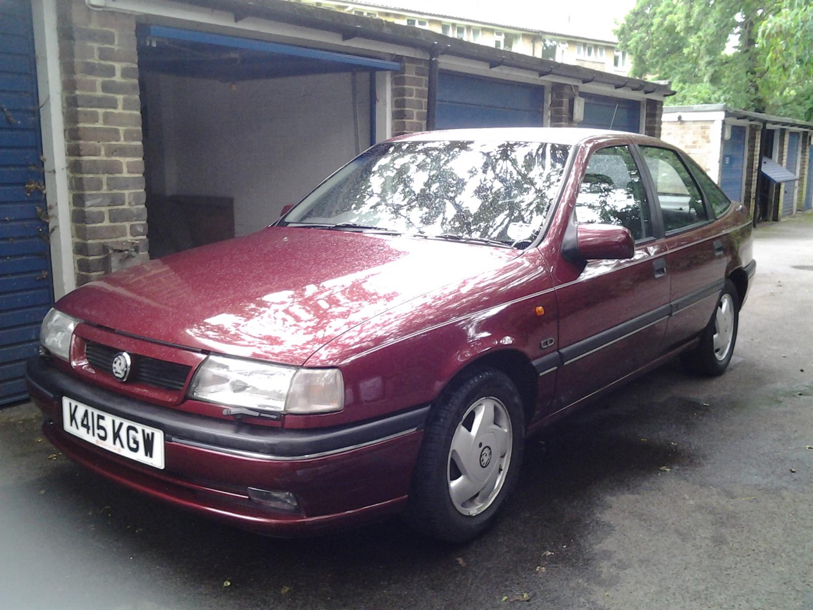

Amongst all this manly talk of felling trees and doing a complex conversion to LHD, all I've done is clean the Cavalier today in readiness for taking it on hols. Checked the levels, tyres, and like a twat also poked around at the sills as couldn't help myself. The arches and sill ends really are a mess so I need to sort out some weldage soon as it 'aint nice to look at.
In reference to the forever car thread, if I wasn't such a fickle sod I'd just keep this and be done with it.
