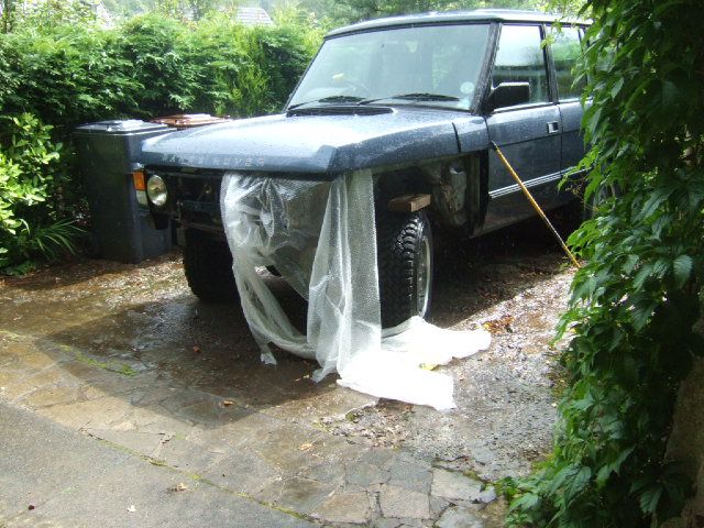

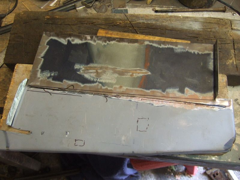

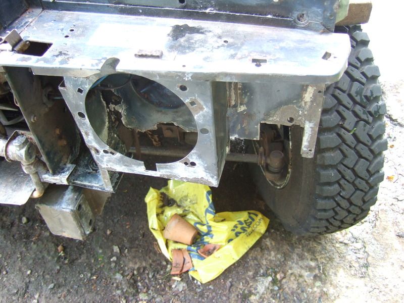

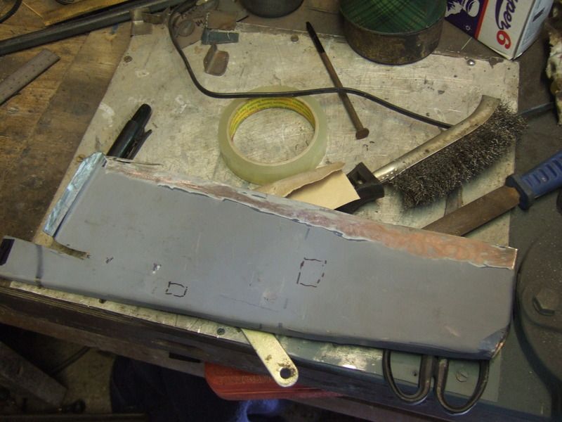

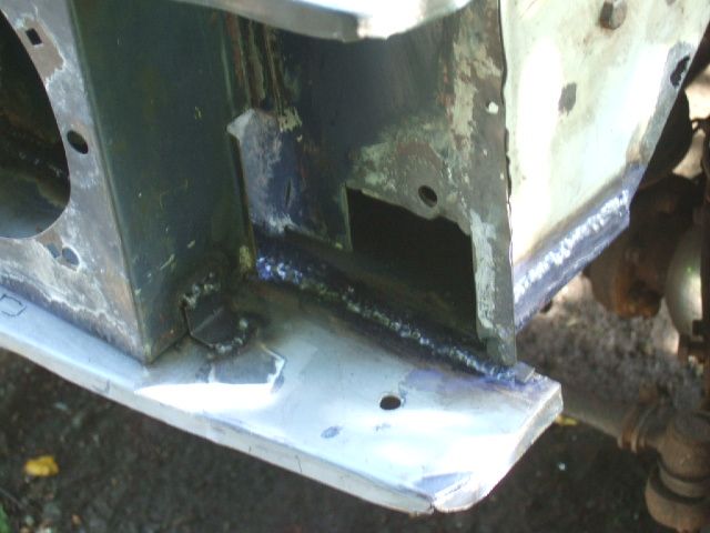

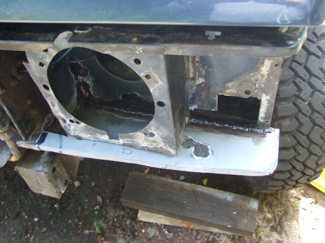

First day  of sunshine for a few weeks so set about the welding.
First cut all the shite away and then the rubbed paint off and acid treatment.
New light base made up. it was a bit fiddly, but I couldn't justify the £40 quid to buy and have delivered.
Next up was to measure and fit the rear plate - it's made from old bonnet. Measure and measure again. And then again and again!
These two bits were welder together on the bench to make things easier, like less upside down welding in a wheel arch.
Test fit. Not bad me old son.
Rained like a bastard for 1/3 hour and then Mr Sunshine comes out again.
All welded in, with just some wee scraps to do tomorrow.
That's the very last of the major rusty bits in the RR. All the other stuff is just wee bits n bobs to do now and again.
