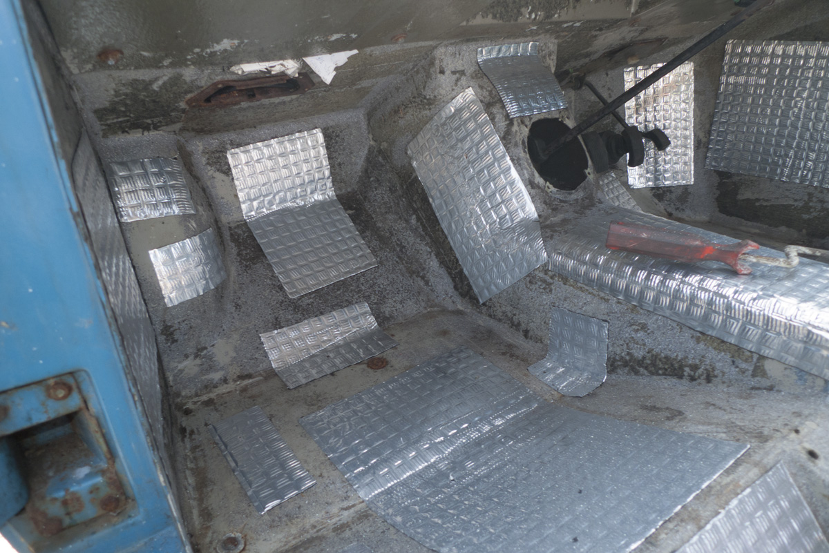

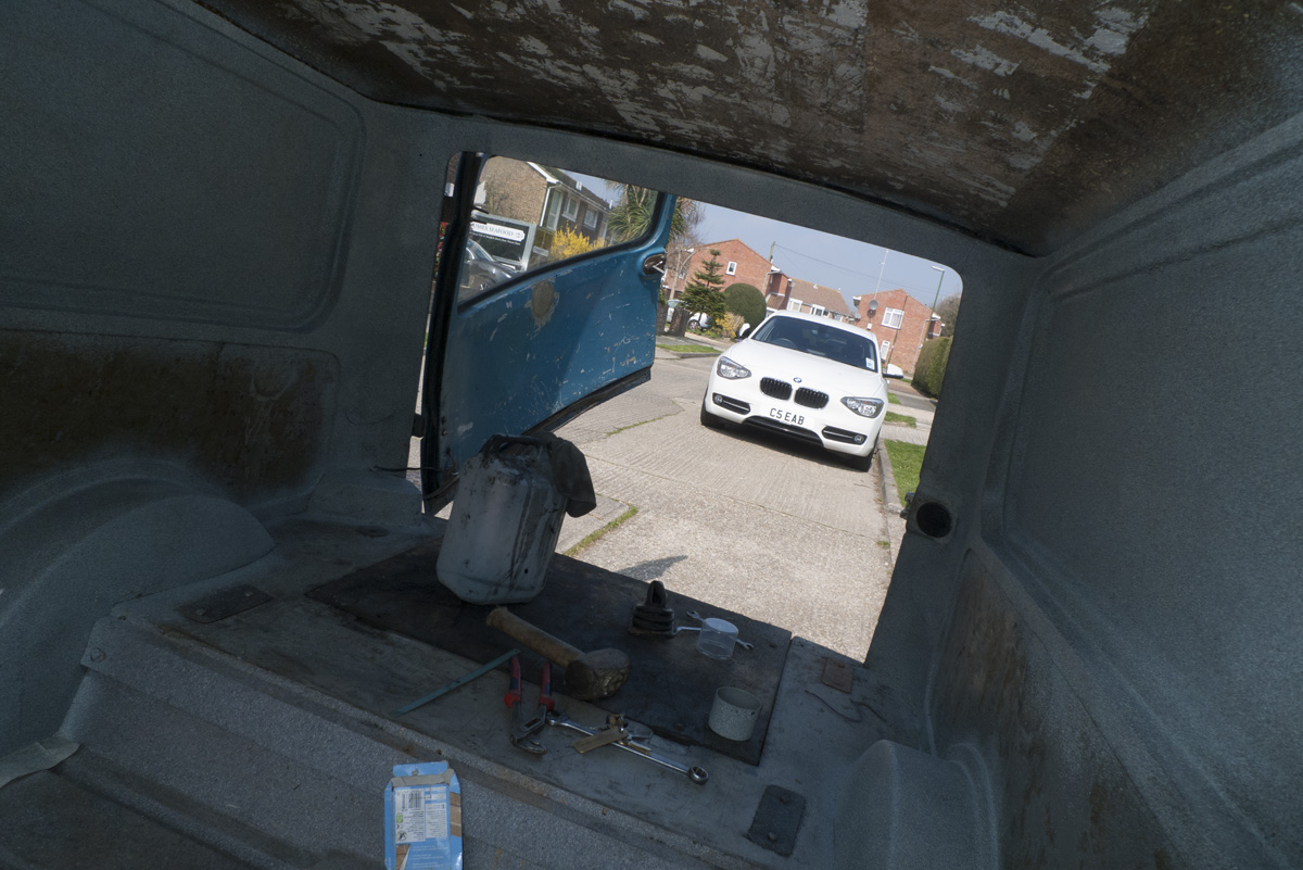

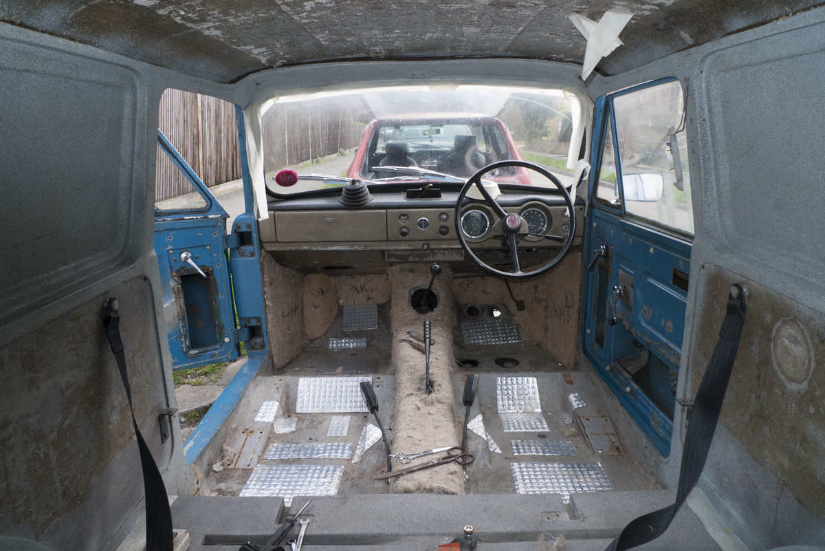

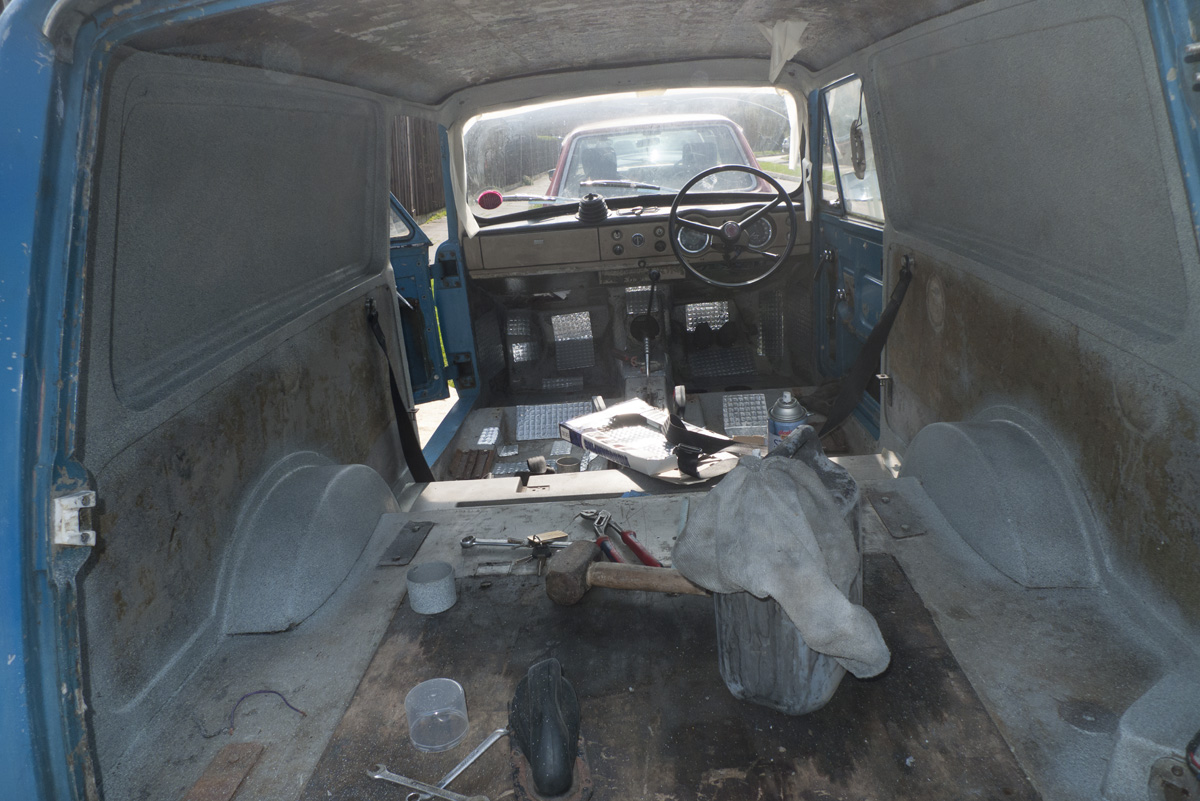

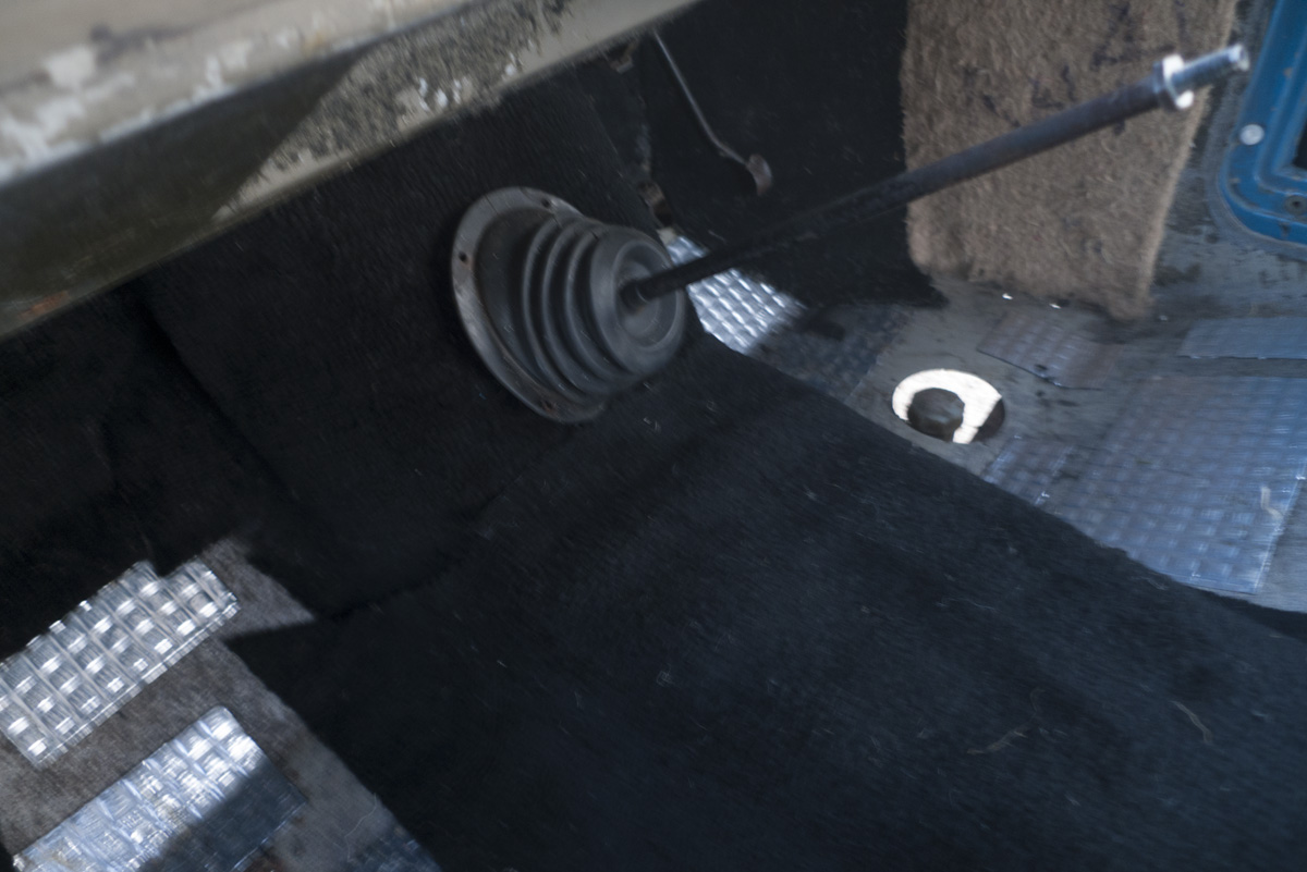

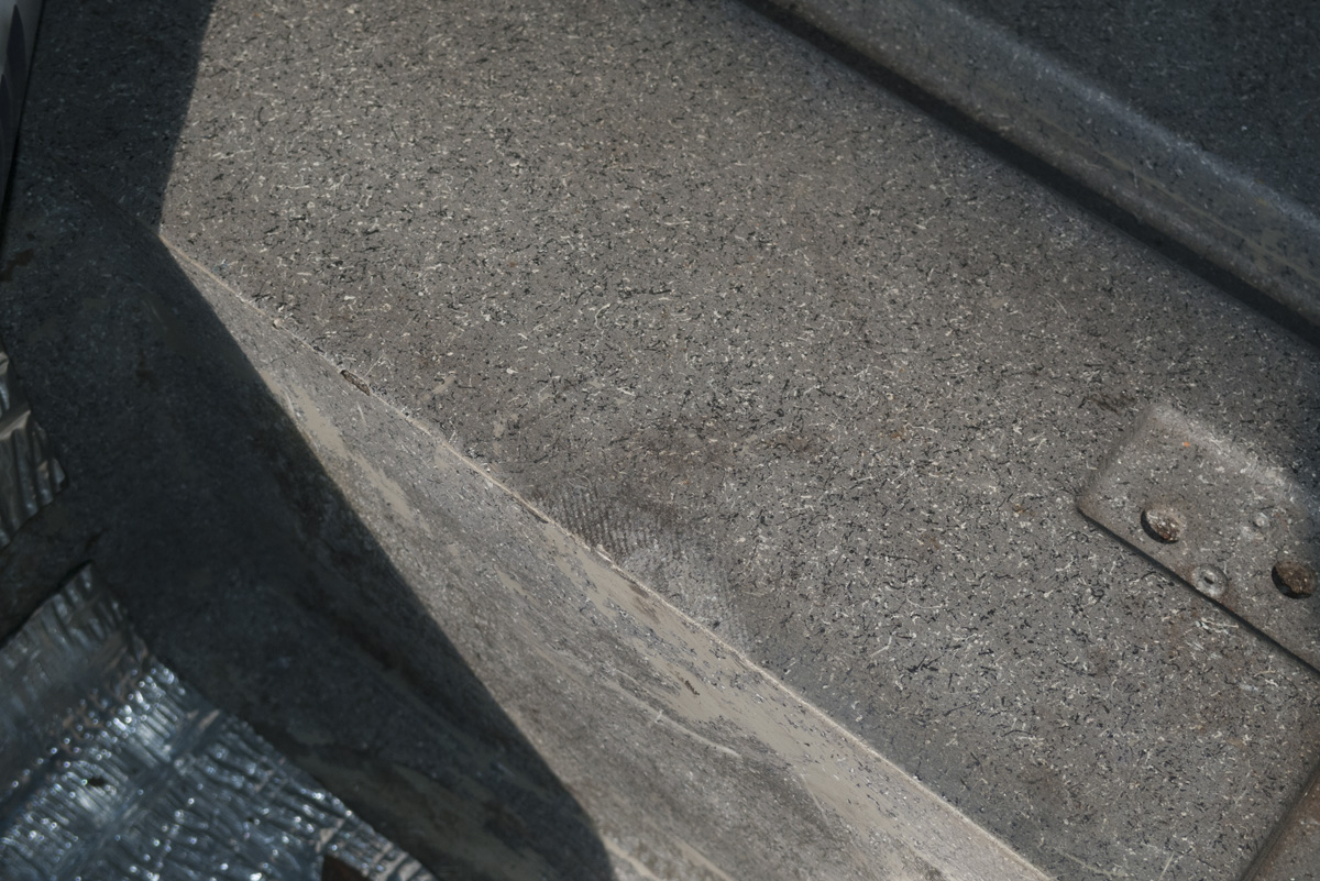

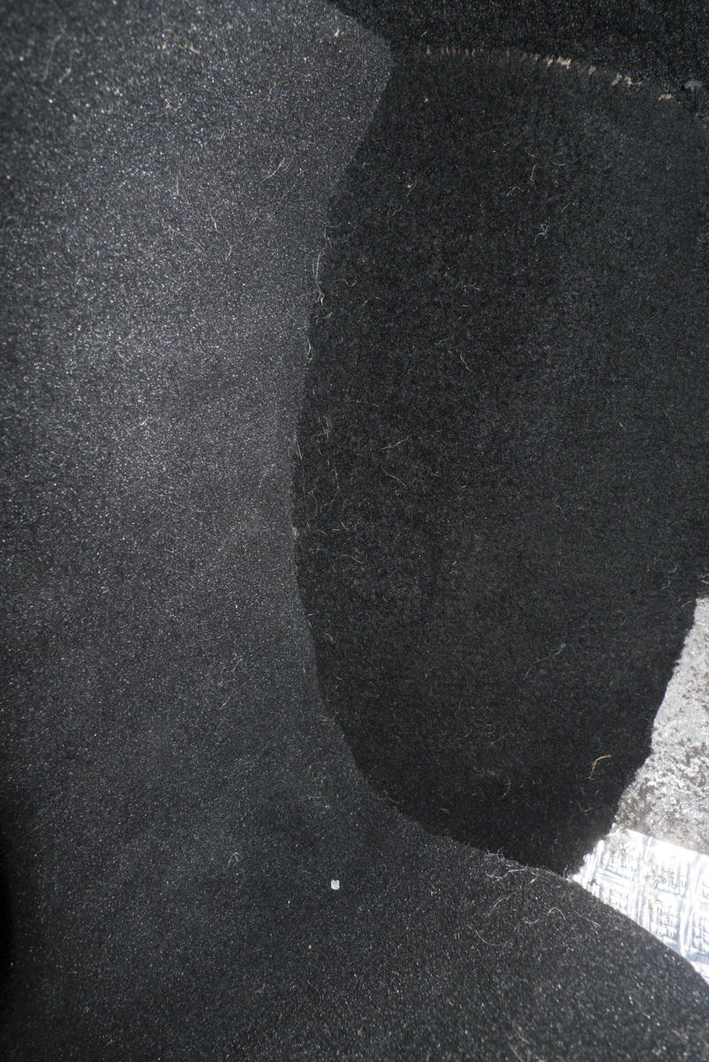

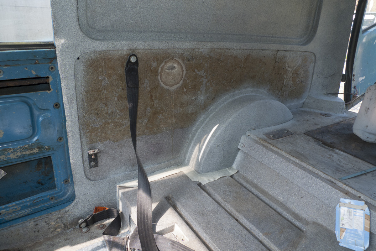

Spent another day working on the rebel van interior and this time I've got a few photos,

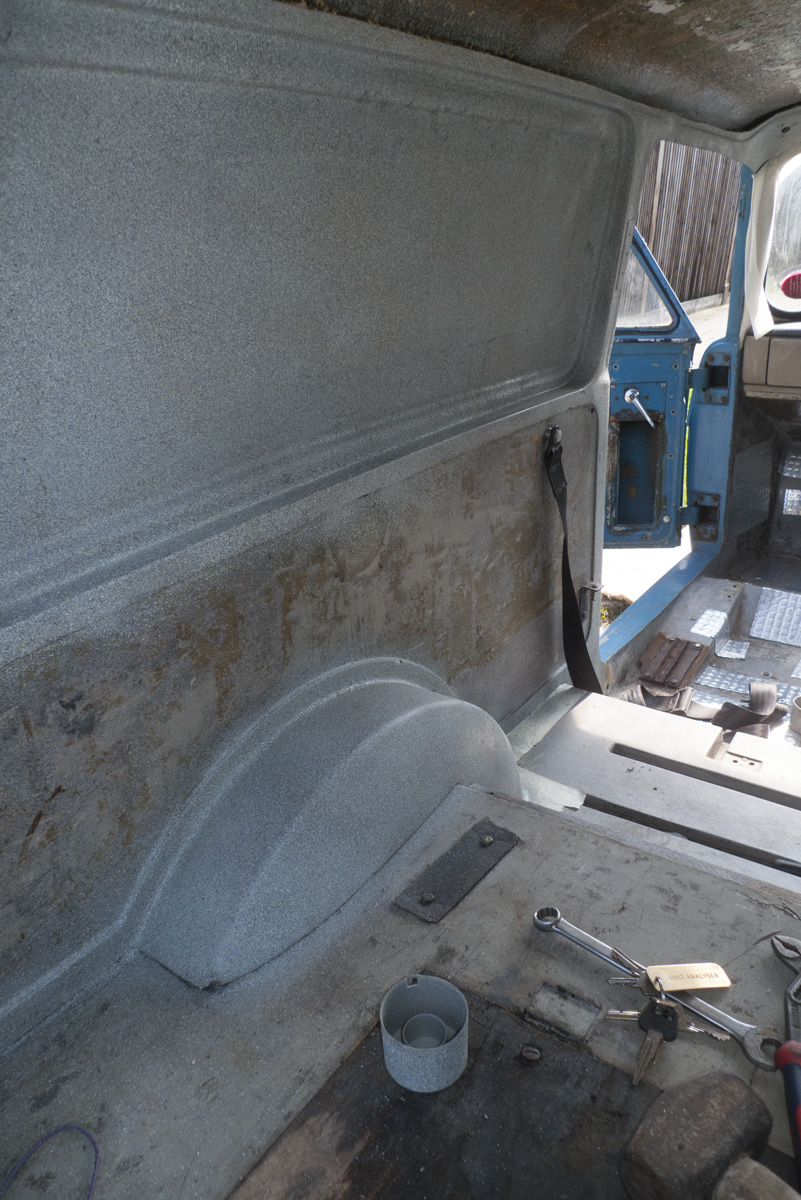

I started off by touching up the remaining bits that needed a second coat of speckled paint, overspray areas get hidden behind either the headlining, side pannels or rubber matting to go on boot floor.
Anti vibration pads,
I then started to cut and fit the insulation,

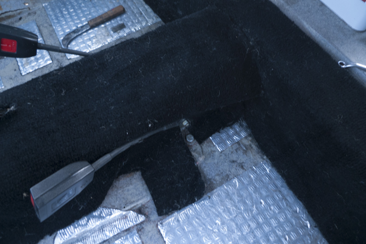

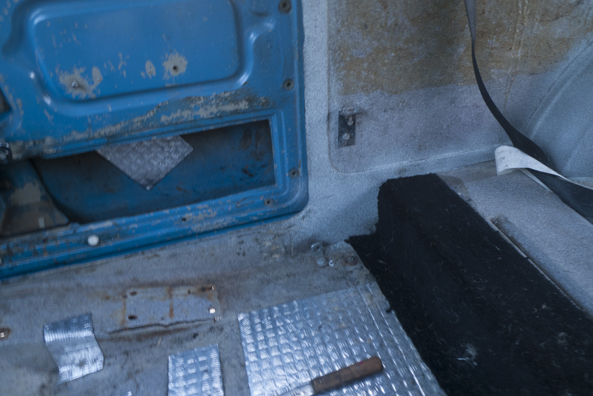

I then moved onto the carpet, This is a really time consuming job as each piece has to be cut to suit before gluing in. The bulkhead section has all been glued in, the gearbox tunnel is only dry fitted as it needs some edge trim sewing on before it can be stuck down. All the pedals had to be removed the old air vent covers drilled off etc. Sorry about the state of these pics the light was fading as I took them.
Unfortunately I've now run out of tufted carpet.... I've got some more but its a different style much shorter and less traditional. I still need to do two more big panels in the footwells and a small section around the doors, as well as leave enough to create to overcarpets. I'm in two minds as to wether to order some more matching carpet or just say sot it an fit the stuff I've got....
Heres a comparison photo:
Tomorrow I'm expecting the rubber matting for the boot to arrive and I might try to get the headlining fitted!
