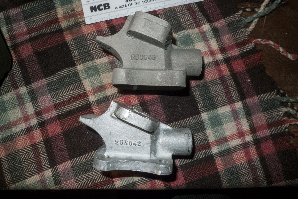

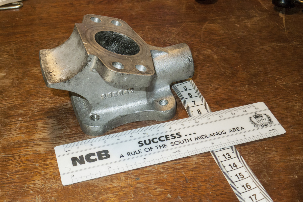

After a few months of messing about with non standard zenith carbs I eventually decided the only way to get the straight 6 running the way I wanted was to replace the Triple SU setup. Unfortunately this system is quite sought after by zodiac / zephyr 6 owners who regard it as the best period modification available short of fitting a Mays Head and triple sidedraft webers. Used examples frequently fetched north of £1000 which was well beyond my budget.

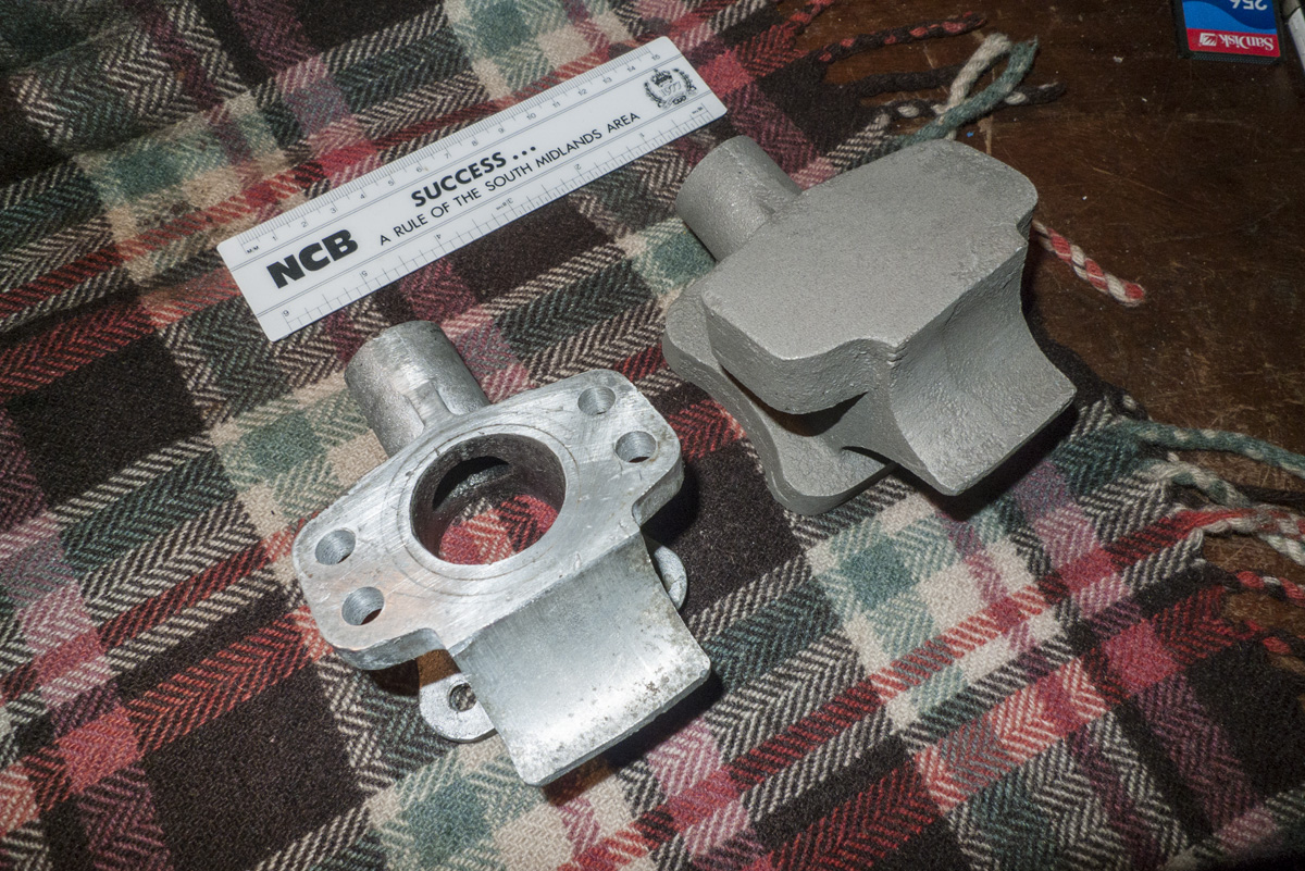

So a plan was hatched to make the replacement parts needed... Starting with the inlet manifolds... I was fortunate enough to find someone in the owners club willing to lend me an original and I set about finding a local foundry who could remake it...
I must have emailed about 20 companies trying to find somewhere who could create a copy without needing to sell my internal organs... I eventually came across a jobbing foundry in east sussex willing to take on a small job.

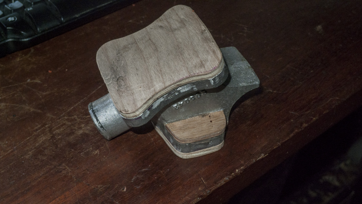

The original was prepped to be used as a mould, with plywood caps over the surfaces that would need to be machined:

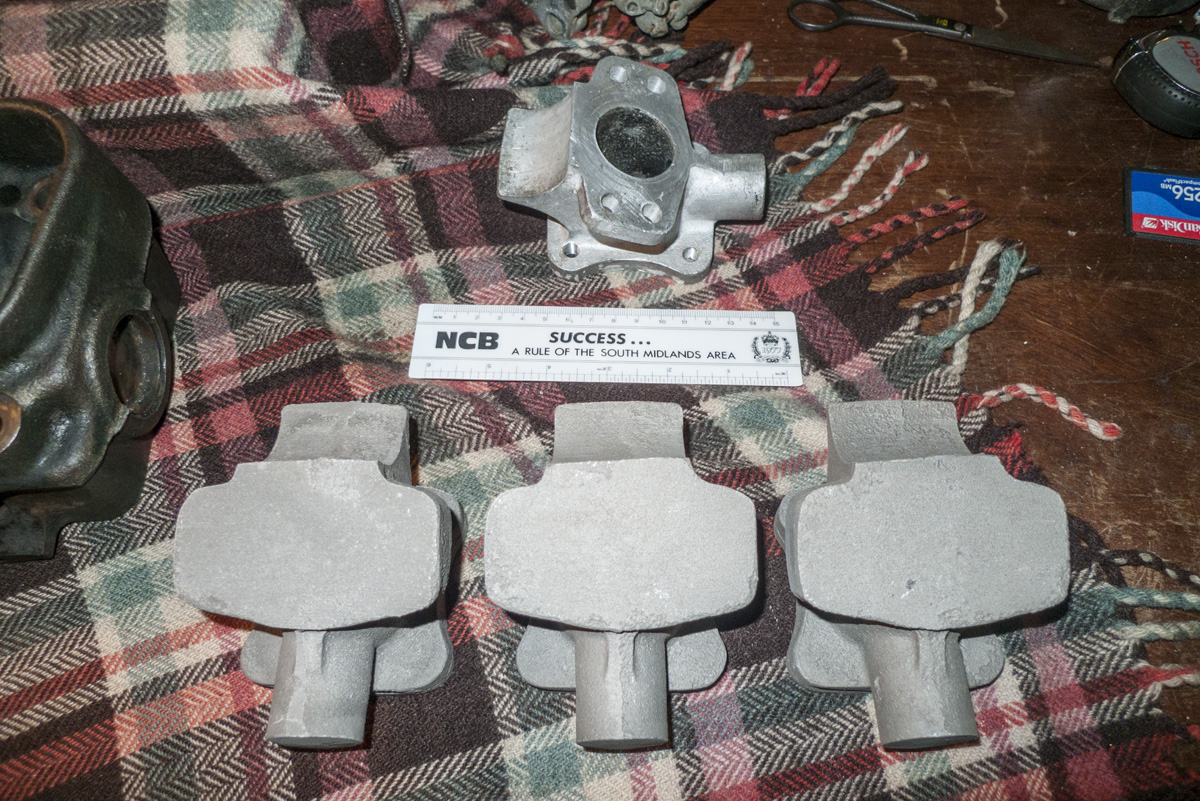

heres the result:
The difference in colour is because the new items have been heat treated, this should make them easier to machine.

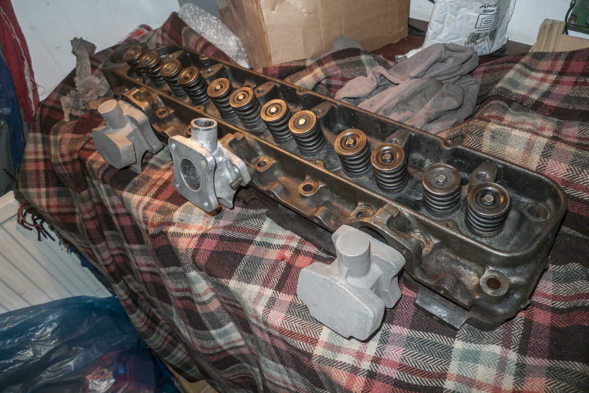

3 New Castings,

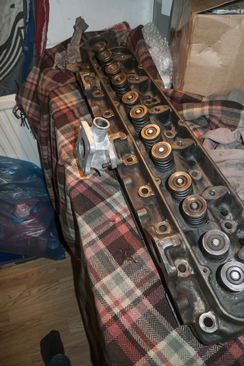

I've also bought a spare cylinder Head on ebay, Parts for the ford Straight 6 can be difficult and expensive to get hold of... They are popular for period racing and those into racing 50's & 60's cars have much deeper pockets than I do. So I was really pleased to pick this MK3 Head up for £10
It needs a skim, but otherwise seems to be in pretty good order,

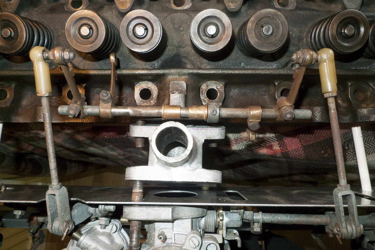

Trial fitting:
Next stage will be to get the new inlet manifolds machined....

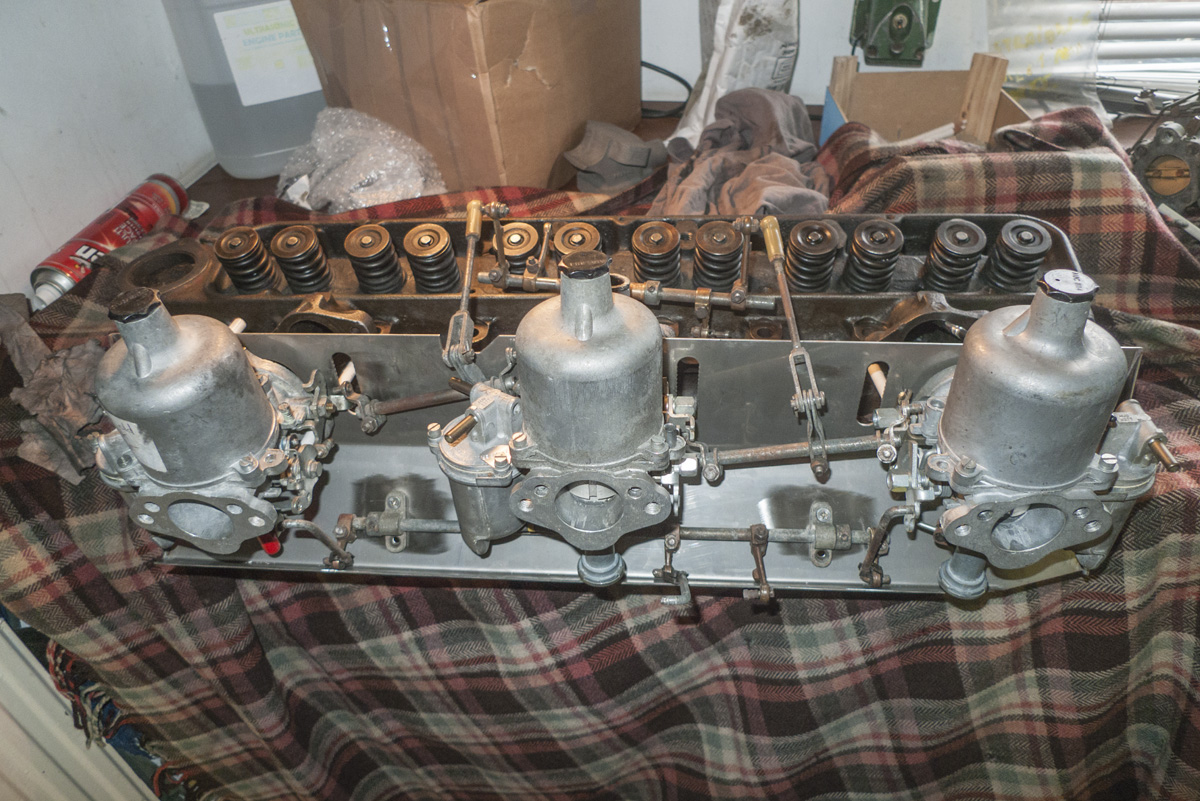

Straight 6 Coupé news:

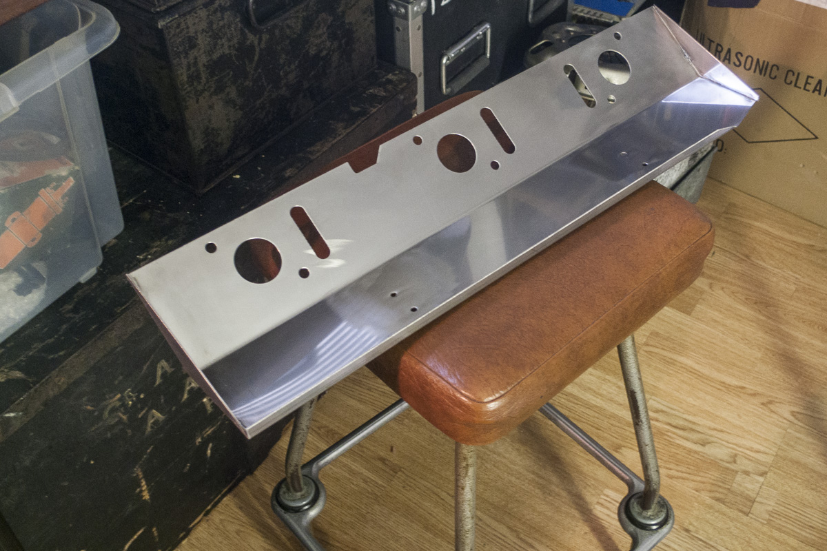

At some point yesterday the local fabricator had been round and left a stainless drip tray on the front step! I've had this made specially for the straight 6, I've got a perfectly good steel one but decided to get one done in 304 stainless for the hell of it. It is after all the year of shiney... The plan will be to get it professionaly polished locally, I've been told of an affordable polisher over Shoreham way so will give him a go to see if we can get rid of the few machining marks.

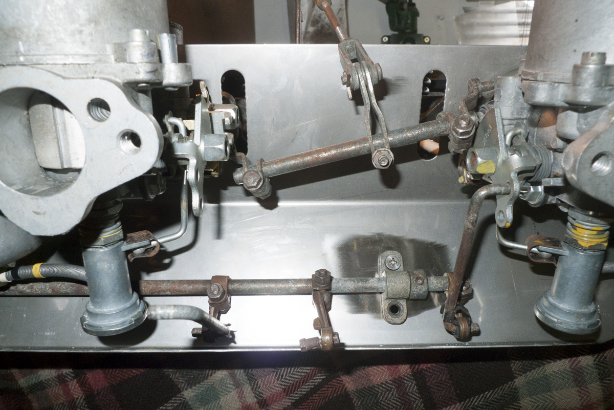

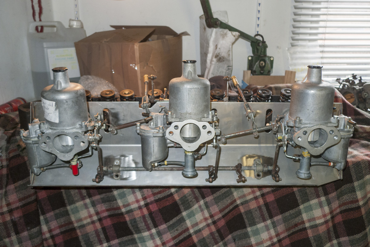

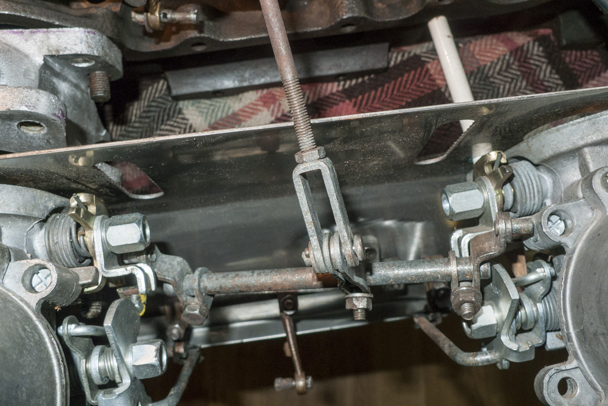

Having the drip tray finished allowed me to mockup the carbs on the bench and try and get my head around how all the linkages should work. I've never seen this setup installed on a car and have only had a handful of photos found online to use as a starting point. I'm going to need to order a variety of spacers and gaskets for the head to manifold joints and manifold to carb. The central spacer between the carb and manifold appears to need a bracket to allow the choke linkage to pivot correctly. something I'd not previously thought about.
The Hs4 Carbs are all new old stock, They will need needles and springs changing before they can be used as currently they are setup for something else.
I'll also need to sort out a balance pipe but that can wait until after the manifolds are machined.
Sorry Its not very autoshite. I suppose the shite solution would have been to create a new carb setup using mismatched triple zeniths tied together with mig wire, old spoons and some steel found in a skip... I r fail!

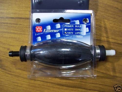

T0 everyone that is having problems with fuel pickup.
In the past i have fitted one of these,just a few pumps and you are off.
http://www.ebay.co.uk/itm/New-Outboard-Engine-Petrol-Primer-Bulb-Fuel-Boat-Large-in-Line-Hand-Pump-Primer-/150378805522?pt=LH_DefaultDomain_3&hash=item2303467912
