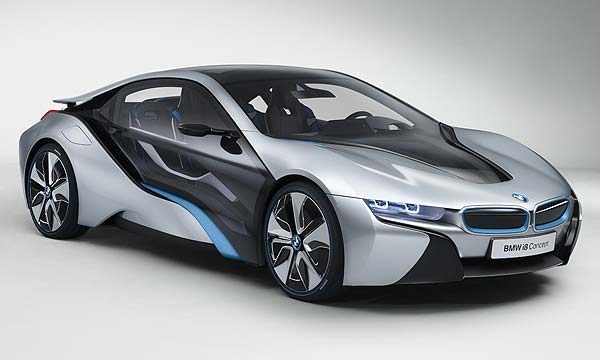

A colleague of mine has been testing the i3 and the vauxhall ampera. Unfortunately I missed a ride in the i3, but the ampera was good. The acceleration in these things is excellent fun!
I have seen an I8 on the road. Look flipping amazing!!! There was just a little bit of that magic I used to feel when I spotted a new model on the roads as a kid. Dont get that very often but they have defo got the wow factor. Awesome!!

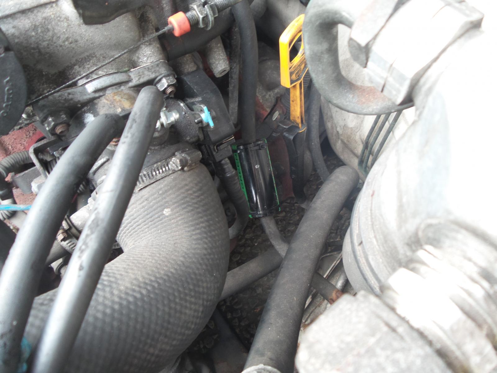

So today was spent carefully putting that back together using bits from the donor 760. Something else rescued from that was one of those "Magic" magnetic fuel saving things which was also fitted.
I'm almost completely convinced the only thing it'll do is make the car slightly heavier but it seemed worth a try.

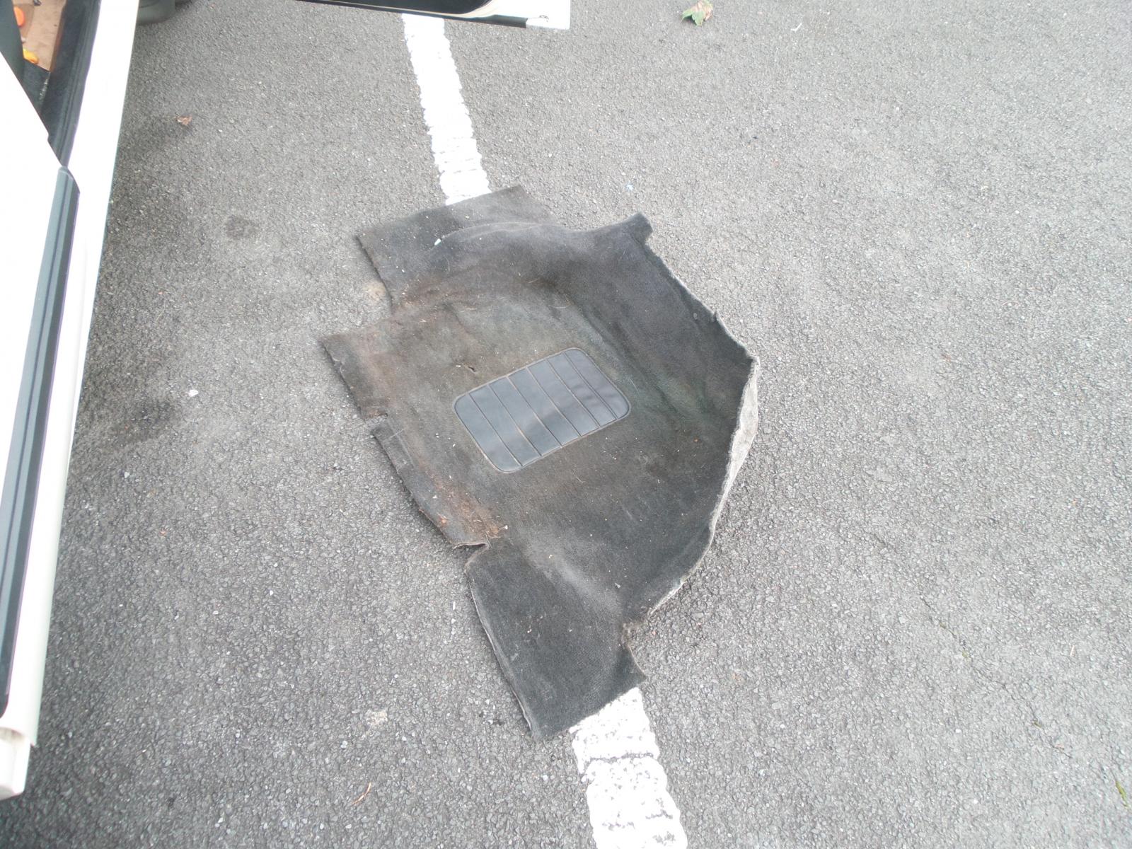

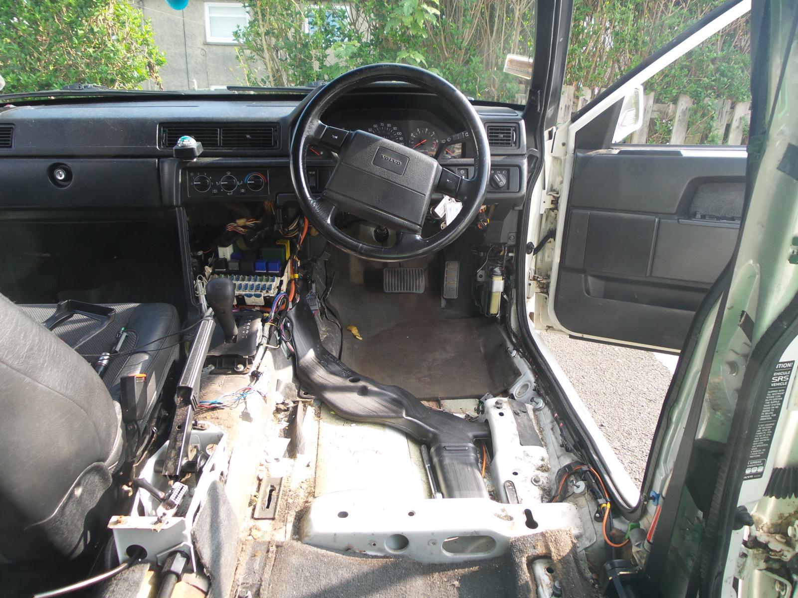

As mentioned recently, the other thing rescued from the 760 was a caramac carpet set for a saloon. Despite having an estate with a black interior I decided it would look excellent and replace the knackered carpet it had.
The floor looks in good order and no more leaks to report.

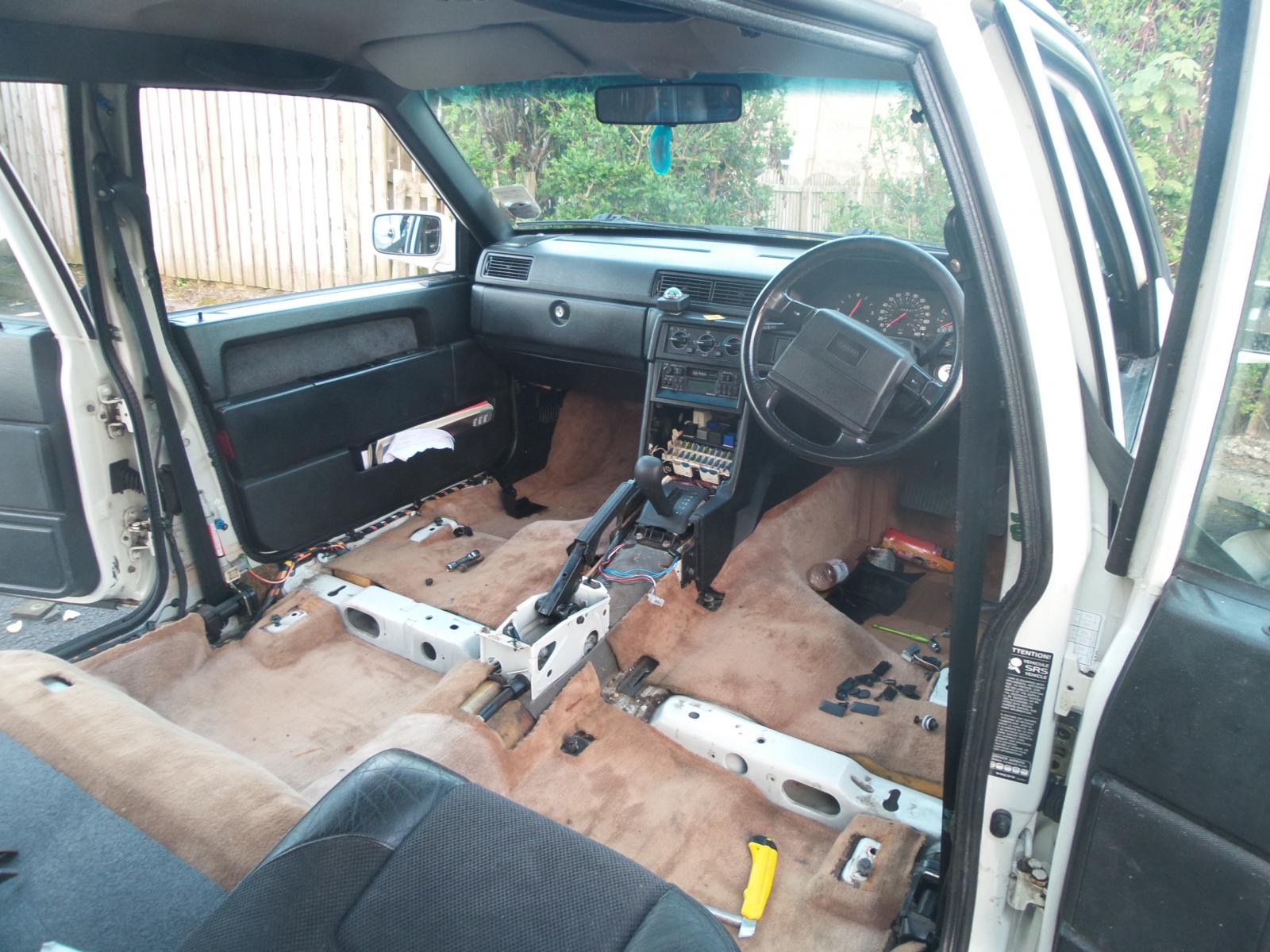

All the carpets down. Interior rebuilding commenced.
Haven't got a completed pic yet unfortunately but it drew a fair bit of praise. Even as a committed follower of the church of WCPGW, fitting a different carpet set to a car is a fucking nightmare and not something I'd be keen to repeat. So of course it'll probably need done on every car now...
