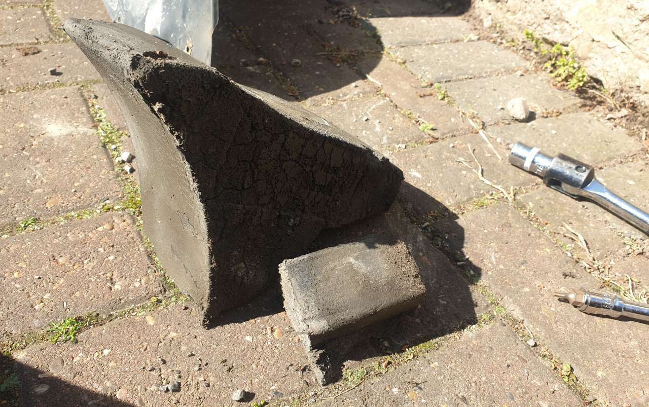

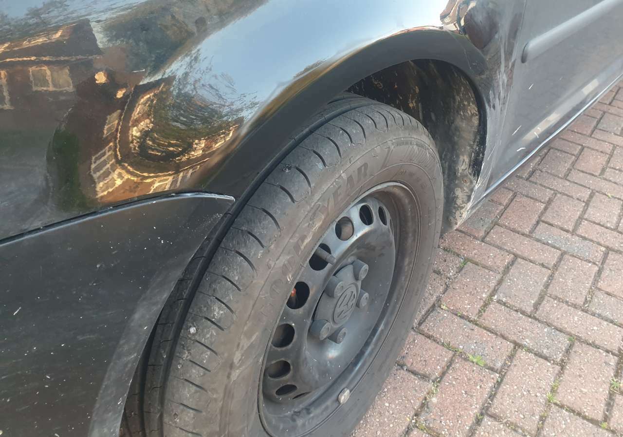

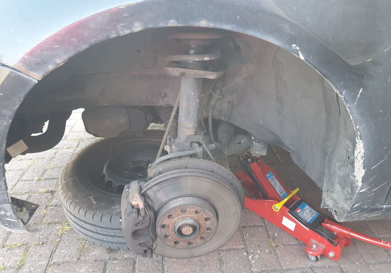

The front wheel arches on the Caddy have been getting a bit rusty over the last year, this is caused by a nice lump of foam that VW popped between the wing and arch liner soaking up water and road salt 😒, with nice weather this weekend it was time to sort them out.

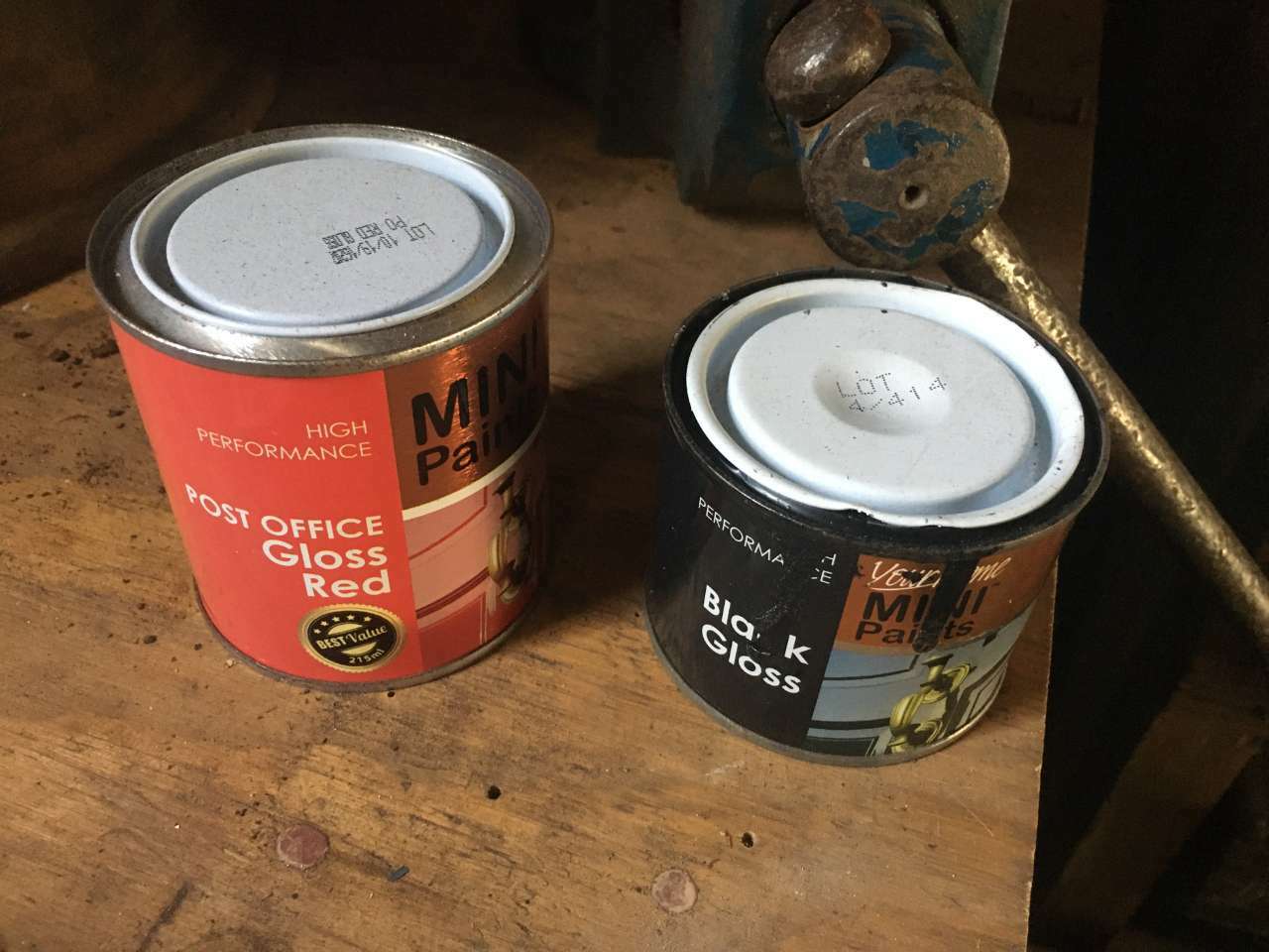

Advance warning this won't be a top quality job, just functional to stop it spreading and having to stick duct tape on it at MOT time. Also I bought matching paint at vast expense, can't find it anywhere! So I'm using Toolstations finest generic black paint - black paints black paint innit?

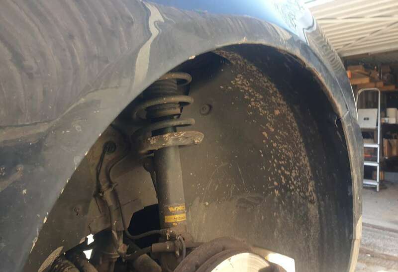

View on the other side. Archliner is off on this side and it looks solid enough, just a bit of surface rust starting.
Poxy foam put in at the factory.

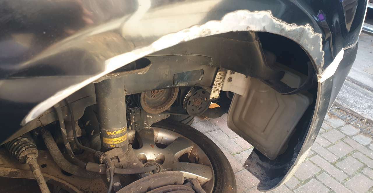

Got a flap disc on the angle grinder and attacked the wings.
Used some Vactan on the rusty bits, primed it, smoothed it, primed it again, smoothed it again, painted it and clear coated it - really needed a bit of filler, but as mentioned just needs to be functional and not getting worse and I'm crap with filler. I'll polish it up in a few days when the paints cured, hopefully look a bit better.
Also gave the arch tubs a seeing to, Vactan, zinc primer and underseal, should keep the rust at bay for a bit.

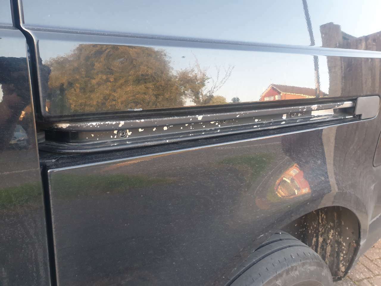

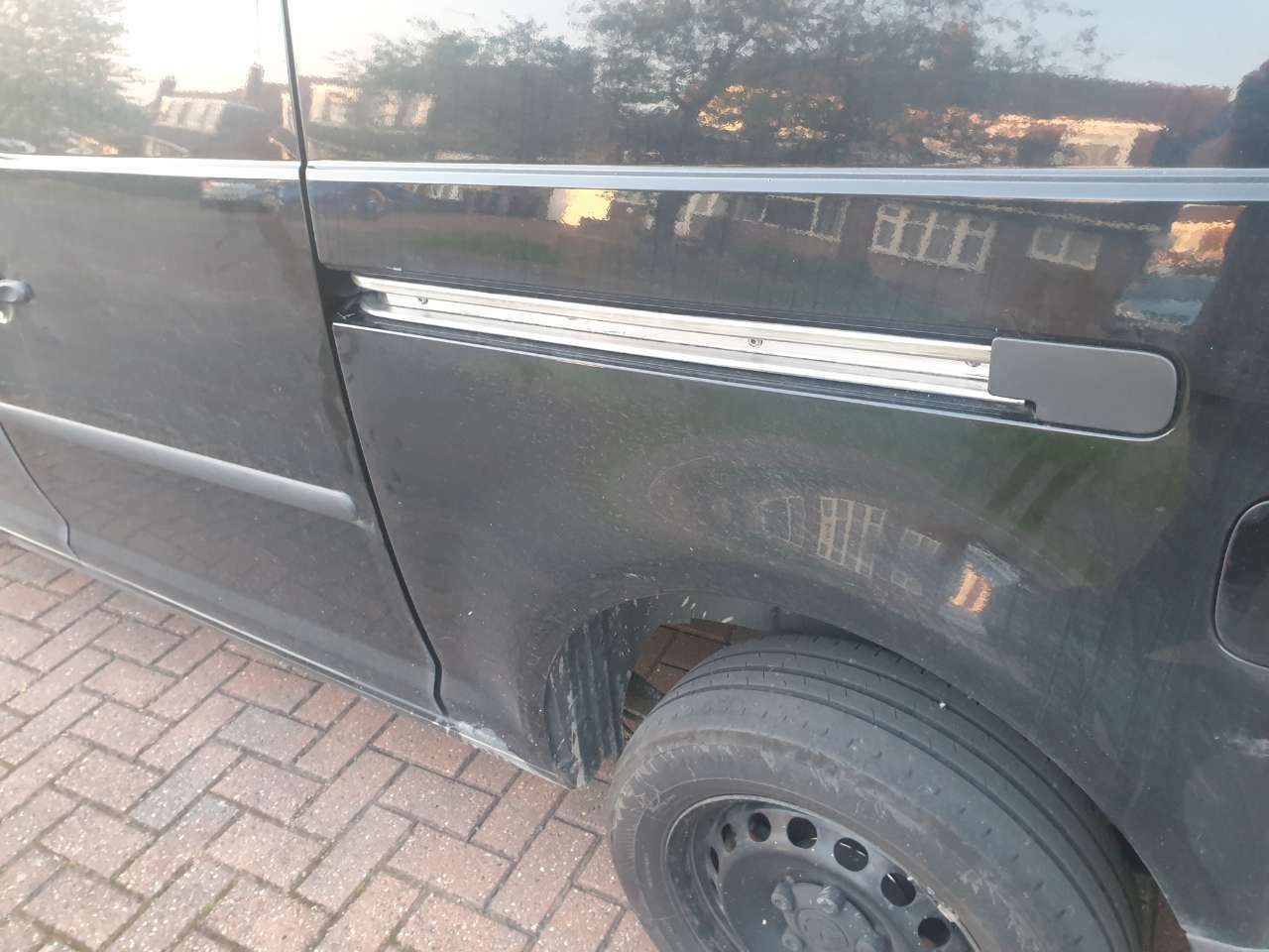

I also tidied up an annoyance, previous owner colour coded the side door sliding rails - it looks shit.
Easy enough to remove, just 5 spline bolts holding it in - a bit of sanding and scrapping later and a panic when I couldn't get the centre roller lined back up to get the rail in and it looks much better to me.
And yes the van has twin side doors so I had to do both sides, at least I knew how to line the roller up second time round.

The roller seems fine, just user error on my part, the roller has some up and down movement in it that I hadn't realised and I couldn't line the trim back up with the roller, I opened the door a bit more to help align it and the top roller came out causing a panic as I thought the door was going to hit the deck!

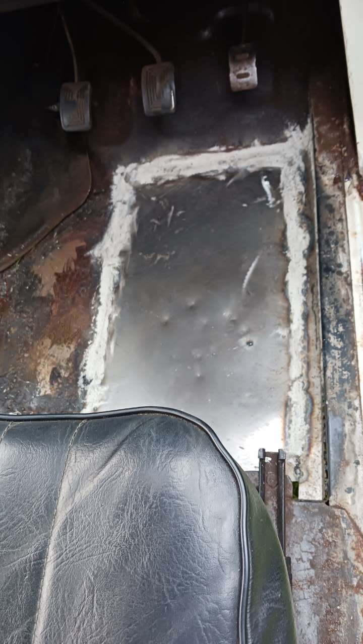

It was a lovely sunny weekend so some fettling occurred, although not as much as I would have liked as I was feeling a bit rubbish yesterday.  First job was to slap some white paint on the worst of the rusty bits on the Renault 4, which I'd rust treated last week.  It's a really rubbish job using a brush and Lidl white metal paint, but it looks better than it did and it's always going to be a scruffy car anyway.  I went out it in this morning and got caught in the middle of a load of old Yank hot rods out for a run, which was interesting.  Also got stuck in the outside lane of the A47 when some senile old twat in a HR-V decided to put his foot down while I was overtaking him - I had to push the poor old 4 up to about 75 and it sounded like it was about to put a rod through the block.
This afternoon I treated the 75 to a transmission fluid change - only a partial one though as I really couldn't be arsed with trying to drain the torque converter.  I got three and a bit litres out, and replaced it with exactly the same quantity of fresh fluid - I have no idea when it was last changed (if it ever has been) but it still had a bit of a red hue to it, didn't smell burnt and there weren't any metal particles floating around so I don't think it can have been too bad.  I took the car for a quick drive and didn't notice any immediate difference in shift quality, but I will give it a longer run at some point and see if it's any quicker to kick down now.
I made a start on fitting the replacement rear strut to the MG - got all the nuts and bolts loosened off and the anti-roll bar disconnected, so it should now be the 30-minute job it would in theory have been in the first place if rust wasn't a thing.  I'll hopefully get round to finishing the job one evening this week.
Then I ran the Renault 6 up to my welding mate's for him to have another look at now that the extent of the grot was a bit more apparent.  He told me which bits of floorpan to slice out, which was easily done with my shiny new Parkside grinder.  Then weldage occurred.
There's still a lot more to do, but at least it now has a floor which is actually joined on to the inner sill, which is a definite improvement.  I've left the car up there and cycled the 12 miles home - I don't really want to be driving it too much until it's finished.

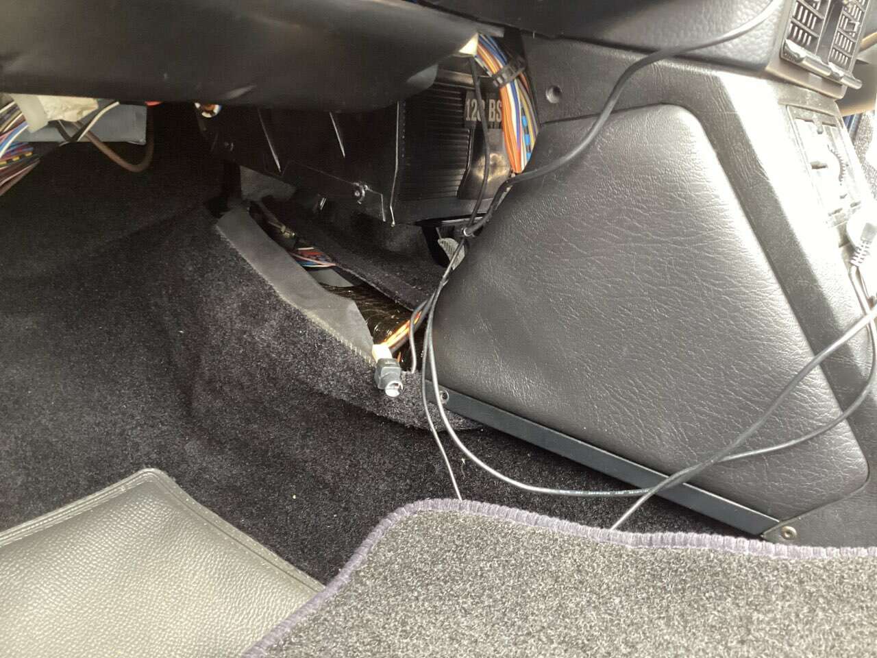

A serious lack of space for my leg to operate the brake pedal gave me all the excuse I needed to fit one of my favourite wheels of all time.
Which Porker is that off? I have been looking for a replacement wheel for ours as the rubber has come away at the top.
928? 944?
944, but 924, 968 will also work I did have to space out the horn contact ring 6mm using motherboard spacers and extend the main shaft spacer 6mm by cutting a second one down, but it's the work of 10minites or so. If you have a non assisted van I wouldn't recommend it as the wheel is a lot smaller, but it's no problem on a PAS van.
I bought a slightly rough looking brown one and dyed it black to save a few quid which was easy with a sponge and some furniture clinic dye.
