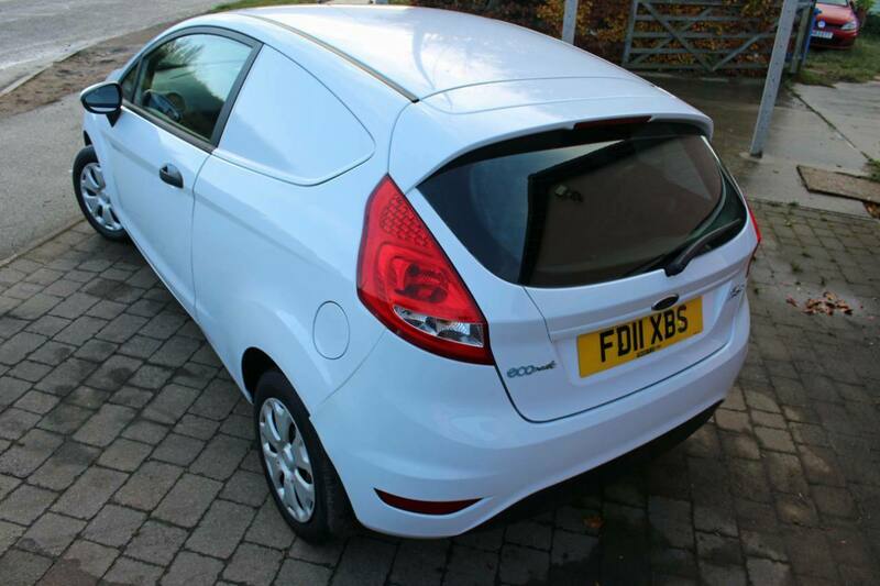

The little green Fiesta is looking a lot less green now.
It's remarkable how tidy it was under all that green moss and algae but I've now hit a snag, It won't rev over 3800 rpm and smokes when on the limiter, the ecu comes up with a P132B fault code which is a turbo actuator or boost fault? I'm not sure how deep i want to go into fixing that yet as i have no experience in them? other than a needing a new windscreen it's almost ready for a mot now though.
Don't make the mistake I made on my Espace. I assumed the noisy turbo was the culprit and spent quite a bit of time and money replacing it. Turned out that it was the solenoid valve that directs vacuum to the turbo (VGT?) actuator.
The valve was £30 and ten minutes to fit...

If you like I will see what I can dig out on Ford ETIS for the solenoid, assuming there is one.
Cheers for the offer, I've just managed to fix it... It ended up being a stuck actuator, took the E Clip of the rod and it all spring back into life again, gave it a squirt of WD40 and it now runs perfect, cleared the codes and there's no lights either so happy days!
25 minutes ago, trigger said:
Cheers for the offer, I've just managed to fix it... It ended up being a stick actuator, took the E Clip of the rod and it all spring back into life again, gave it a squirt of WD40 and it now runs perfect, cleared the codes and there's no lights either so happy days!
