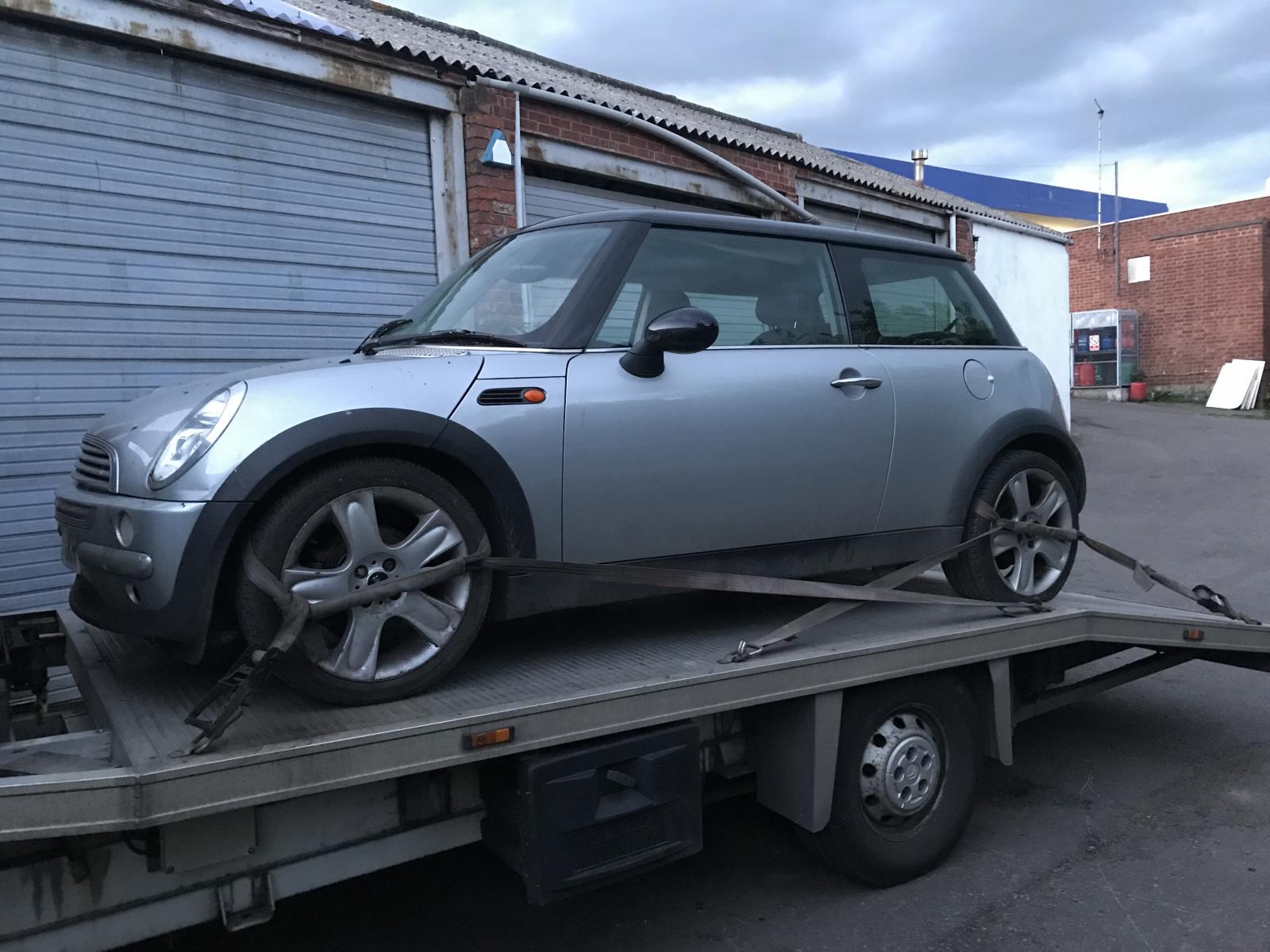

Fetched the Bini and it’s a solid little thing and a nice spec. It has glass sliding roof, Chilli Pack, and full leather. Also has traction control and dynamic stability.
However, the dash is lit like a Christmas tree, headlining needs attention, boot lock needs sorting and A/C is inoperative. Needs brakes all round and some fettling on the body.
Wheels are original but I’m not sure if I like them or not. Pedal rubbers have a Mini script on them and it appears that early incarceration’s didn’t have a glove box, just a parcel tray.
Is it worth the effort? I think so as these are a good steer and there is decent enough interest in early 2001 motors. It was also cheap, but that’s testament to the condition.
I will keep you all posted in my Bini thread and turn it into a project.
