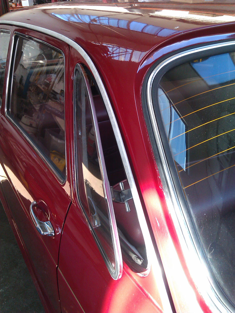

Just picked up this thing.
22050034_10159542081760436_4849569150854
22154276_10159543399245436_4969943690642
22089760_10159543399665436_4303074825861

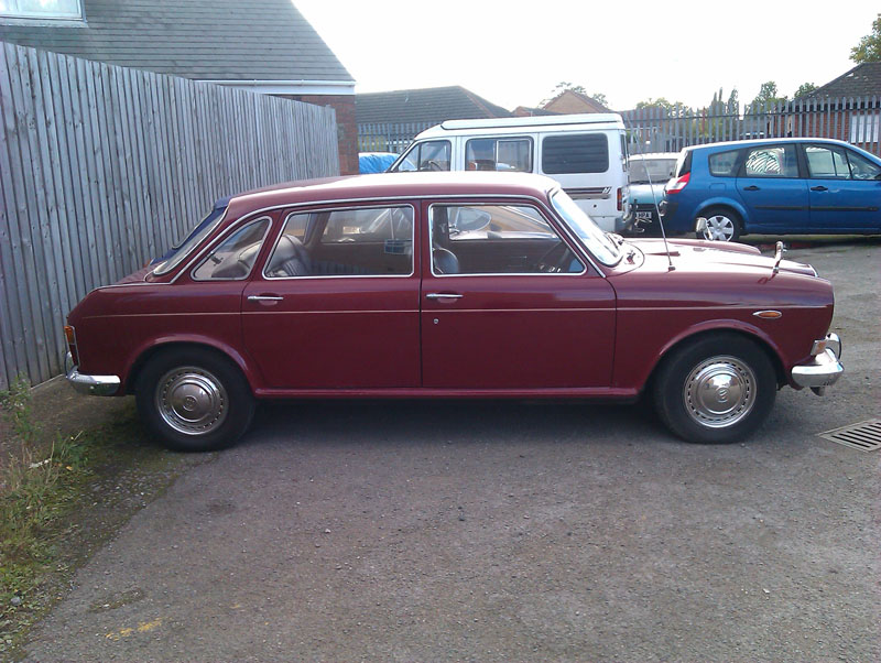

Parked up for a year, covered in tree sap, non working starter. I was intending to just defuel and scrap but obviously I had to clean it up and have a poke about..
22089110_10159543400110436_7757470156299
22140961_10159543398825436_1444565714821
The starter came back to life with the aid of a big diesel battery and the leaves and tree sap were cleared off. Everything works, can't find anything obviously wrong apart from a small patch inside one rear wheel arch, new exhaust, brakes and a couple of tyres for it's last MOT (which was 2 years ago to be fair). Do I fill it with scrap and weigh it in? Sell it "as is" to a Pineapple apologist? MOT it myself and smoke around in it? Arrgh, why can't it just be a total shitter so I'd know what do do!

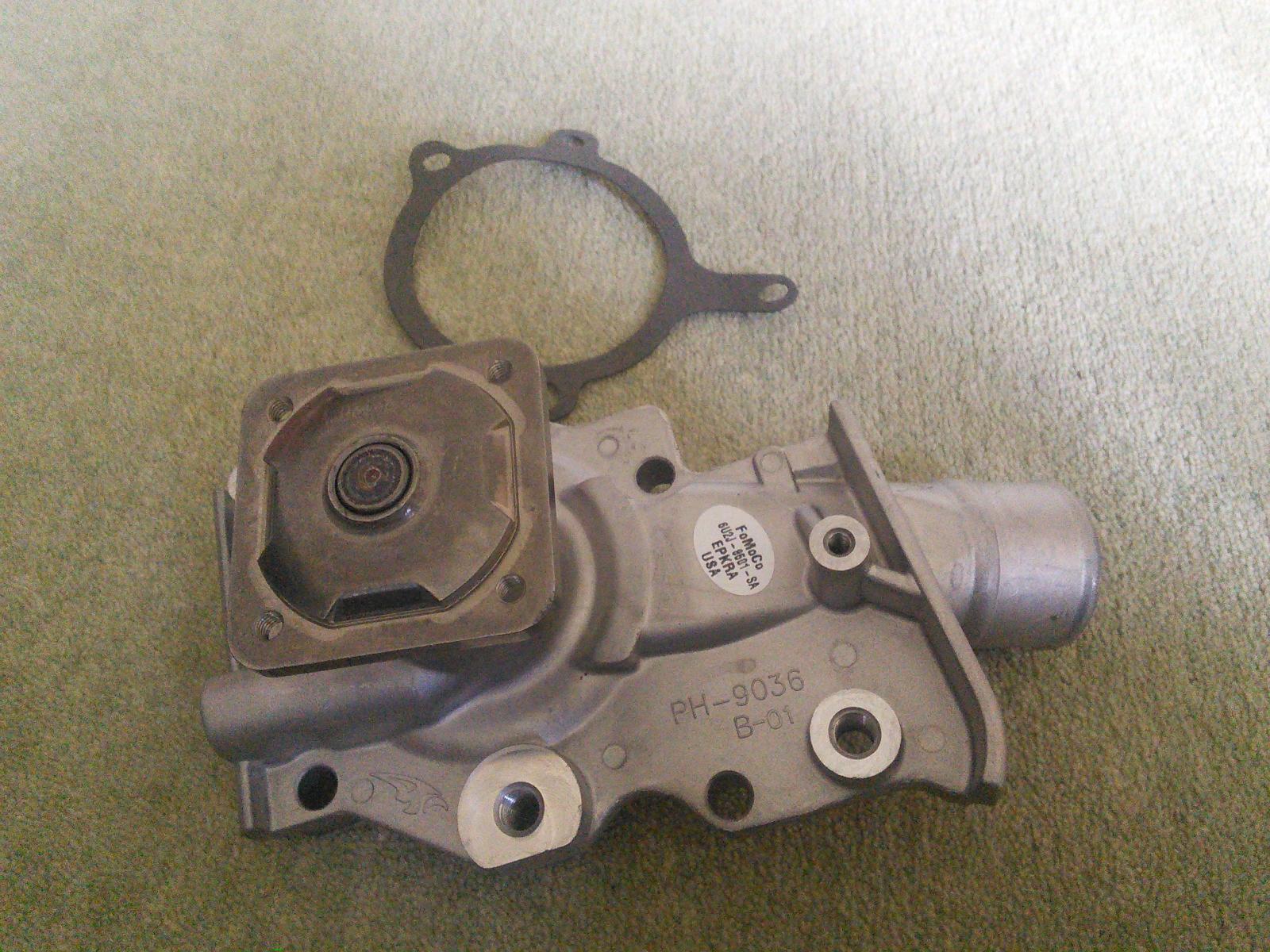

Despite best advice, I ordered a USA water pump for a Ford Contour for my Mondeo, well, because OEM for £30 including import VAT! Looks right, proof will be in the fitting...
