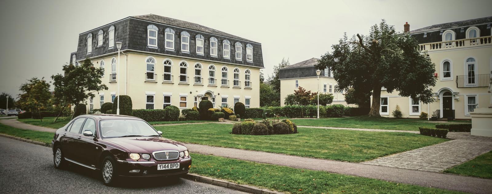

July 2018 calendar shot if I do say so myself.....
