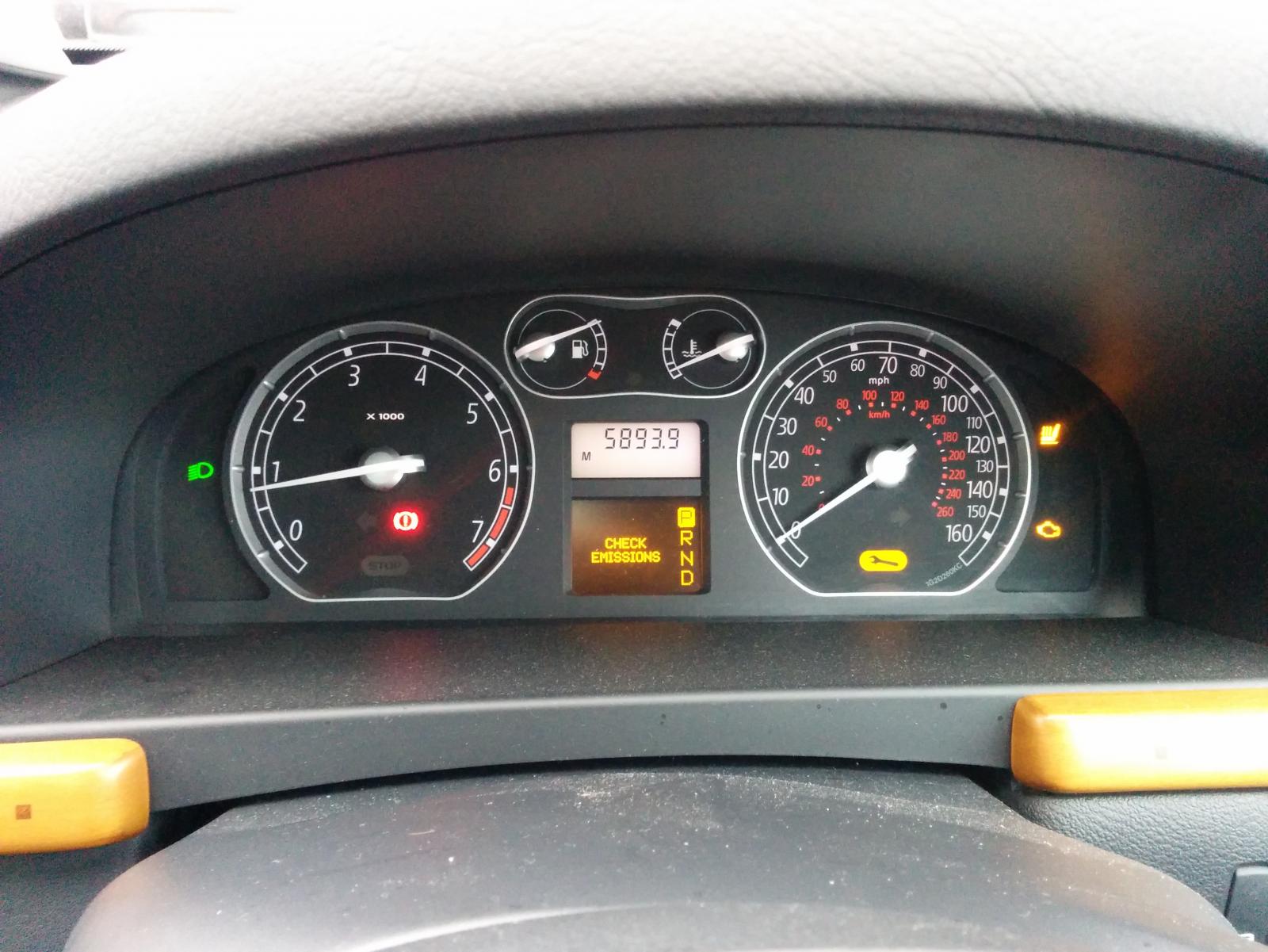

Feck sake. EML was merrily flashing away while I just carried on driving to work. Code reader (yes, one lives in the Laguna) says P0300 and P0355 - random misfire and cylinder 5 coilpack connection. Wierdly the engine temperature gauge stayed on minmium and occasionally flicked up and down. Hopefully it's just when it's misfiring it stops sending the coolant information over the CAN bus and so the dash stops showing that info.
Quick Google says cylinder 5 is under the intake manifold. So a disassembly job to get to it. :(

It has been juddering occasionally when coming to a junction at idle but only ever when cold and usually only once at the start too. I always assumed it was something like the lock-up converter clutch solenoid being a bit slow (i.e. related to the double bump I get setting off from a stop which I think is low-line pressure) when it was really cold. However as the roughness at the moment is identical to what happened there now I think it was the coilpack giving me a warning that it was starting to get a bit sickly.
I seem to remember this one being replaced not long before I bought it.
Sent the wife out to go down to the only ECP that had coilpacks and spark plugs for the v6 in stock. £72 after discount code. :(
Next "fun" is the drive home. Hopefully it doesn't cut out if the coil pack is failing/failed. I mean it still has 5 other cylinders that work...
Got back ok in the end. Arse clenching moment of a mile section of motorway out of the city I had to do - roadworks with narrow lanes and no hard shoulders. Fair play to the car though as it got me back.
Coil from ECP is wierd though. Website said Hella, box is labeled Bougicord and coil inside says Delphi. Reckon someone swapped a cheapy/knock-off into the box and returned it?

Right. My only chance this weekend to fix this heap of garlic flavoured piece of shit is to go out now and get going tonight. That way I have a hour or two tomorrow to finish it off in the morning. Just 0C to -1C ATM. Not only cold for me, but cold for bits of plastic I have to undo. :(
Supposed to take around 1.5hrs - so 3hrs at my speeds.

Done! Took 2 hrs 45 minutes. However that was coil pack (manifold off), replacing all 6 plugs, giving the throttle body a good scrub and snapping a stupid rigid breather pipe. Currently fixed by jamming in a bit of silicone hose and taping it up with insulation tape. Can hear it leaking a bit of air though, so may have to seal that bit with silicone sealant.
Ultimately find a replacement part, but it's got alsorts of junctions on it. No doubt silly money from Renault.
Runs really well now though. I'm sure the butt dyno is registering a power increase.
