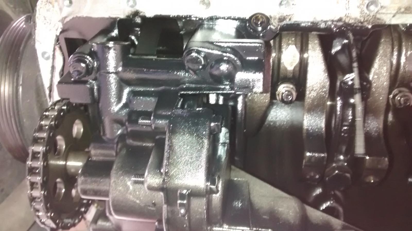

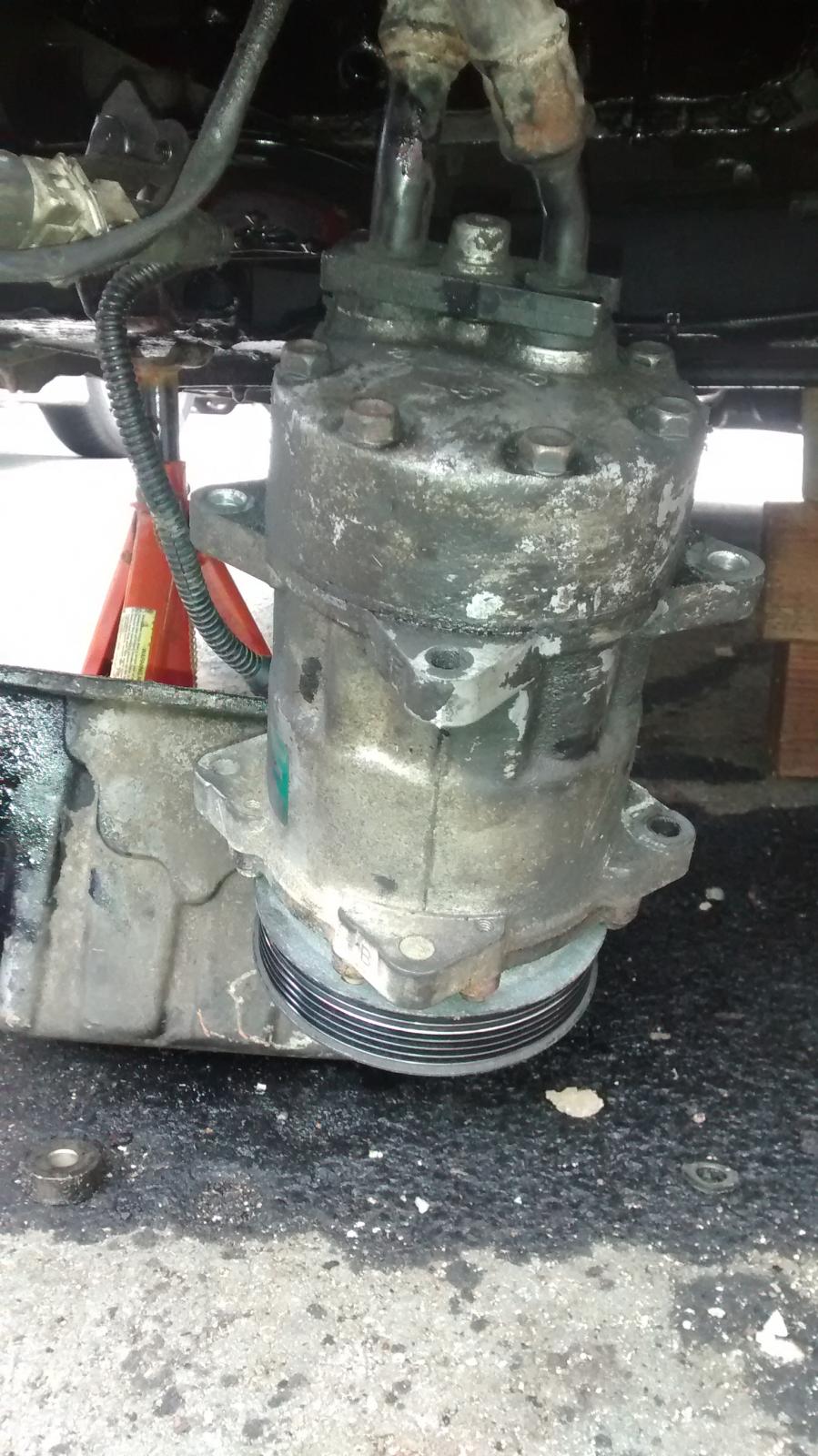

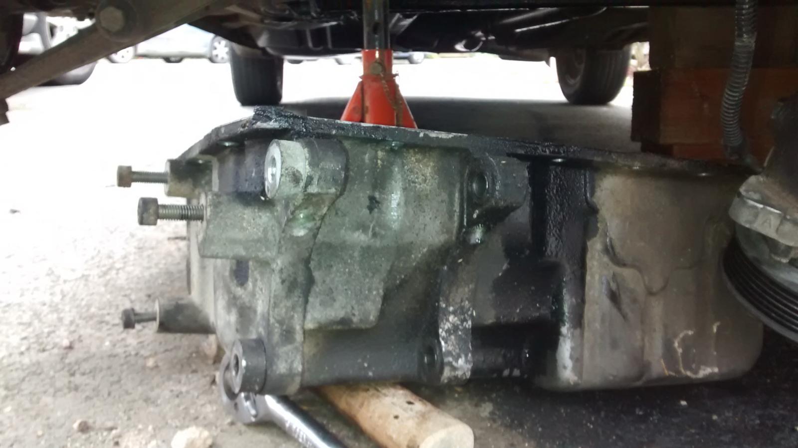

Finally got the cracked sump off the 405 this morning. It would have been an easy job on a car without air conditioning. As it was the alternator and everything around it had to come off too to get to the upper mounting bolts on the compressor.

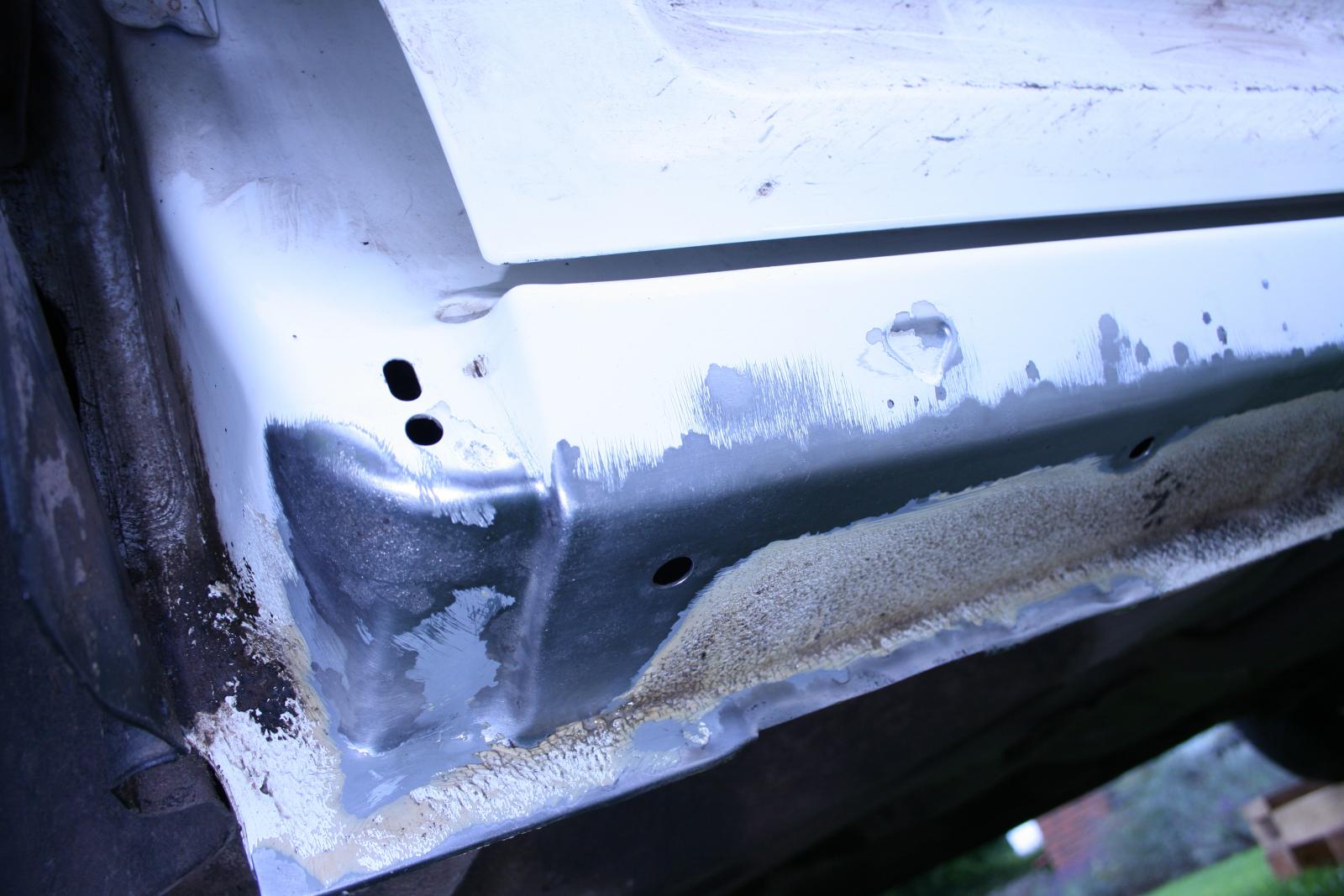

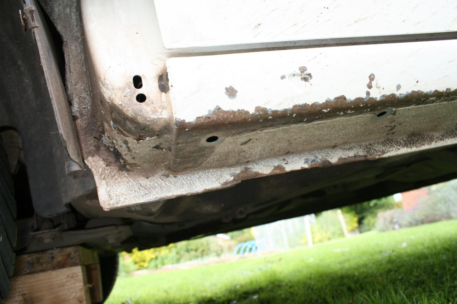

Happy afternoon de-rusting the n/s sill on the Connect.
Thank goodness for zinc coated steel! Rust minimal despite the thinnest paint ever.
Amazing stuff that Deox gel.
Hope the rain stays away until I can get some zinc primer on. Stonechip tomorrow.
